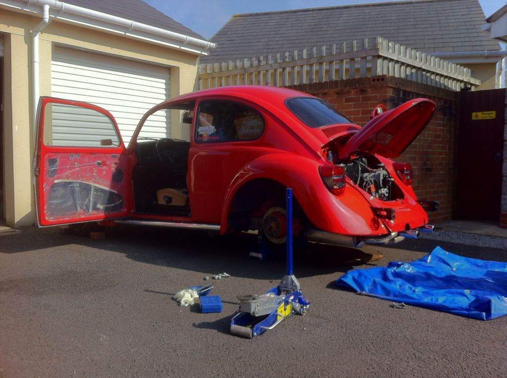

So the gearbox looks like its internal damage
Me and Chipper got the engine out last night, only 2 hours Very Happy
Ella - The 1985 Mexican Bandit - Page 18 388FB40F-C148-4B46-8823-41066CA81F81-145-00000005630B80C2_zps4cdf3186
All out
Ella - The 1985 Mexican Bandit - Page 18 81196017-4994-47D5-AF58-E01083CDD337-145-000000057183A745_zps8595856a
The clutch / flywheel / pressure plate looks to be ok, will dismantle this tonight
But the damage seems to be inside the box so that will have to come out
If its quite expensive to repair then I will probably IRS the rear end

Ella - The 1985 Mexican Bandit - Page 18 482520_4814881376784_611795163_n
engine out
thanks chipper for the help Very Happy
