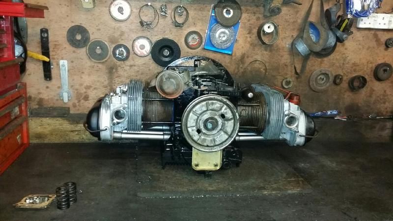

| 1776 is finished and paid for and will be couriered via a pallet next week. 1776cc Reground crank and all new bearings etc. 110 cam and new lifters, drilled for full flow oil system Heads have been vapour blasted and the valves lapped back in Going to run electronic ign dizzy, twin IDFs and the VS exhaust Got a Scat Serpentine system to go on there too. Can't wait to get it back and built up from long block. | |

| Scoops, is that a picture of your new rebuilt engine? Can you say who did the work? (well known?) Not sure about all those cutting discs, strange way to build an engine | |
| Subject: Re: 71 Early Bay (formerly known as Superdry) Sat Nov 21, 2015 1:54 am | |
| It's a fella up Doncaster way how has also built engines for other well known owners. | |

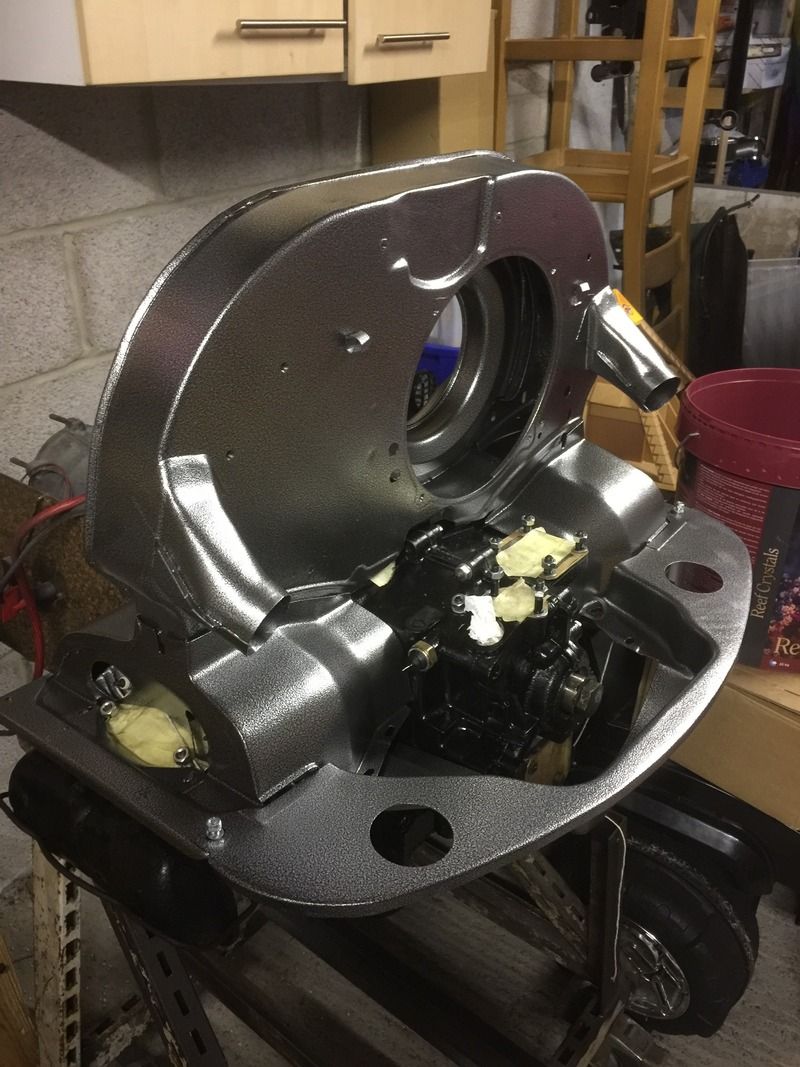

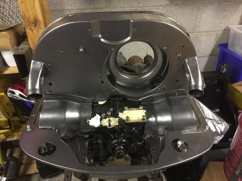

| Bailand Dave kindly popped round earlier to give me a hand to get the new engine on the stand. I had a spare ten minutes so wanted to have a look at what it may look like so had a little mock up. Going to set to it and get it fully built up and ready for [squeaky bum time]cam break in[/squeaky bum time] | |

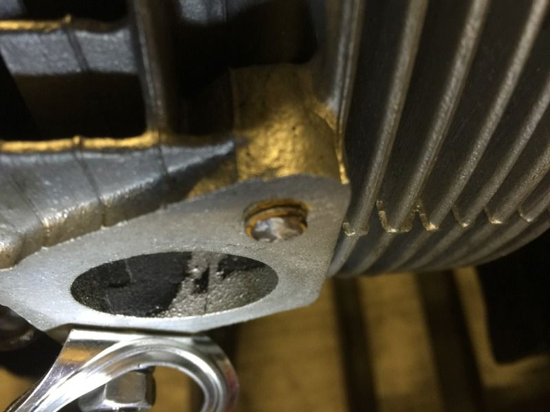

| I"m trying to get back in touch with the fella who built the 1776 as I'm simply not happy with it. Shagged exhaust studs that are snapping when they come off, not enough thread penetration on the head nuts, blue sealant all over the place and the heads don't look square on the barrels to me. Gives me no confidence so it's going back for a refund......back on the hunt for an engine.
