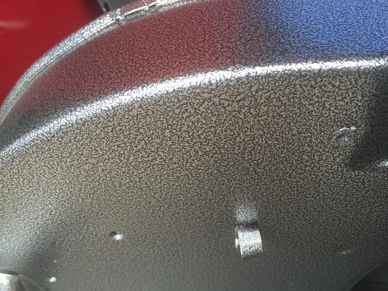

Dropped the tinware and firewall off at ABC coatings in Nailsea today.
It's all going to get cleaned up, blasted and powder coated.
120 for the tinware and firewall, should be back in about 10 days.
Hurrah.

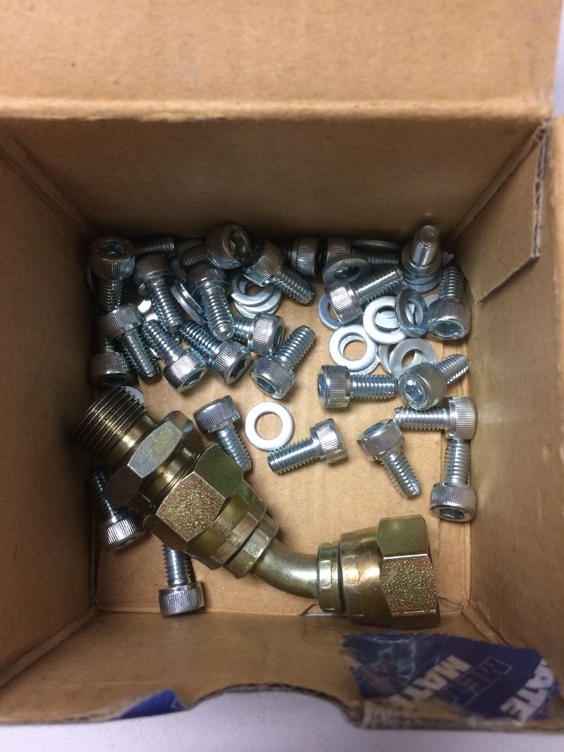

In anticipation of the return of my tinware I wandered up to Western Hose at lunchtime and purchased a 45 degree oil line fitting and then round to Weston Fasteners to get some more tinware bolts and washers.

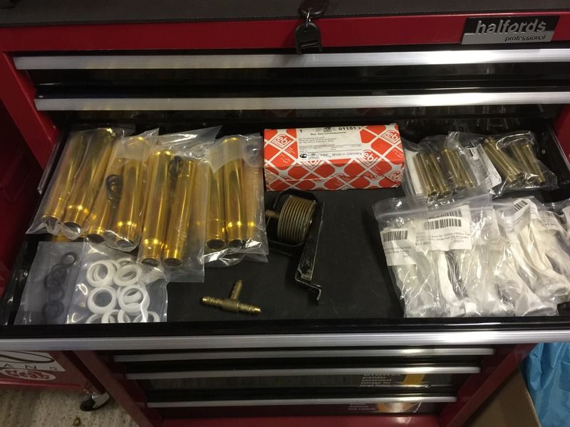

I used these for all the tinware when finishing off the engine on the Wizard.
M6 and M8 versions in lots of different lengths.

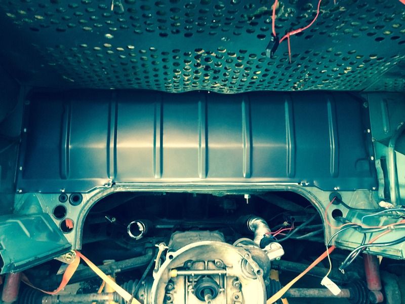

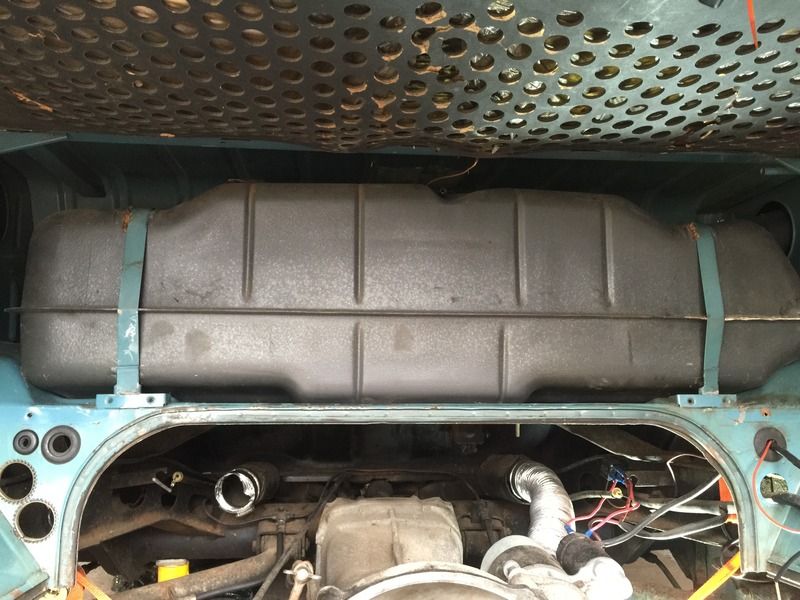

Finally a little bit of progress on the 71.
Got the fuel tank back in place.
With the breather pipes all reconnected I then managed to get the firewall back in place.

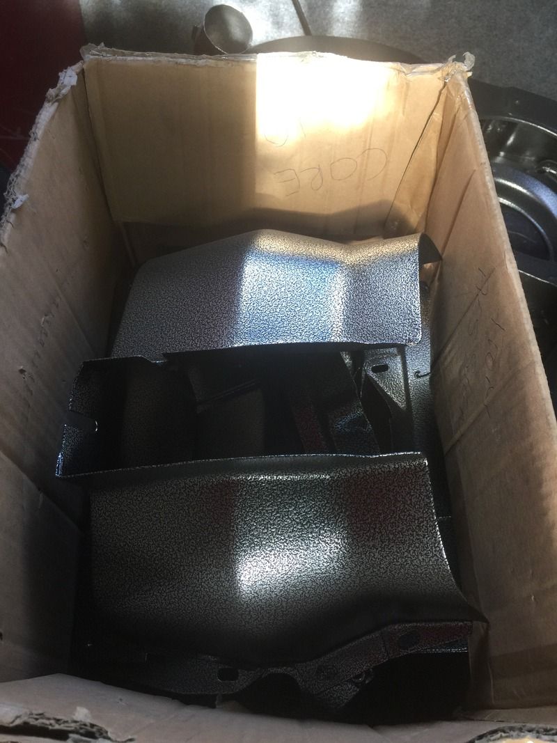

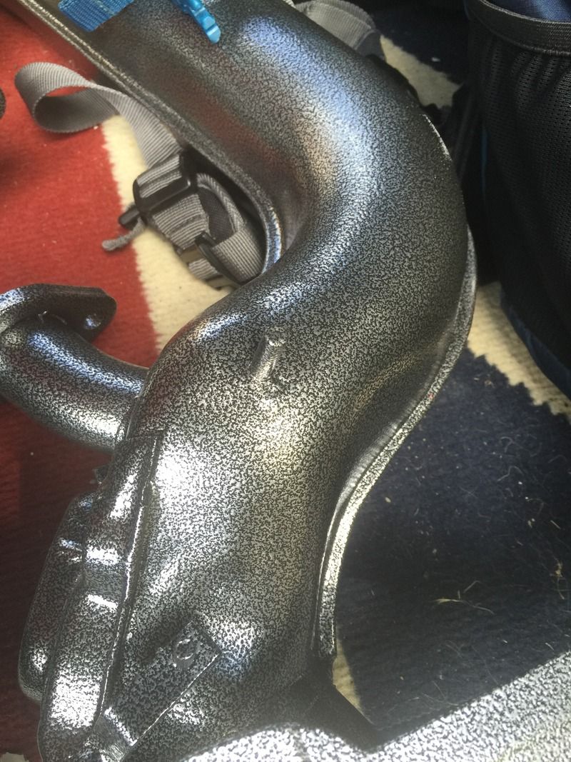

Got my heat exchangers and tinware back too.

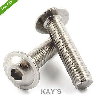

Firewall sorted properly now. Bought stainless screws today and fitted them, then found the 12v feed for the sender, so had to drop it off again, fit the lead, then refit. All sorted now. next job is to t-cut the paint in the engine bay.

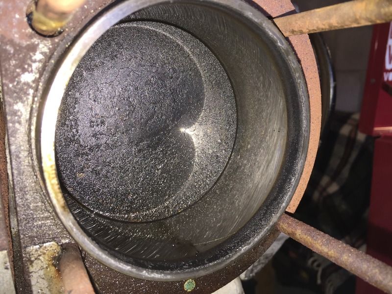

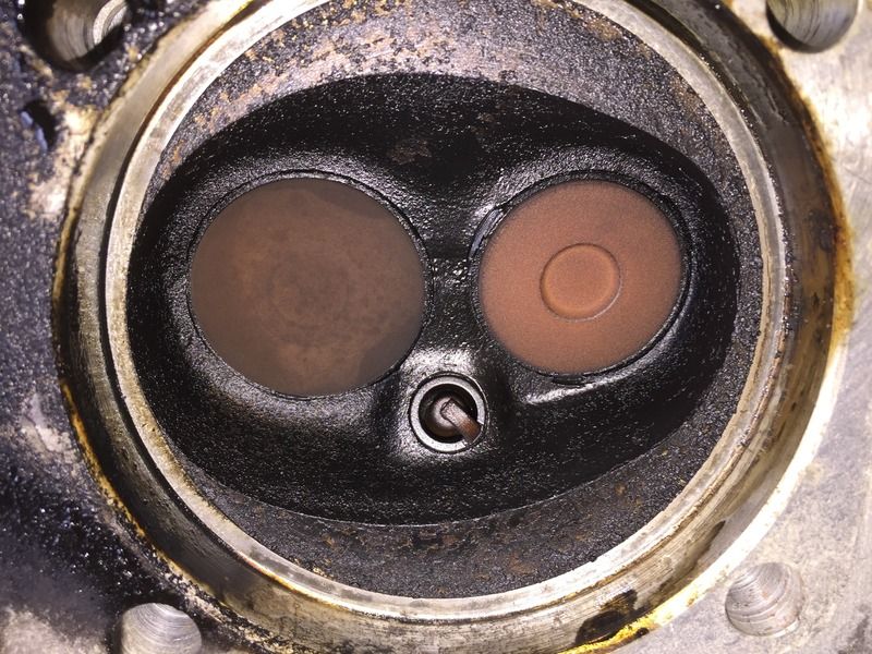

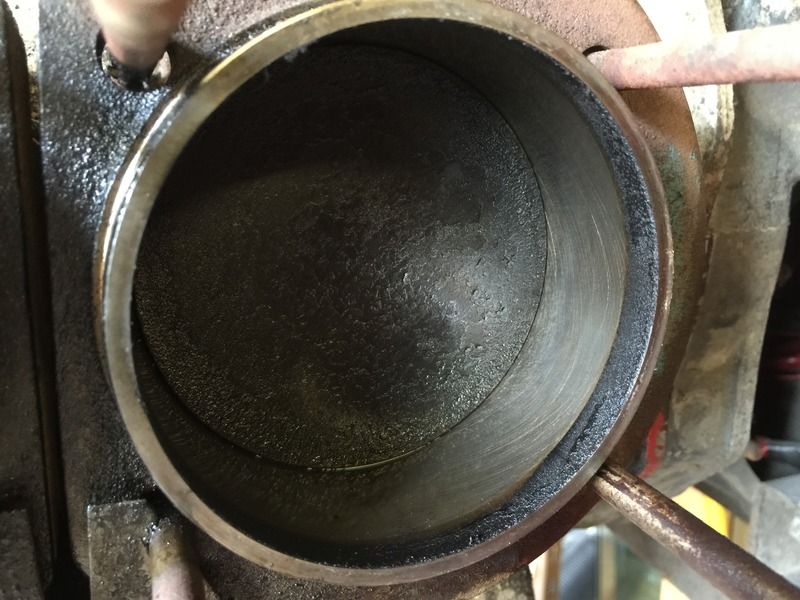

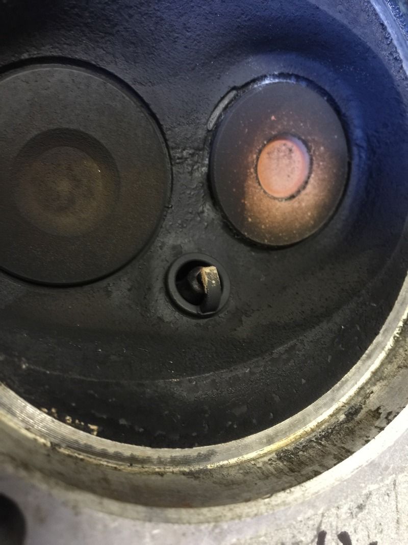

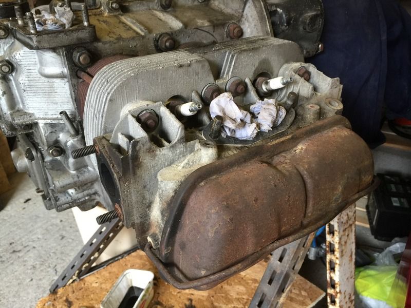

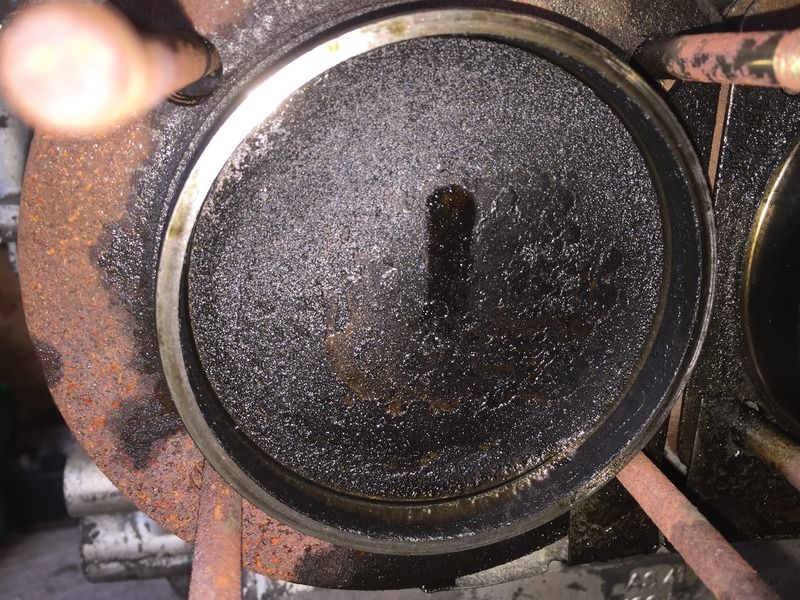

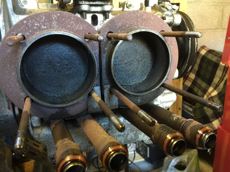

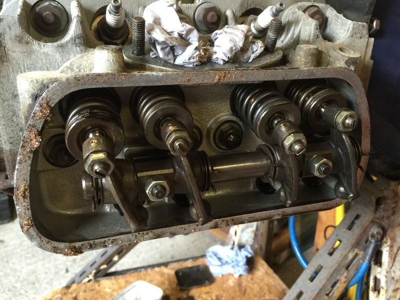

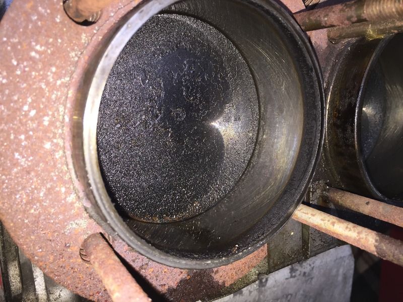

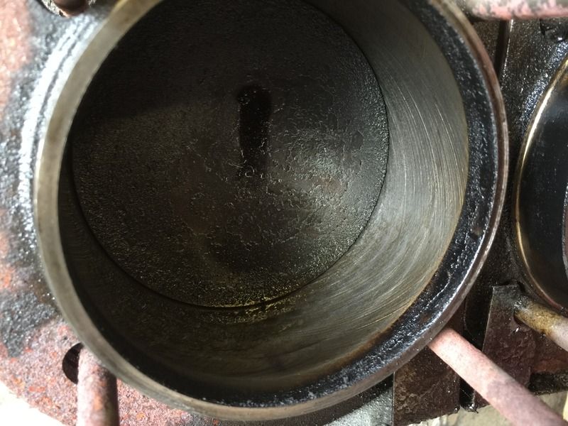

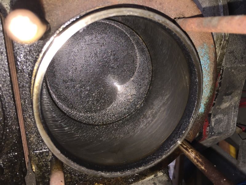

Decide to make a start on the 1641 this afternoon.
Gasket needs properly cleaning off, it'd gone a bit crusty
Barrel #2
Barrel #1
#2 looks like there's a bit of oil in there
#2
Actually #1 doesn't look that good at the plug either does it?
Bores seem ok.
Awaiting some love......
I have a full set of replacement stock valves here, along with a set of rings and a set of valve guides.
Is it worth just replacing the lot?
View user profile http://www.cttp.co.uk
avatar
PostSubject: Re: 71 Early Bay (formerly known as Superdry)   Fri Jun 12, 2015 8:34 pm
could just be oil ,cos the engine has been tipped in transit .but if you have the new stuff ,i'd fit it

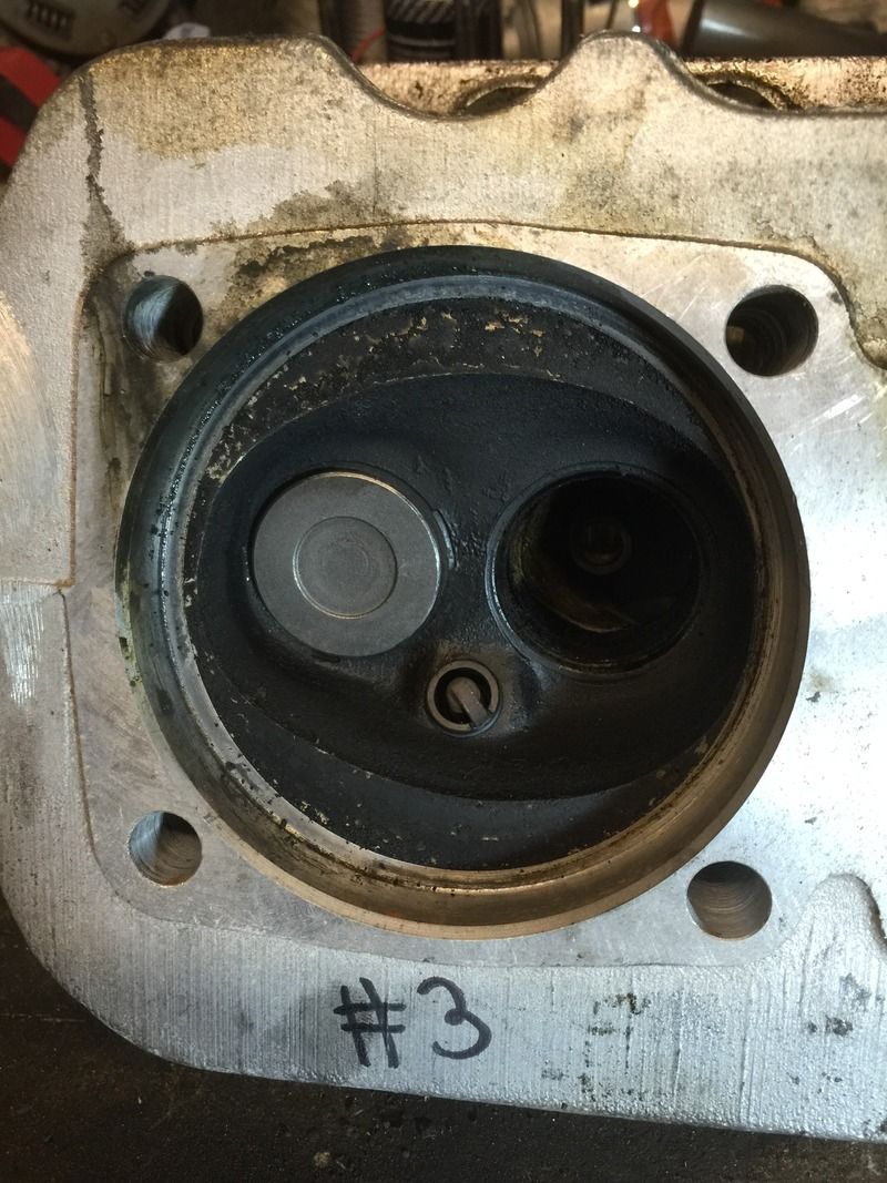

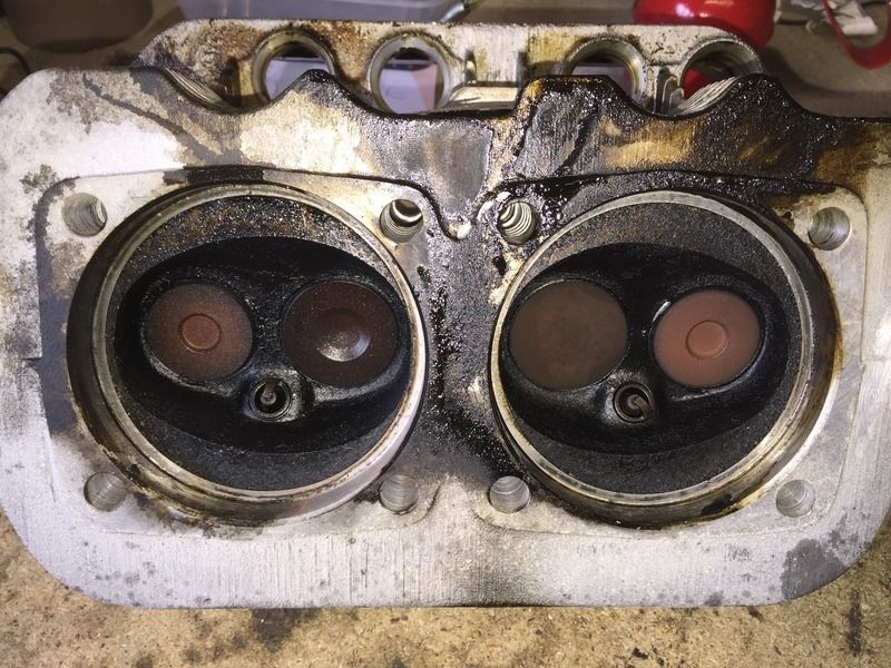

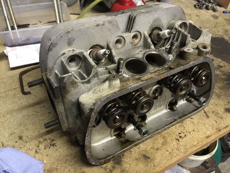

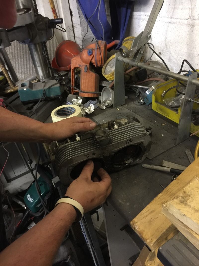

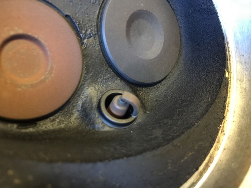

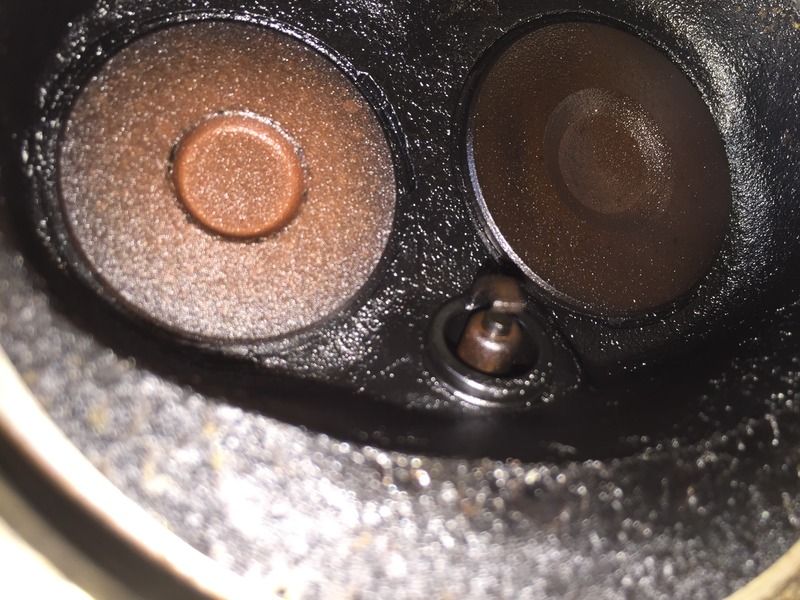

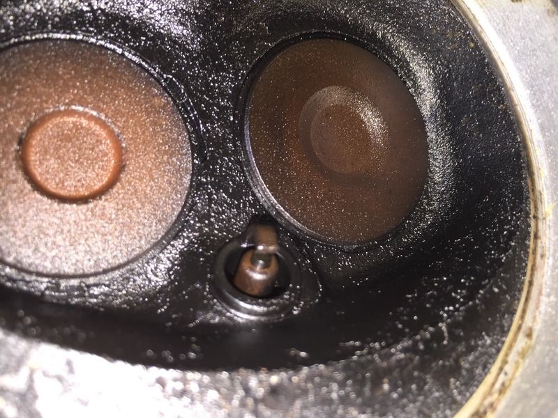

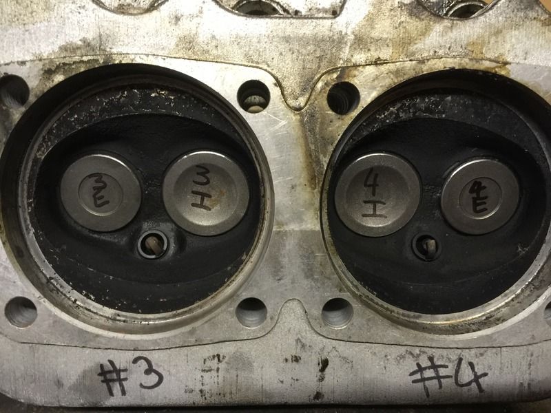

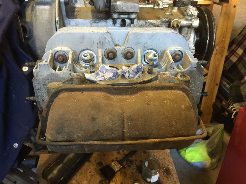

Needed to get the other head off too
URL=http://illiweb.com/fa/pbucket.gif][/URL]
This side looked healthier so I'm assuming it had been tipped on it's side at some point.
Marked up and ready for some diagnosis from Nomates
Plugs look better this side too
Armed with some measuring data I set off to Dr Nomates Engine Emporium.

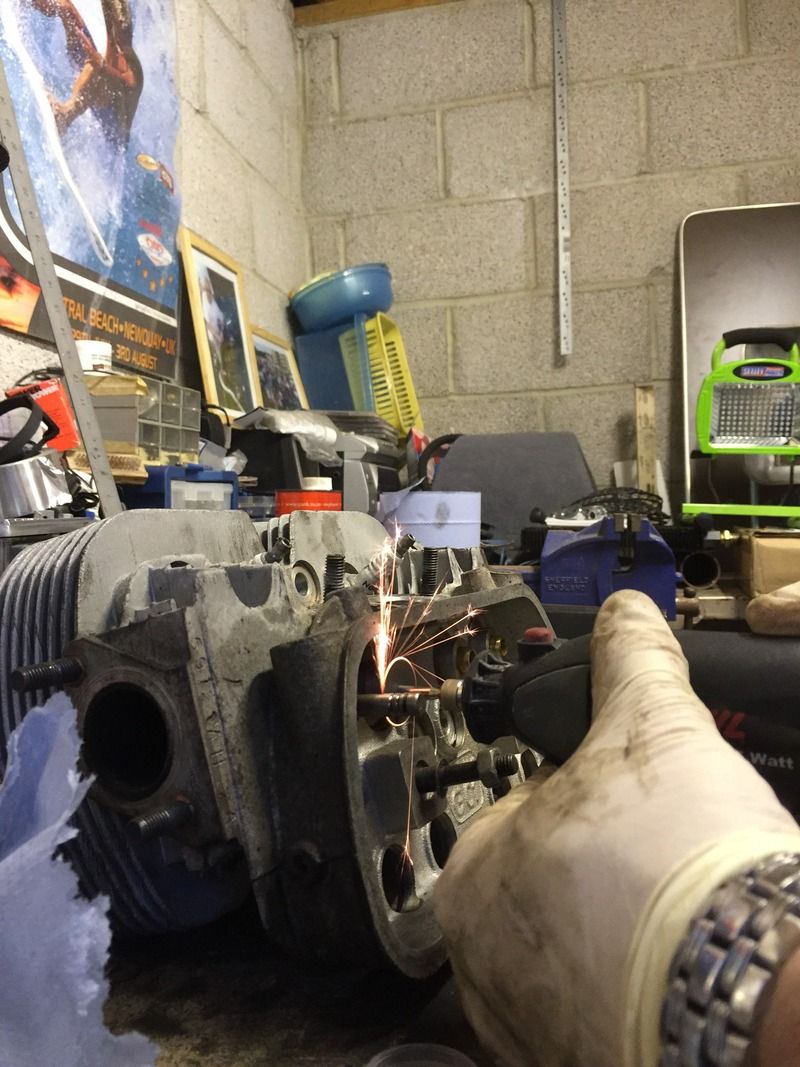

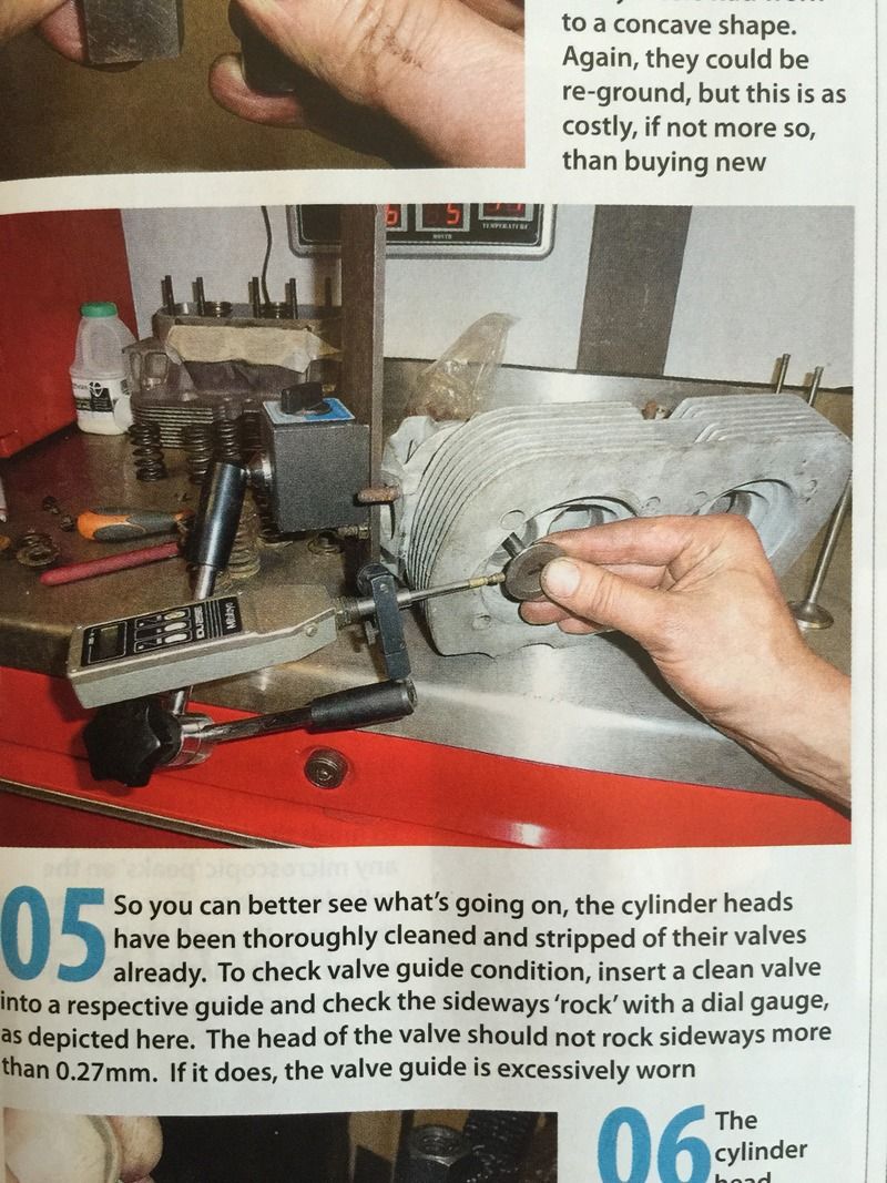

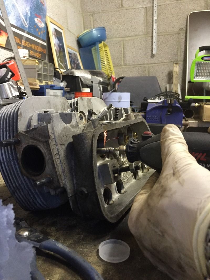

However, Dr Nomates shunned this info in his own special way by saying "that's bollocks, they are showing you measure the guide wear from side to side, they wear top to bottom" so we dismissed the article and he worked his magic.
Out came the collets and springs.
And he used his in built 'spidey sense'
He said in his opinion all the guides were ok but to relap in the valves, something I'd planned to do anyway.

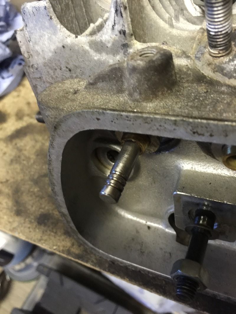

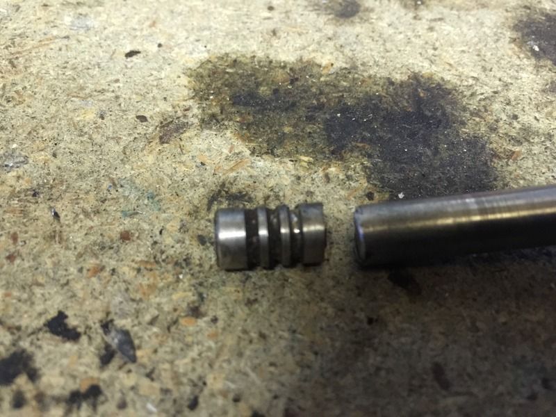

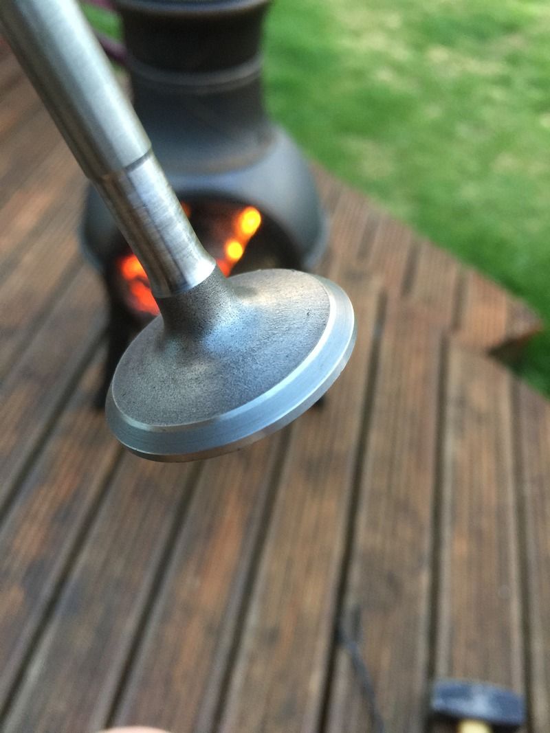

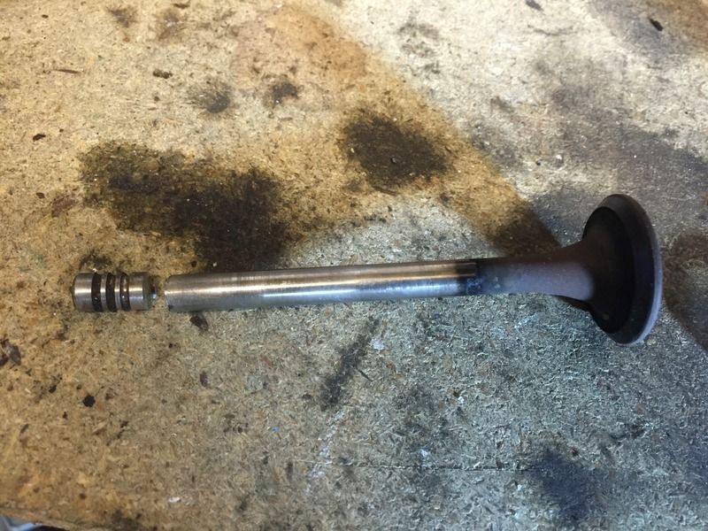

Then we had a minor issue in that the exhaust valve on Number 3 had developed a bit of a burr from the collet and wouldn't go back down the guide. The first groove had an edge on it and I didn't want to bugger the guide up by forcing it.
Out with the cutting discs in the Dremel
Ooooh, pretty

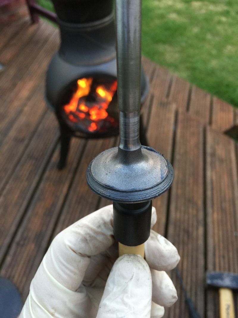

Valve cut and a chamfer put on to make sure the guide didn't get scored when it came out.

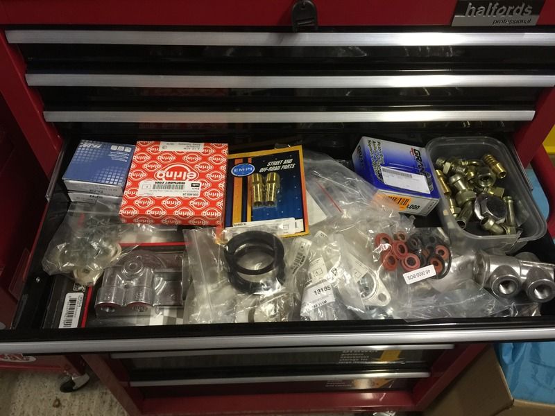

Time to start clearing the drawers out and getting stuff installed!
Problem valve replaced
Along with the others
Just need lapping in now.

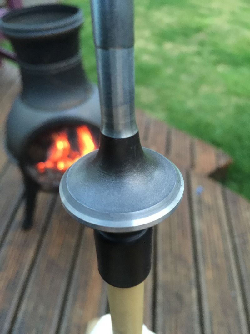

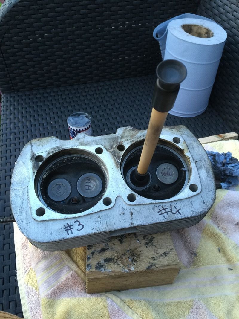

Had a little bit of time tonight so decided to make a start on valve lapping.
Mid-Lap
Need to clean this head up now, before starting the next one, before refitting the springs and then doing a valve leak check.
