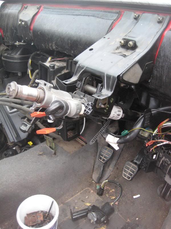

| The dash, pedalbox, and looms, are all removed from the Golf VR6 now. The golf also has a full CAT 1 Toad Alarm and immobilisor, so im carefully trying to remove it all so i can fit in it in the caddy. | |

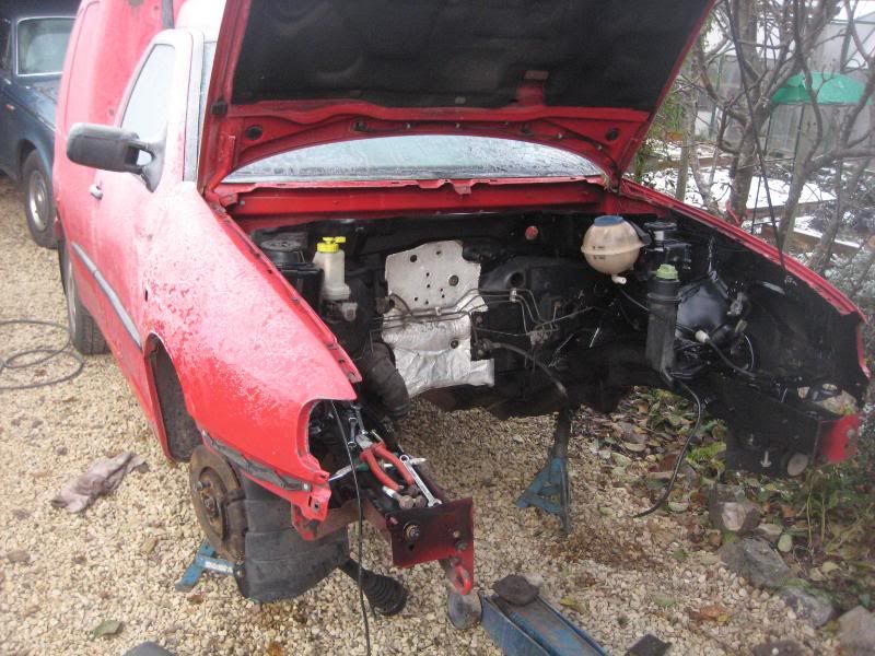

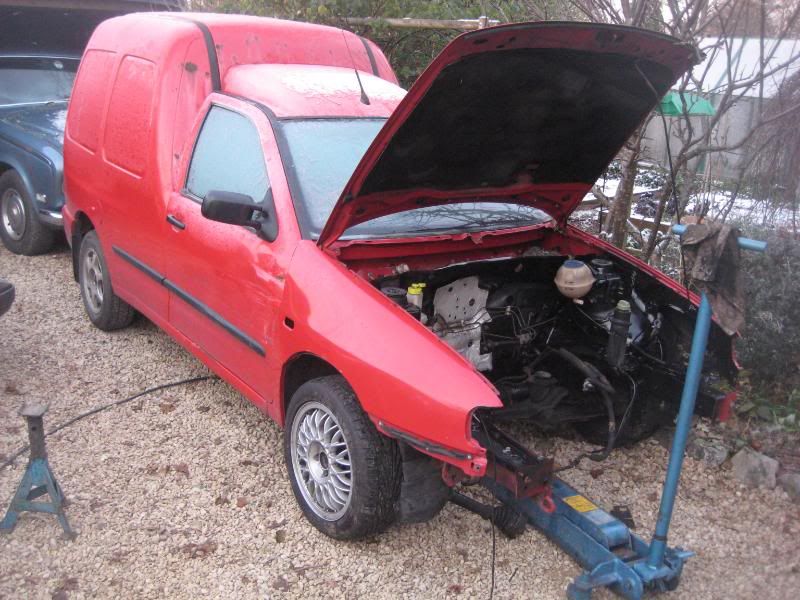

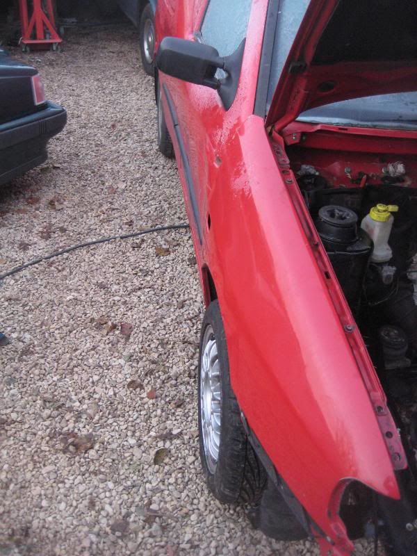

| So dispite being really ill, i braved the cold this weekend. 1st up i rubbed back the engine bay, ground off a few 'unnessesary' things to make it look cleaner, and gave it a coat of gloss black as it would be easier to touch in if i scratched it fitting the engine in. Unfortunately one half went on really nicely, but the other half reacted badly, so will need rubbing back again and repainting. Re-fitted the adjustable steering coloumn. Also discovered that after i had fitted the VR6 clutch pedal, it wasnt that great, so i removed it, and rewelded a bracket on for the clutch master cylinder as it was angled wrong to start with. I planned on using the Caddy subframe, wishbones, etc and just swapping over the VR6 hubs and brakes, but i found out the hardway you cant do this.... The VR6 subframe is identical to the Caddy one, but the Trackrods, driveshafts, and wishbones are about 30mm longer each side. So i ended up just swapping over the entire VR6 subframe, rods, shafts, and bones, complete with Hubs, suspension etc. I now have a widetrack Caddy! I dont know exactly how much wider it is but at a guess 60mm wider than the caddy Next job is to re-do the paint in the bay, and clean / paint the engine before fitting. | |

| Engine in... bonnet doesnt close. EPIC FAIL. lol

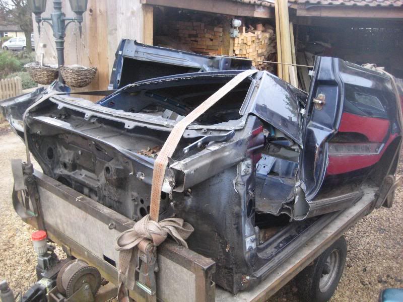

| Well, had a really productive day today, the Mk3 Golf was completely stripped of EVERYTHING. then cut into 3 sections for ease of loading it onto the trailer, went to Frank Howes in Weston and weighed it in. Now there was space in the dry for the Caddy, so i moved it under cover, and started running all the VR6 looms, i stripped all the crappy loom tape from it and used convoluted tubing to cover it all the same way i did the looms in my old Mk2 Golf. But this time i found it so much easier, and was able to make it a lot neater. I even ran the looms inside the Bulkhead instead of infront of it so that in the future IF i decided to Turbo it, the looms would be out of harms way. I didnt take any photos as i ran out of light, but i think it looks so much neater than a standard VR6 engine bay. Overall im happy. | |

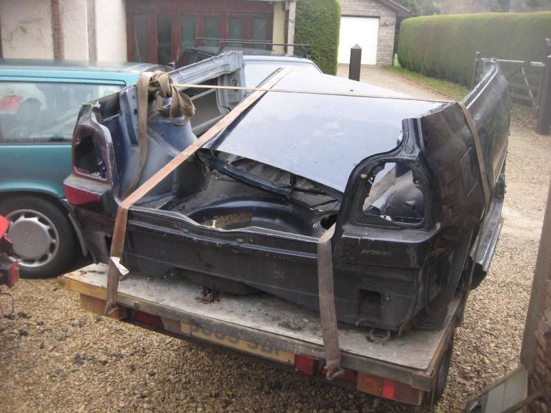

| The remainders of the VR6 was cut up and weighed in. I had a spare V8 engine block laying around so i threw that on the trailer aswell to bump the weight up, still only got £42 though, was a bit gutted about that tbh. Onto the Caddy... Looks a mess at the moment, but i will tidy it all up once its running. Not sure if i should paint the Inlet manifold gloss black, or Mirror polish it like i did with my old mk2? | |
