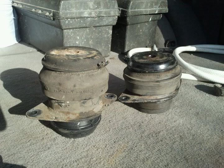

| Considering i had a hangover and didnt start work on the pat van till mid day i got loads done. 1st off i made a sleeve so that i could join the caddy exhaust to the VR6 front section, the van is now so quiet, like literally its silent!! Maybe im getting old but i actually quite like it this way now... Then i made up some new brake lines for the rear, fitted them and bled the rear brakes. Also i managed to get another rear engine mount, i cut the rubber and centre shaft down half an inch, re-tapped the shaft and fitted it to the van replacing the standard VR6 mount. The engine now sits level and more importantly the bonnet closes! Oh and when i started working on the van earlier i noticed one of the rear tyres was flat... so i pumped it up and submerged it in the water but. Found i have a leak where it isnt sitting on the bead properly. So i need to break the bead and re-fit it. | |

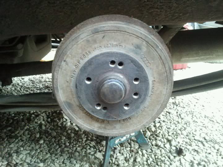

| Well its been a while since i updated this. So heres a quick pic of a standard VR6 rear engine mount, and the one i shortened The top of the engine was painted Gloss black for a cleaner look. I re-drilled and tapped the rear drums from 4x100 - 5x100 PCD. The Van then went for MOT and failed on an anti-roll bar link, so £15 and 5 mins later it was back in for a re-test and it passed. Well happy! Tax and insurance were sorted and ive been driving it round ever since. No problems at all with the engine 'yet' but the wheels were catching the arches really badly when i hit a bump. So to solve this im in the process of making some wider arches... | |

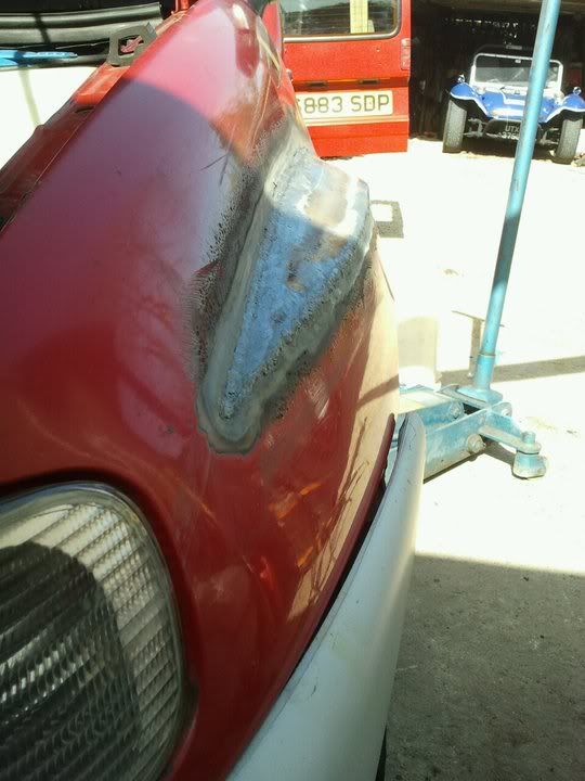

| I had a few issues with the Mig welder burning more holes in the wing, so ended up just spot welding it, then using the gas welder to seam weld it. Doesnt look too bad considering the state it was in. The wing hardly warped too which means i could shape it really well using hammer and dolly so when i come to skim it in glass and filler i shouldnt need much. I have ground it back and cleaned it up (no pics yet) and it looks so much better. Consider ive never gas welded before i think i did alright. Need to do the other sde now before doing the filling. | |

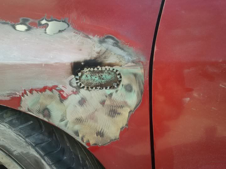

| Side repeater holes..... .....gone! | |
