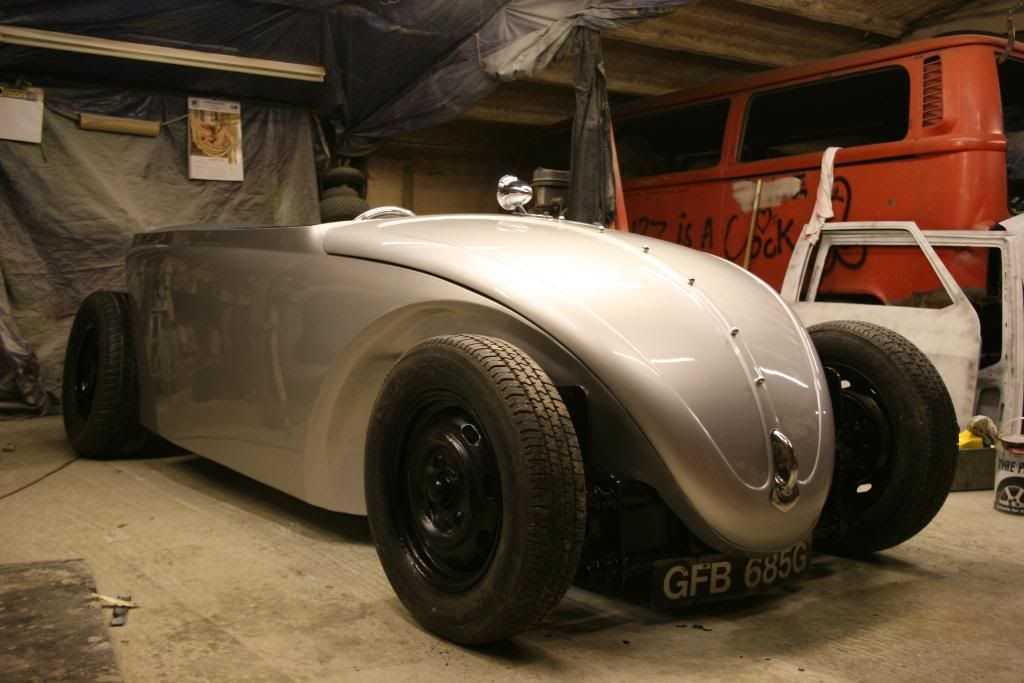

What started out as a workshop project a little over a year ago for a customer, turned the ugly duckling of a paris convertible which
resembled a sieve into what you see now.
Originally,the customer wanted something very different to what you see here, but when he
ran out of money, enthusiasm and the lack of a driving licence, we bought what was left off him and did our own thing….

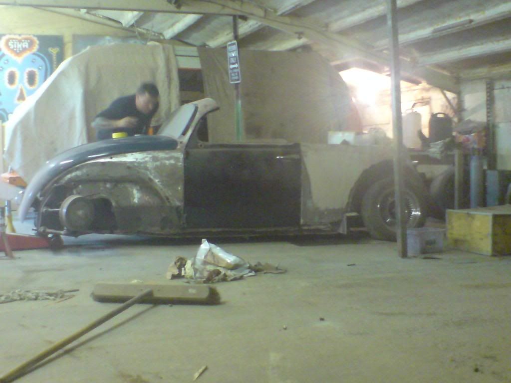

Starting from day 1, the shell was stripped, body split from pan and anything that was
too far gone or just too damn ugly was rehomed in the skip.. so that left just
the body and what remained of the pan….. which to be honest wasn’t much!
Literally the whole interior, roof, tank, wings, brakes, electrics and engine
were all scrap!

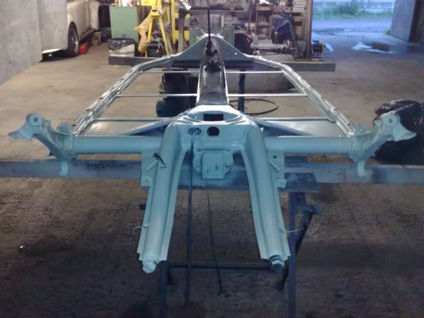

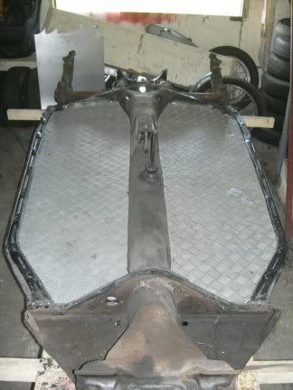

First to be shown some “love” was the pan. This was painstakingly stripped, cut and fettled. New ally halves were constructed by hand with new strengthening beams and framework throughout. The customers intention was to always build it as a rod, but apart from a couple of magazine pics and a few chats over a cup of tea it was pretty much left in our hands.

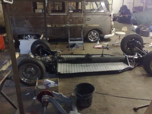

Next up was a new Bay Area Rods beam extension which after a bit of head scratching and some more “love” eventually fitted! The original beam was then replaced and later swapped for a 4” narrowed item when one arose.
A replacement gearbox was sought and after brand new brakes were fitted all roundthen pan was nearly finished, and rolling…

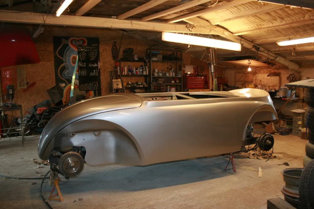

So the body was attacked!

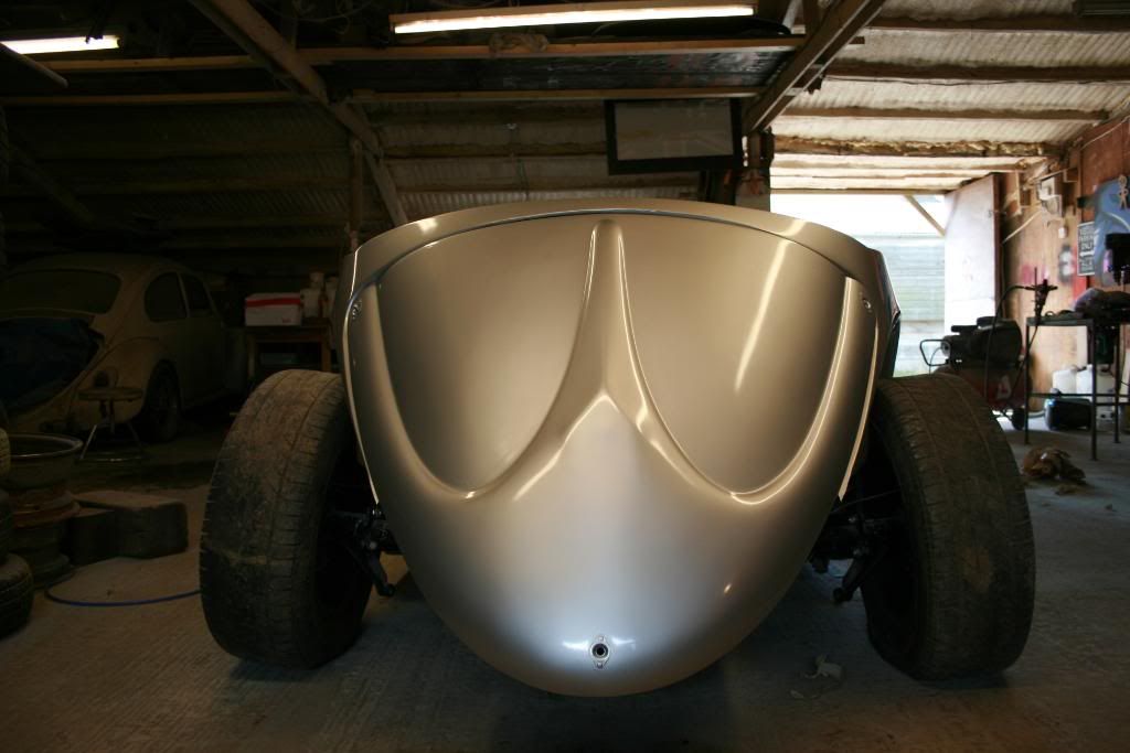

First off, the windscreen was scrapped, and replaced with…erm… nothing! No windscreen = no need for washers or wipers. The body was smoothed and tidied between other jobs. Next the long bonnet was attached and new front end constructed by hand to accommodate the new length but still retain the “early” look.
Inner wings were extended to match and the filler cap removed and smoothed to give it at cleaner lines… Looking under the bonnet, you wont find a fuel tank, its moved and replaced with something a little more individual!
We didn’t see the need for doors anymore, so these were cut, shaped and welded closed to allow for smoother lines and the obligatory Dukes of Hazzard entry/exit! With the addition of the W decklid, the rough draft of the exterior was complete and once reunited with the new pan we could see where we were going.

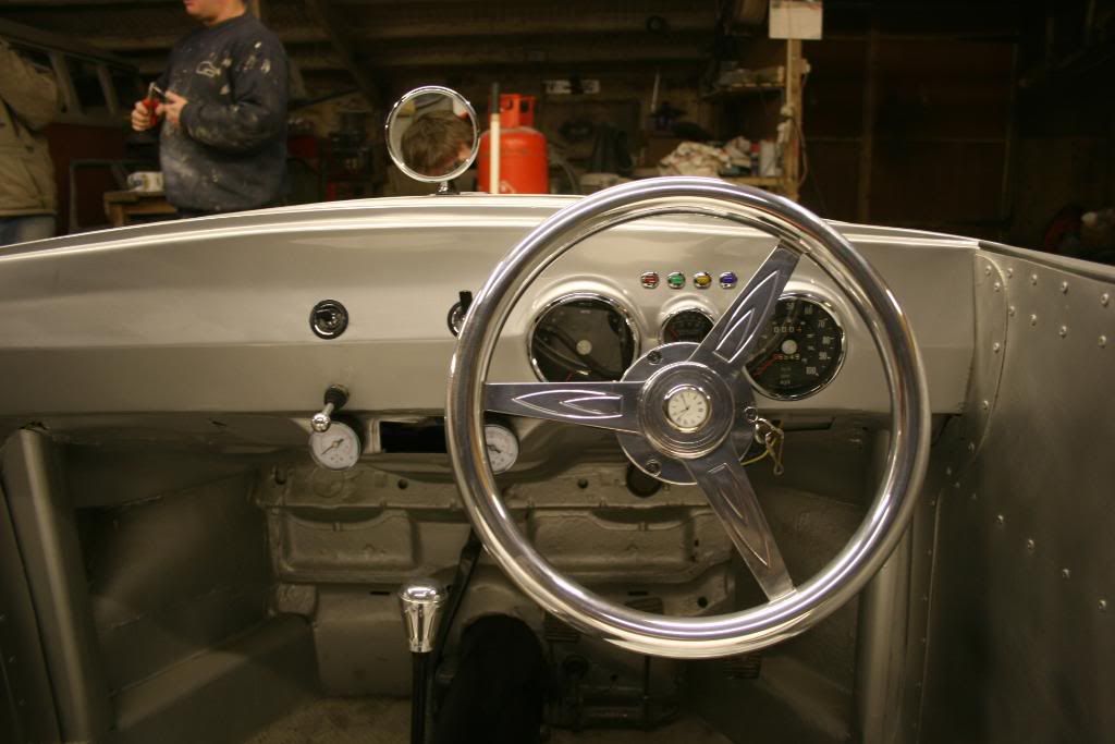

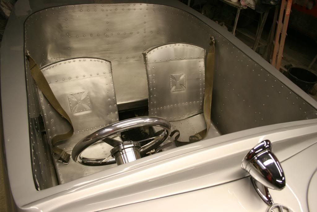

Custom ally seats we’re made inhouse and the interior completely tubbed with ally, a new custom/retro dashboard was grafted in (10 points for whoever can spot where it came from!) and completed with a custom ally steering wheel with a clock mounted in the centre… The ally theme continues under the bonnet where you’ll now find the air tank!

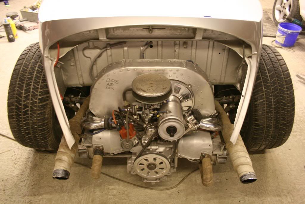

Lastly was the engine… only one way to go with this theme.. 1641 and LOUD!!
The engine was gone through and new custom pipes made and wrapped and fan shroud “retrimmed” to match the interior theme.. take a look!!
