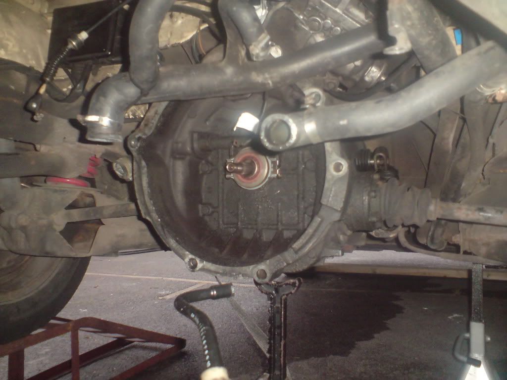

T3 1.6D to 1.9TD convertion Allywatersystemdisconectedfrom1600D
Then I disconnected the water system from the engine.
Removed all the bolts holding the gearbox to the engine.

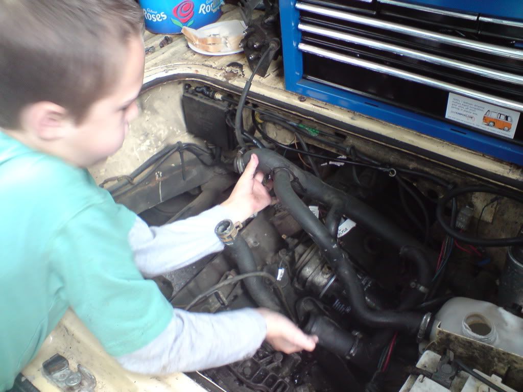

T3 1.6D to 1.9TD convertion AllyHarryremovingenginmountbolts
Then Harry removed the engine mount nuts and bolts with some help.

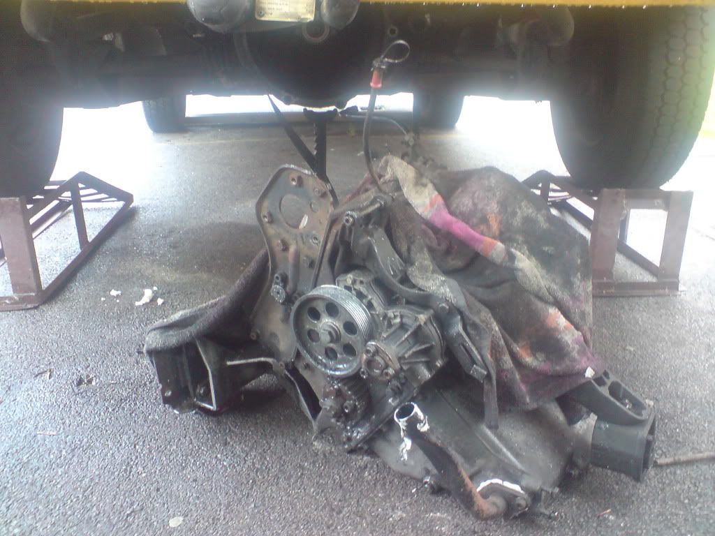

With a trolley jack supporting the engine from underneath I was able to separate the engine and gearbox and lower it to the floor.
T3 1.6D to 1.9TD convertion Ally1600Donthedeck
T3 1.6D to 1.9TD convertion Allyenginebay-engine
