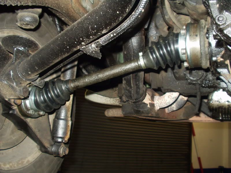

New cv boots fitted to both driveshafts
Bay Resto PA080111

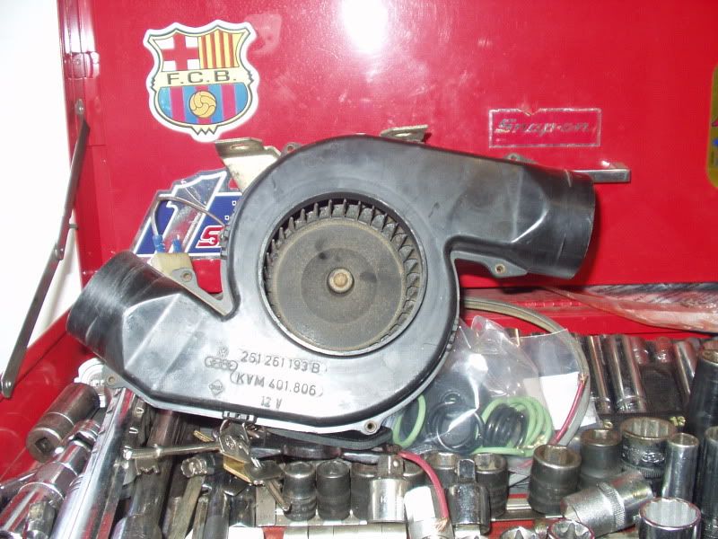

first thing i noticed was the blower was missing
Bay Resto PA080105
so i got this off flea bay for £30
Bay Resto PA080117

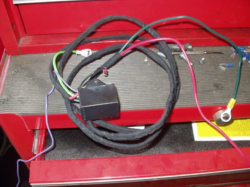

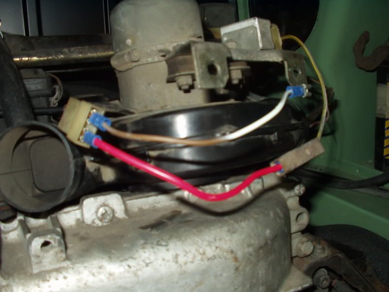

i had to make a small loom from the blower to the relay as it was missing
Bay Resto PA080118

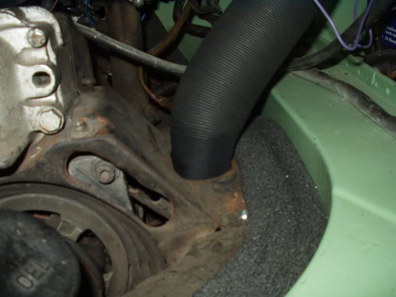

then just bolt it all up and fit the air hoses
Bay Resto PA080119
the rubber seals where the hoses go throught the tinware are long gone so i put some fabric tape around the bottom edge until the seals arrive
Bay Resto PA080120

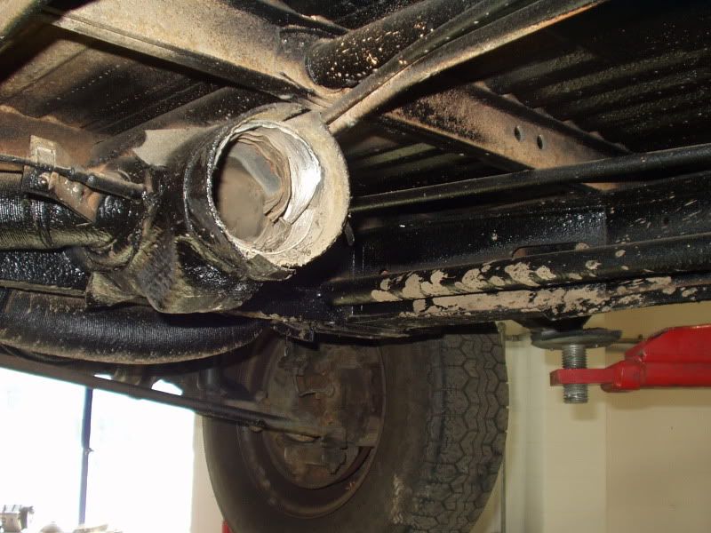

so now the blower is fitted, i rigged it to run constantly. still no air coming out of the vents though.
porbably because of this...
Knackered o/s heat exchanger
Bay Resto PA080112
rotten heater pipes
Bay Resto PA080114
Bay Resto PA080115
Bay Resto PA080116

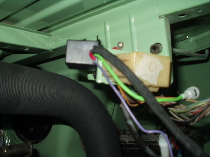

a mate of mine gave me a Ring split charge relay f.o.c. so as i am waiting parts for the heater i thought i would fit the split charge.
Bay Resto PA080121
after deciding where to mount the relay and battery i loomed the wire for the 2nd battery and 12v engine running live
Bay Resto PA080122
fitted the relay by the diagnostic socket
Bay Resto PA080123
connected the fused light green to the original battery, the purple trigger wire to the blower fan engine running live, black to earth then cable tied the newly loomed wires to the existing wiring
Bay Resto PA080124
then tucked the wiring looms back up above the engine lid.

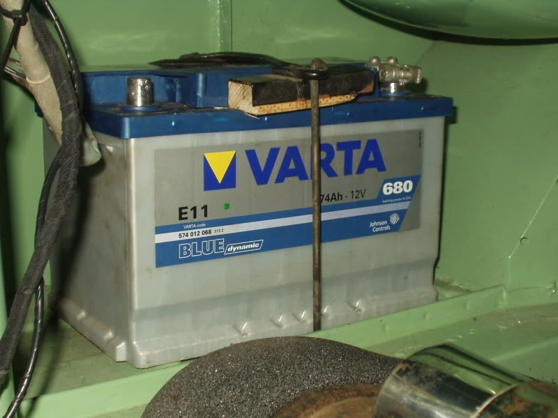

i found a battery, some terminals and a mounting bracket so i fitted them opposite the original battery. (the block of wood on the battery clamp is temporay till i shorten the clamp)
Bay Resto PA080125
Split charge relay, battery and fittings for a grand total....
of NOTHING!!!

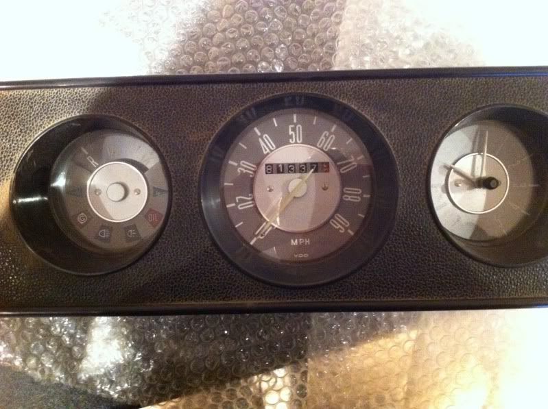

my new parts arrived today
Bay Resto IMG_0176
it has chrome shiny bits on the fascia and a working clock!

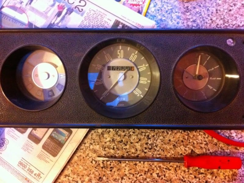

the only problem was the mileage was more than on mine. i know mine may have been round the clock a few times but i am on a limited mileage insurance policy.
so....
Bay Resto IMG_0177
out it came
mileage adjusted
Bay Resto IMG_0178
and refitted
Bay Resto IMG_0179

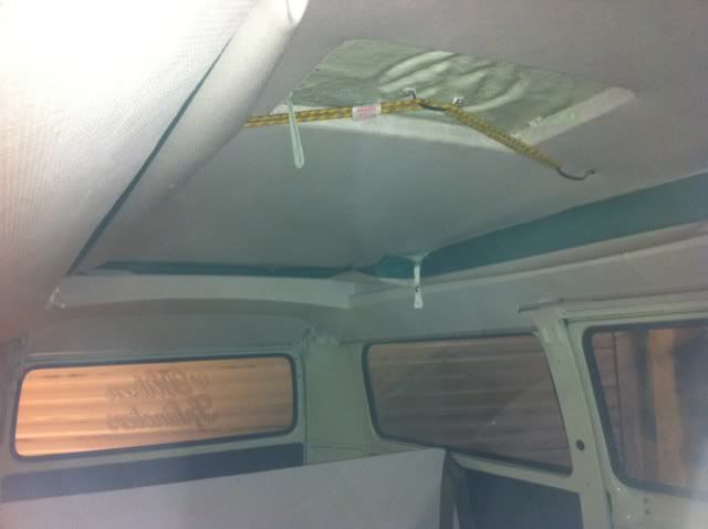

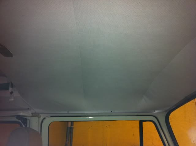

also had a new headlining and pop top canvas done earlier this year, not the best pics but here they are
Bay Resto Headliner2
Bay Resto Headliner1
the bungee has now gone off the skylight and a locking hinge fitted

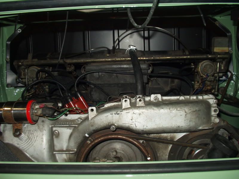

had a slight oil leak earlier this year too
Bay Resto Tube1
Bay Resto Tube2
so out with the push rod tubes
Bay Resto Tube3
removed and engine cleaned off a little
Bay Resto Tube8
Bay Resto Tube9
wire brushed
Bay Resto Tube4
painted
Bay Resto Tube5
fitted
Bay Resto Tube7
Bay Resto Tube6
Bay Resto B9d2fd24
