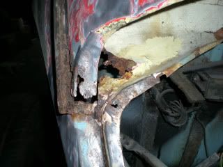

PostSubject: Re: HUGO THE 72   HUGO THE 72 EmptySun Nov 23, 2008 10:24 pm
Usuaul rot here and there.

Looks lovely.why do people do this.......quicker to weld it than stuff it..

PostSubject: Re: HUGO THE 72   HUGO THE 72 EmptySun Nov 23, 2008 10:29 pm
chicken wire and fibreglass ......WHY do people do these types of repair!!!......makes me so cross
looks like you've got the right idea dude ....find all the rot ,and get rid Smile

PostSubject: Re: HUGO THE 72   HUGO THE 72 EmptySun Nov 23, 2008 10:32 pm
Fuck me, that was 'restored' late 80's/early 90's then!!
affraid
It seems the standard of work people put into restos these days are of an infinately higher expectation.
Glad to see you are saving a Big though bud, I reckon 'Fat Chicks' are the next Big Thing.
Old School Cal Looks are cool, I quite like late model proper Lookers....
