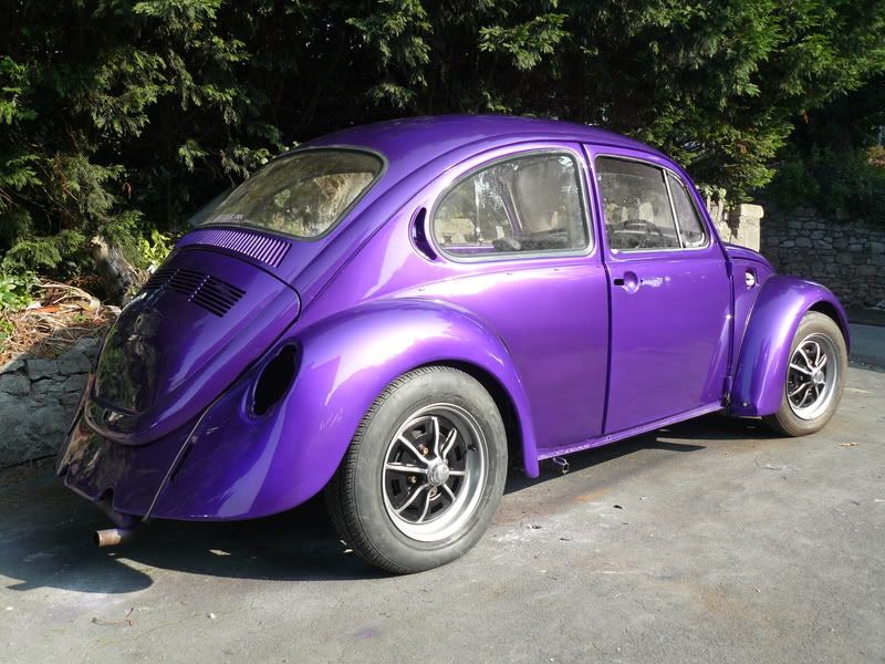

PostSubject: Re: My first beetle Stella...   My first beetle Stella... EmptyMon Sep 22, 2008 8:42 pm
Well all the exterior is painted, next for the interior paintwork to be sorted all lights etc back on and then new headlining, seats, carpets Very Happy
So a sneak preview...
My first beetle Stella... P1020475
Looks better in real life, you'll see it soon enough hopefully Smile
