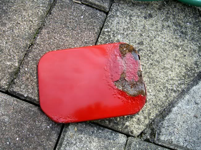

I also started on rerusting him! First up was the filler flap - the paint had started to come off and it had surface rust and just looked terrible!
Meet Foxy the Polo! PIC_0045yu

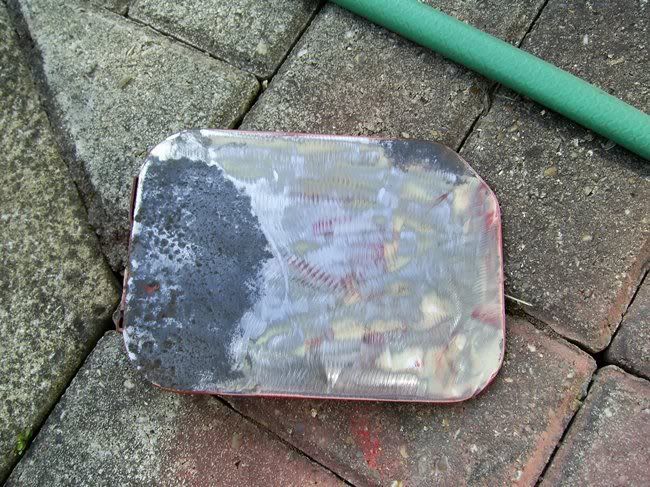

A minute of so with the ankle grinder and sanding disk later:
Meet Foxy the Polo! PIC_0046yu

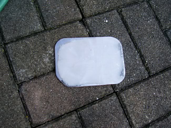

A light skim of filler, sanded down:
Meet Foxy the Polo! PIC_0049yu

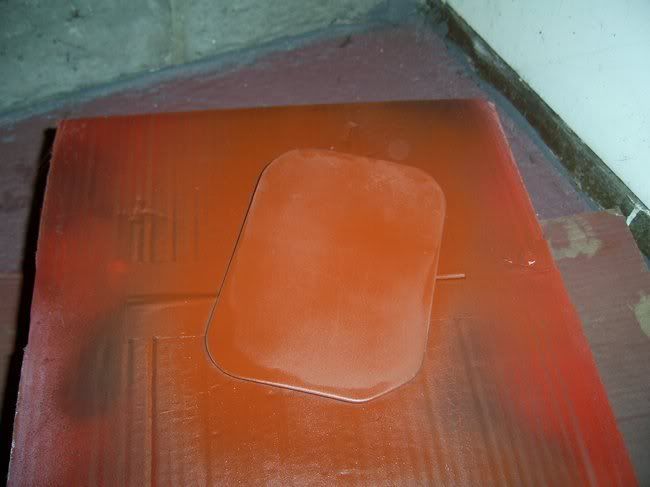

Bit of primer:
Meet Foxy the Polo! PIC_0050yu

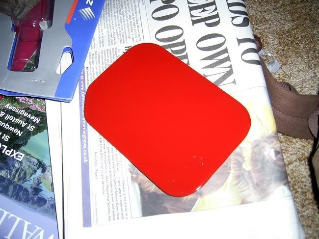

And some Tornado Red:
Meet Foxy the Polo! PIC_0056yu
Shibby! I shall fit it tomorrow when it's fully dried.

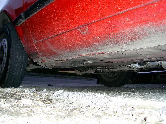

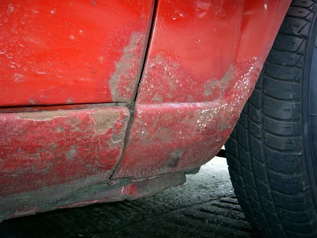

After fitting the plugs, I felt brave enough to have a peek at the sills... after seeing the crusty (although not holed, just bad surface rust) wings, I was expecting a patched mess, and probably needing a couple more for his next MOT.....
Meet Foxy the Polo! PIC_0051yu
Meet Foxy the Polo! PIC_0052yu
Meet Foxy the Polo! PIC_0053yu
Meet Foxy the Polo! PIC_0054yu
Meet Foxy the Polo! PIC_0055yu
What a pleasant suprise! He's as solid as a rock! With no welding been done previously and needing none as far as I can see! There's some bubbly bits on the higher bits of the sills under the doors etc, but I gave them a good poke and there's no holes

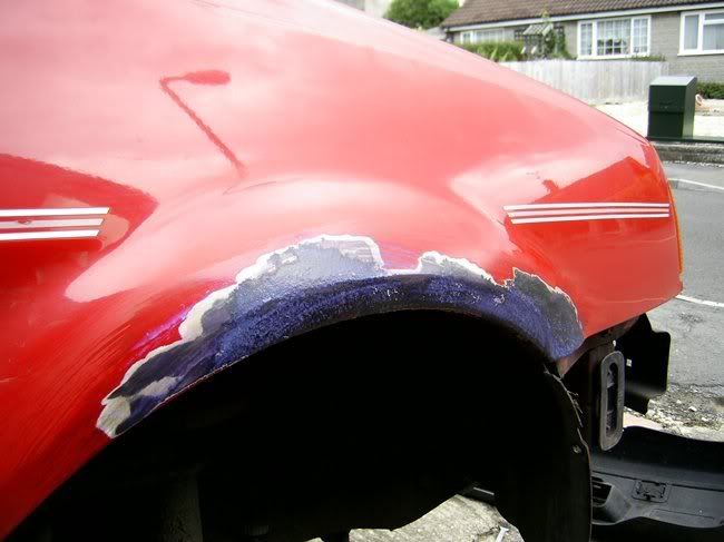

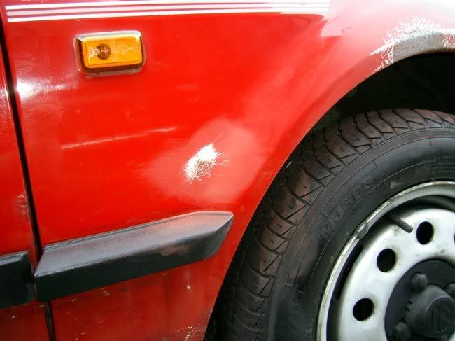

Thought I'd start on sanding the bubbles down on his front wing:
Meet Foxy the Polo! PIC_0099yu
This is all very much the same - looks worse than it is:
Meet Foxy the Polo! PIC_0098yu
Meet Foxy the Polo! PIC_0097yu
As you can see, it's just bad surface rust. There's no holes, just lots of bubbles and paint chipping off. I'll get the flappy sanding disk on the angle grinder on it tomorrow - that'll sort it!

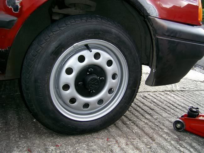

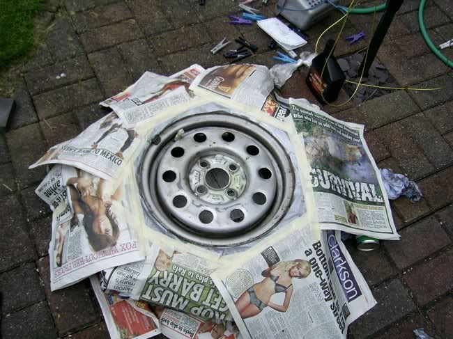

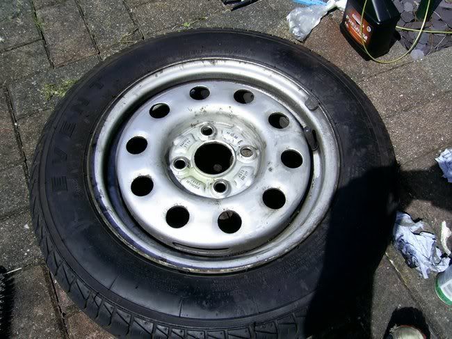

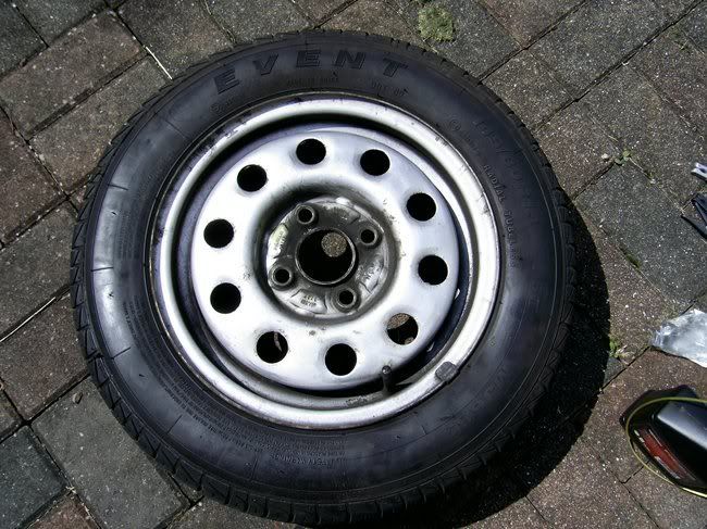

I've been busy again! thought I'd take the wheels off to give them a quick tidy up.
I've done one so far. As it was:
Meet Foxy the Polo! PIC_0110yu
After attacking it with brake cleaner - looking better already!
Meet Foxy the Polo! PIC_0112yu

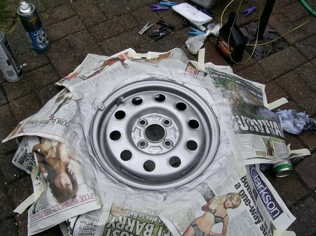

Sanded and masked up, then cleaned with panel wipe:
Meet Foxy the Polo! PIC_0113yu
And first coat of paint:
Meet Foxy the Polo! PIC_0114yu
Meet Foxy the Polo! Empty
PostSubject: Re: Meet Foxy the Polo!   Meet Foxy the Polo! EmptyThu Jun 05, 2008 5:15 pm

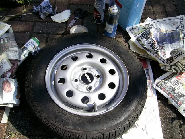

Added some laquer and took the masking off:
Meet Foxy the Polo! PIC_0115yu

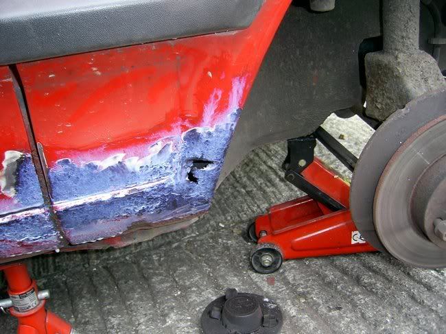

Then treated it:
Meet Foxy the Polo! PIC_0116yu
Then found this Sad undecided if I should try and weld a patch in or just get a new wing - they're only £27 so I might do that!
Meet Foxy the Polo! PIC_0117yu
