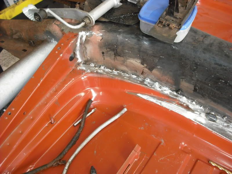

Started back after trashing my face and thought better get back on with the floor pan.
got the o/s/ floor pan in, all the pedal mounts and brakets.
tacked in the n/s/floor pan, as want to try the body on to make sure it all fits before fully welding in the n/s/pan.
all pans plug welded and then welds ground down.
once other pan is in off to get blasted to clean up the underneath of the spine and rear horns.

PostSubject: Re: "The Joker 67" Bug resto    "The Joker 67"  Bug resto  - Page 4 EmptySat May 09, 2009 7:23 pm
Looks good! What's the fit of the pans like?

PostSubject: Re: "The Joker 67" Bug resto    "The Joker 67"  Bug resto  - Page 4 EmptySun May 10, 2009 8:48 am
the pans fit pretty good,got to move seat runner on n/s pan as welded in wrong place.
but they are loads better than the igp pans i fitted the first time, due to fit and thickness of the metal.
would have liked to fit the grey pans but at £270-00 per side seems a bit much to me.

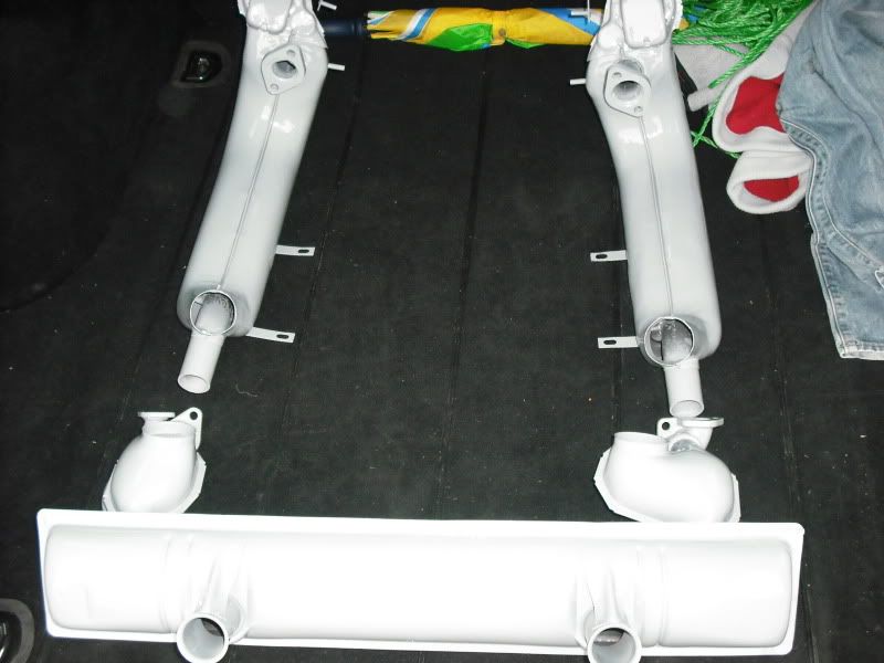

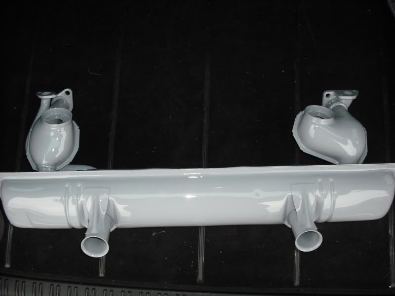

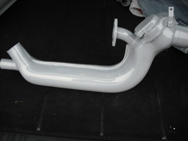

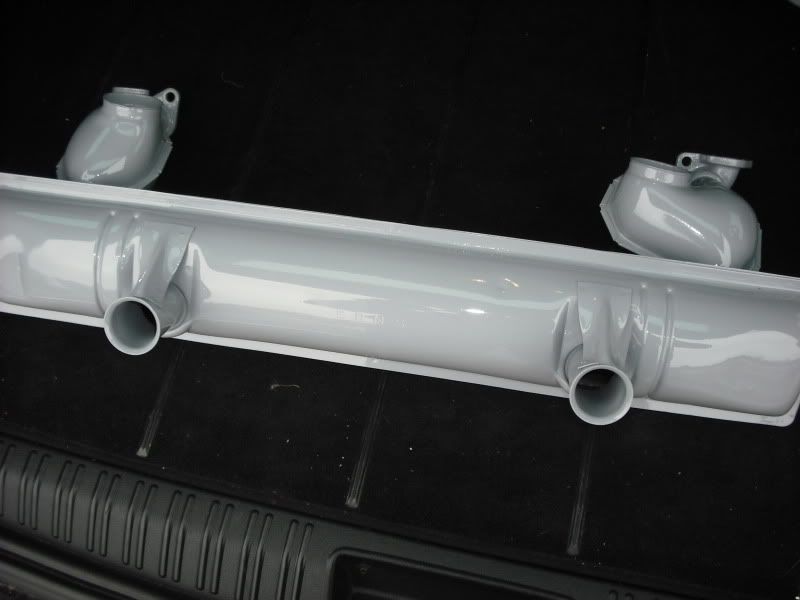

PostSubject: Re: "The Joker 67" Bug resto    "The Joker 67"  Bug resto  - Page 4 EmptyWed May 13, 2009 1:01 pm
out the unit last night, with gungey, got the front inspection cover hole converted, as the new framehead came with a round hole and 67 was a rectangle hole, so cut old one out and graffted into new frame head.
picked up my exhaust from argos racing cycles today as they stove enamalled the heat excangers and exhaust box.
the enamal should be good for a few hundred degrees, they said it won't burn off.
nice and shiny now in grey.

PostSubject: Re: "The Joker 67" Bug resto    "The Joker 67"  Bug resto  - Page 4 EmptyWed May 13, 2009 1:16 pm
SWEEEET! Cool
PostSubject: Re: "The Joker 67" Bug resto    "The Joker 67"  Bug resto  - Page 4 EmptyWed May 13, 2009 2:13 pm
WOW, they look great
PostSubject: Re: "The Joker 67" Bug resto    "The Joker 67"  Bug resto  - Page 4 EmptyWed May 13, 2009 2:23 pm
I've just done a little dribble!! Embarassed
