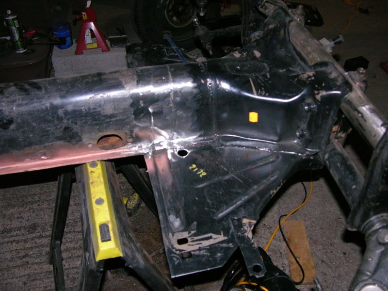

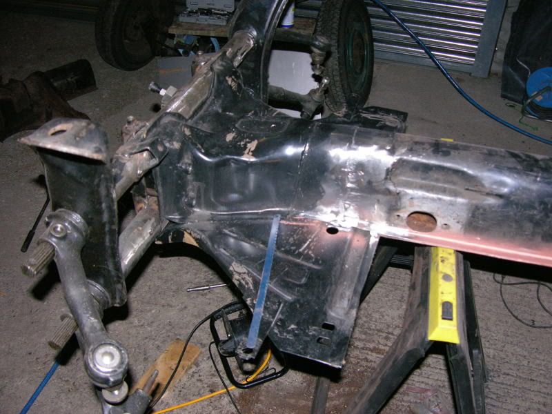

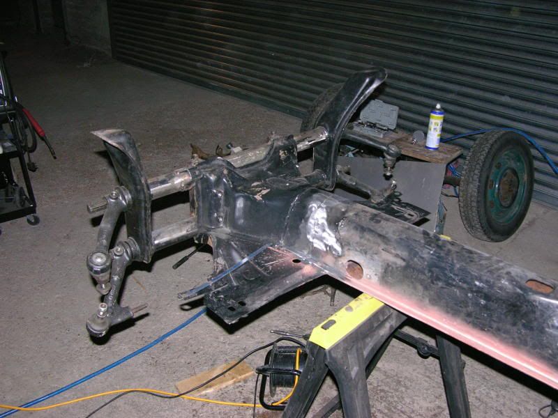

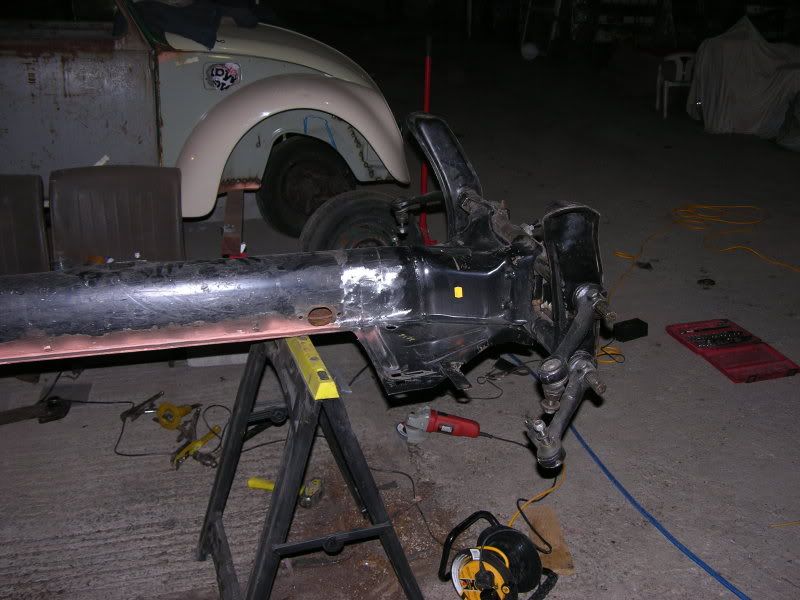

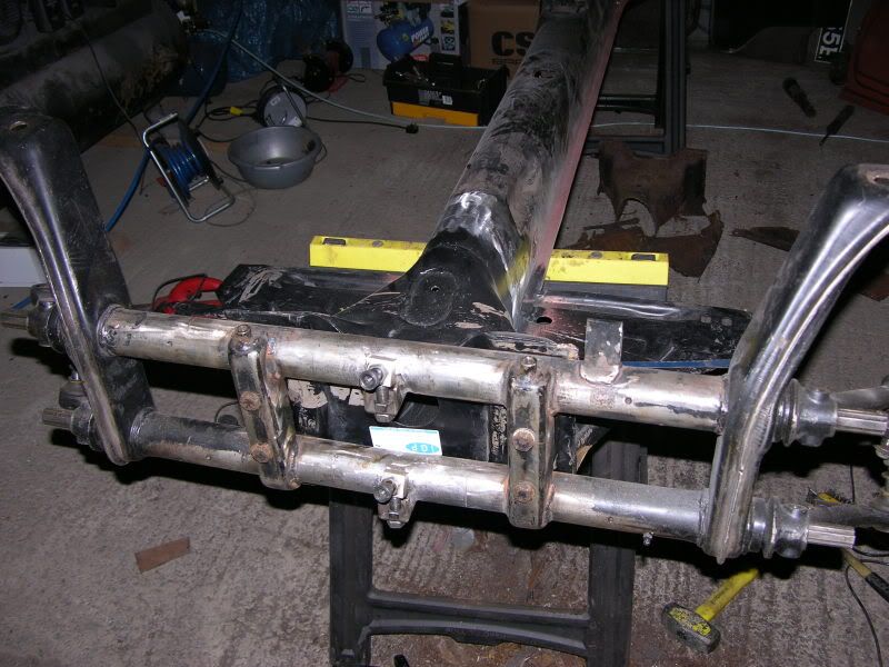

Right have not updated for a couple of weeks, been doing some of those jobs which dont seem worth mentioning. Grinding welds etc.
I started to get the floor pan fully stripped, and had previously fitted some igp floor pans which are total rubbish.
I was decided i would remove them and replace them with heavy duty pans.
Did look at the csp ones, but at £260-00 per side a bit too expensive.
so bought some heritage heavy duty ones.
also cut the frame head off as completly rusty, once aligned i sleeved the tunnel and plug welded the sleeve inside tunnel.
then once aligned i seem welded the frame head on.
checked beam alignment with rear and only 2mm differance between sides, which is good as i have seen upto 10mm diff on some new cars.
also the levals on spirit leval are equal. so nice and straight.
