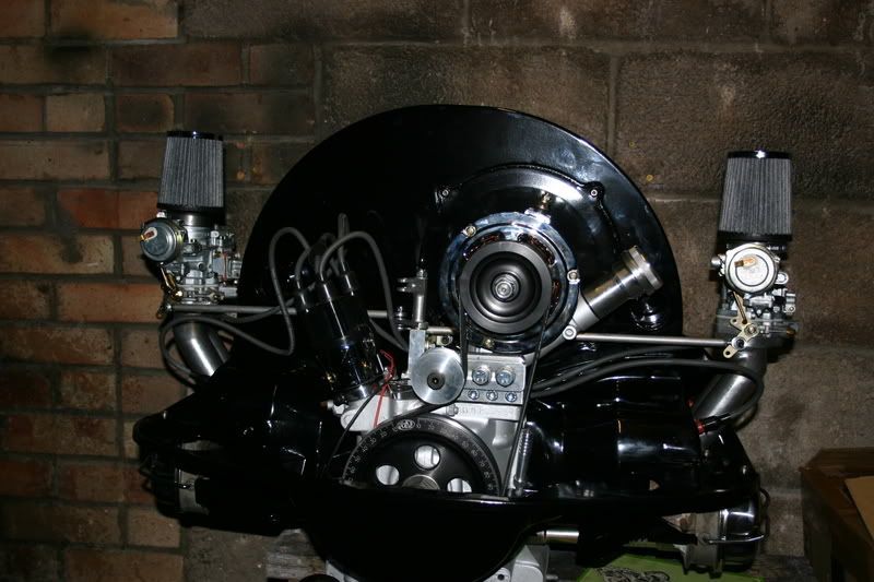

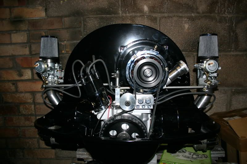

also been working on my engine, standard 1600cc , with scat carb kit 009 with pertronix, new alt, and tin all powdercoated, some of it new and some old, had this coated at swiftco, good people to deal with.
new standard exhaust and heat exchangers, scat valve covers, scat serp belt kit,fuel pump blok off, billet distributor clamp, stainless t-bolt alt strap, scat tin kit, billet oil stick, scat oil filler, and scat sump plate.
pics are a bit dark as taken in my little single garage.

Sweet looking engine dude "The Joker 67"  Bug resto  - Page 2 Hangloos

Top Top work dude ......really jealous of you skills.....you deserve a top motor for sure after this Cool .......
can't believe you use swiftco tho' .......haven't you heard the rumours ?? lol!

What HT leads are you running ....looks like you can bend them to any shape?
they are bosch leads, i just chucked them on at the mo, they seem too long for no 3&4 cyl's.
they are bendy though Laughing

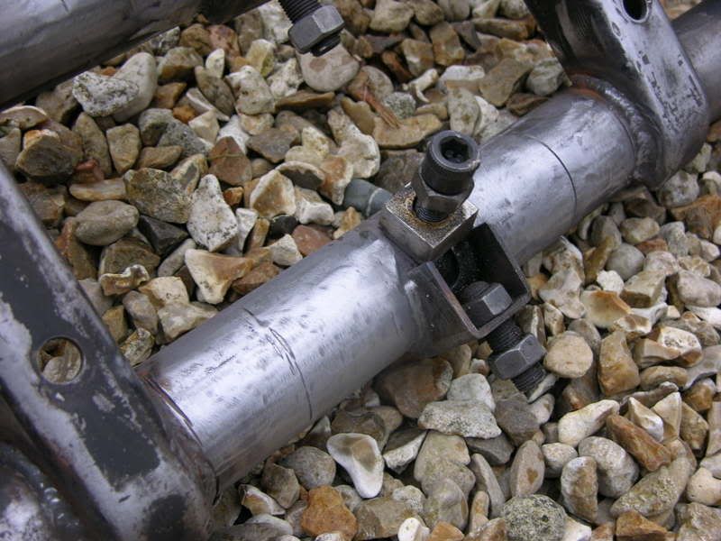

I have been quite busy over last few days, narrowed the front beam 4" , by chopping 6" out the middle, adding 2 sway aways, and re-locating beam mounting brackets to correct position, , converting damper mount from l/h, drive to r/h drive. Beam has standard bearings fitted so no urethane bushes.
Now off to get powder coated with other bits.

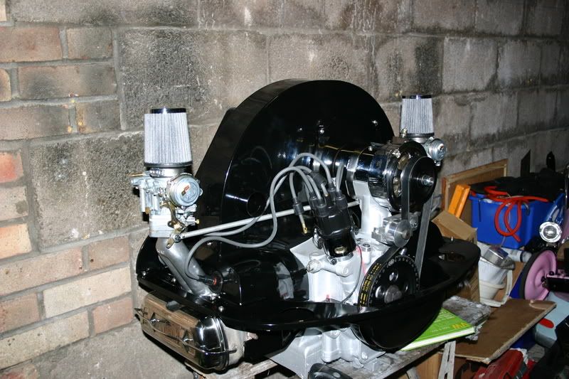

thought i would try to take some more of the engine a i was messing in the garage, as could not go outside as it was raining.

twin carbs with chokes .....thats gonna run real sweet ....what advantages do the serpentine belt system give?

less pressure on the bearings on the alt, as more area of contact with v-belt compared to a standard belt.
