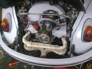

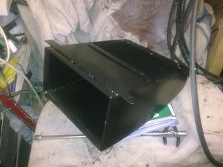

Engine going back in tommorow! Hurrah! Done a few little jobs on it recently, spraying wing mirror etc.
Check my cooler scoop out, bloody over engineered, but the external oil cooler fits in it as snug as a bug!

Project Back to '91! - Page 2 Image077
Its In! Very Happy Very Happy Very Happy Very Happy Very Happy Very Happy Very Happy

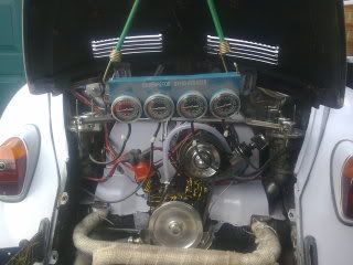

Had a half day tuesday to finish a few things off, like tune it, balance the carbs etc... MOT on the 29th, just need to fit the wing mirror and give it a bloody good clean!
Project Back to '91! - Page 2 Image048
Mmmmmmm, Balancing tool!

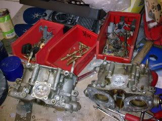

Haven't really driven the car much since the mot, been a bit pissed off with the way that it's been running, Wife bought me the dellorto book for my b'day, so i've been able to sort out the jet sizes etc, lets just say that they were miles out. i decided to strip the carbs down, and rebuild them with the right bits
Project Back to '91! - Page 2 Image014
Not only that, They were also full of crap!
Project Back to '91! - Page 2 Image015
New venturis came in the post this morning from VZI, just waiting for the jets! Very Happy

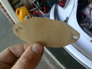

Match porting the inlet manifolds...
1
Project Back to '91! - Page 2 Image019
Mark out the pattern of the port..
2
Project Back to '91! - Page 2 Image020
Then when thats done, hold it next to the inlet manifold, realise that they are only a knats nudger out, and give up!

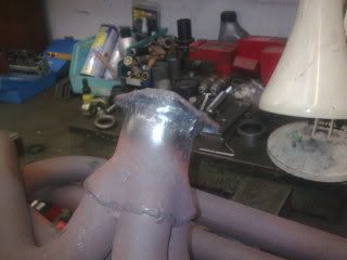

got the carbs back on, set up right and turned it over, lovely sounding motor now, apart from the noise from the exhuast, turns out...
Project Back to '91! - Page 2 Image004
Bloody bugpack exhaust! half hour later....
Project Back to '91! - Page 2 Image006
All welded up!
