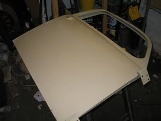

Sloped off from work early to prep a door that I've had for a year, ended up de-trimming the whole car!
Project Back to '91! IMG_0834
Mmmmmm, Prepped door, Tasty

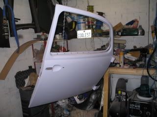

dechroming went well, not bad for proper job filler and primer, and a rattle can match from panel shop!
Project Back to '91! IMG_0837
Unfortunatley, when i sprayed the door, the gun splattered like heck, and its got more runs in it than the curry gardens toilet, i'll be sanding it back for hours.
Project Back to '91! IMG_0838
Never mind, thats the joy of vw's!

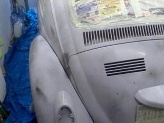

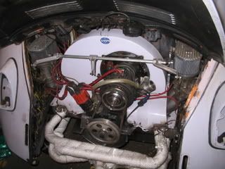

Window Issue resolved! lots of lining up, combined with the fact my new window glass is a mill thicker than my old glass, extra weight plus tight channels equals hassle! going great now, dropped the engine out and replaced the clutch and the oil seal that some pr1ck had put in the wrong way round, while the engine was out, i gave the engine a bloody good clean to get all the sodding dry powder off that i sprayed on it to put the fire out, changed the J tubes, and wrapped the exhaust in thermal wrap
Project Back to '91! IMG_0840
I also flanged my quality bugpack header so it would fit snug in the tube for the silencers, should help gas flow!
Project Back to '91! IMG_0841

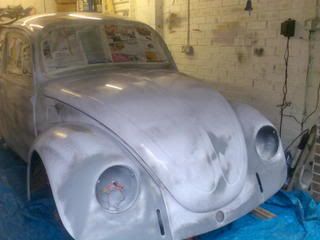

Here's some of it prepped..
Project Back to '91! Image021
And another one.
Project Back to '91! Image011

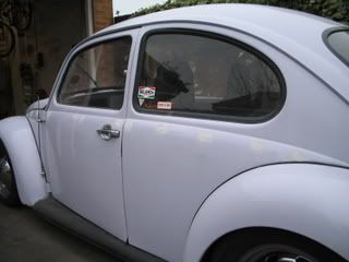

Here's some of it painted, not 100% perfect, I'm going to have to rub some of it down and do it again, but i'll spray them when i paint my bumpers.
Project Back to '91! Image022
Project Back to '91! Image035
Project Back to '91! Image036

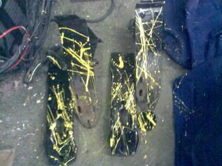

Here's my splatter effect bumper irons!!!!!!!!
Project Back to '91! Image030

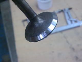

After my engine woes, the extent of my problems are becoming clear, apart from the damaged caused by the foriegn objects (screws, washers!) i had a bent valve and a damaged valve seat, also P*$$ poor compression on 1 & 2, this became clear when i was having the heads looked at in a machine shop, instead of just milling the heads flat like i asked, they decided to remove and re-grind the valves, also, ream the seats smooth again. they are going to cut the heads and case for the new barrels, and drill and tap the case for full flow. as soon as they come back, i'll rebuild the engine, chek the compression ratio, and sort out the valve geometry, it was a bloody mess when i took it apart, both pedastals were spaced out by different amounts on both sides.

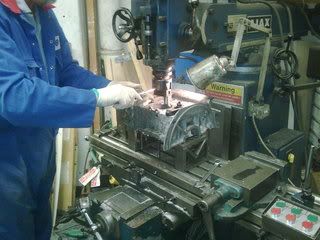

Case being milled out for new barrels
Project Back to '91! Image059
Its so bloody perfect, the guy doing it for me is so flippin' anal about his tolerances!

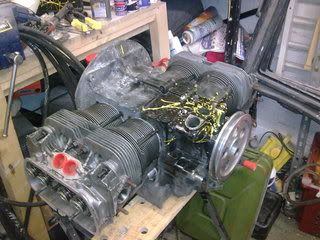

getting there, after doing the parent thing for four weeks, i've pulled my finger out and built most of the engine.
Project Back to '91! Image071
hopefully have it all assembled and in the car by monday night, TRY and have the car on the roads by the end of month!
