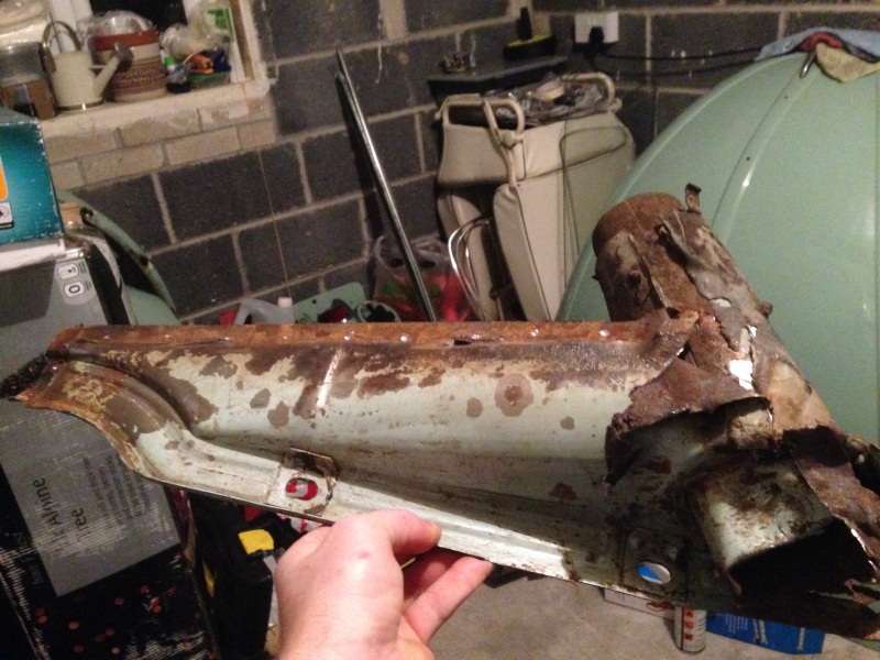

Heres some photos of the removal of the cross member.
The cross member has a large patch to it which had a shocking repair. The sheet metal wasn't primed or treated, just had some weird looking sealant that didn't work as the welds were rusted.

This is the cross member that was removed. The left side up to the heater input was all solid which I would have loved to keep if there was a repair panel that fitted the correct shape but the new ones available which I got from VW Heritage were more square in shape and not finished that great.

Whitebrow's 65 Bug Full Restoration - Page 4 Photo_28
shoes are way to clean !
whitebrow83
Male Number of posts : 126
Registration date : 2013-05-22
Whitebrow's 65 Bug Full Restoration - Page 4 Empty
PostSubject: Re: Whitebrow's 65 Bug Full Restoration   Whitebrow's 65 Bug Full Restoration - Page 4 EmptyThu Nov 28, 2013 3:47 pm
Lol they're the shoes I wear to work. I was too excited to work on the bug and thought changing them would be a waste of time. Very Happy
