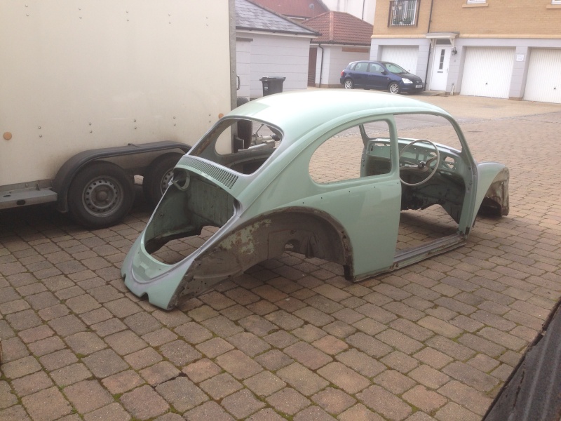

We then carefully removed the body which was solid anyway.
Whitebrow's 65 Bug Full Restoration - Page 6 Photo_54

The welders saw them and said they were solid and i've put the doors back on after the work was done and it all lined up ok.
