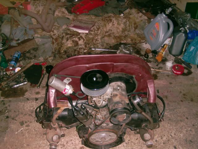

PostSubject: Re: Ruby the 1303 ongoing resto!   Ruby the 1303 ongoing resto! - Page 6 EmptyMon Mar 19, 2007 8:11 pm
well, here goes.....
Ta da my freshen up rebuild 1641 single porter!
No frills & 2 bits of cheap chrome (out of neccessity cos' chrome dont get you home!)
no tarting, back in tommorow so please pray it runs ok! pale
Ruby the 1303 ongoing resto! - Page 6 Funpics499
PS excuse the state of the garage Shocked

PostSubject: Re: Ruby the 1303 ongoing resto!   Ruby the 1303 ongoing resto! - Page 6 EmptyMon Mar 19, 2007 9:29 pm
looking good, so is it a 1641cc?!?!?

PostSubject: Re: Ruby the 1303 ongoing resto!   Ruby the 1303 ongoing resto! - Page 6 EmptyTue Mar 20, 2007 11:25 am
yep!
pulled it out thinking it was a 1300cc, cleaned off the crud on the engine number & found out it was a 1500.
Broke it down, new bearings, full gasket set, new mahle 1641 barrels n pistons added, cleaned it up..................ready to roll....hopefully! pale
Was done on the cheap as a stop-gap cos i want a 1776/1914 by the end of the year but there just aint the cash right now, so if it goes pop i aint gonna cry Laughing

PostSubject: Re: Ruby the 1303 ongoing resto!   Ruby the 1303 ongoing resto! - Page 6 EmptyTue Mar 20, 2007 12:26 pm
Bloody hell Cliff, I thought my garage was a mess, is that a homeless dude asleep behind the engine??
lol! lol!
Ruby the 1303 ongoing resto! - Page 6 Pbucket

PostSubject: Re: Ruby the 1303 ongoing resto!   Ruby the 1303 ongoing resto! - Page 6 EmptyTue Mar 20, 2007 12:29 pm
yeh, his names joe & he gives me £10 a week to kip in a rolled up carpet!!
lol! lol!
Usually not this bad but had bits of bug everywhere so aint no point tidying up till the engine/interiors in.

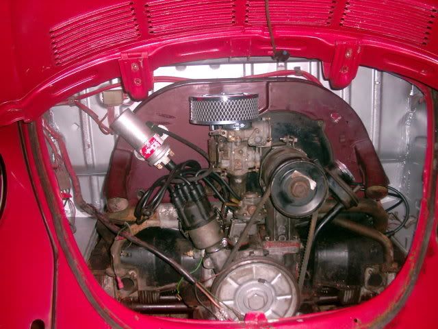

PostSubject: Re: Ruby the 1303 ongoing resto!   Ruby the 1303 ongoing resto! - Page 6 EmptyTue Mar 20, 2007 3:33 pm
that compared to mine is well tidy......fair play dude I have my fingers crossed yhat it runs O.K ,keep us posted as i was wondering how thing's were going afro
PostSubject: Re: Ruby the 1303 ongoing resto!   Ruby the 1303 ongoing resto! - Page 6 EmptyTue Mar 20, 2007 7:02 pm
well, the engines in, engine bay cleaned up n repainted 1st (not sure bout the silver?)
did it on my own again but took considerably longer than the half hour it took to get it out........try 3 times that! pale
Havent run it yet cos the dark outran me before i wired it up & its brass monkey cold out there
Ruby the 1303 ongoing resto! - Page 6 Funpics500
also got no exhaust on till tomorrow cos the econopack needs a lil fettling to fit properly
hope to run it up tomorrow guys Ruby the 1303 ongoing resto! - Page 6 Hangloos

PostSubject: Re: Ruby the 1303 ongoing resto!   Ruby the 1303 ongoing resto! - Page 6 EmptyTue Mar 20, 2007 10:32 pm
Your garage is super tidy dude, I should know, I did it! Rolling Eyes
Looking good Impy, not sure about the silver, I think it is growing on me but I am not convinced Suspect

PostSubject: Re: Ruby the 1303 ongoing resto!   Ruby the 1303 ongoing resto! - Page 6 EmptyWed Mar 21, 2007 9:11 am
Hope she fires bud, fingers and thumbs crossed. I like that silver engine bay, I wasnt sure at first, but it does look good. Smile
PostSubject: Re: Ruby the 1303 ongoing resto!   Ruby the 1303 ongoing resto! - Page 6 EmptyWed Mar 21, 2007 12:16 pm
I quite like your silver firewall, a nice contrast to the red.....
