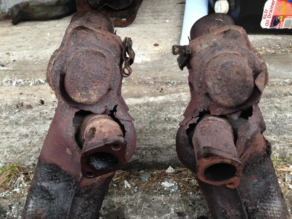

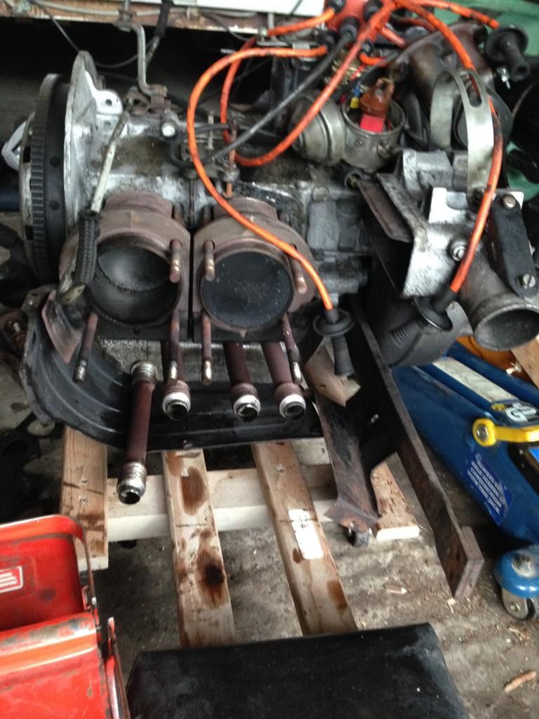

I've been quiet lately, however with a mate from work I pulled the engine last week. It seems like I have the right tinwear, nut that the heat exchangers and thermostat boxes that sit on top of the exhaust collector have seen better days.
Whilst taking it all apart I've found a few rubbish pipes, a couple of splits and a few exhaust blows. Importantly, the heads and barrels all look pretty good. I guess low compression must have been caused by worn rings, so the to do list now includes rings, and pushrod tubes, new seals all round, a new clutch end oil seal, and some new heat exchangers... whilst I'm there it seems rude not to pop on a T3D exhaust for a little rumble Smile
Once the engine is back up I'll look at the oil relief valve, and a csp sump plate with a temp sender...

happy with those...

definitely seen better days!

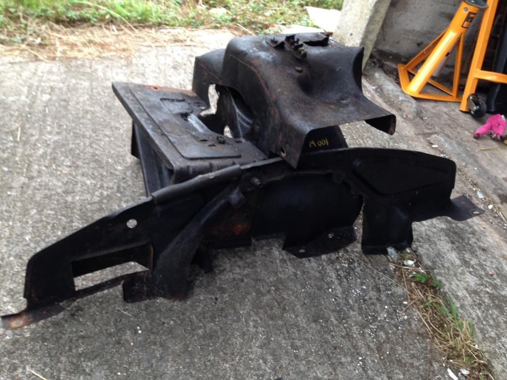

Pile of tinware for cleaning up and painting at work.

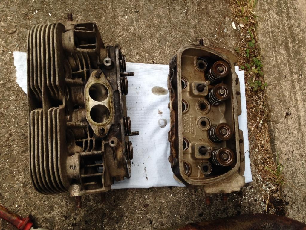

heads to decoke at work and either build up the plug holes with weld and recut or helicoil for now...
