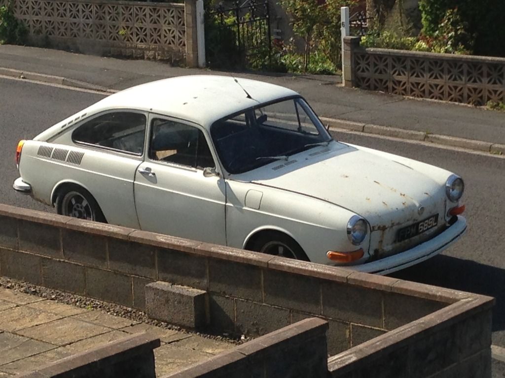

So after expressing an interest in something aircooled, probably a van to camp in or something oddball, Clocky ended up pointing me towards a fasty on the type 3/4 owners club forum. Initially the pics didn't look anything special, a quite tatty white fasty stared back at me, but after a couple of messages to Rachel the owner the story came out. After being restored and shown at bug jam in '90 the fast back had been tucked away as the inevitable work/family took over the owners time, fast foward to six years ago and a very excited young lady was on her way to her first car - a tatty cal look 1776 fasty! Funnily enough the story came full circle, Rachel had the engine rebuilt to a standard 1600 stocker, had some work done on the carbs and sourced an original pipe to keep it on the road and reliable, but work pressures had led her to buy a newer fiat, with flump residing in a lean to in Ilfracombe...
Such is the way with these stories, I'd only gone to have a look - there were other cars I had in mind, rarer, or better condition for the asking price, especially since flump had no second gear and a couple of dribbles from underneath... Long story short, I made an offer and got her for a good enough price, with a car full of spares (my friend Courtney had a back seat and boot full of windscreen, two boots, a gear box and four or five boxes of "come in handy" bits). Elated, I set off for home, ignoring the advice of the previous owner and headed towards Combe Martin for lunch with family. The first problem was trying to find an open petrol station out of tourist season in Devon, the second was hills... Without second gear flump was crawling up some in third and straining in first on others. Help was at hand when a stoned guy in a T4 pulled up, recognised the car and said about wishing he had bought it for his flower shop and offered to tow us as far as yeovil.

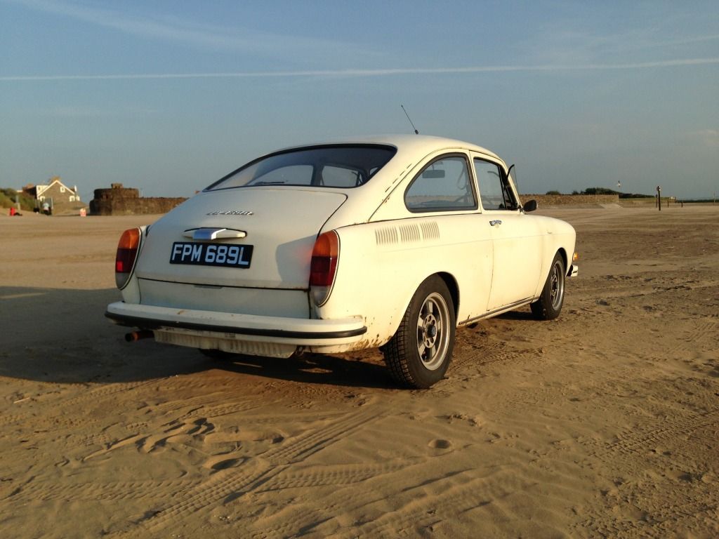

Flump - the '72 late fasty A21782AA-9766-4E8D-BD01-AF62CD29DB25-2589-0000010C97545D3F
Safely home Smile
Flump - the '72 late fasty C8FA7CA9-FC59-4A30-930A-BE1A861D41F9-2228-000000D5886DCC14
And after a good clean a few weeks later... The dribbles were from leaky empi rocker covers that have now sealed up, I have lost a fuel gauge earth from the tank and have a dodgy connection in my oil pressure sender somewhere, and Big Al gave me a hand to time it up correctly.

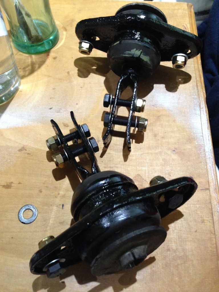

Flump - the '72 late fasty D0BDA421-03DA-40DF-927F-126D1722B43C-2091-0000005A35447ED3
Two good mounts from t3d wirebrushed, two coats of anti corrosive green and an impact resistant top coat plus a wipe of back to black on the rubbers. I must have left the nose mount in the car.

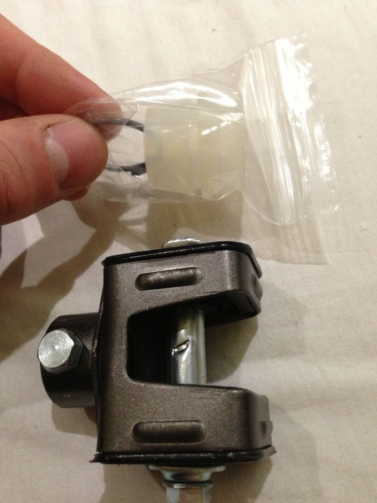

Any tips on doing the shift bushes are welcome... I think I've got the right bits.

PostSubject: Re: Flump - the '72 late fasty   Flump - the '72 late fasty EmptyFri Jun 14, 2013 5:18 pm
not too sure about t3 but when i did my bug ones i pushed the shift bar to the front of the tunnel and tied on a piece of string so i could pull it back into place (remove the plate on the beam) watch the fuel pipe as it gets stuck on it
PostSubject: Re: Flump - the '72 late fasty   Flump - the '72 late fasty EmptyFri Jun 14, 2013 7:04 pm
You have to remove the shift rod from the pan.
1) remove gear stick
2) remove rear seat base and access cover
3) remove spare wheel, spare tray, hole cover in front panel, and plate in frame head of chassis behind beam
4) loosen the shift rod to gearbox link, and remove from car, and then slide shift rod from tunnel through front of car.
5) fit bush in tunnel near gear shift.
6) replace shift rod and grease around bush
7) fit rear shift bush assy and lock wire.
re-fit as reverse of strip.
hope this helps andy

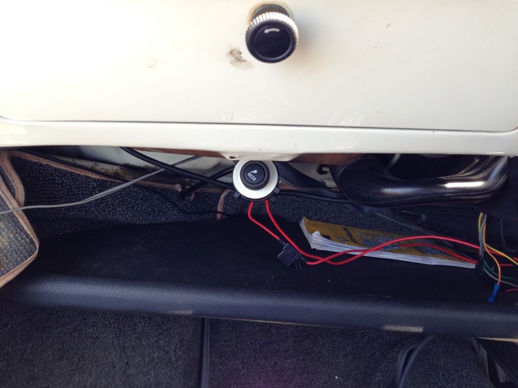

Flump - the '72 late fasty 40776DFA-E13A-4DAA-89BF-37A0DC989838-20715-000003025DC02DAB
It's not the neatest - but one 12v socket, in a housing made from a deodorant lid and some O rings... Inline fused and taken off a switched live. Job possibly jobbed!
I also rationalised the wiring on my shelf and tied it all back after the pic Smile
