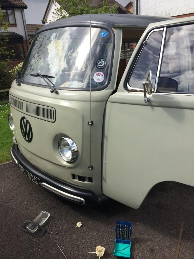

So after starting an internet debate on aerial positions, I've fitted mine.
Maybe should've sorted the stone chips on the front panel first, but couldn't be bothered.

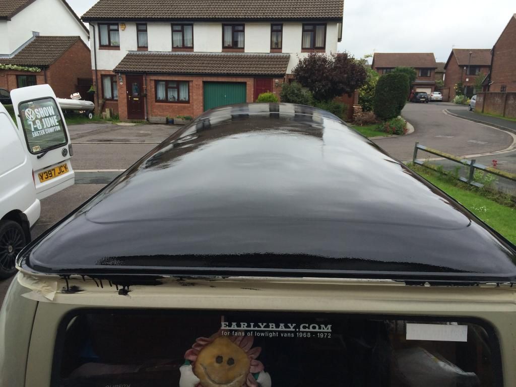

Friday afternoon, finished work early, a bit of cash in my pocket and some mates have text me to say they're in the beer garden.
What do I do, I come home and attack the bus' roof with the grinder and DA.....
5 hours later after finishing with a bit of 400 grit wet and dry.
rusty nail to sow's ear - Page 22 011_zpsfb821127
Never been happy with the paint finish since I did it in the bad weather, and after fitting the ply headliner some of the previous owners filler work had popped out.
Primer coats tomorrow. Smile

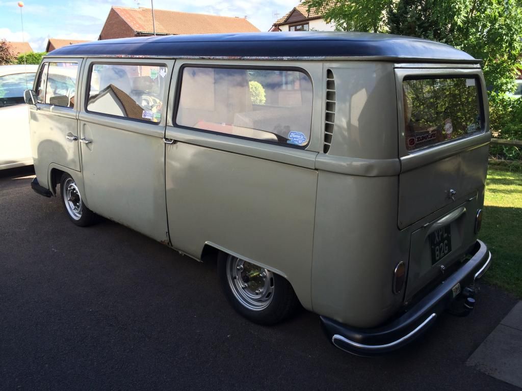

So I spent most of the day sanding back the roof yet again.
It's not dent free, but smoother than a pair of silk knickers and ready for paint. Haven't decided whether it'll be spray or roller applied yet though.

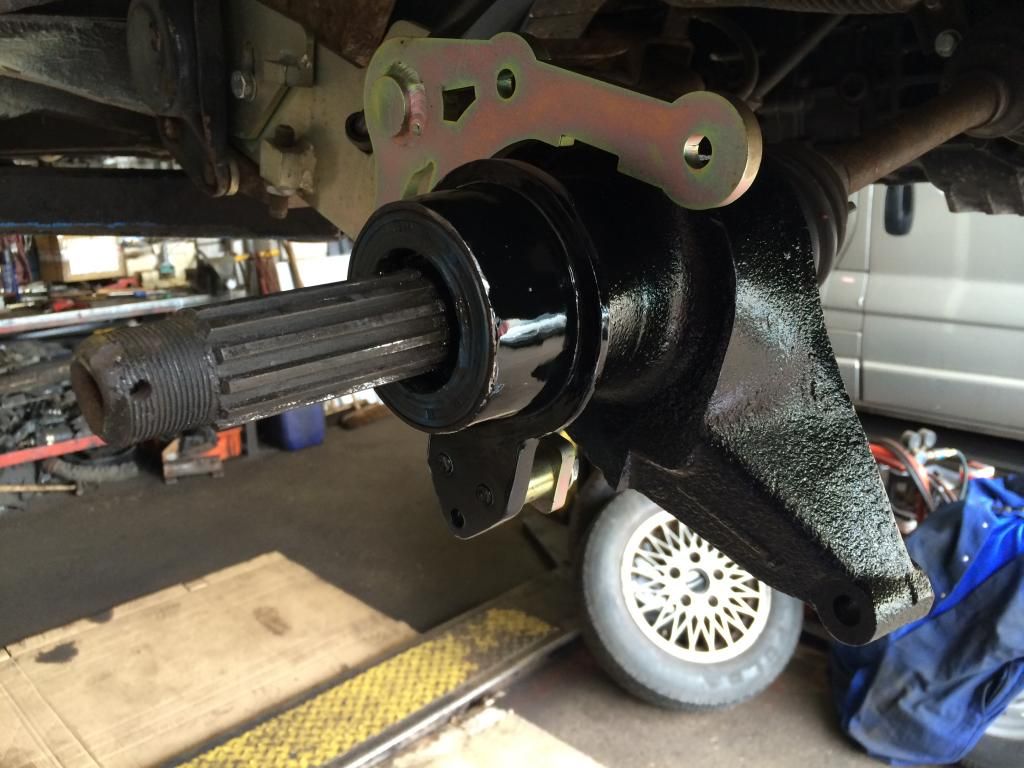

rusty nail to sow's ear - Page 22 005_zpse9db8593
Off-side rear brakes removed and hub assembly bared.
rusty nail to sow's ear - Page 22 006_zps061465ae
First job is to remove the upper back plate mount.
This is the moment of no return, once you've cut this off it's not possible to fit drum brakes again.

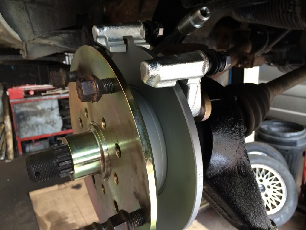

Next job is to attach the calliper carrier mount. This uses the two front hub mounting bolts and the lower back plate mount.
rusty nail to sow's ear - Page 22 022_zps5e226704
rusty nail to sow's ear - Page 22 021_zpsfcb818a3
And then slip on the disc assembly.
rusty nail to sow's ear - Page 22 023_zpsf9a0df9d
rusty nail to sow's ear - Page 22 024_zpsc5f22675
rusty nail to sow's ear - Page 22 025_zpsdf5a5484
rusty nail to sow's ear - Page 22 026_zps6878f8d6

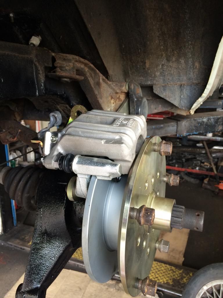

I must admit that it was at this point a number of issues started to arise.
Firstly the instructions supplied are shite, and secondly CE customer service is shite.
Calliper carriers not in correct position.
rusty nail to sow's ear - Page 22 029_zps9219cf78
This is due to the disc assembly not sitting far enough onto the hub shaft.
rusty nail to sow's ear - Page 22 030_zpsf0bac71a

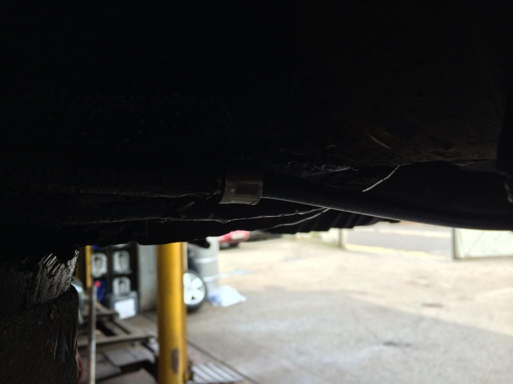

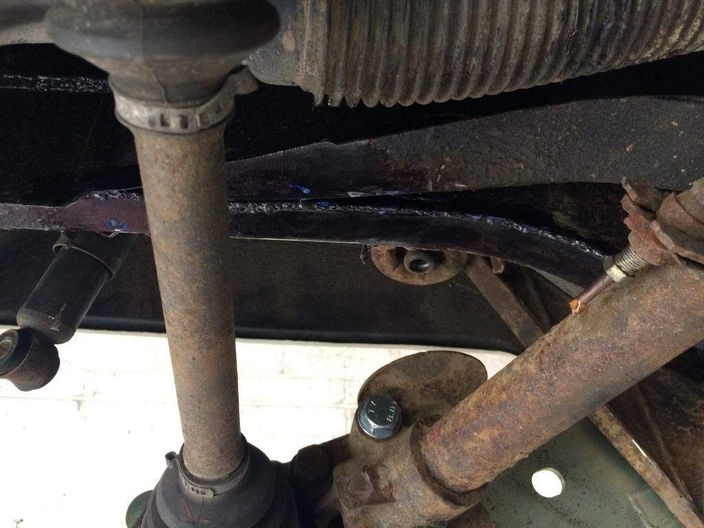

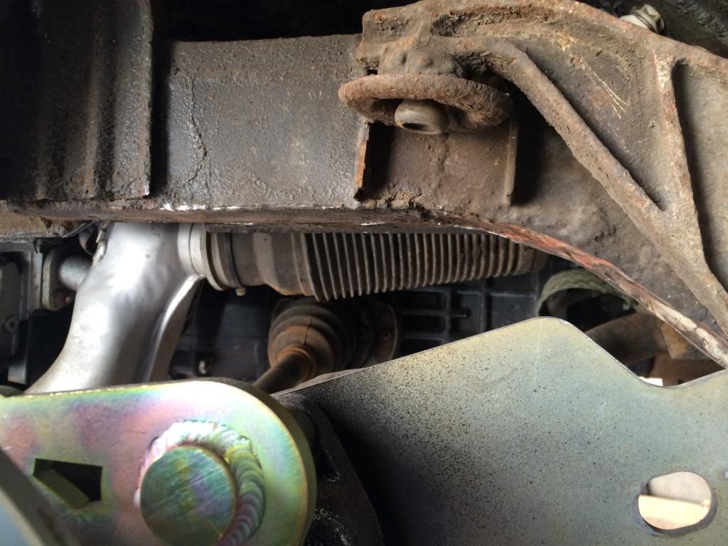

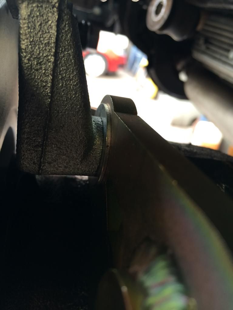

As we weren't getting anywhere with the brakes I decided to remedy some small clearance issues I've been having.
Not with the driveshaft or shocks, but the trailing arm catching the chassis.
So out came the grinder and the lip along the bottom edge of the chassis rails was removed.
rusty nail to sow's ear - Page 22 001_zps2699472e
rusty nail to sow's ear - Page 22 004_zps981b5bde

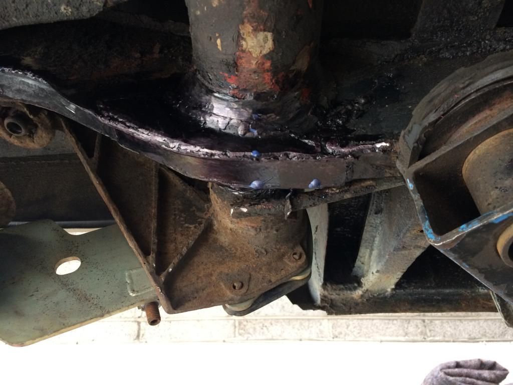

While I was there a smallish repair was done around the torsion tube for the MOT.
rusty nail to sow's ear - Page 22 003_zps88f2f920
I think some small notches will be required soon.

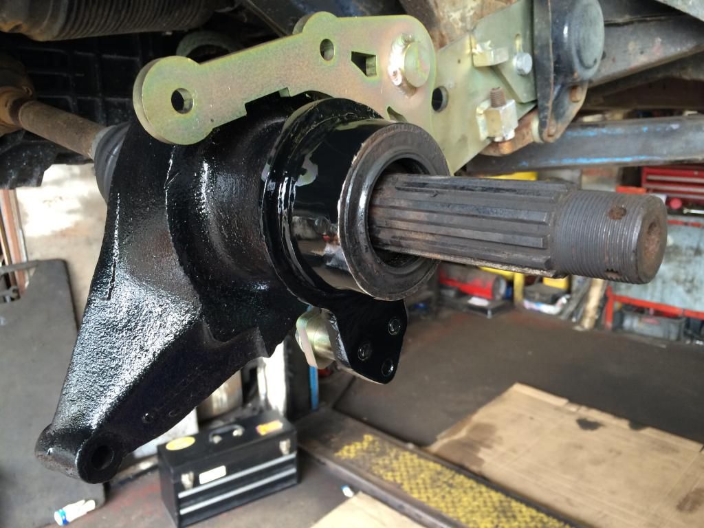

We're now into day 3, and I'm getting pissed off.

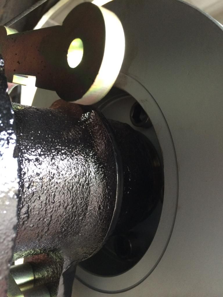

The issues have been sorted, but could've been avoided with better instructions as you will see.

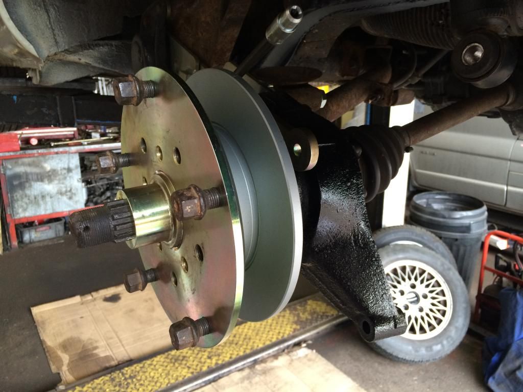

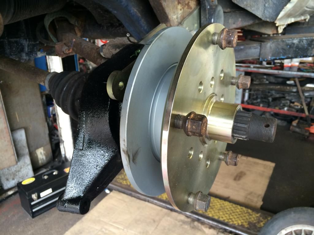

It appears that the 12mm spacer that sits on top of the outer hub bearing needs to be removed to allow the disc assembly to sit further onto the half shaft.
So out they came, just need to be gently pried out with a small screwdriver.
rusty nail to sow's ear - Page 22 001_zpsdd15dbaf
The disc assembly now sits further onto the splines, but the internal bolts now foul on the hub.
rusty nail to sow's ear - Page 22 005_zps8656c208
So out comes the grinder again and the hubs are clearanced and repainted.
rusty nail to sow's ear - Page 22 002_zps3857ebca
rusty nail to sow's ear - Page 22 003_zps8e78a07a
Success.
rusty nail to sow's ear - Page 22 005_zpse89bc205
rusty nail to sow's ear - Page 22 006_zpscc91427d

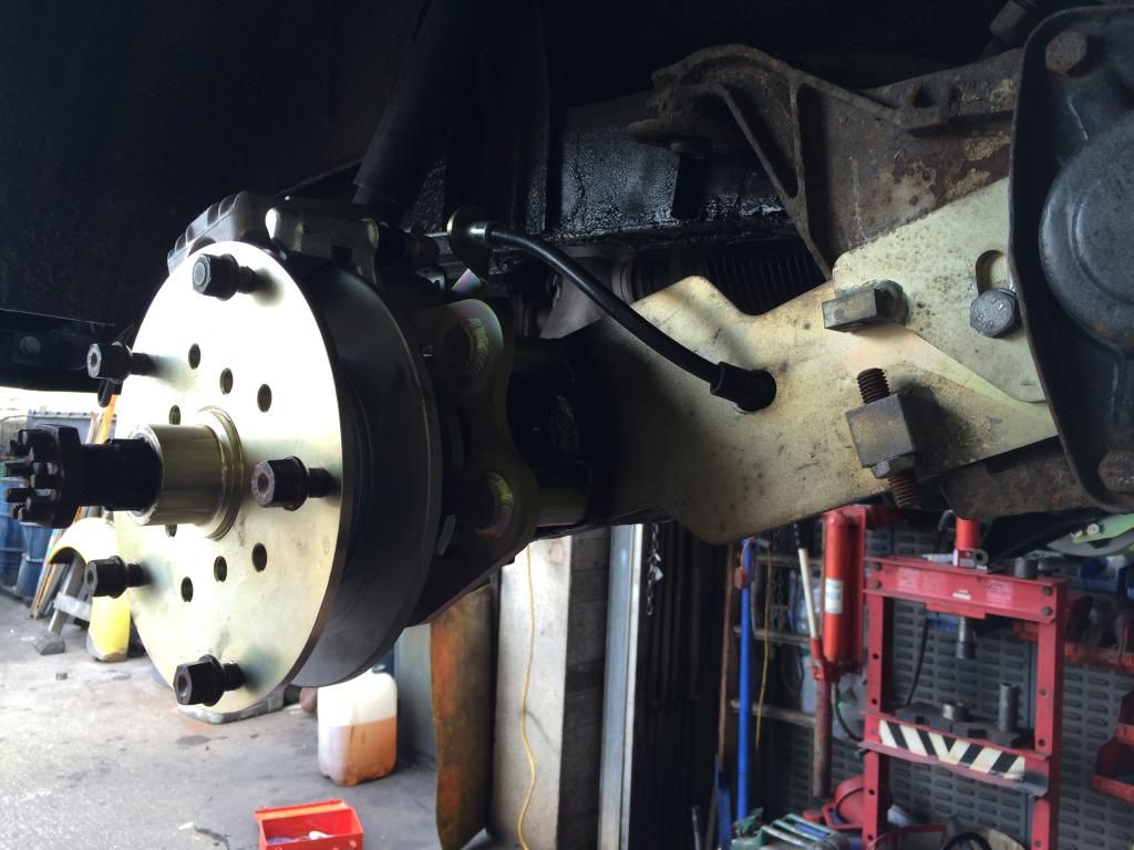

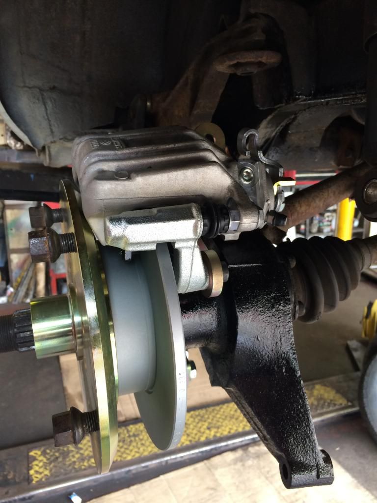

On with the assembly, calliper carriers next.
rusty nail to sow's ear - Page 22 007_zpsdf14e80d
rusty nail to sow's ear - Page 22 009_zps634ad26c

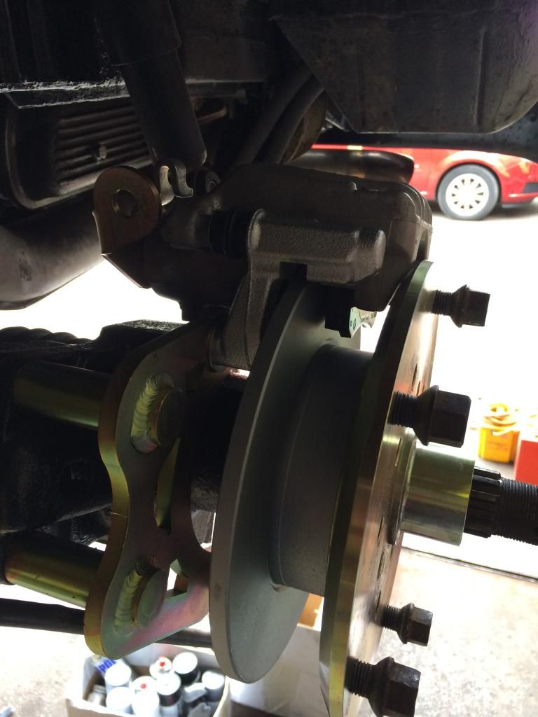

This didn't go quite to plan either. For some reason the carrier fouls the disc slightly on one side.
This was cured by the addition of a 10mm penny washer on the front edge of each carrier.
rusty nail to sow's ear - Page 22 008_zpsf54d36af
rusty nail to sow's ear - Page 22 010_zps22f107ca

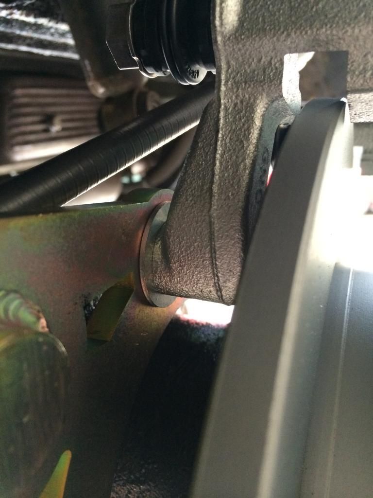

Calliper fitting.
rusty nail to sow's ear - Page 22 011_zps39a21852
rusty nail to sow's ear - Page 22 013_zps2de783f2

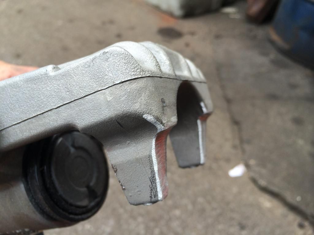

Can you see a problem?
rusty nail to sow's ear - Page 22 014_zpsca028b3a
Yet again it's resolved with the grinder. Both callipers need clearancing to stop fouling the disc assembly.
rusty nail to sow's ear - Page 22 015_zps65442ff2

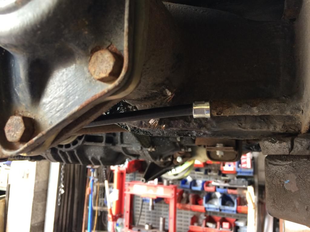

Handbrake cables now.
I needed to trim the handbrake cable tube back about 70mm each side to get the outers to fit properly so there is enough cable to attach to the callipers.
rusty nail to sow's ear - Page 22 016_zps9bd9ac09
rusty nail to sow's ear - Page 22 017_zpsf52b0704
rusty nail to sow's ear - Page 22 020_zps5c3ff234
rusty nail to sow's ear - Page 22 022_zpsdeb40cc6
Don't attach the cables to the callipers, or operate the handbrake levers until the brakes have been bled and set up.

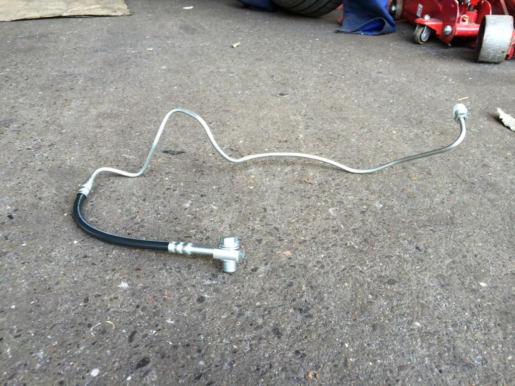

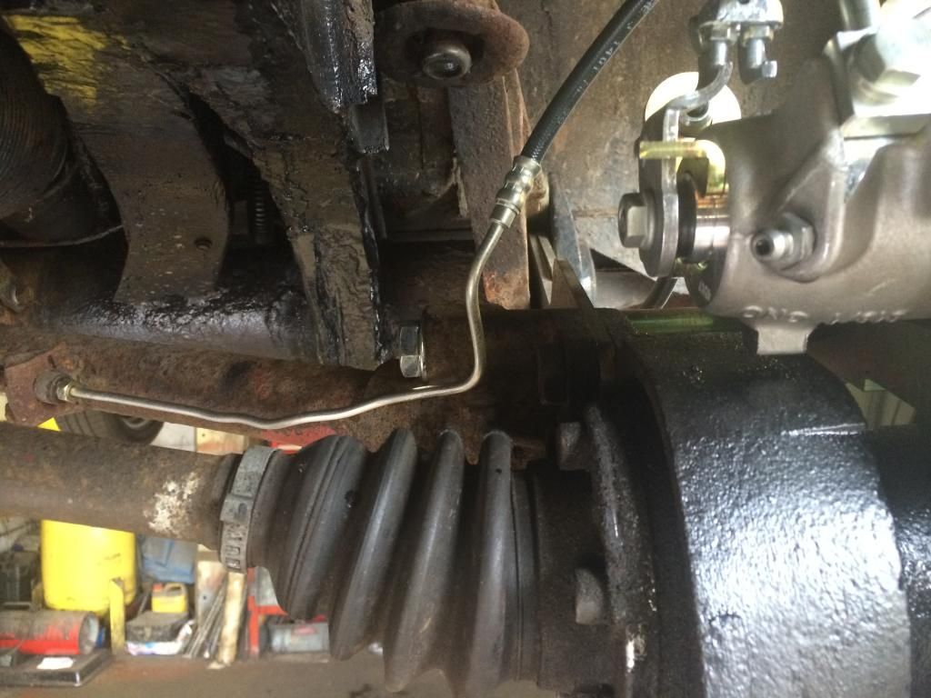

And now the brake pipes. CE don't supply any brake pipes so you need to source your own.
I went for Mk 4 Golf Estate rears to suit the calipers, but they need modifying to fit as well.
rusty nail to sow's ear - Page 22 023_zpsd262d3f3
rusty nail to sow's ear - Page 22 024_zpsfa0b893a
What a pain in the ass, definitely wouldn't do it again and not worth the money.

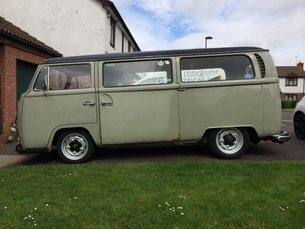

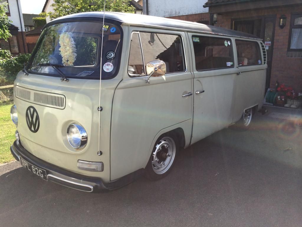

Looks like I won't be running centre caps unless I fit shortened half shafts, and that won't be happening. At least not in the foreseeable future.

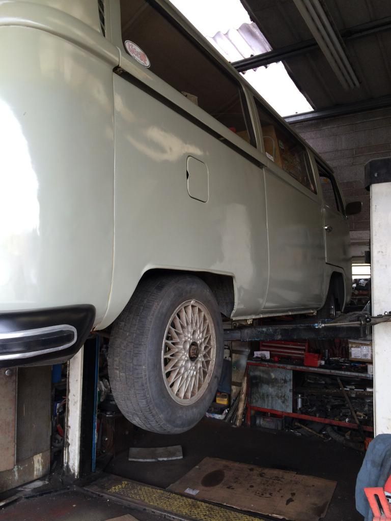

Hub nut spacers fitted today and the bus is back home, at last.
rusty nail to sow's ear - Page 22 002_zps3e361661
rusty nail to sow's ear - Page 22 003_zps5a6dc4b9
rusty nail to sow's ear - Page 22 008_zpsd21cb86b
Next jobs, oil cooler, oil and filter change, and valve clearances.
What could possibly go wrong.....?
