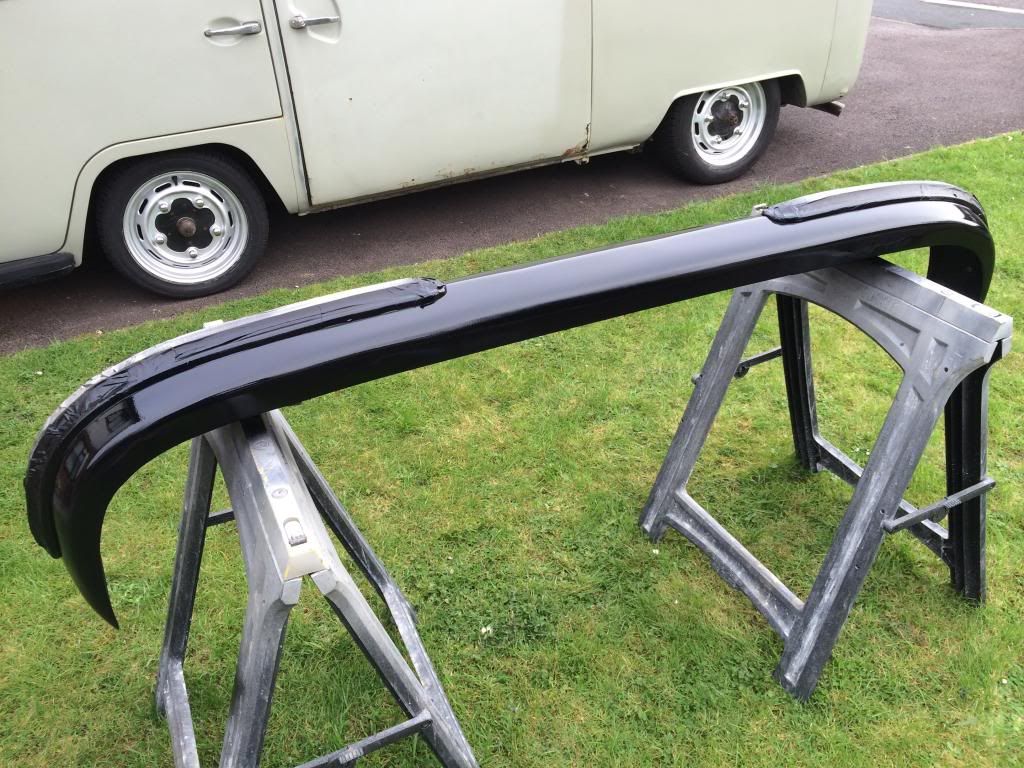

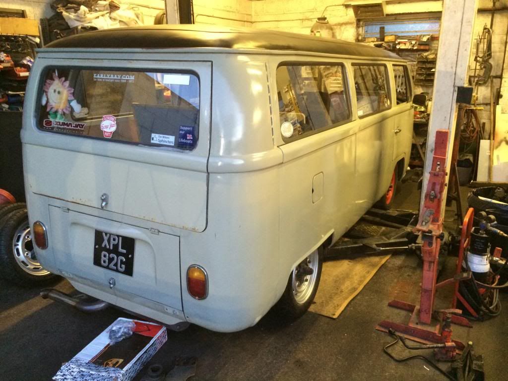

Sat 1st March 2014
Shitter shining in the sun this morning.
rusty nail to sow's ear - Page 21 002_zpsef39a1ba

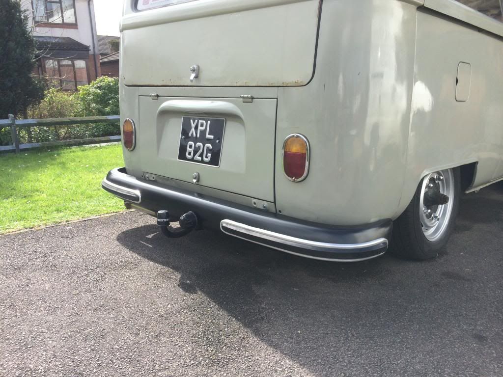

Rear bumper irons Mk II, needed a bit of additional bracing with the towbar.

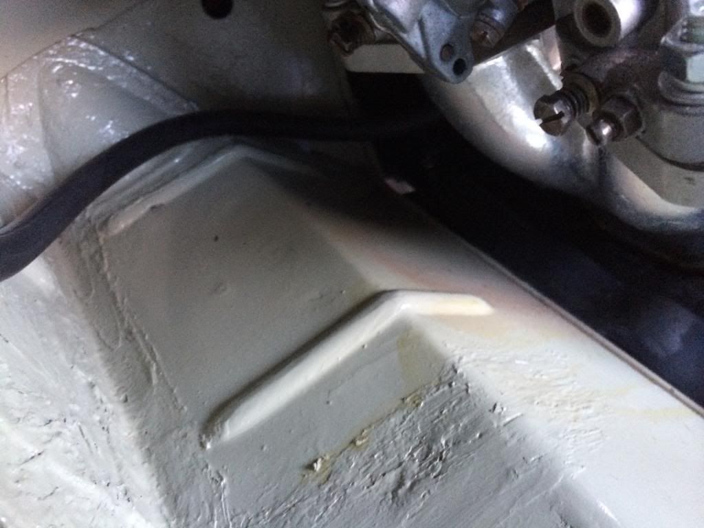

The wife mentioned there was a whiff of fuel out of the n/s vent yesterday, had a quick look and couldn't see anything.
So today I started it up, walked round the back and opened the engine lid to have a big flame rush out. Pulled the coil lead off to stall the engine and close the fuel cut-off solenoid.
Looks like a blank on the n/s carb fuel inlet blew out, all fixed now with a bit of fuel pipe, some clips and an 8mm bolt.
No damage other than a scorch mark on the engine bay closing panel.

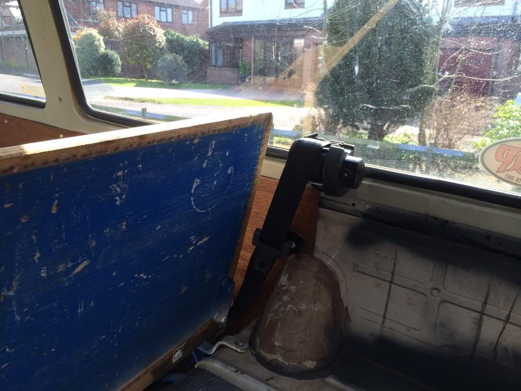

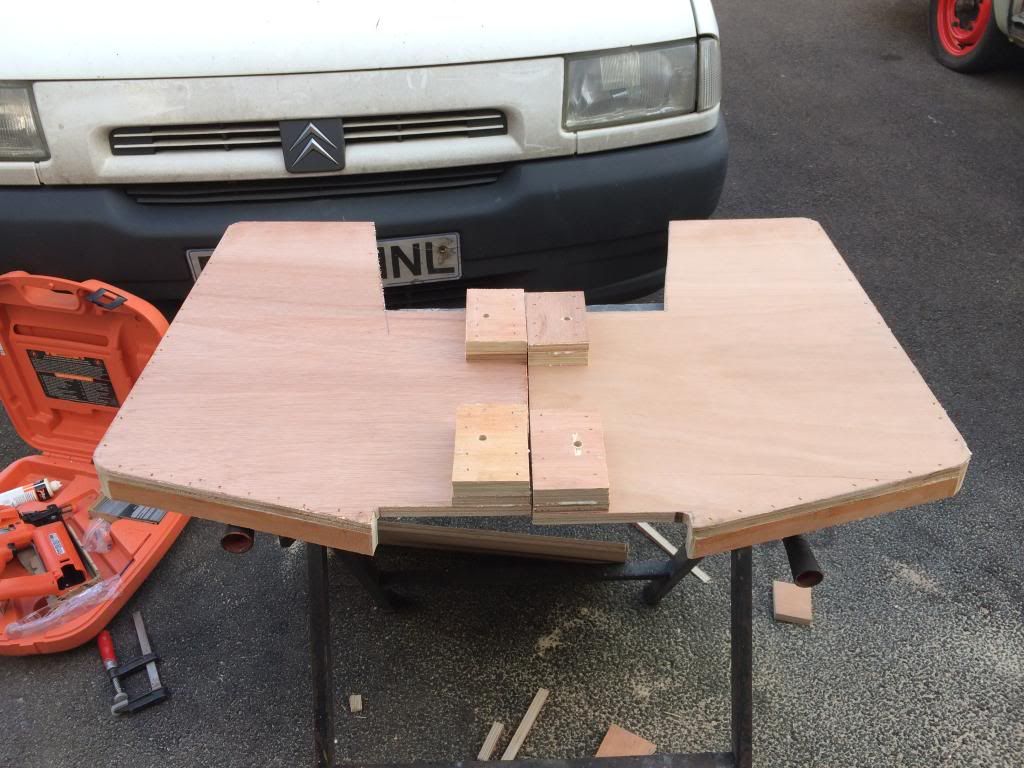

Saturday 8th March 2014

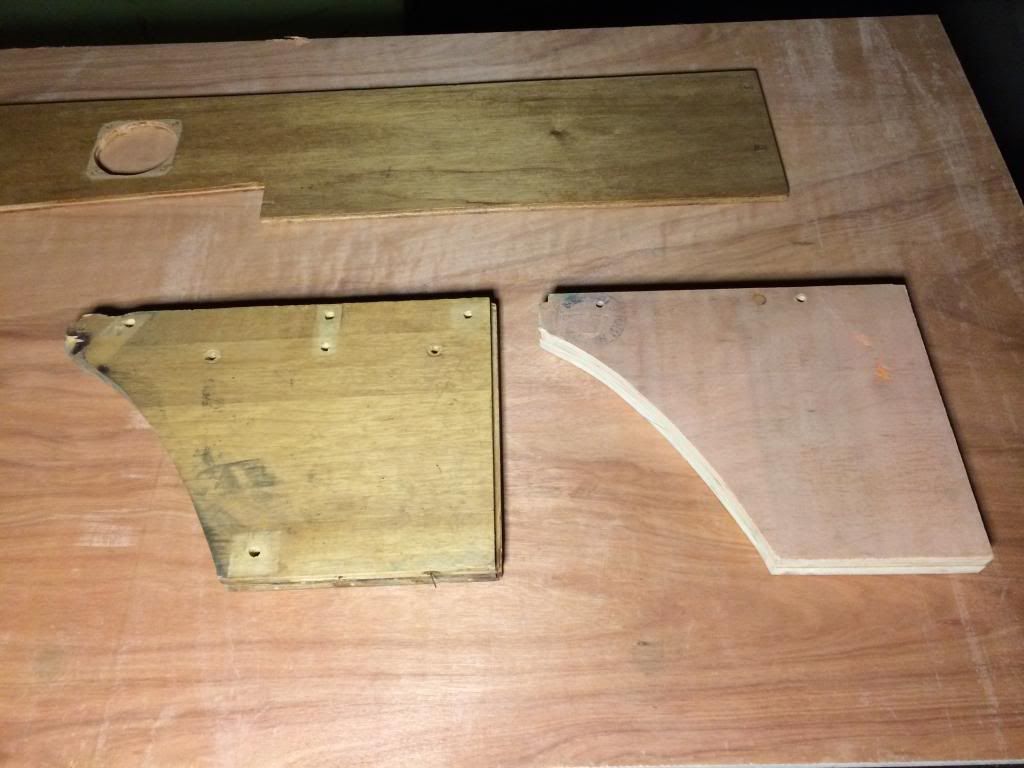

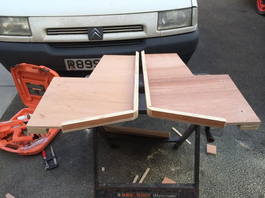

So today I started on the Westfakia interior bed base.
Borrowed some spare boards as a template, picked up a sheet of 18mm ply and started cutting.
I wanted to keep the heater outlet so slightly modified the side boards to suit, and as the seat base supports weren't fitted and there's two sets of fixing holes, I had to guesstimate the size of the front board.
Not too bad though, works fine as a seat.
rusty nail to sow's ear - Page 21 001_zps40d70446
Now there's a problem, see if you can spot the difference.
rusty nail to sow's ear - Page 21 005_zps4eb3c871

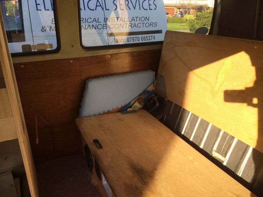

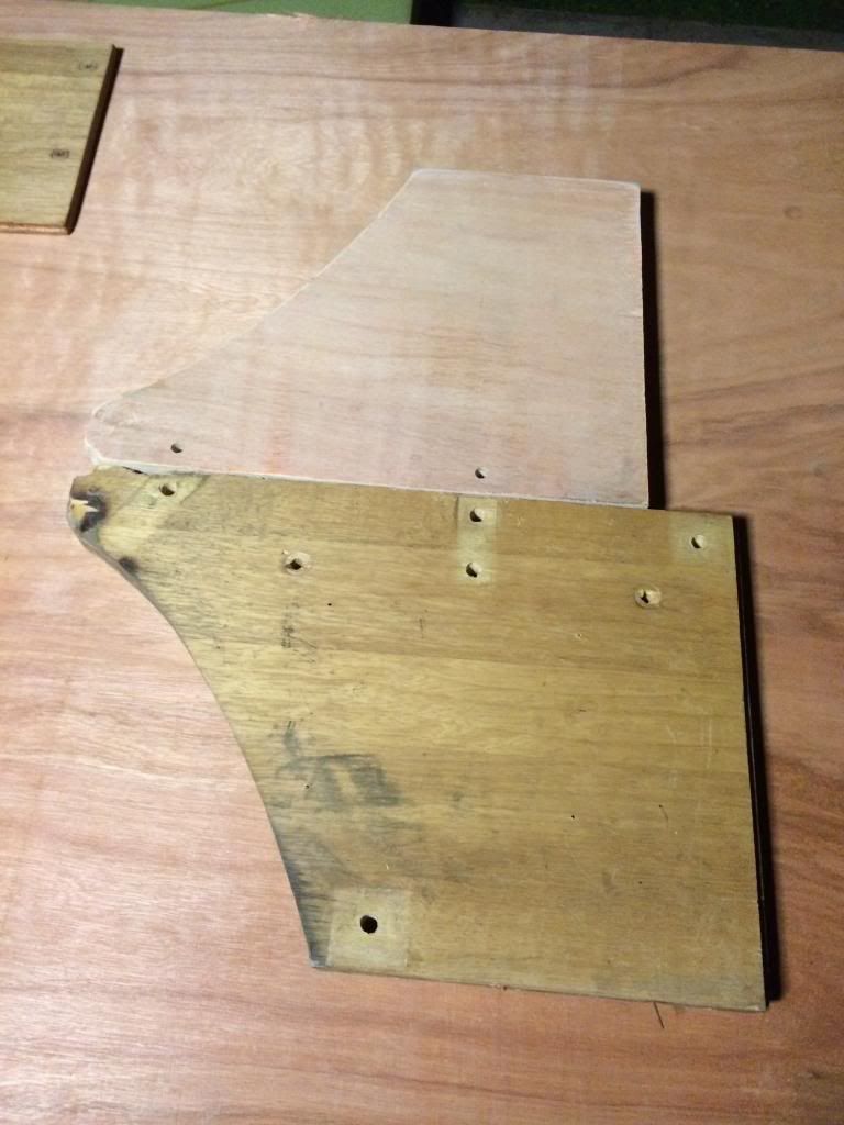

This may make it slightly easier. Laughing
rusty nail to sow's ear - Page 21 006_zps86b0e951

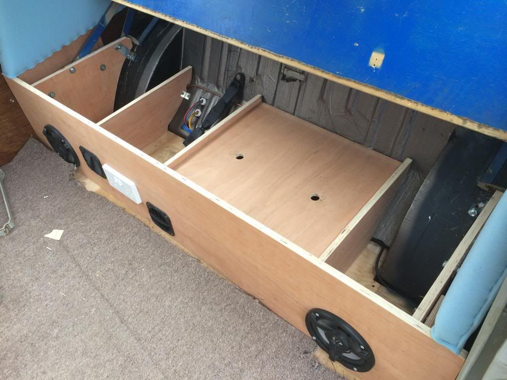

Shortening the side supports moves the front board backwards and that means that the seat base supports don't support anything.
So I started again, even though it was dark now.
rusty nail to sow's ear - Page 21 004_zpsb3813a58
I think I can make a duct for the heater outlet as it's now 3" behind the front board.
Rolling Eyes

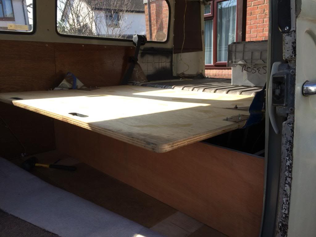

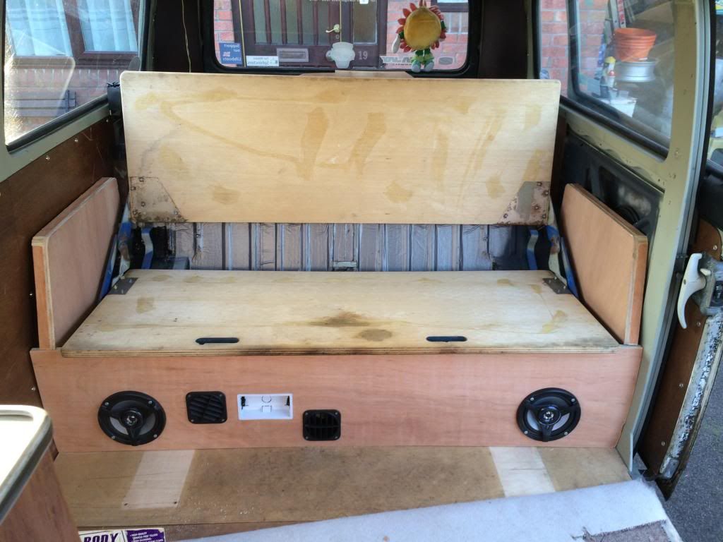

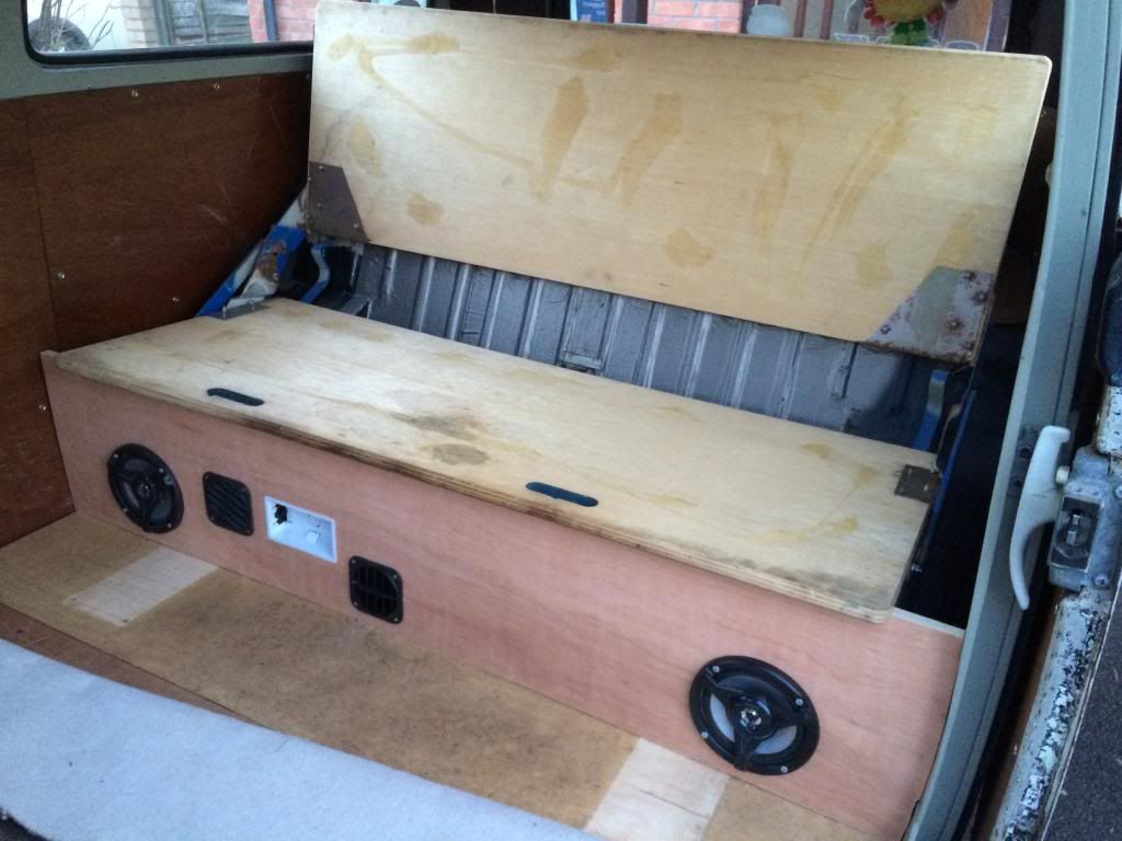

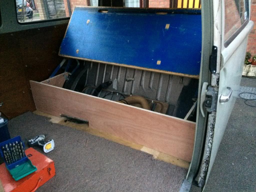

Sunday 9th March 2014
on with the wood butchery.
New front board, just needs a little fettling.
rusty nail to sow's ear - Page 21 002_zps8d02a16f
Bed works, a bit uncomfortable at present though.
rusty nail to sow's ear - Page 21 001_zps902afc07
And it's a seat, who'd thought that.
rusty nail to sow's ear - Page 21 003_zps1d2d5dcc
Clears the seat belt mech as well.
rusty nail to sow's ear - Page 21 004_zpsbc7a73e6

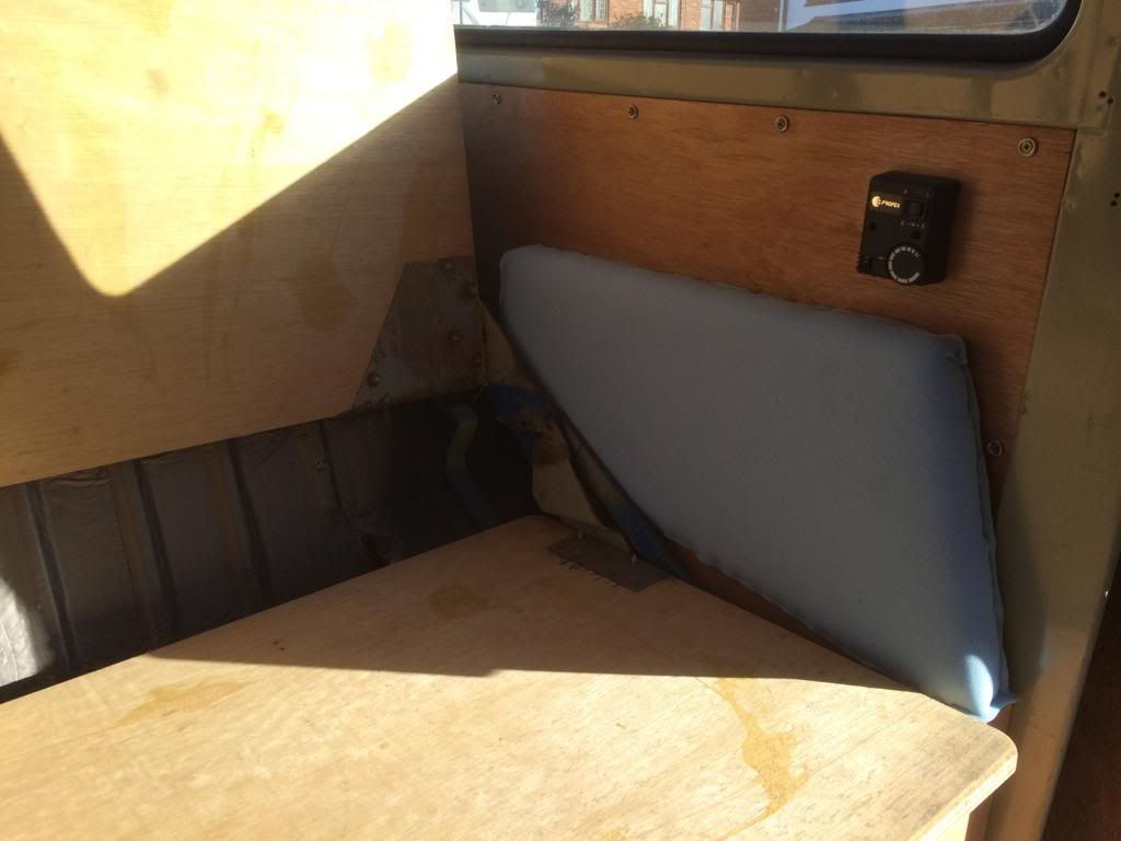

Today's project is the seat/bed arm rests.
rusty nail to sow's ear - Page 21 002_zps1c900196
rusty nail to sow's ear - Page 21 003_zpsc82ba266
rusty nail to sow's ear - Page 21 006_zps9436f668

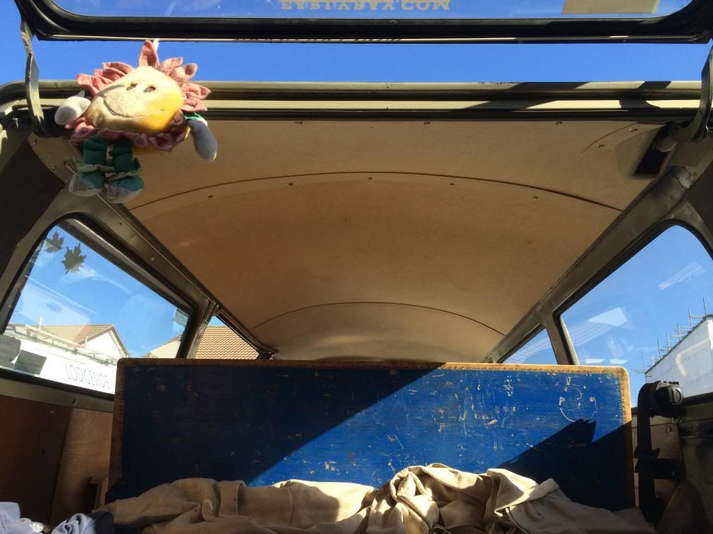

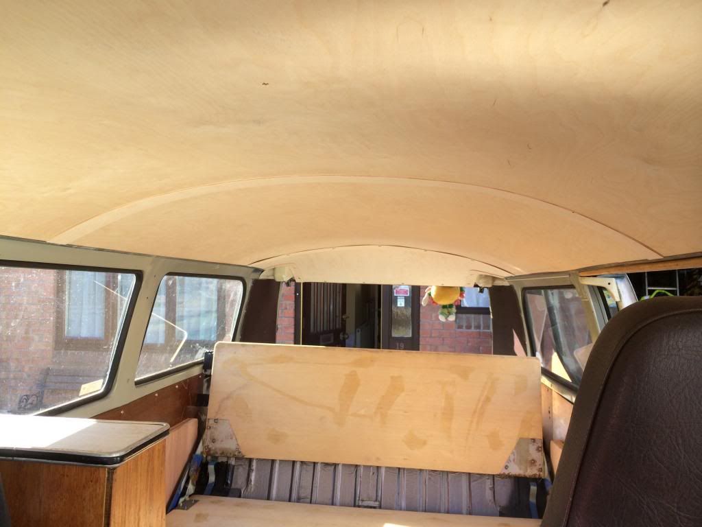

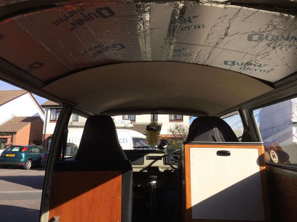

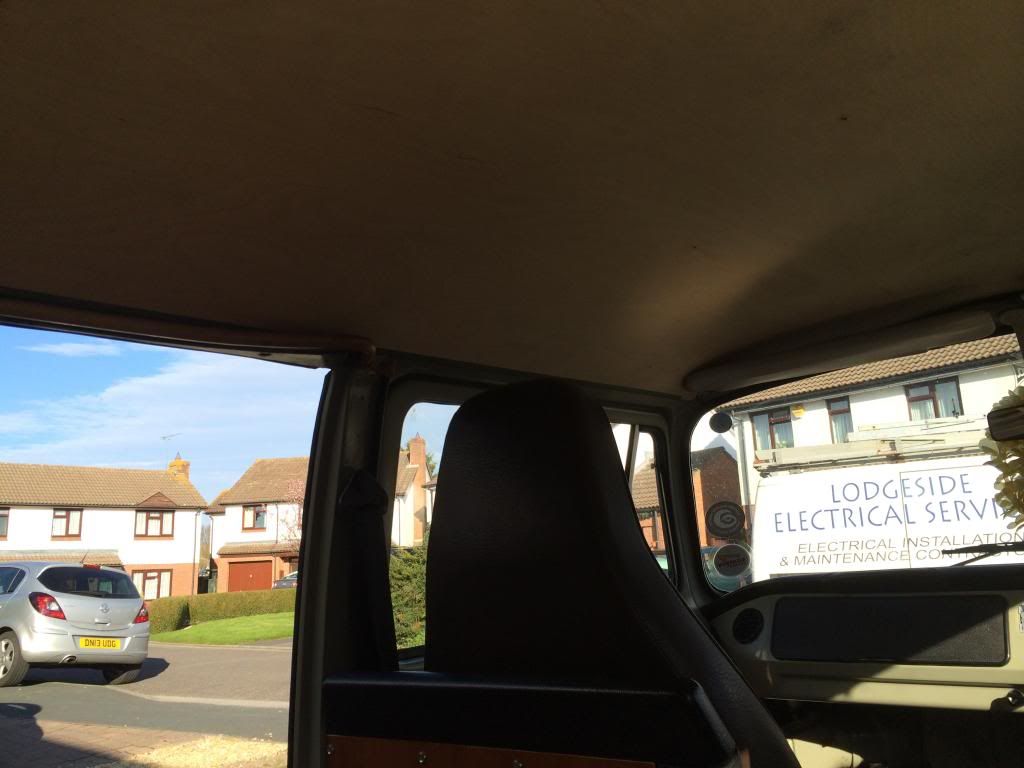

Saturday 15th March 2014
So it required trimming a couple of times this morning, but it fits.
rusty nail to sow's ear - Page 21 002_zps806c1671
rusty nail to sow's ear - Page 21 003_zps04a1476c

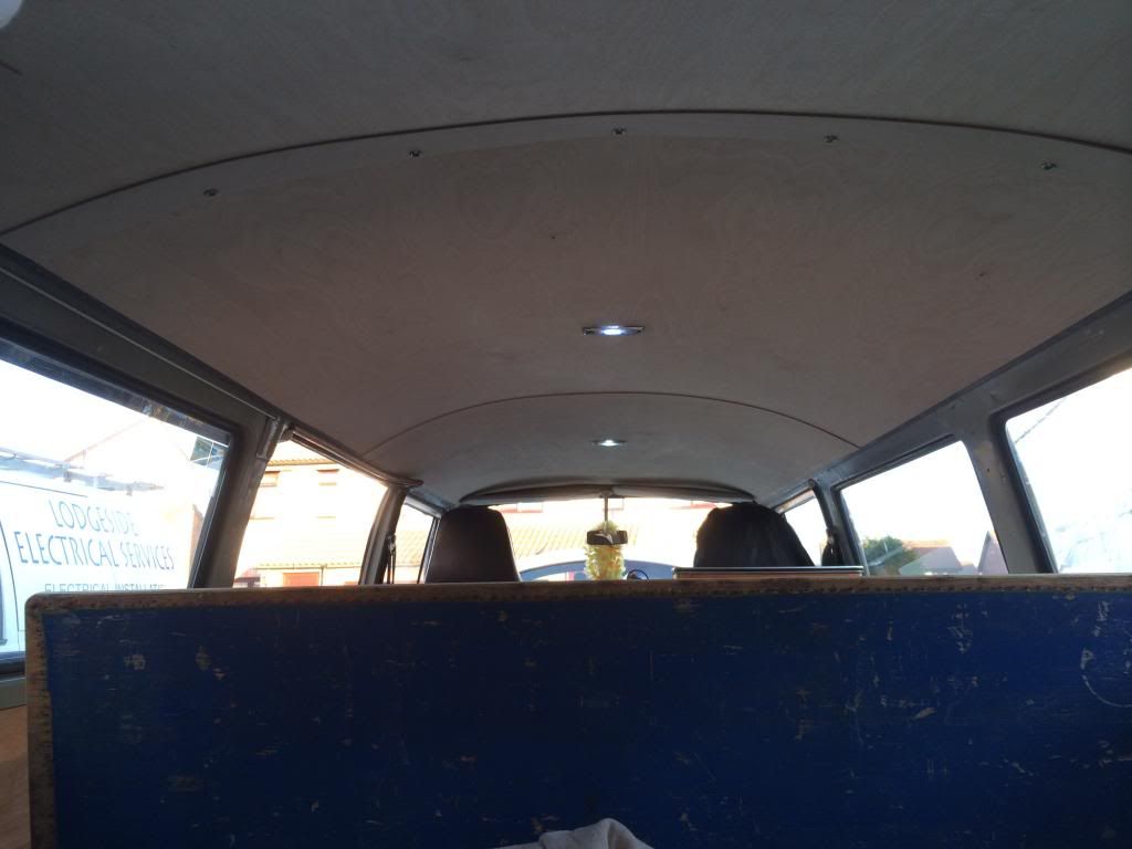

On with the second sheet.
rusty nail to sow's ear - Page 21 004_zps1883713f
That took most of the afternoon and early evening to get right as well.
I forgot that there would be a small gap between the sheets at the centre of the roof due to the shape of the bus, so a cover strip has had to be used. It's only that colour because the sealer hadn't dried when I took the pic.
rusty nail to sow's ear - Page 21 006_zps62c33734
Quite pleased with the result though.
Still got the rear section round the hinges to redo tomorrow, I was getting frustrated and it was getting dark.
rusty nail to sow's ear - Page 21 007_zps8a89b84b

Got the last piece fitted today.
rusty nail to sow's ear - Page 21 001_zpsa7c6c8f0
rusty nail to sow's ear - Page 21 003_zps498b56e0
I had to use some screws to hold the rear two sheets together due to the compound curves involved, and a couple of trim pieces around the hinges to tidy them up.
rusty nail to sow's ear - Page 21 004_zps3acfbaf0
rusty nail to sow's ear - Page 21 005_zps576adba8
Courtesy lights in and finished.
rusty nail to sow's ear - Page 21 008_zps4deacb84
I'm pleased with how it ended up, although a bit pissed off that I mis-measured the front courtesy light and have a 6mm hole over the walk-through section.   Neutral

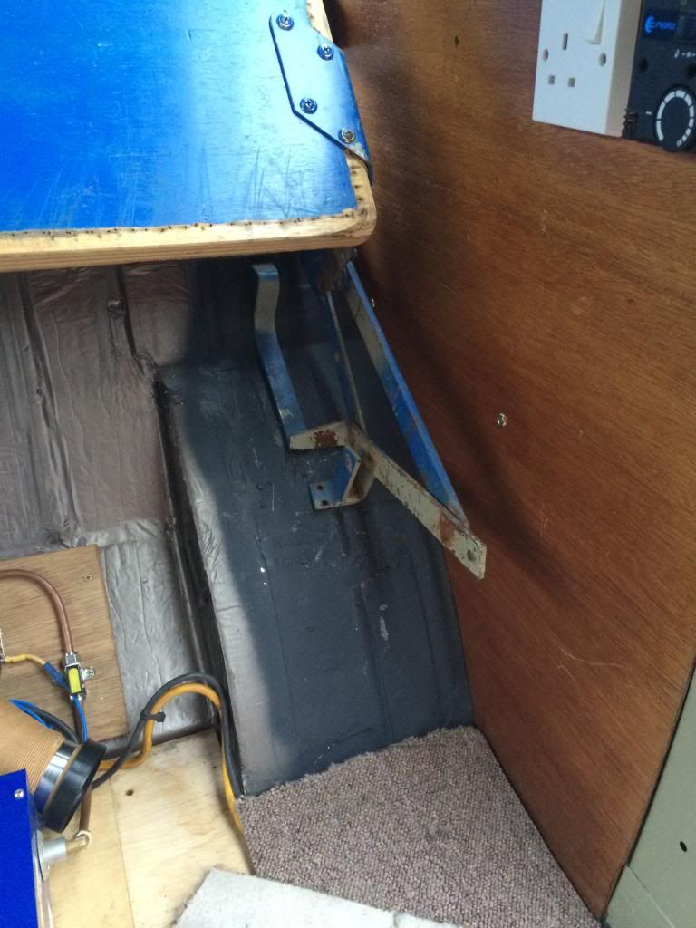

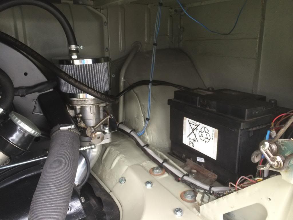

So today I spent an hour making a couple of brackets to fit return springs on the throttle linkage. Now I can change gear without the engine racing, and pull up to a junction without having to left foot brake and stick my right foot under the throttle pedal.
rusty nail to sow's ear - Page 21 001_zpsa29b99de
rusty nail to sow's ear - Page 21 007_zps06f0096e
rusty nail to sow's ear - Page 21 008_zps149a9bea
rusty nail to sow's ear - Page 21 004_zps05374300

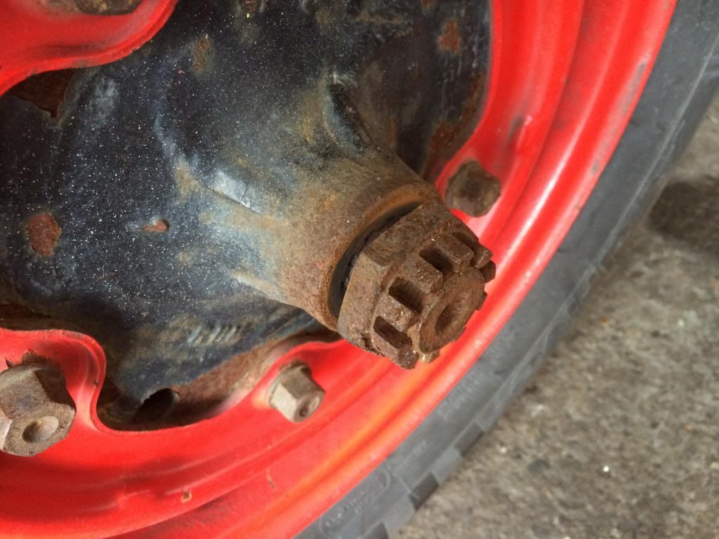

Friday 21st March 2014

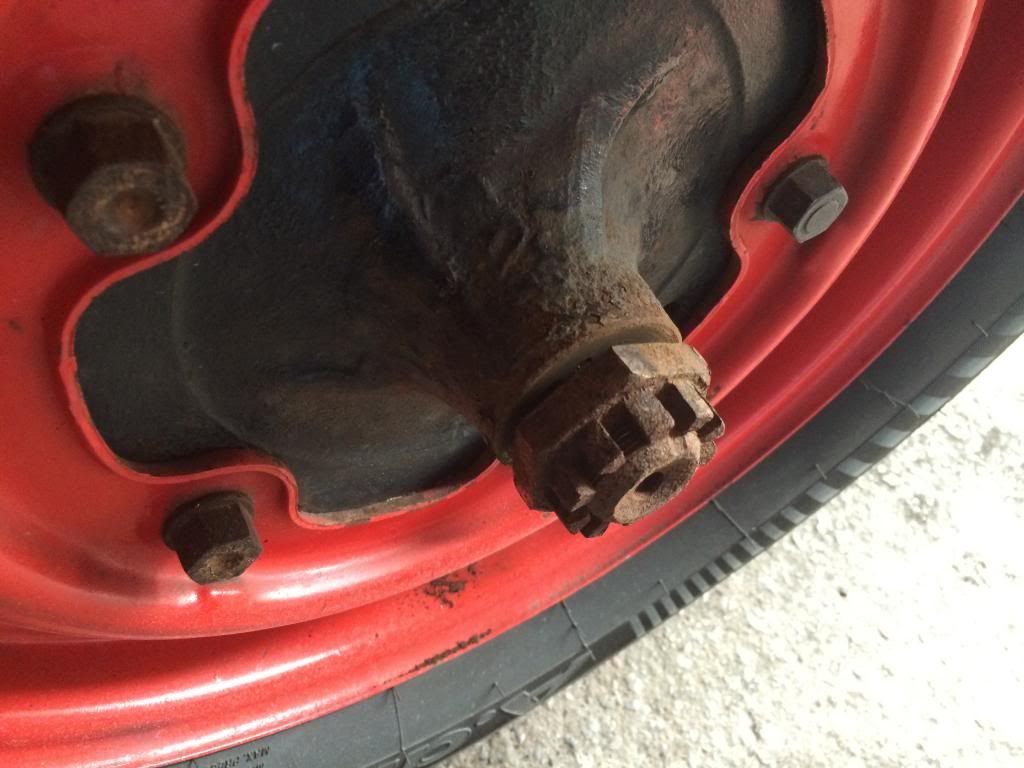

So today was adjustable springplate day, about time really considering they've been in the garage since November.
Hub nuts came off surprisingly easy.
rusty nail to sow's ear - Page 21 001_zps18f73bac
rusty nail to sow's ear - Page 21 002_zps18a317ed
I did use the air gun though. :msn4:
T2D spring plates with Creative Engineering bushes. Question

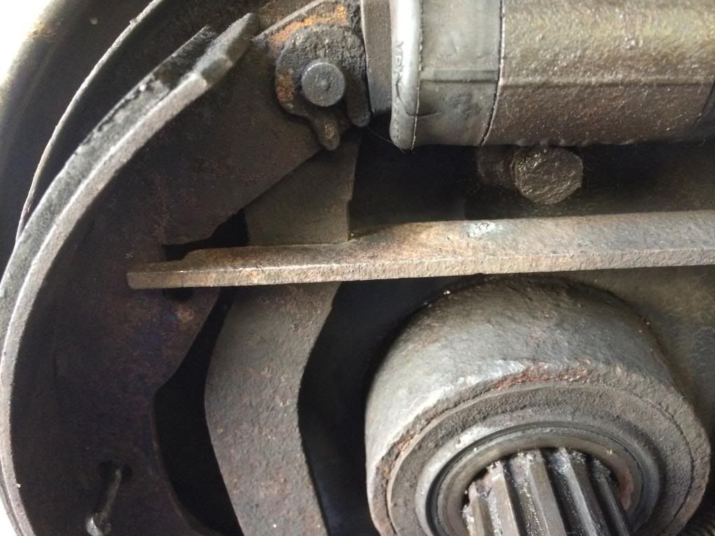

So this morning was spent mucking about with the rear brakes.
Spreader bar welded to see if this would help the handbrake issues.
rusty nail to sow's ear - Page 21 012_zps8240f9a6
Didn't make too much difference, adjust the brakes and handbrake only works on near side, adjust the handbrake cables and the off side drum drags with the handbrake off.
Hopefully when I replace the rear wheel cylinder and linings I can sort the handbrake out.

I seem to have acquired another Continental unit.
rusty nail to sow's ear - Page 21 002_zpsc9fbdd9a
rusty nail to sow's ear - Page 21 001_zpse892ec40
As it was sunny yesterday progress was made.
The Continental units were stripped, and one good one made from the two.
A new back board fitted, some stopper, sanded and one coat of satin varnish, and the rear bumper was sanded and primed as it looked awful.

Time for an update.
2nd coat of varnish on the unit and bumper painted, just waiting for the rain to stop now so I can fit it.
rusty nail to sow's ear - Page 21 002_zpse65d4182
So today was nice and sunny, and the bumper was bolted back on.
Along with the trailer socket and all the engine bay/leisure battery wiring finished and both batteries re-fitted.
rusty nail to sow's ear - Page 21 001_zps3c1db33b
Be nice to get out for a drive and stick some more miles on this weekend.

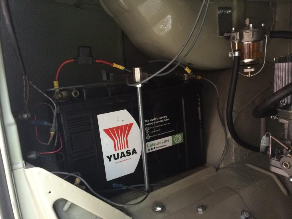

Batteries secured.
rusty nail to sow's ear - Page 21 002_zpsb0b82b18
rusty nail to sow's ear - Page 21 006_zps2822a756
And cover for the Propex and 12V wiring done.
Just need to get some U profile steel for the top of the ply where the bed supports rest and some upholstery fabric and we're almost ready for Easter.

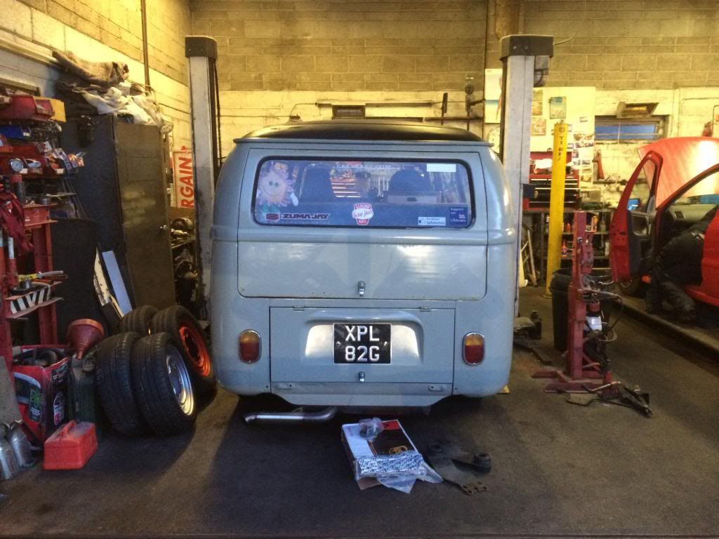

So yesterday morning was spent down the yard. Oil and filter change, and a raise of the rear springplates to allow for the weight of the Rapido.
rusty nail to sow's ear - Page 21 001_zps74f61c5c
While I was raising the ride height, ozziedog's bus was getting new door rubbers and the Type 3 was going down slightly.
However, I think I may have slightly overdone it, a bit of nose down stance going on.
rusty nail to sow's ear - Page 21 002_zpsb80e6ce9

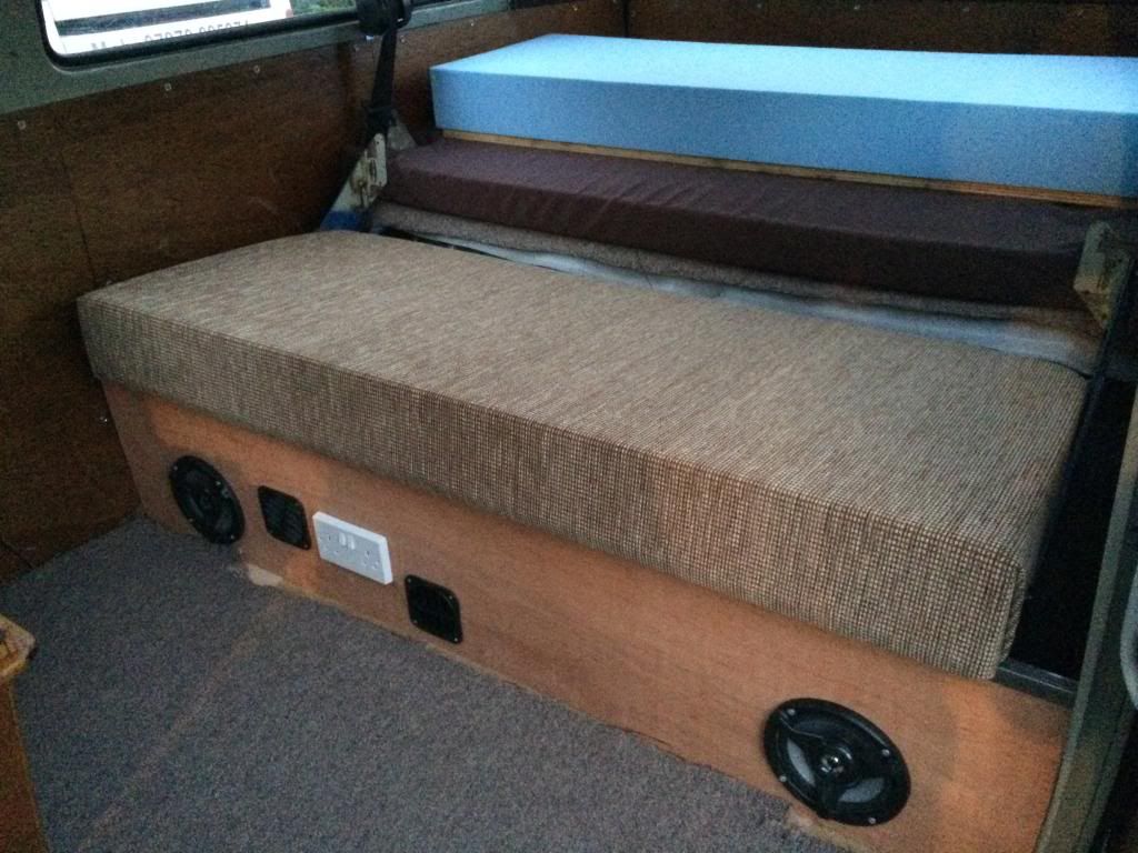

Today was spent fettling the Rapido for it's first trip this year, and covering the Westy bed.
rusty nail to sow's ear - Page 21 006_zps568c6671
Not bad for a first attempt at upholstery, just need to do the back board and arm rests before Wednesday morning.

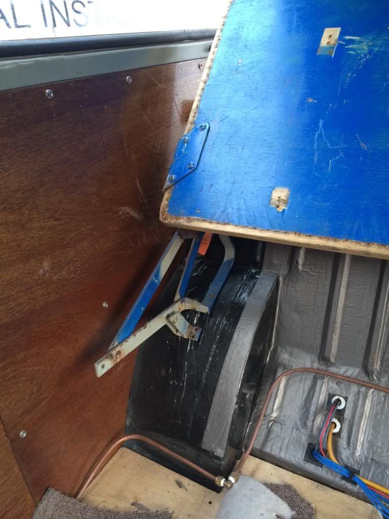

Bed finished tonight, good job really as we're off for Easter tomorrow.
rusty nail to sow's ear - Page 21 006_zpsb66f1cee
rusty nail to sow's ear - Page 21 005_zpsd2e79d0b
