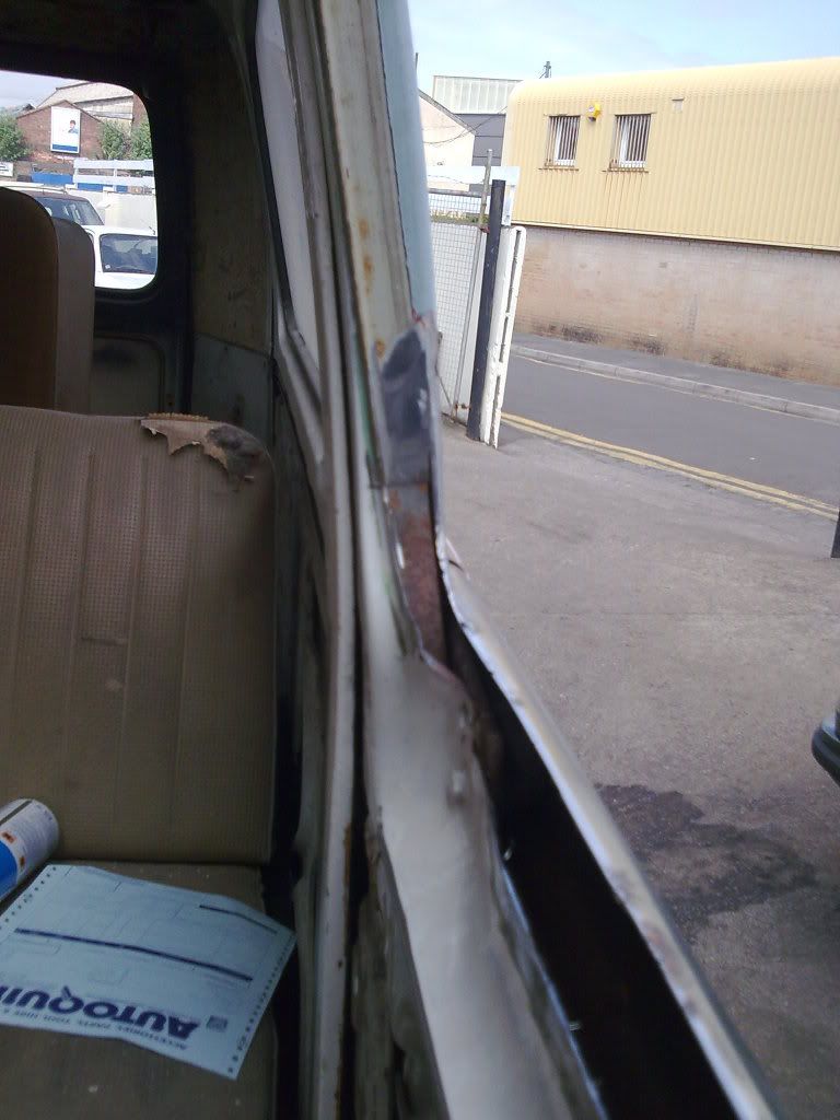

Monday 27th April 2009
A pillar repair
rusty nail to sow's ear - Page 3 Apillars038
After the weekend's work, not happy with the top of the front panel cut. Too much filler and repair plates, really disappointed to tell you the truth.

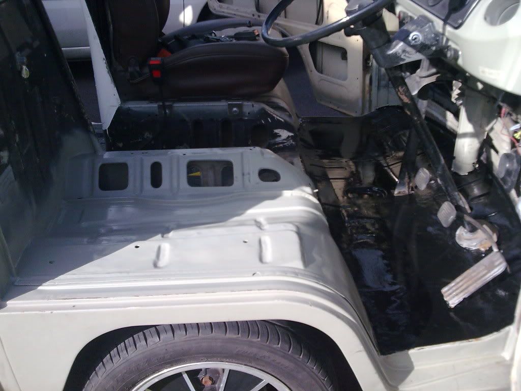

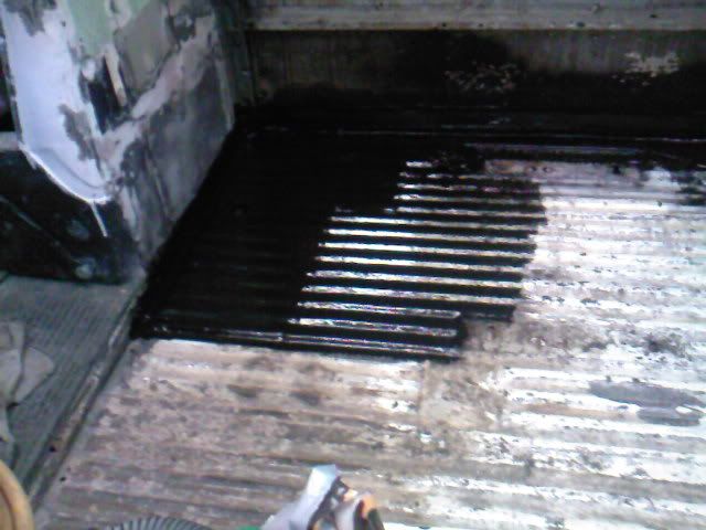

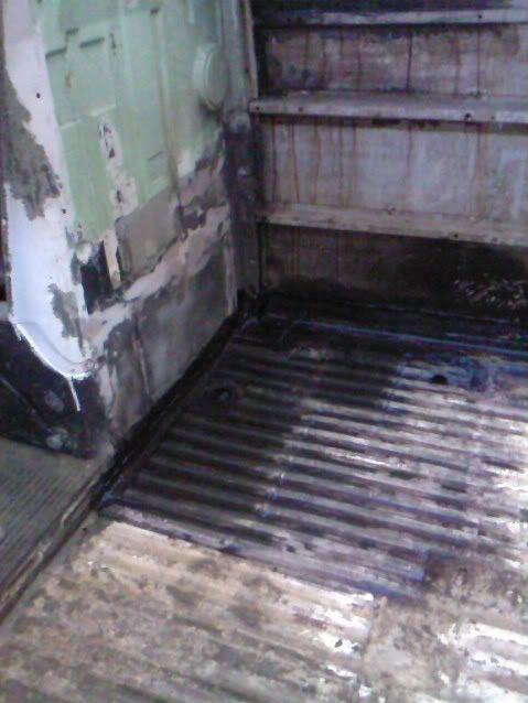

Found reason why the cargo floor gets wet after rain .
rusty nail to sow's ear - Page 3 Roof001

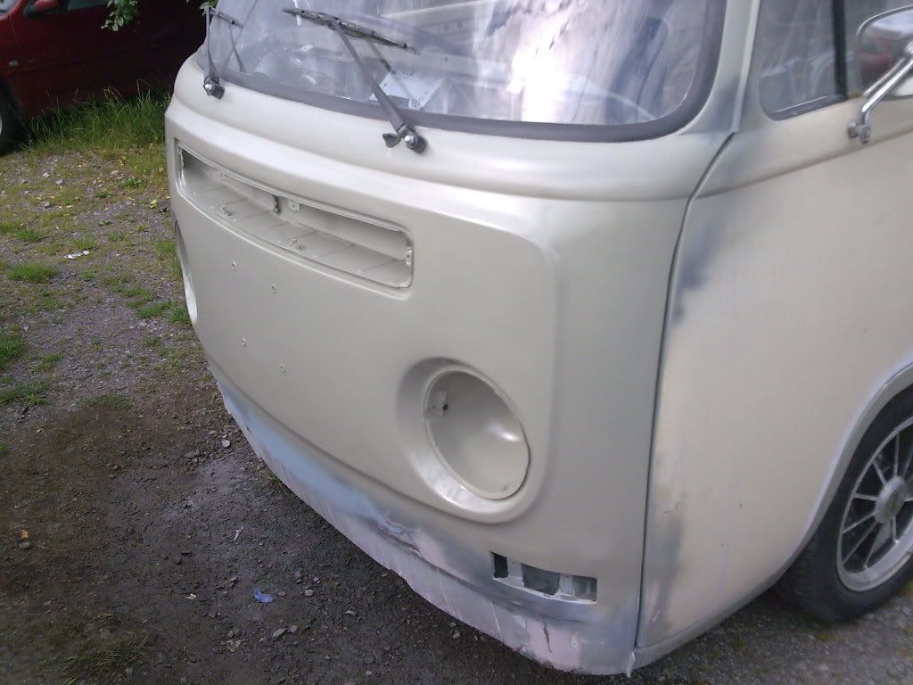

At last, under coat and finish colour on the front. Very Happy
rusty nail to sow's ear - Page 3 Frontpanel024
rusty nail to sow's ear - Page 3 Frontpanel025
rusty nail to sow's ear - Page 3 Frontpanel026
rusty nail to sow's ear - Page 3 Frontpanel029
rusty nail to sow's ear - Page 3 Frontpanel027
Baking in the sun.
rusty nail to sow's ear - Page 3 Frontpanel032
rusty nail to sow's ear - Page 3 Frontpanel030
rusty nail to sow's ear - Page 3 Frontpanel031
The colour looks a bit washed out in the sun, but is much darker. Windscreen being fitted and the reassembly starts tomorrow, although I want to strip the dash back to body colour before I refit it.

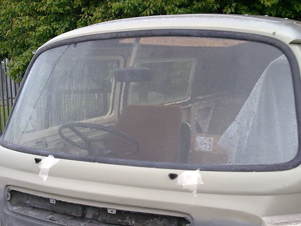

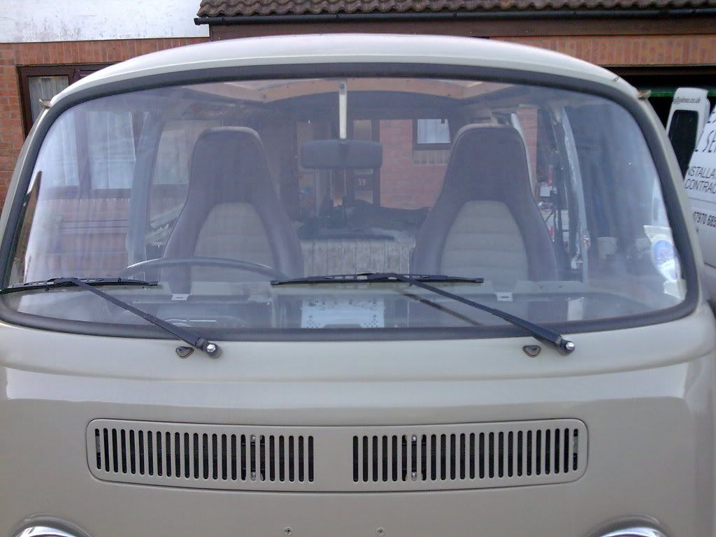

Thursday 30th April 2009

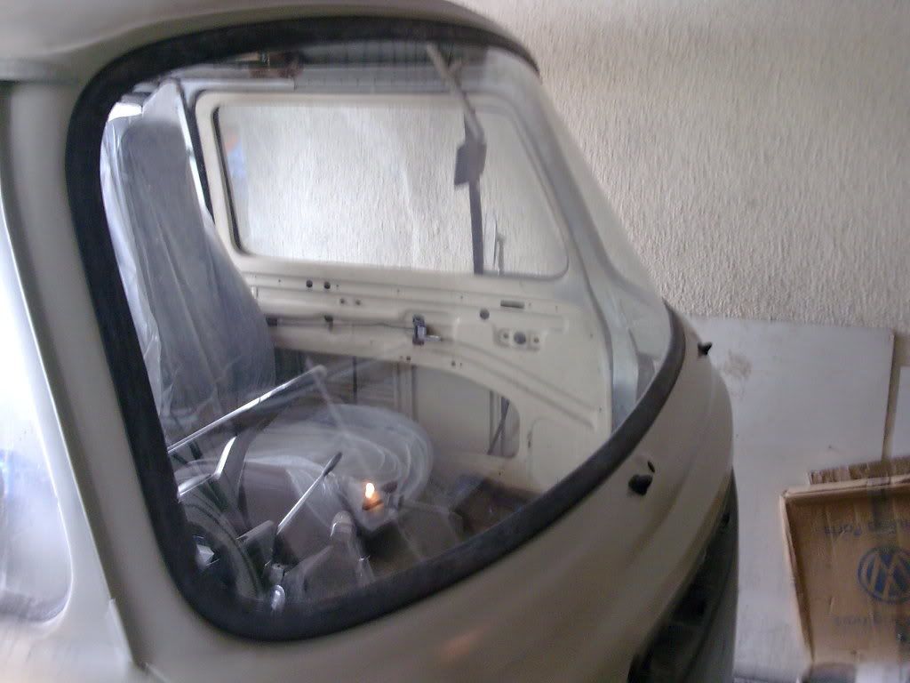

Hooray, windscreen fitted. Had a couple of moments when we thought the opening was too big, but it's in and watertight. :mrgreen:
rusty nail to sow's ear - Page 3 Frontpanel033

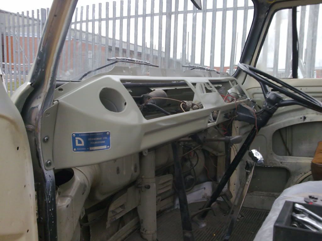

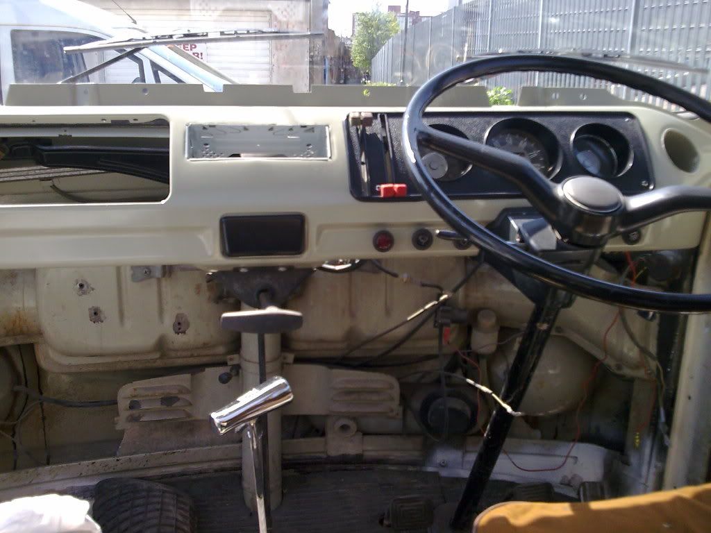

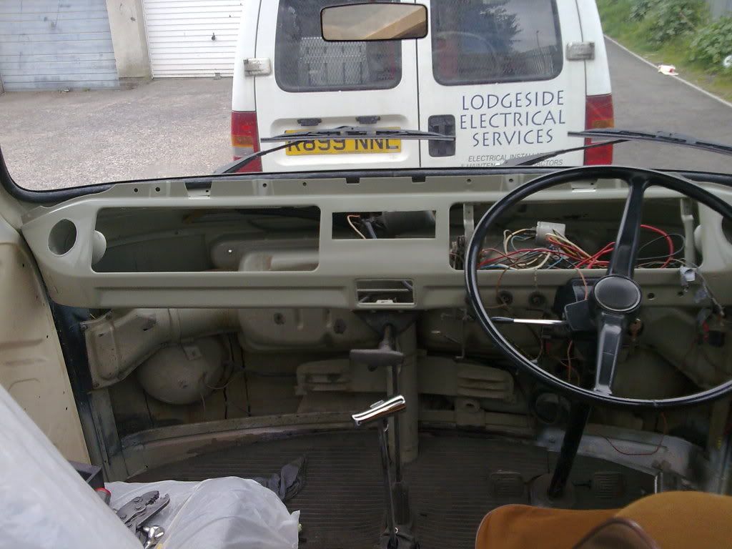

Dash painted, what a pain that was. All day yesterday stripping and rubbing back, got fed up with it really........
rusty nail to sow's ear - Page 3 Dash001
....but now it's back in.
rusty nail to sow's ear - Page 3 Dash002
rusty nail to sow's ear - Page 3 Dash003
Dash top needs repairing, so that'll go back in at a later date.

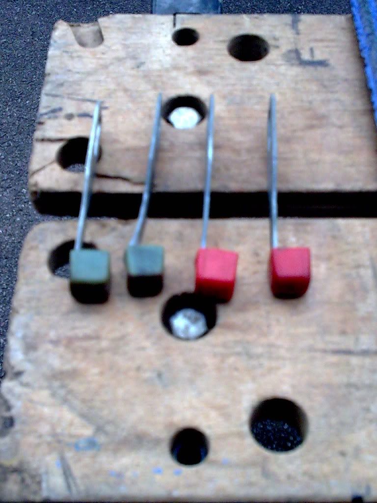

£10 heater knobs came off of eBay at the right time.
rusty nail to sow's ear - Page 3 Heaterknobs
The blue has discoloured a bit, that'll mean a few points deducted at the concours competition

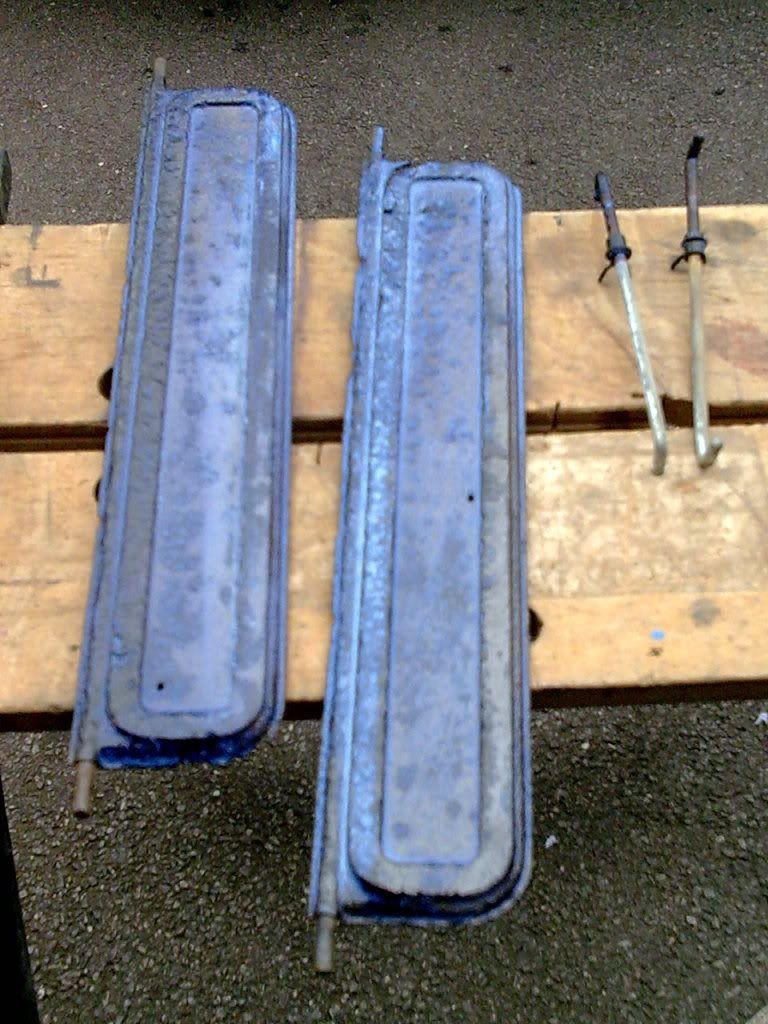

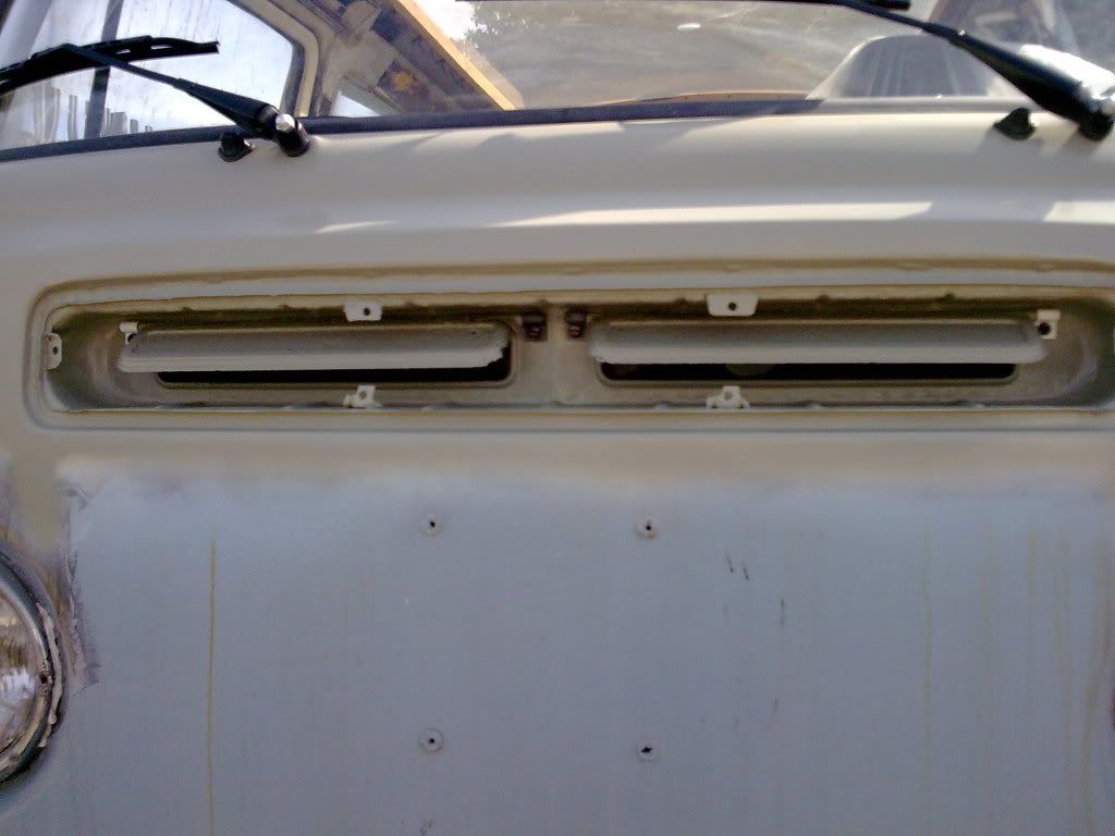

Started on the hidden stuff so I can get the front finished. Fresh air flaps get a bit of tlc.
rusty nail to sow's ear - Page 3 Freshairflaps
The seals are fine, but I'm replacing the pivots.

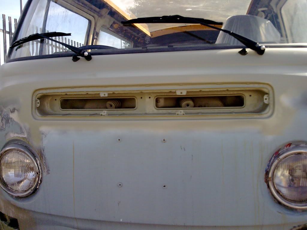

Mon 11th May 2009

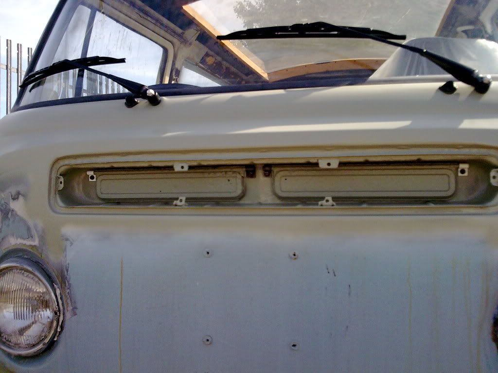

Fresh air flap installment.
Painted,
rusty nail to sow's ear - Page 3 Frontpanel037
open,
rusty nail to sow's ear - Page 3 Frontpanel038
shut.
rusty nail to sow's ear - Page 3 Frontpanel039

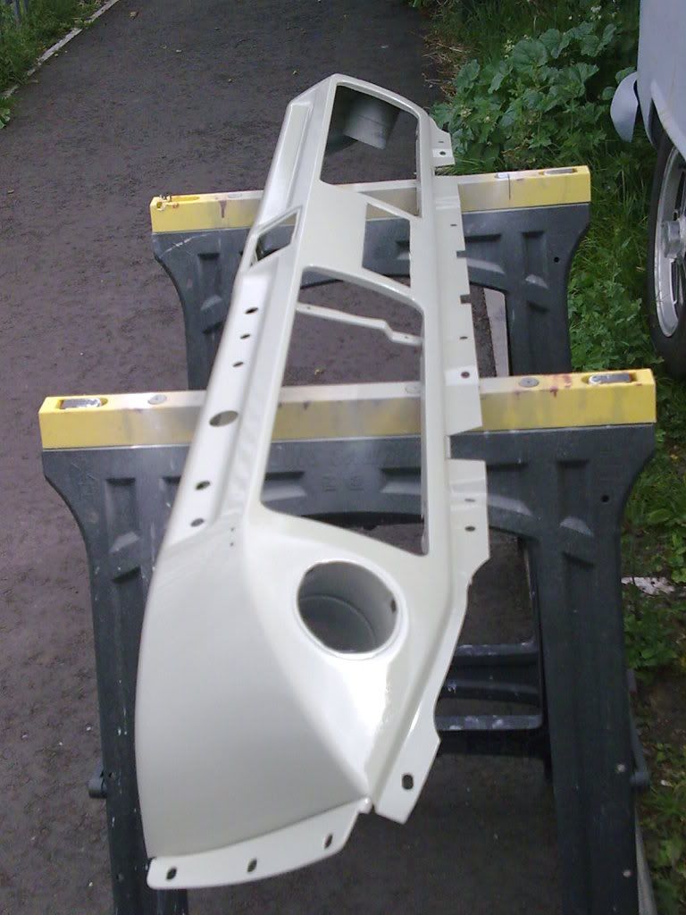

Cleaned and painted ash tray, fitted heater/flap levers(what a pain in the ass that was, need some more plastic plugs now....), fitted radio cage into oversize hole Evil or Very Mad
rusty nail to sow's ear - Page 3 Dash004

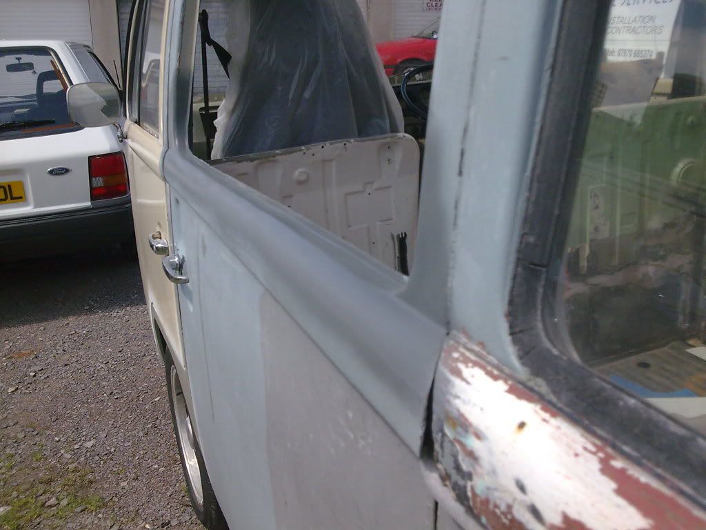

Folded panel around A pillars and seam sealed. Put doors back on. N/S side shuts a treat, O/S needs a bit of fettling.
A bit of filler and a coat of primer until I can finish it off properly. Finished welding the rear wheel tubs as well. Had a good day today.

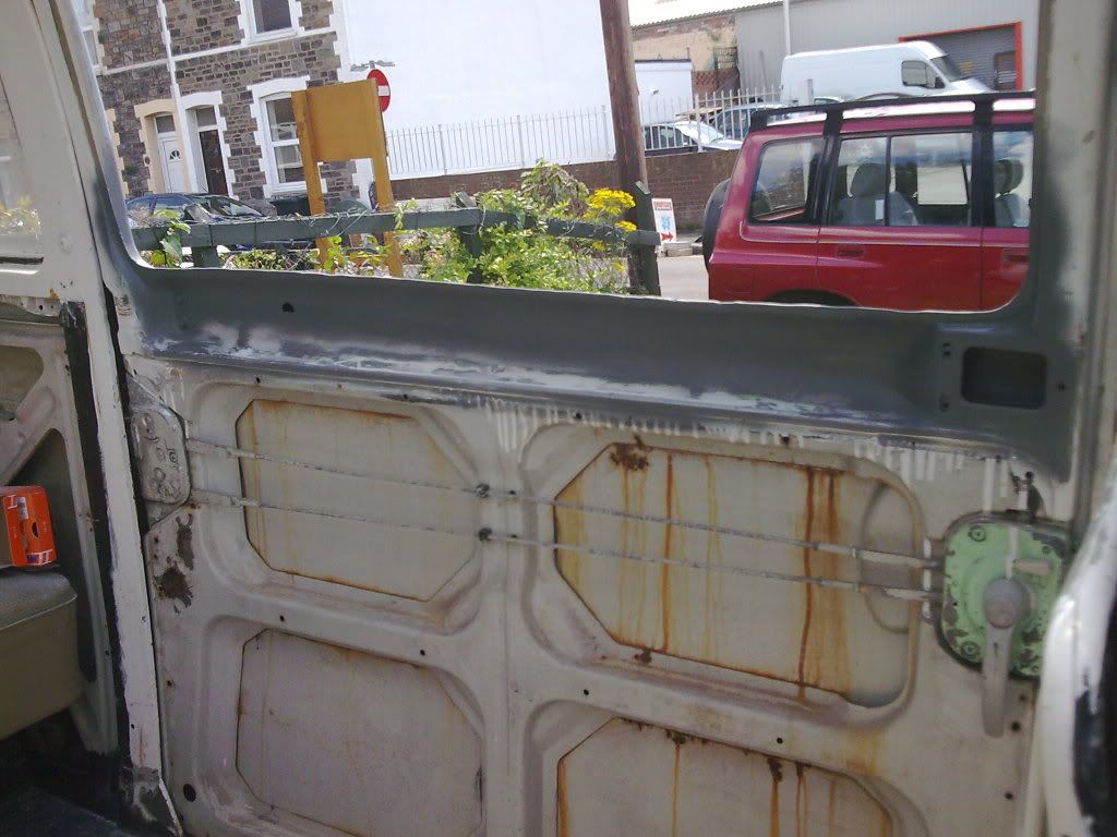

Wed 20th May 2009
Had a bit of a setback this week, bloody kids at the nearby school decided my bus would look better without windows. Evil or Very Mad
Luckily, they only broke the sliding door glass. But still £85 out of pocket after ordering new glass and rubber.
Sliding door needs repairing before glass can go back in, so yet another job elbowing it's way onto the list.....

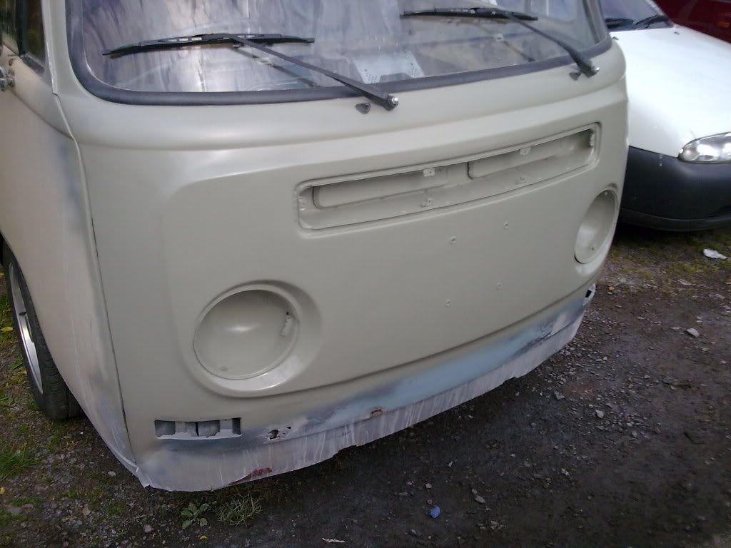

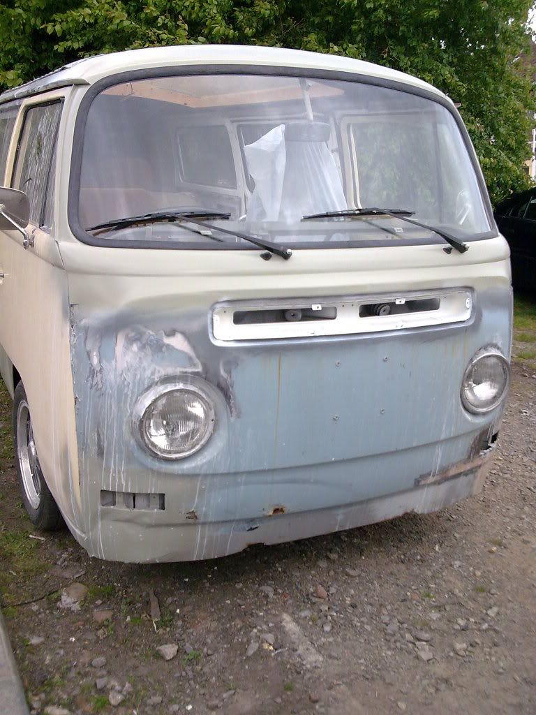

Sat 30th May 2009

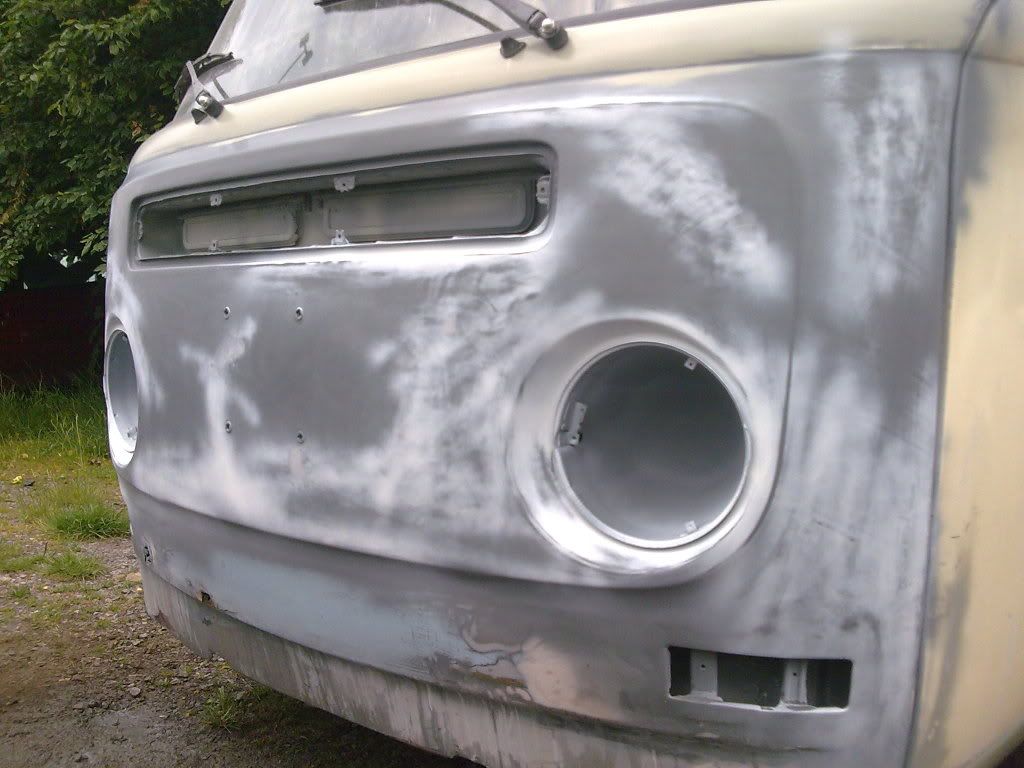

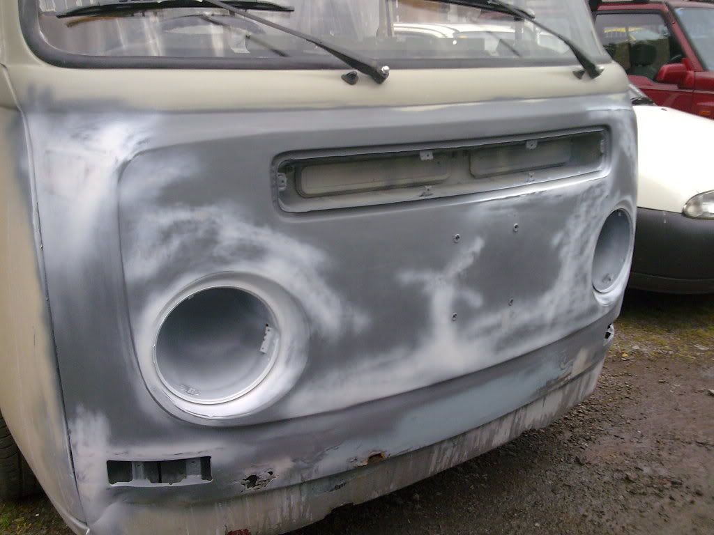

Regained a bit of enthusiasm today, and had another go at the front panel. Rubbed back again and another skim of filler.
However, I fitted a new upper front panel to the bus and this has a different size opening for the front grille. Evil or Very Mad
A couple of hours later and some reconstructive surgery......
rusty nail to sow's ear - Page 3 Frontpanel050
rusty nail to sow's ear - Page 3 Frontpanel051
rusty nail to sow's ear - Page 3 Frontpanel052

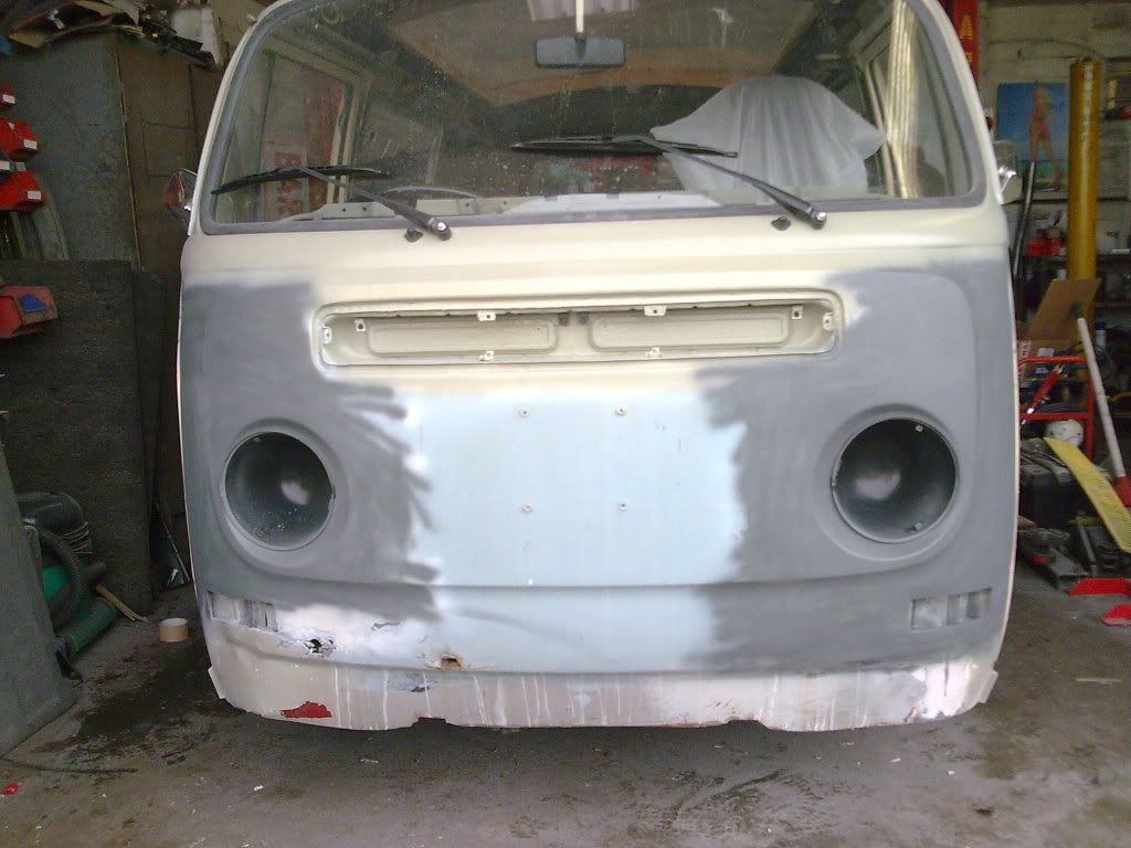

Doesn't look too bad.
A bit more fine wet and dry and a coat of primer.
rusty nail to sow's ear - Page 3 Frontpanel053
rusty nail to sow's ear - Page 3 Frontpanel054
rusty nail to sow's ear - Page 3 Frontpanel055
rusty nail to sow's ear - Page 3 Frontpanel056
Needs a bit more work, I think, there's a high spot under the n/s side of the grille that I need to knock back.

Tues 9th June 2009
After sleeping in a small tent at Bristol Volksfest, it's time to crack on with the bus again. Determined to get to at least one show this year.
Spent most of today filling and rubbing back many times, but managed to get a top coat on at last.
rusty nail to sow's ear - Page 3 Frontpanel057
rusty nail to sow's ear - Page 3 Frontpanel058
rusty nail to sow's ear - Page 3 Frontpanel060
rusty nail to sow's ear - Page 3 Frontpanel061
Plan to get another couple of coats on tomorrow and then refit the headlights and indicators. Very Happy

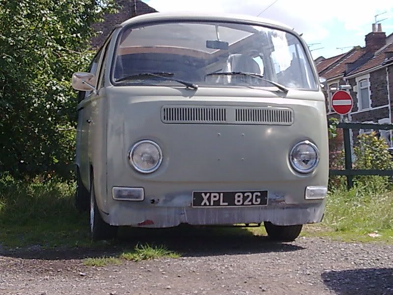

Wed 10th June 2009
Slapped some more paint on today. Put quite a lot on to get a decent depth of paint so got a couple of runs, hopefully they'll polish out.
rusty nail to sow's ear - Page 3 Frontpanel065
rusty nail to sow's ear - Page 3 Frontpanel069
rusty nail to sow's ear - Page 3 Frontpanel070
rusty nail to sow's ear - Page 3 Frontpanel071
rusty nail to sow's ear - Page 3 10thJune2009001
rusty nail to sow's ear - Page 3 10thJune2009002
Bit of an improvement on when it first arrived.

Sun 28th June 2009
Seems a long time since I last did some work on the bus. But this weekend it was time to repair the damage done by the schoolkids.
Cutting the rotten window surround out of the sliding door so I can replace the glass.
rusty nail to sow's ear - Page 3 Slidingdoor002
rusty nail to sow's ear - Page 3 Slidingdoor004
See how many coats of paint you can count, children.
rusty nail to sow's ear - Page 3 Slidingdoor005
rusty nail to sow's ear - Page 3 Slidingdoor006
Got to a stage yesterday where I'd had enough, just like being in a greenhouse with the sodding perspex roof.
Used a JK window surround repair and the centre section is nearly 2" too short.
Used an old door skin to repair the inner skin, as the bulge is nearly the same profile.
Ground the welds down, slapped some primer on and put the window in temporarily until the next time.
rusty nail to sow's ear - Page 3 Slidingdoor009
Don't think much of these new JK window seals. Wink

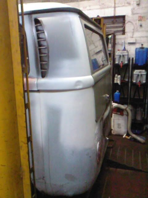

Mon 27th July 2009
Just an hour tonight, repair plate to floor behind bulkhead and a coat of paint.
rusty nail to sow's ear - Page 3 SP_A0082
rusty nail to sow's ear - Page 3 SP_A0084
Rear corner looks a bit more presentable now as well.

Thurs 6th August 2009
rusty nail to sow's ear - Page 3 6thAugust20092
rusty nail to sow's ear - Page 3 Thumbs

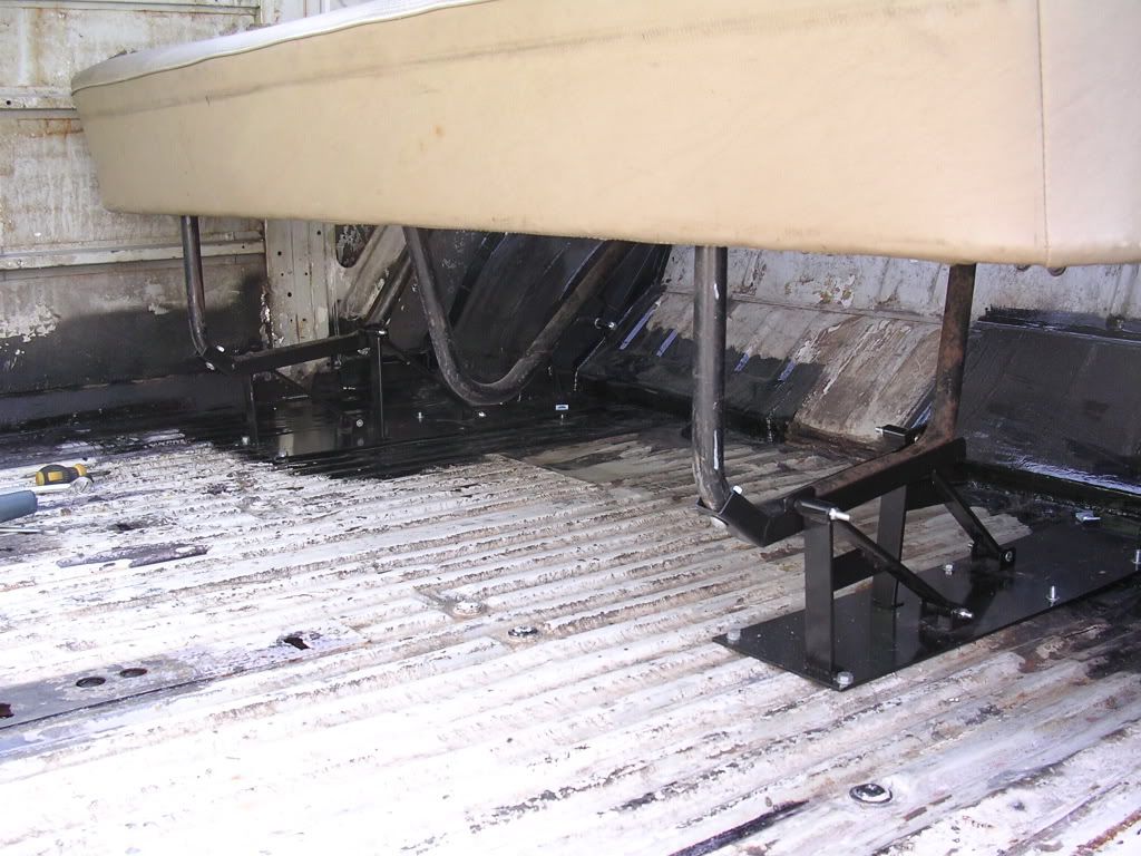

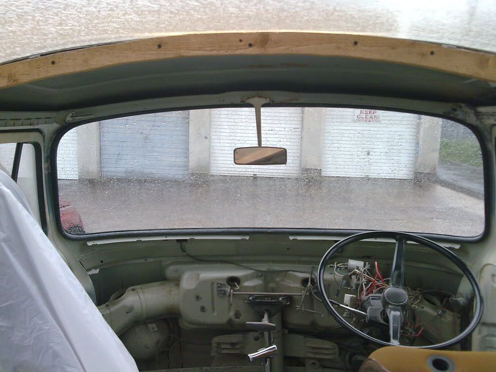

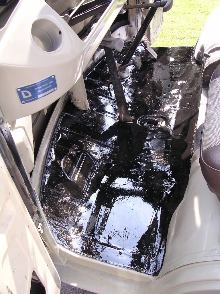

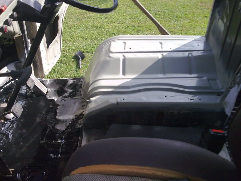

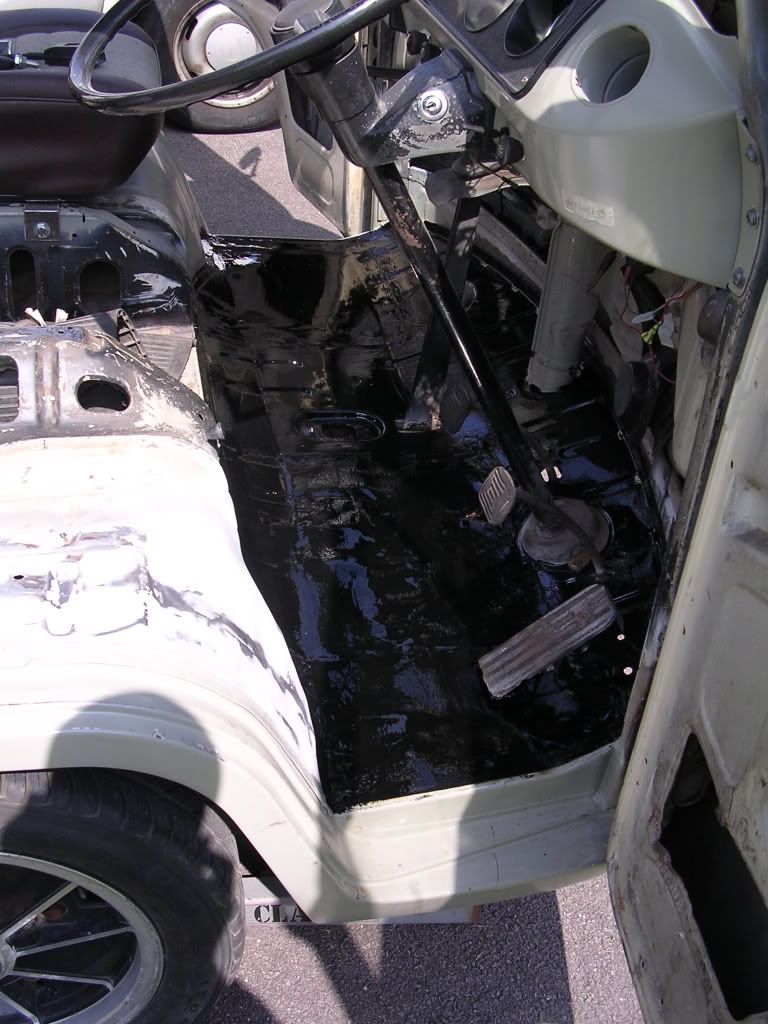

Sun 9th August 2009
Progress at home.
Stripped and painted cab floor.
rusty nail to sow's ear - Page 3 088
rusty nail to sow's ear - Page 3 091
Won't see the black under the cab mat, arches to be body colour.
Started the z-bed fit, drilled the fixing holes, now ready to scrape and paint the floor.
rusty nail to sow's ear - Page 3 Zbed001
rusty nail to sow's ear - Page 3 Zbed002

Mon 10th August 2009
I'm still pondering how to secure the bench seat to the hinges.
Can't bolt through the top as this will hit the hinge base, cant bolt thought the side as this interferes with the hinge.
Did think about a piece of threaded stud through the side with a circlip to secure it.

Wed 19th August 2009
Problem solved, going to tack a threaded stud to the bottom of the seat support and bolt through the seat runner. Smile
Another coat of paint on the cab floor and arch ready for the seat to be refitted.
rusty nail to sow's ear - Page 3 092
rusty nail to sow's ear - Page 3 093

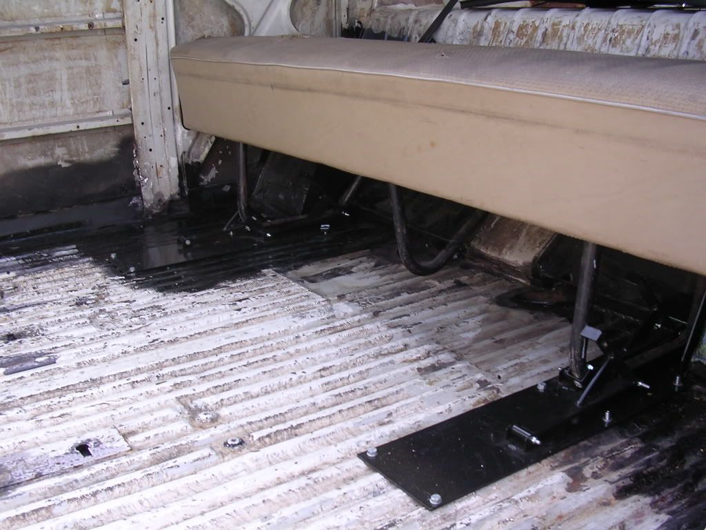

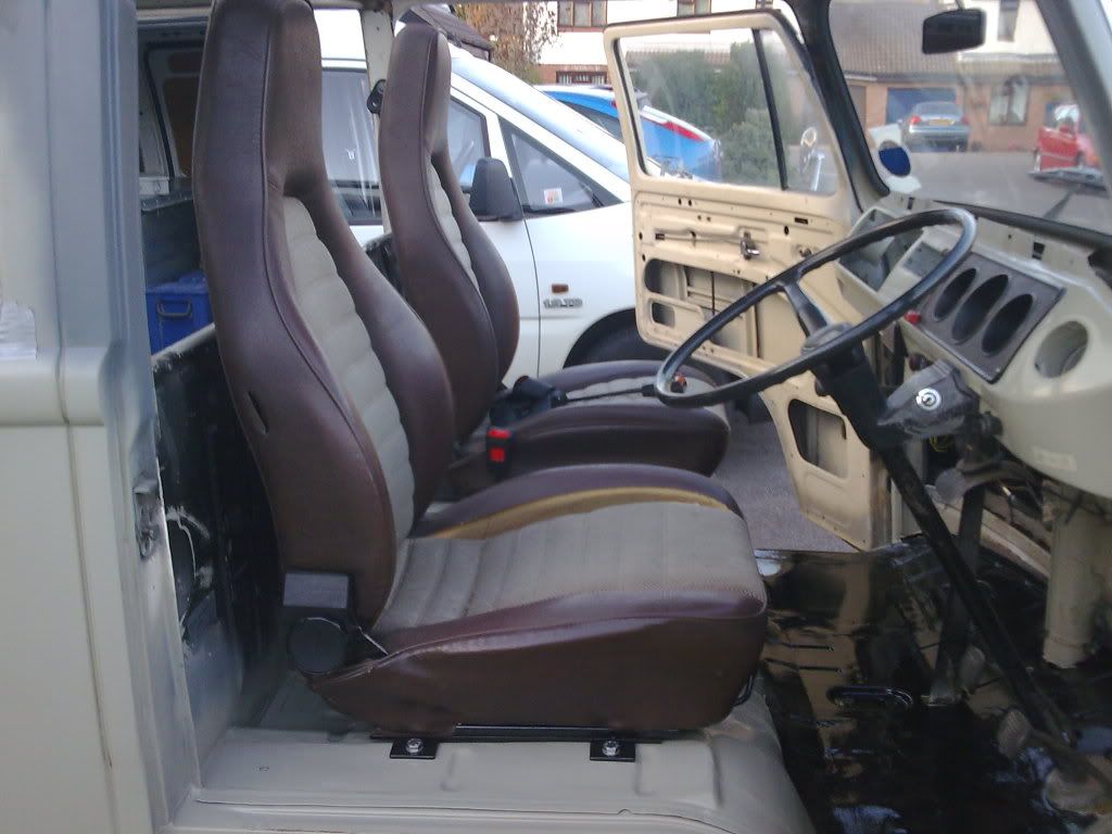

The good thing about having the bus on the drive is that I can fettle for an hour or so.... Very Happy
Driver's seat back in.
rusty nail to sow's ear - Page 3 Seatfit007
rusty nail to sow's ear - Page 3 Seatfit008
rusty nail to sow's ear - Page 3 Seatfit009
Let's see now, what shall I do next...
