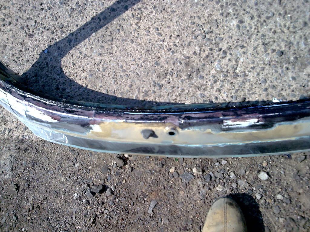

Inner arch plate on now, just needs tidying and a coat of underseal. Should have done this weeks ago.
rusty nail to sow's ear - Page 2 Osarch003
N/S arch ready for paint
rusty nail to sow's ear - Page 2 Nsarch011

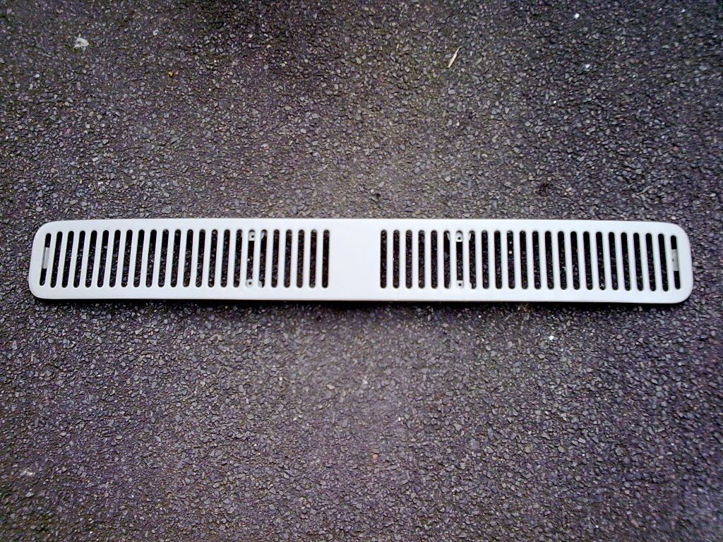

...and front grille ready to fit, just need the mesh now.
rusty nail to sow's ear - Page 2 Frontgrille006

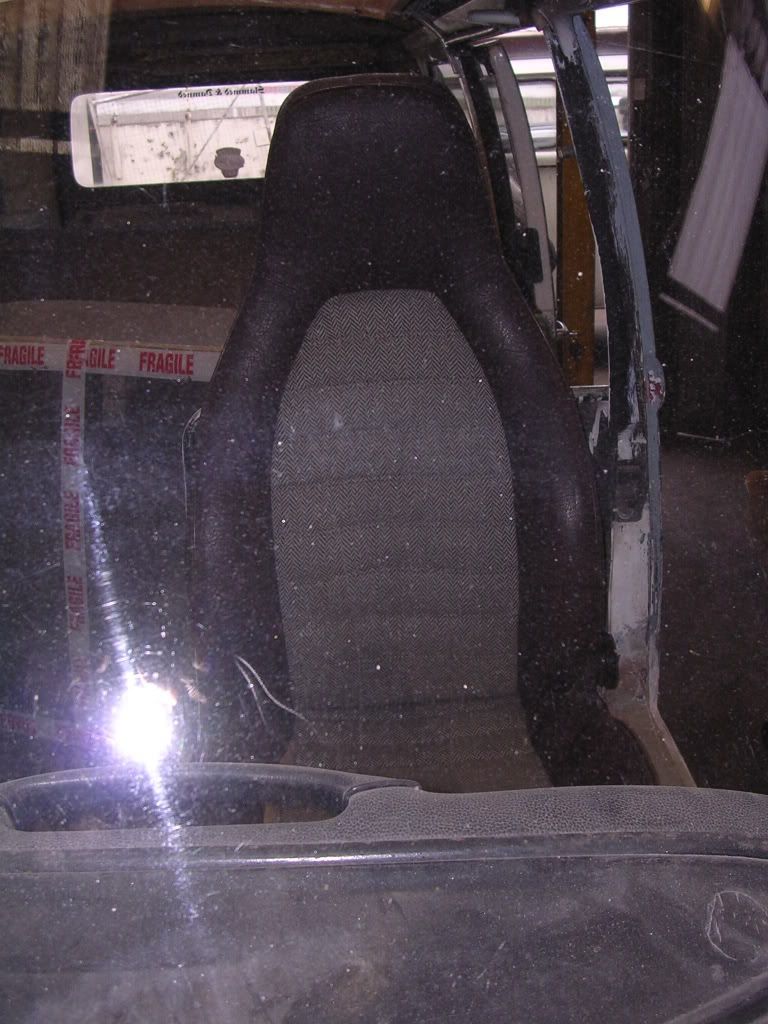

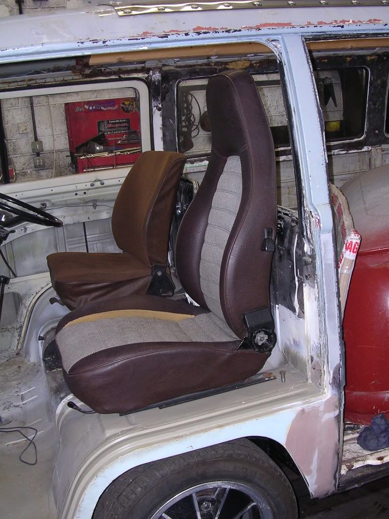

As work's a bit slow this week, and I'm fed up of falling over them in the garage, I've decided to have a go at fitting the Porsche seats this afternoon.
Out with the old....
rusty nail to sow's ear - Page 2 Seatfit001
rusty nail to sow's ear - Page 2 Seatfit002
....and in with the new
rusty nail to sow's ear - Page 2 Seatfit003

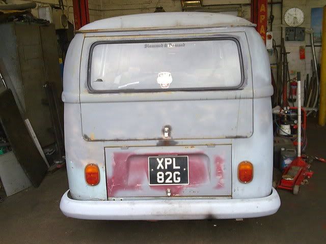

Sat 28th Feb 2009

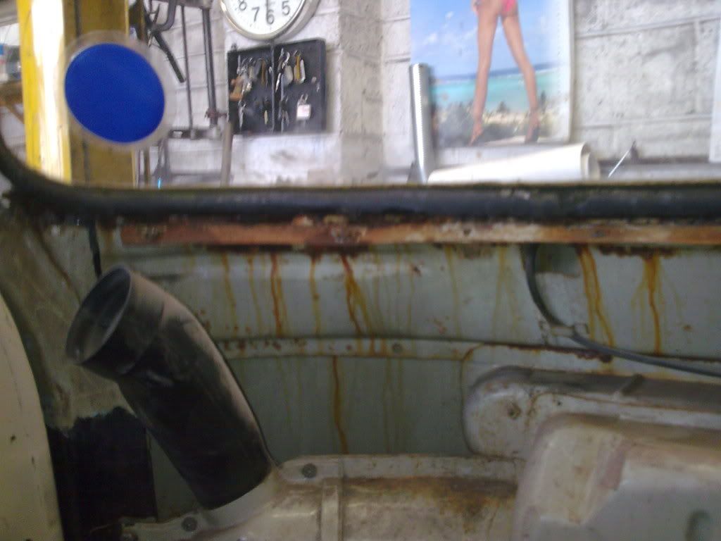

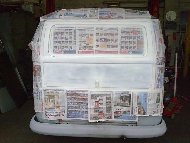

A bit of tidying today, cleared the cab area and under the seat bases. Started tidying the awful high build primer that the po sprayed on.
Quick rub down and mask.
rusty nail to sow's ear - Page 2 Rear001
rusty nail to sow's ear - Page 2 Rear002
Not to concerned about finish really, as the hatch needs repairing to the lower edge. But looks OK, much better than before. Another can of L345 gone. Smile

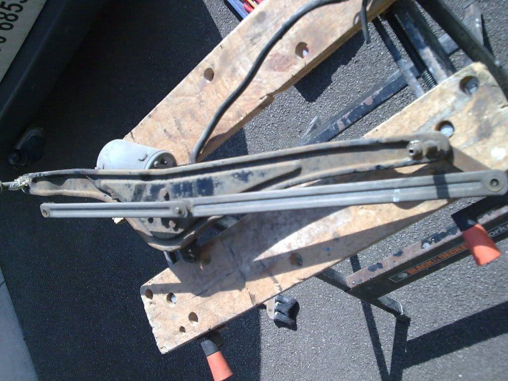

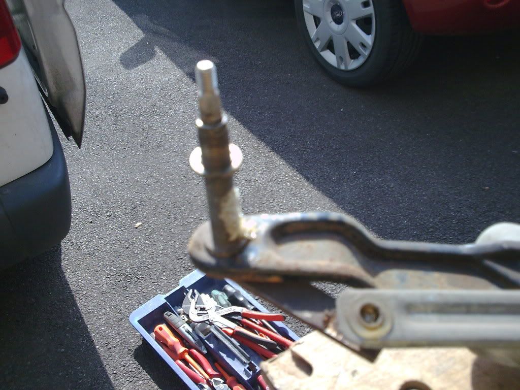

Throttle linkage decided to part company, so seems a good time to replace with the kit I bought nearly a year ago.
But not as straight forward as I would like. The short link from the pedal to the pivot is too short. Sad
rusty nail to sow's ear - Page 2 Image031
So will repair the original one and refit that.

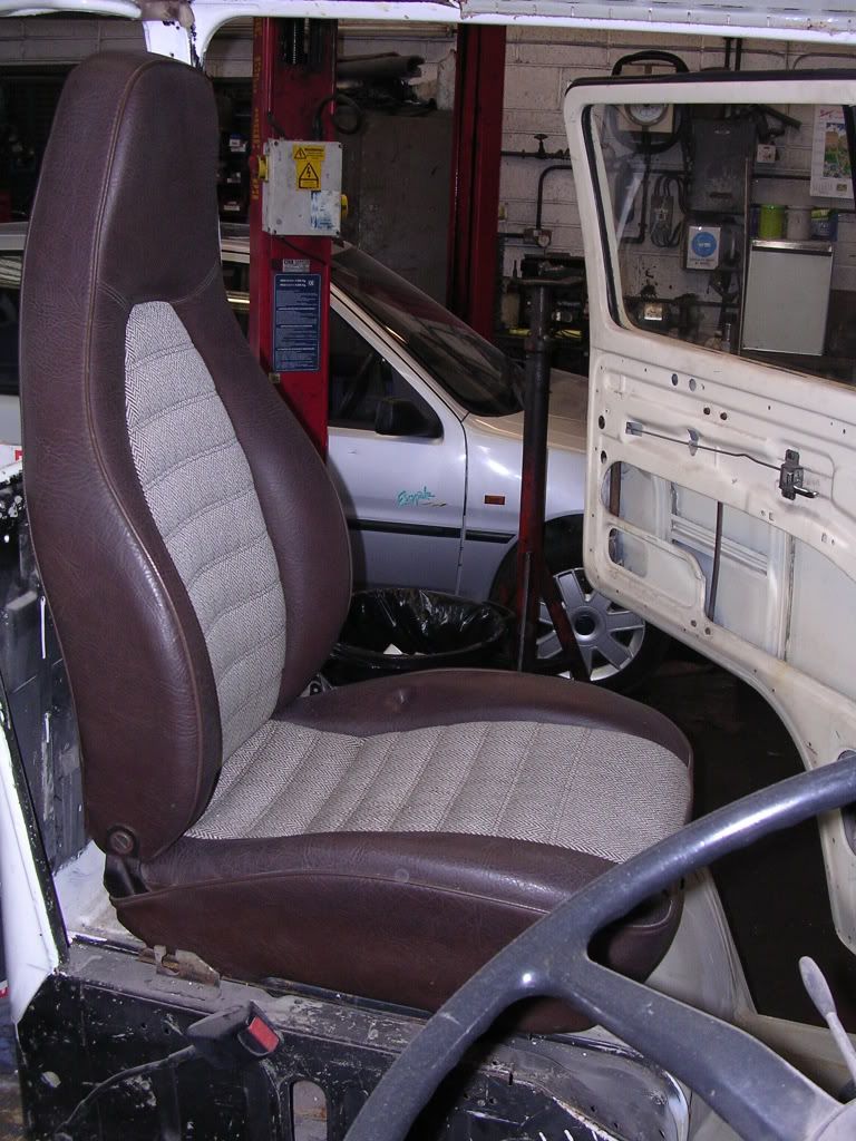

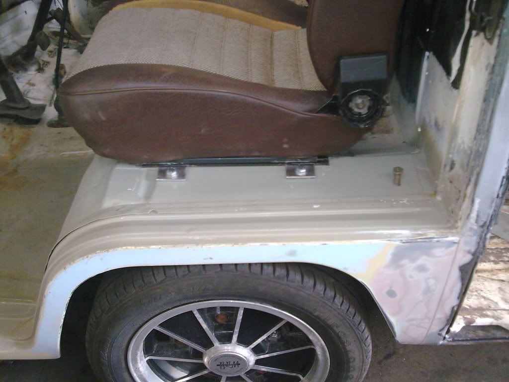

Had a good day today, finished fixing the passenger seat in. Welded a couple of brackets to the seat runners and bolted down to the wheel tub. Will look better when painted.
rusty nail to sow's ear - Page 2 Seatfit005
rusty nail to sow's ear - Page 2 Seatfit006

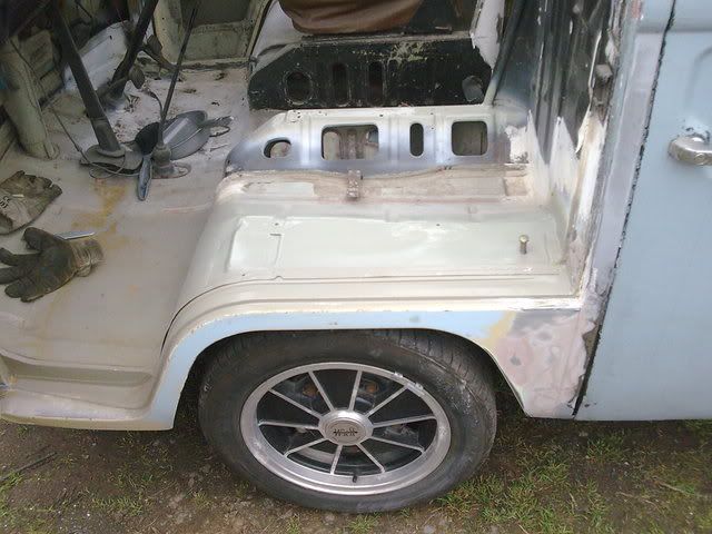

Finished (at last) welding up the os front wheel arch, just needs a coat of paint now.
Cleaned all the crap out of the cab and cargo area, looks much better for a clean. Smile

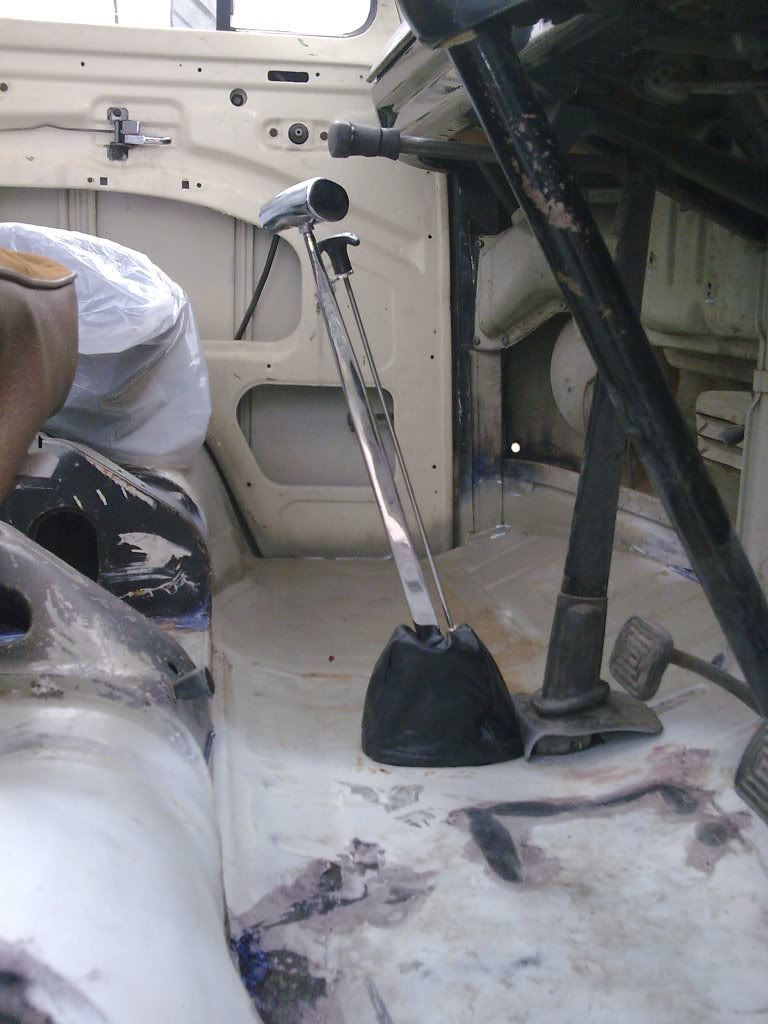

Replaced ignition switch and put Scat shifter in. Not bad for a tenner and I can find first gear first time now Very Happy
rusty nail to sow's ear - Page 2 Scatshifter001
Scraped some more paint off of the roof, may be able to rescue some og colour.

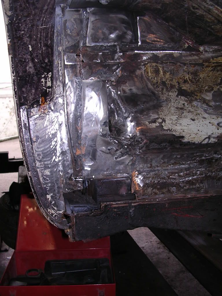

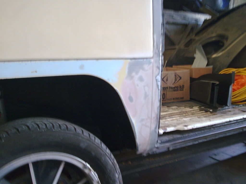

Finally finished the os front arch today (hoo-f**king-ray), seam and under sealed.
rusty nail to sow's ear - Page 2 Osarch037
rusty nail to sow's ear - Page 2 Osarch038

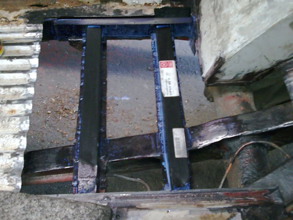

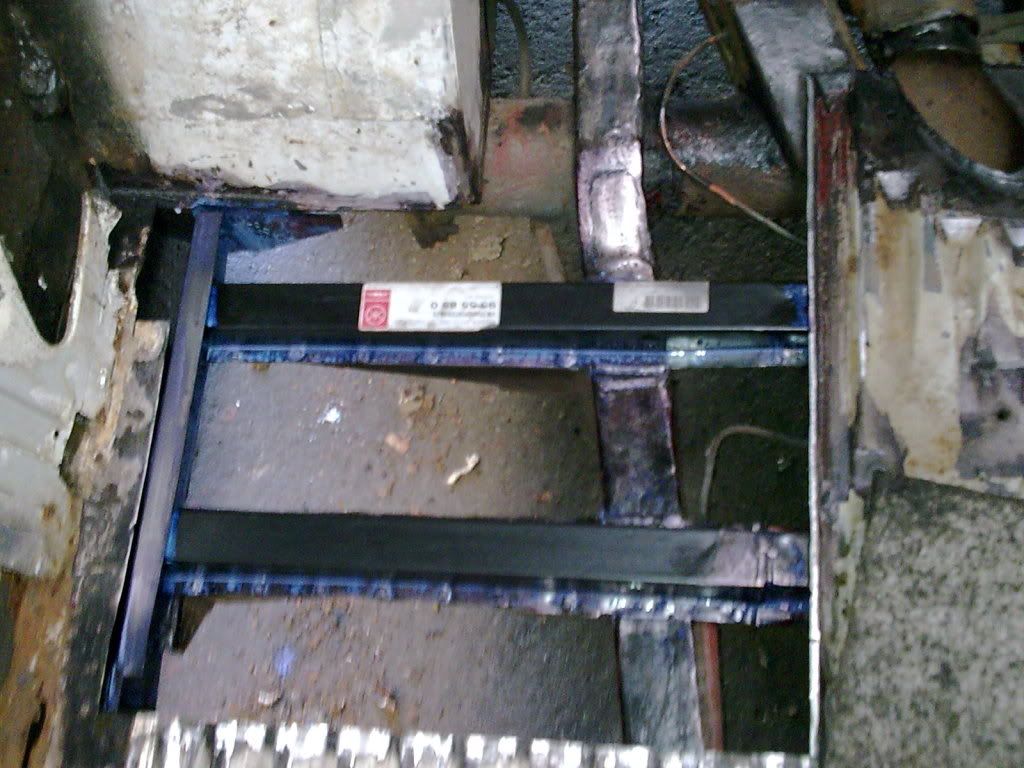

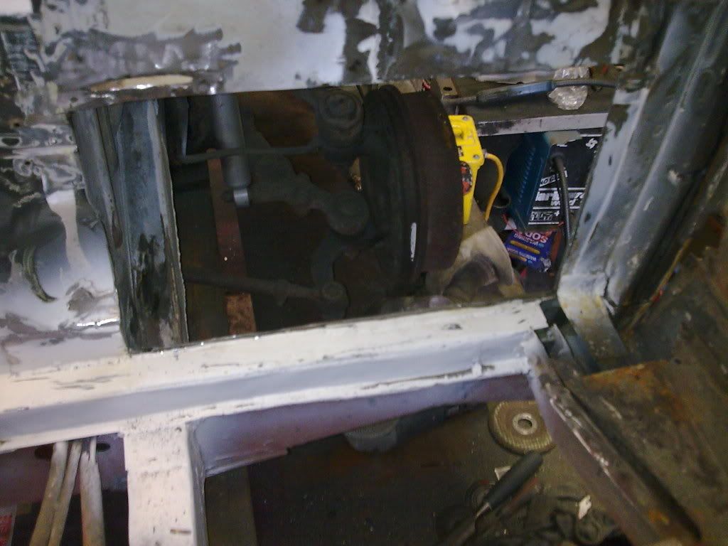

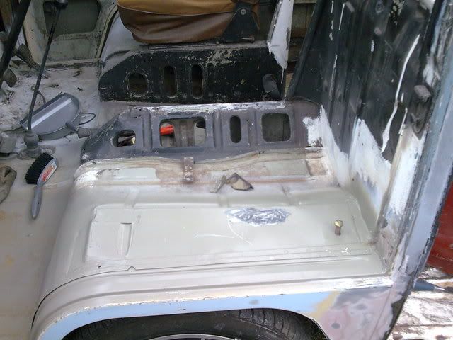

Cargo floor repair
rusty nail to sow's ear - Page 2 Osseatbulkhead002

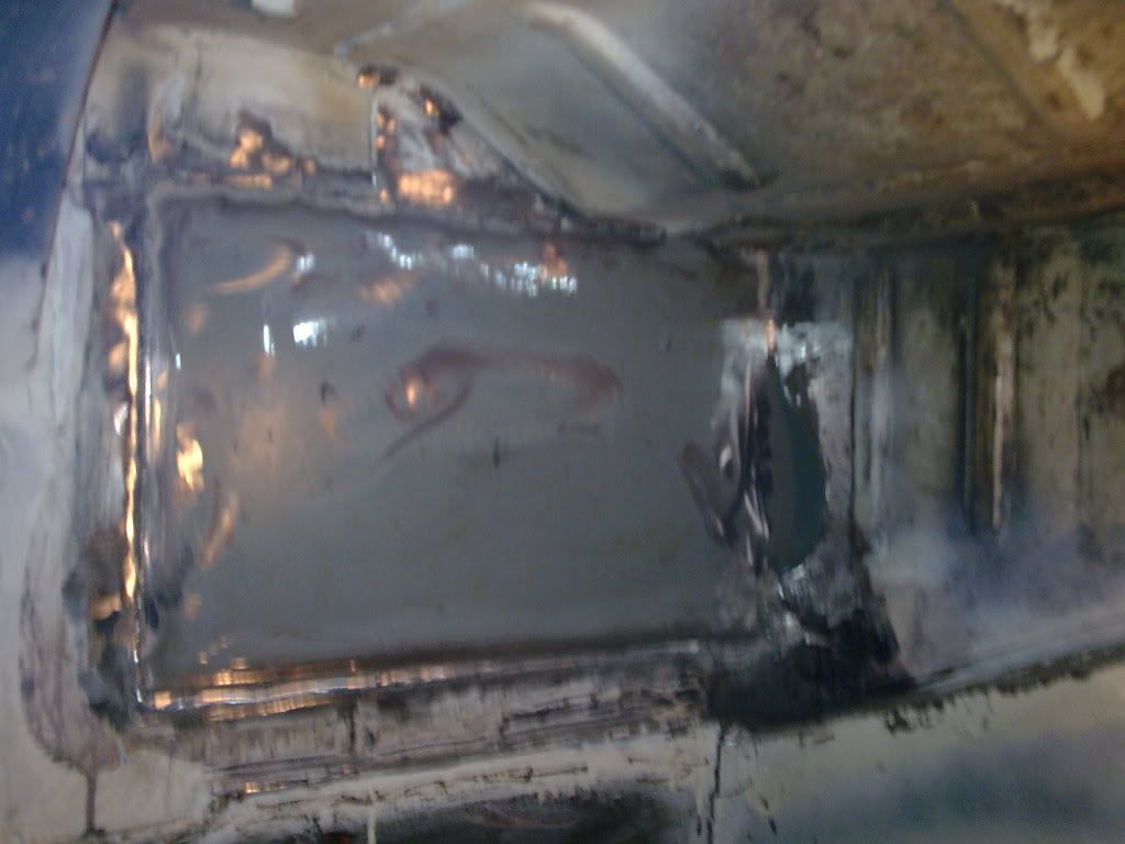

I have a confession to make, I was so chuffed after yesterday and the arches looking good, that I didn't measure twice and cut once.
So two plates instead of one.
rusty nail to sow's ear - Page 2 Osseatbulkhead003

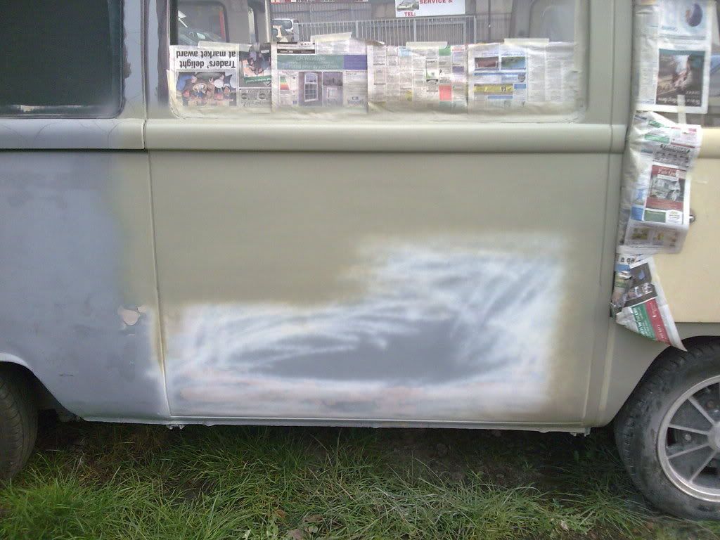

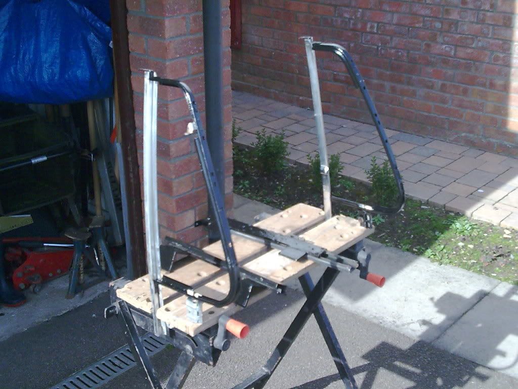

The weather was so good today, after cutting the grass front and back and doing some work on the garden and veg patch, I decided to strip my opening quarterlights, give them a rub down and coat of paint.
rusty nail to sow's ear - Page 2 Quarterlights001
Had a good couple of days on the bus Very Happy

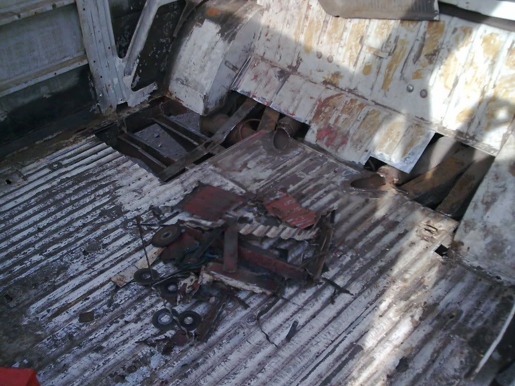

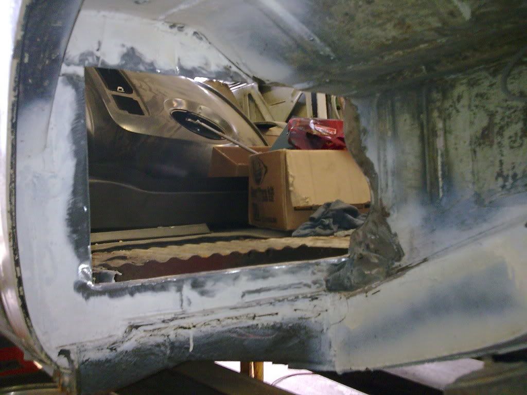

Another half day today, so on with the grinding.

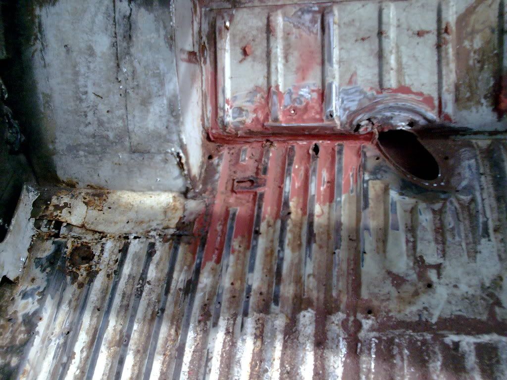

Thought I'd have a go at the small holes in the cargo floor.
rusty nail to sow's ear - Page 2 Cargofloor004
rusty nail to sow's ear - Page 2 Cargofloor005
No such thing as a small hole though.... Laughing
rusty nail to sow's ear - Page 2 Cargofloor006
I reckon my bus will be at least 20% lighter than when I got it, after cutting all the layers of metal out. Repairs on top of repairs.

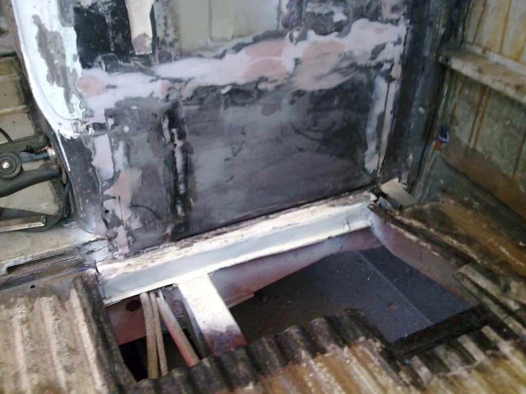

Sat 21st March 2009

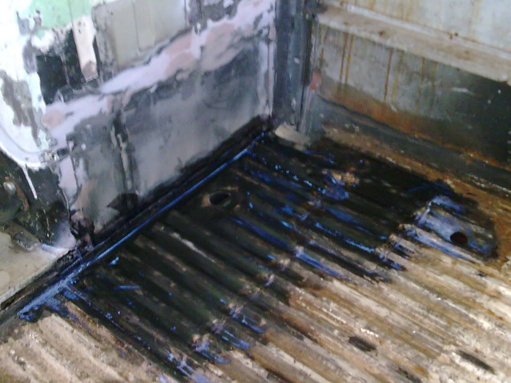

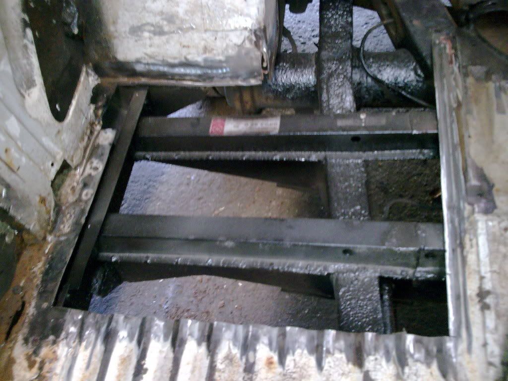

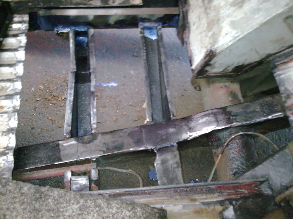

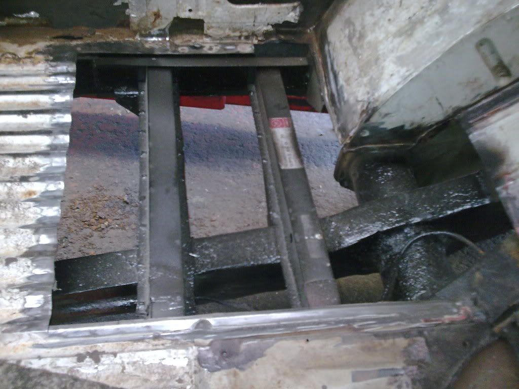

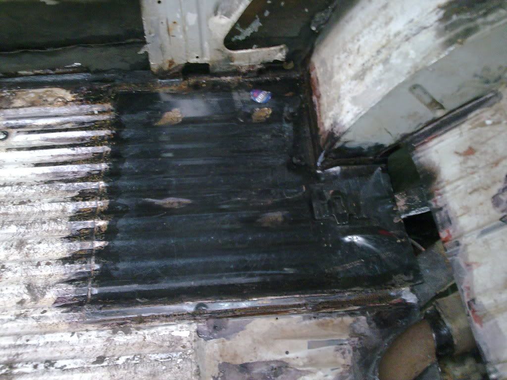

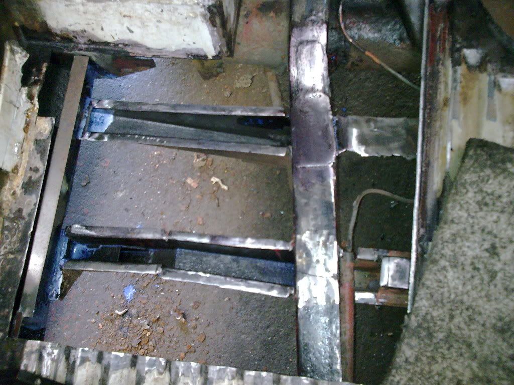

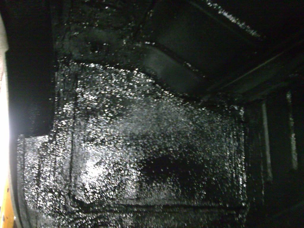

On with the floor.
Cleaned up and chassis leg repair plates,
rusty nail to sow's ear - Page 2 Cargofloor007
rusty nail to sow's ear - Page 2 Cargofloor008
top hat sections fitted,
rusty nail to sow's ear - Page 2 Cargofloor009
rusty nail to sow's ear - Page 2 Cargofloor010
undersealed,
rusty nail to sow's ear - Page 2 Cargofloor011
rusty nail to sow's ear - Page 2 Cargofloor012

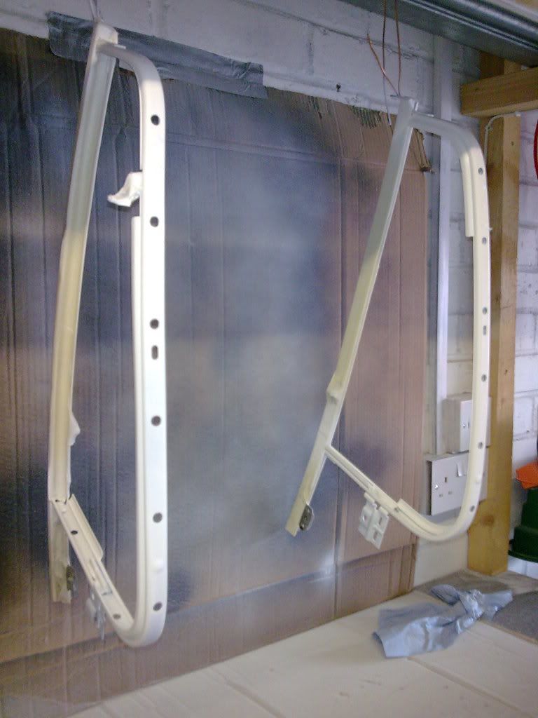

Sat 28th March 2009

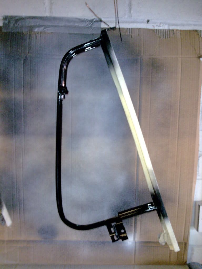

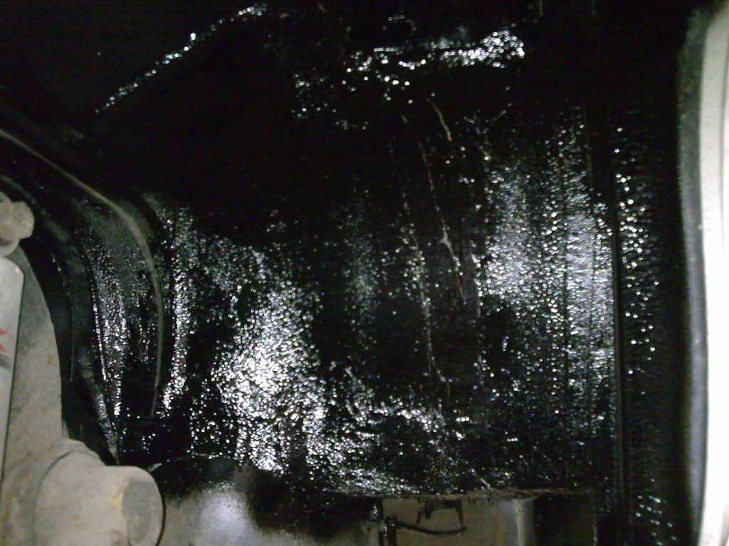

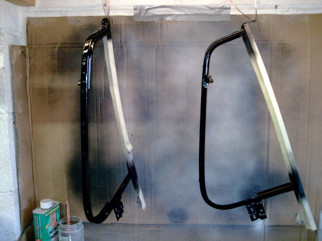

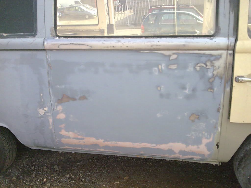

Cleaned and prepped my opening quarterlights last weekend, primered and top coated, looked ace.
Until last night that is, the black top coat has reacted with something.

Cargo floor finished this side.
rusty nail to sow's ear - Page 2 Cargofloor013
Fitted the repair panels to the engine bulkhead today, but didn't take any pics. Embarassed
Next week's task is to finish the cargo floor and make a rear wheel tub really solid to take a seat belt mount.

Friday 3rd April 2009
Had a day off of work today to get the cambelt done on the works van, so carried on with trying to cover the crappy primer.
rusty nail to sow's ear - Page 2 Offside001-1

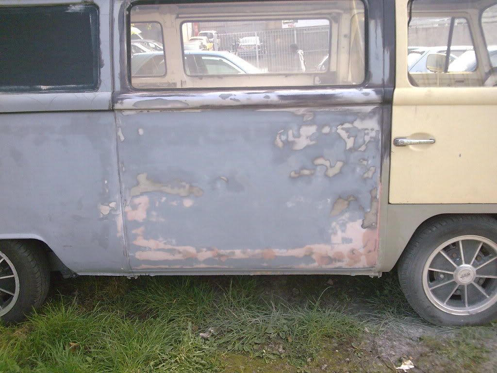

Panel doesn't look too bad at the top, needs repairing around the window opening and new rubbers and I'm going to replace the badly fitted lower repair panel with added tub of filler in the future. So not too worried about perfect finish.
rusty nail to sow's ear - Page 2 Offside002
rusty nail to sow's ear - Page 2 Offside003
rusty nail to sow's ear - Page 2 Offside004
The rattlecan started chucking lumps out instead of a fine mist, so gave up for today. Will order some more paint tomorrow and get a replacement for the faulty can.

Sat 4th April 2009
Cargo floor and wheel tubs cont.
rusty nail to sow's ear - Page 2 Cargofloor014
rusty nail to sow's ear - Page 2 Cargofloor015
New top hat and inner sill section
rusty nail to sow's ear - Page 2 Cargofloor017
rusty nail to sow's ear - Page 2 Cargofloor018
rusty nail to sow's ear - Page 2 Cargofloor019
Embarassed wheel tubs
rusty nail to sow's ear - Page 2 Nsrearwheeltub001
rusty nail to sow's ear - Page 2 Osrearwheeltub001
rusty nail to sow's ear - Page 2 Osrearwheeltub002
Just trying to rectify po's bodges. I don't think I can do much about the off-side inner arch without removing the side of the bus. I'll fit a plate to repair the top section and feather it in farther down to get the arch profile better.

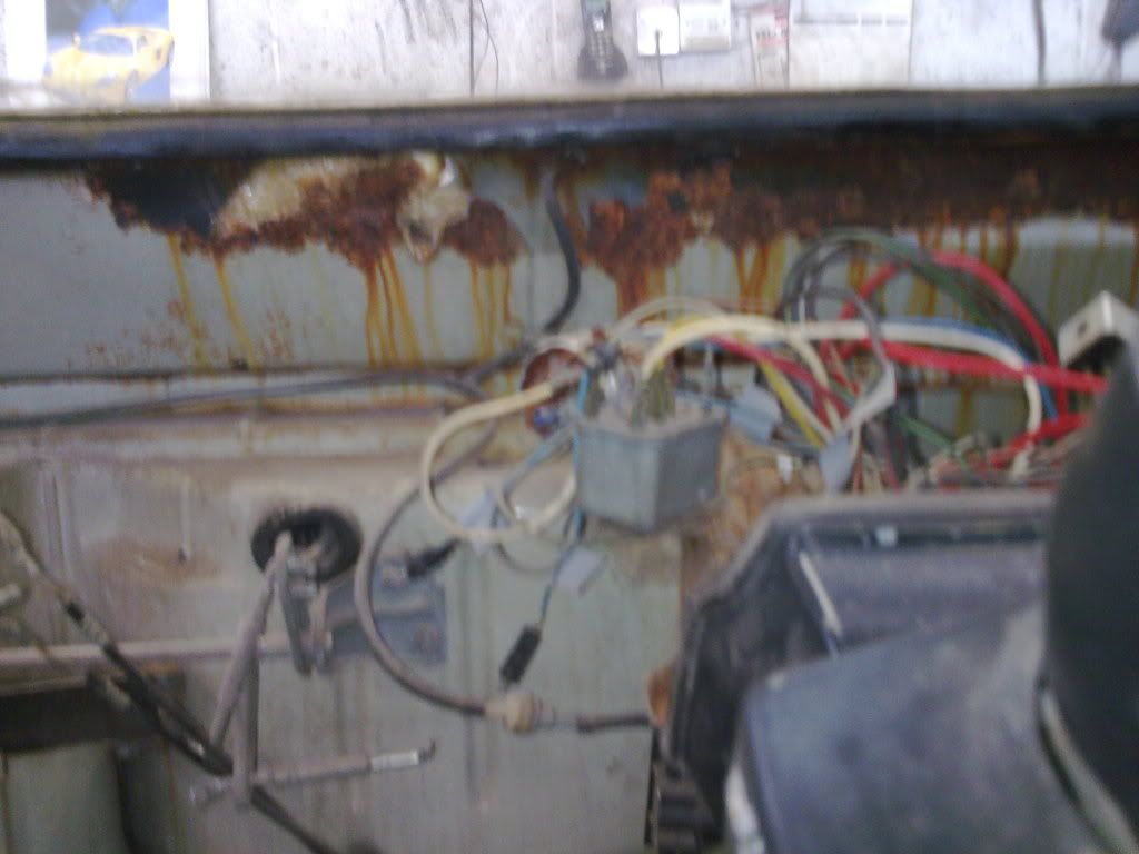

Stripped the dash today ready for the major structural job next weekend. Not as bad as I thought really....
rusty nail to sow's ear - Page 2 Frontpanel001
rusty nail to sow's ear - Page 2 Frontpanel002
rusty nail to sow's ear - Page 2 Frontpanel003
Got a windscreen cut yesterday from Graham at Midland Early Bay, so we're ready to chop the cab roof section over the driver's door and replace the rotten A pillars and windscreen bulge.
Happy with the opening quarter lights, which are now rust free.
rusty nail to sow's ear - Page 2 Quarterlights002
rusty nail to sow's ear - Page 2 Quarterlights004
rusty nail to sow's ear - Page 2 Quarterlights007

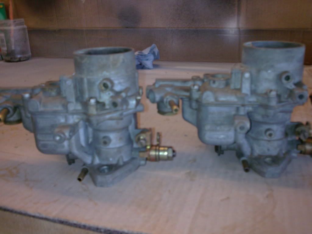

Oh, as an aside, I bought a twin port engine a couple of weeks ago for the princely sum of £60. Seems like a bargain, no endfloat, turns over by hand, etc.
I thought I would use it as a base to build a 1915 or something of that nature.
Anyway, the chap who sold it to me gave me a ring a couple of days later, to say he had forgotten to give me some other bits that might be useful and that he was putting them in the post.
These arrived today......

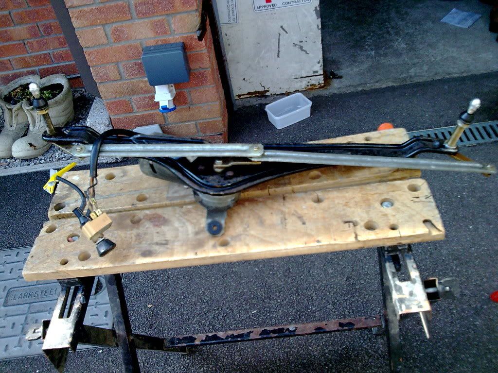

As I've stripped the front of the bus, it's time for a bit of work on the stuff I took out.

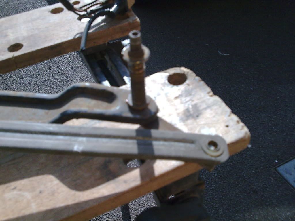

Cleaned wiper mechanism and replaced dodgy wiper spindle, what a pain in the ass that was.....
rusty nail to sow's ear - Page 2 Wiperassembly001
rusty nail to sow's ear - Page 2 Wiperassembly002
rusty nail to sow's ear - Page 2 Wiperassembly003
rusty nail to sow's ear - Page 2 Wiperassembly004

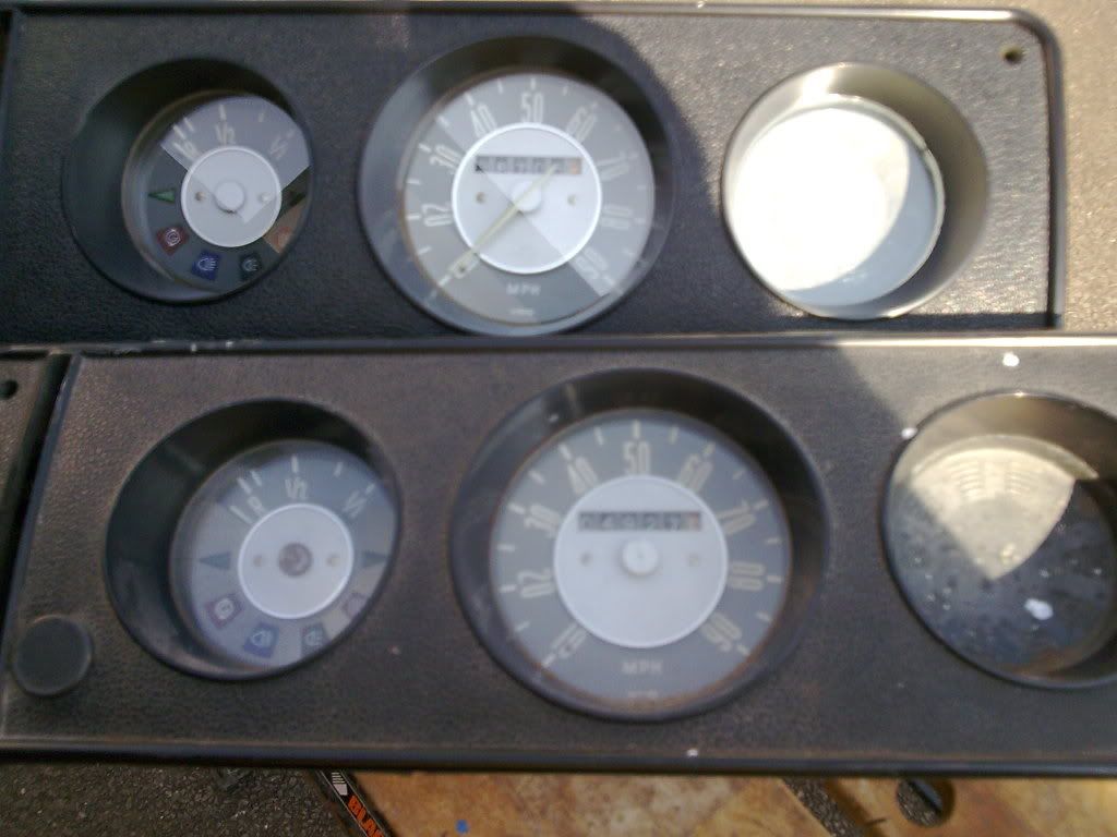

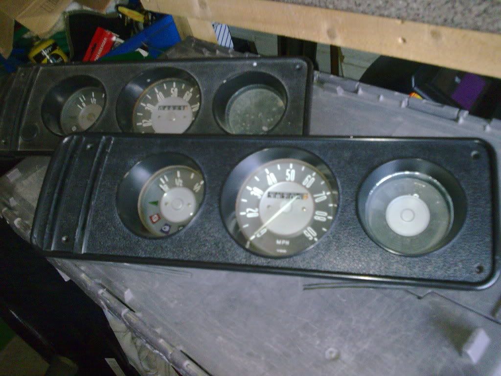

Changed speedo for one with a needle, cleaned and fixed dash pod and clocks.
rusty nail to sow's ear - Page 2 Dashclocks001
rusty nail to sow's ear - Page 2 Dashclocks002
Stripped eight layers of paint off and rustproofed wiper arms as well, but couldn't be assed to take a pic.

Monday 20th April 2009
Finally got some more paint on the off side middle panel, not too happy with the finish, but it'll do for the moment.
Cleaned up the roof where I'll be cutting this weekend.
rusty nail to sow's ear - Page 2 Offside006
Windscreen cut not as solid as I hoped. Sad Oh, well, a bit more repairing once it's in.

Back together again, relieved it's not scrap. Laughing
Just got to weld the B pillar fully and round the window opening. I've still to let some repair sections into the top of the windscreen bulge, a bit disappointed about that really. Then a bit of filler and paint, put the bus back together and then it's MOT time hopefully. Very Happy
rusty nail to sow's ear - Page 2 Apillars033
rusty nail to sow's ear - Page 2 Apillars034
rusty nail to sow's ear - Page 2 Apillars035
rusty nail to sow's ear - Page 2 Apillars036
rusty nail to sow's ear - Page 2 Apillars037
