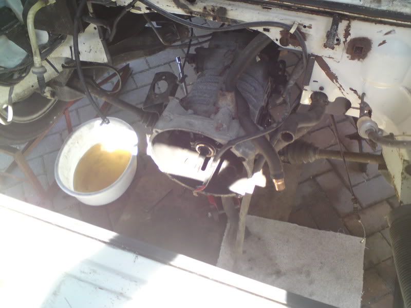

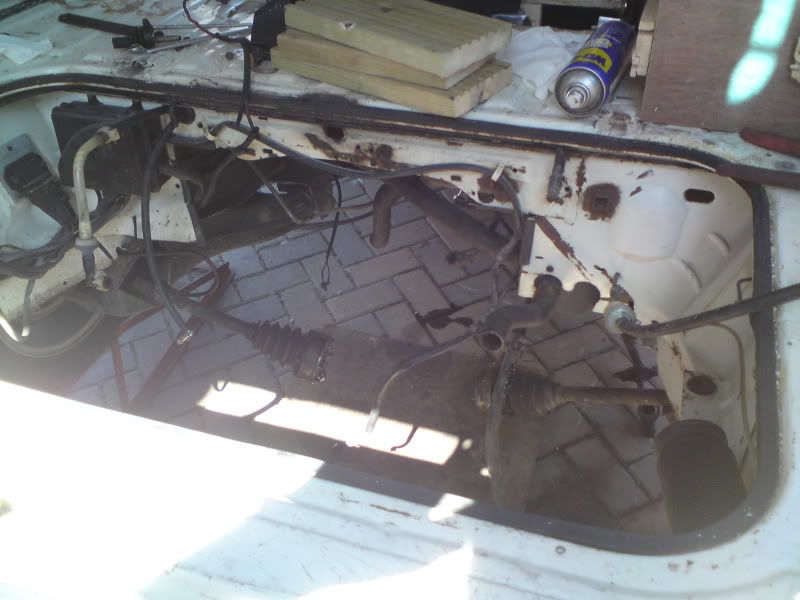

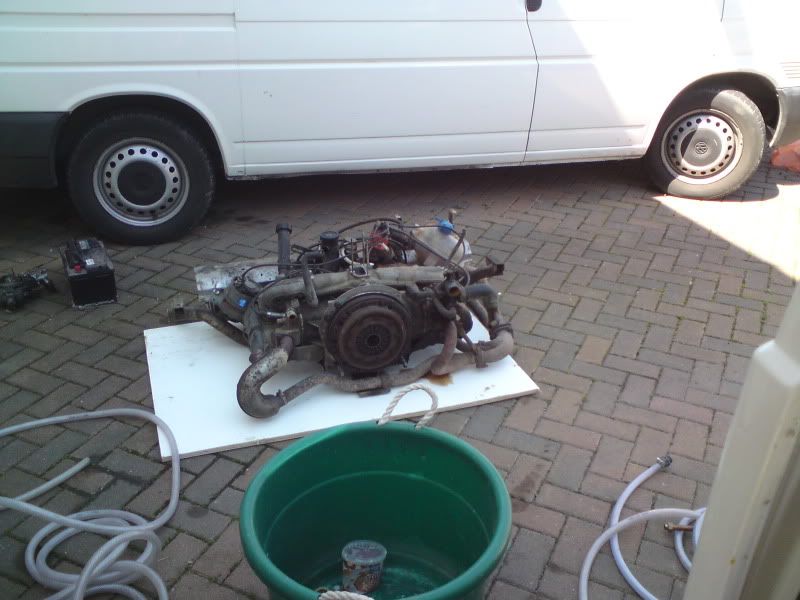

i then had a good idea the central heating power flushing pump i have i thought i wonder if that will connect on to those hoses Smile a bit of adaption with some copper fittings and hey presto sunny one pressure cleaned cooling system lol!
four king van - Page 2 Ebaycrap008

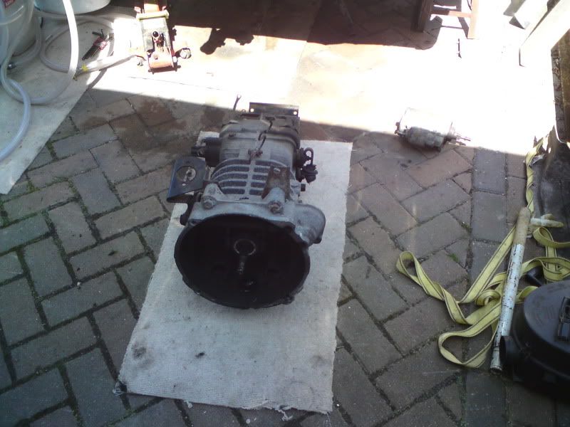

old un out ready to be stripped once it makes it in to the shed
four king van - Page 2 Ebaycrap010
old box out may go for rebuild if i get enough spare cash one month

the power flush in action, i was surprised just how much shit and rust there was in such a small system compared to a house. i didn't get anymore pictures of the re-install as it was getting late but idid get it finished in one day and back on the road just needs the mixture and timing setting to finish it off.

PostSubject: Re: four king van   four king van - Page 2 EmptySun Jun 14, 2009 7:59 pm
that flush is something i need to do, ive been told the main reason for the t3 getting hot is the rad building up with corrosion and crap,
have you noticed it cooler ??

powerflushing the rad is probably a bad idea ...as it will push all the loose stuff around and block the tiny waterway's up in the rad ............youd be better off using a more sympathetic method
PostSubject: Re: four king van   four king van - Page 2 EmptySun Jun 14, 2009 9:14 pm
PostSubject: Re: four king van   four king van - Page 2 EmptySun Jun 14, 2009 9:25 pm
taking the rad out ....and flushing manually
PostSubject: Re: four king van   four king van - Page 2 EmptySun Jun 14, 2009 9:33 pm
i will do that then lol
nooo nooo no, have you ever tried to change a rad on one of these fooking vans, it will be fine the pump can change directions of the flow and it drops all the shit and rust in to the bottom of the machine, besides which i left the drain hose open so all the rust and crap that came out on the first go went straight down the drain and the same on the second go in the opposite direction. then did a third go with clean water sunny
then did the heater matrix seperatly.
seems to be working fine now but i only got the new connector for the temp sender on there yesterday Smile i dont think it has a stat in it as the temp only went to the top of the 1st white marker just off the bottom of the gauge lol!

I use the powerflush machiene nearly every day ....if I don't isolate combi's from the machiene ...it blocks the plate heatexchanger up in no time .....the waterway's are also small in your van rad .....glad yours is ok ,but I wouldn't recommend to to others ..

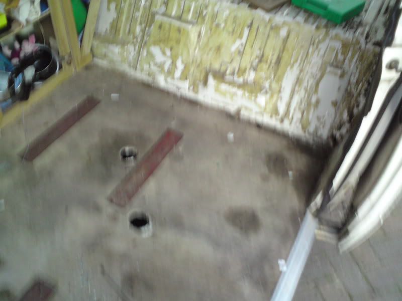

those red oxide strips are 1/2" thick steel welded to the floor, with 13mm holes tapped in to them. was converted to a minibus sometime before i had it, they got to go.

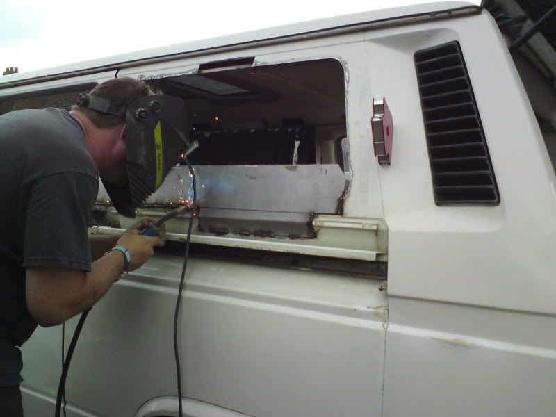

steve came round today done some of the welding started on the inside bits for the mot
four king van - Page 2 Resto007
four king van - Page 2 Resto006
four king van - Page 2 Resto005
four king van - Page 2 Resto008
four king van - Page 2 Resto004

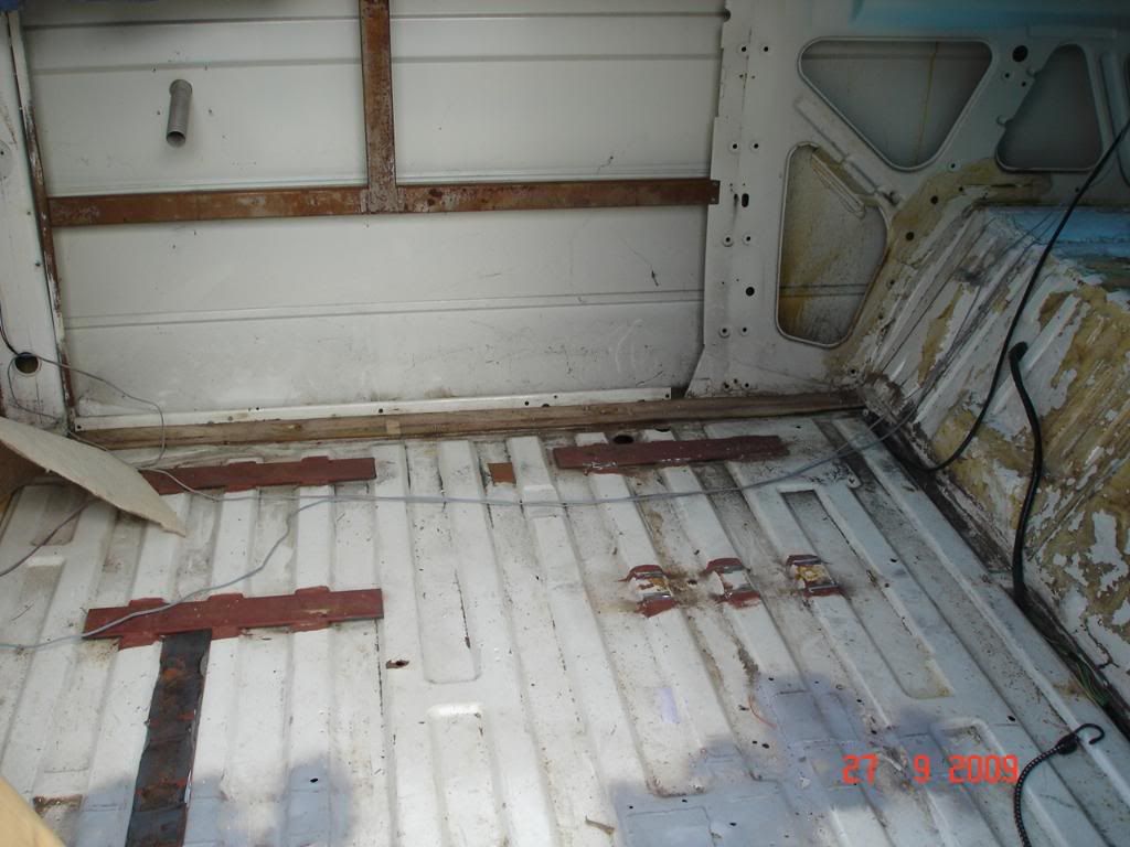

spent a couple of hours this morning stripping out the rest of the interior. as i don't use it as a camper all i want is the rock n roll bed and the fridge for some beer.
i did find a part wiring loom that turned out not to be attached to anything at either end of the van, poss from when had a goof gti lump in it.
four king van - Page 2 Septcamera007
i also cut out the 1/4" thick steel plates welded to the floor, for the seats from when it was a mini bus
four king van - Page 2 Septcamera008

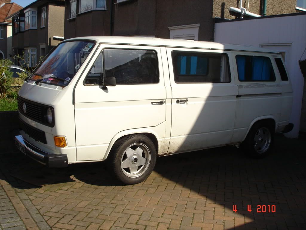

PostSubject: Re: four king van   four king van - Page 2 EmptyMon Apr 05, 2010 8:55 pm
hmm, need to do some work to this.
i have started to ply the floor.
and fitted the new wheels
four king van - Page 2 Aprilcamera018
but there a bit wide, split the paint on the arch and shredded the new tyre Rolling Eyes
four king van - Page 2 Aprilcamera019
