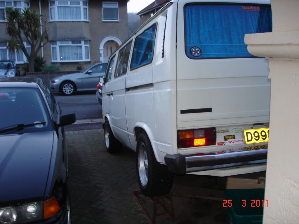

PostSubject: Re: four king van   four king van - Page 6 EmptySun Mar 27, 2011 7:07 pm
so hopefully next week i won't see this when i open my front door
four king van - Page 6 Vanengine003
PostSubject: Re: four king van   four king van - Page 6 EmptyMon Mar 28, 2011 8:38 pm
blimey - reversing onto them in a van is braver than i am, but then i am wimp lol Wink

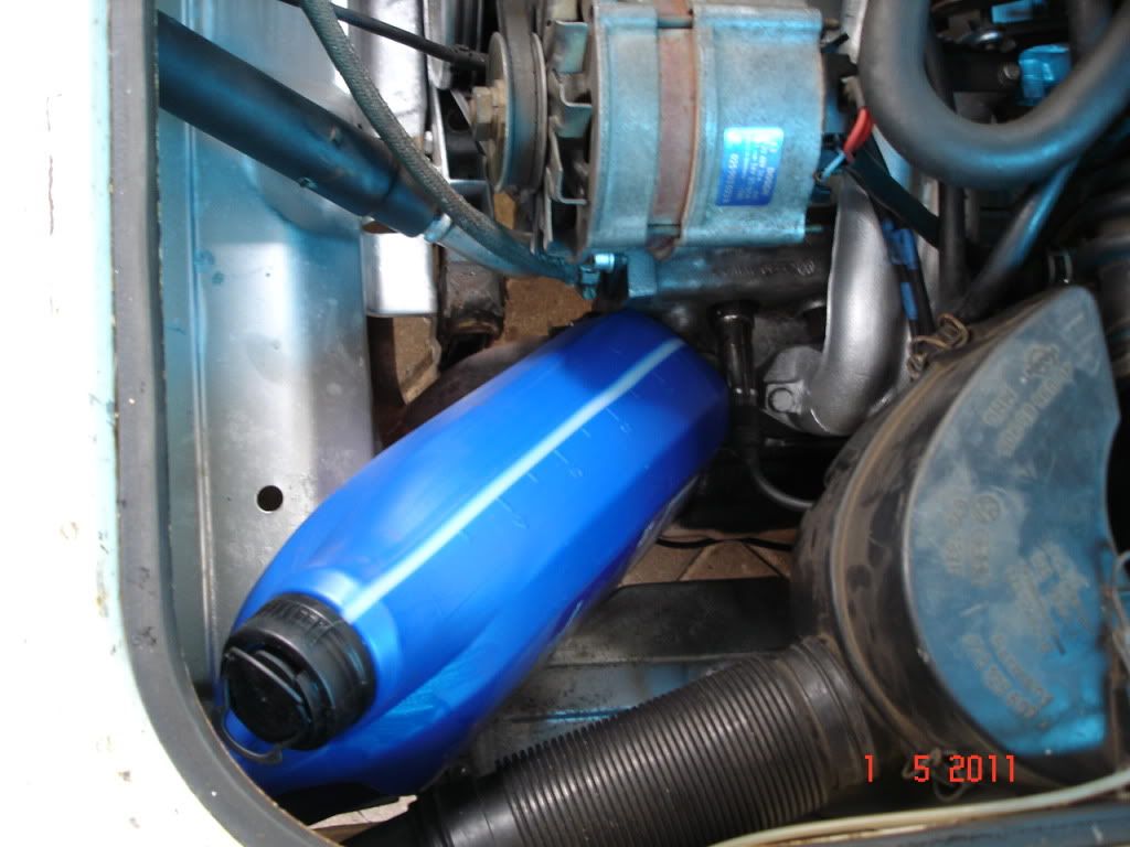

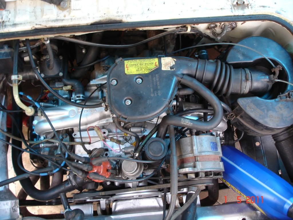

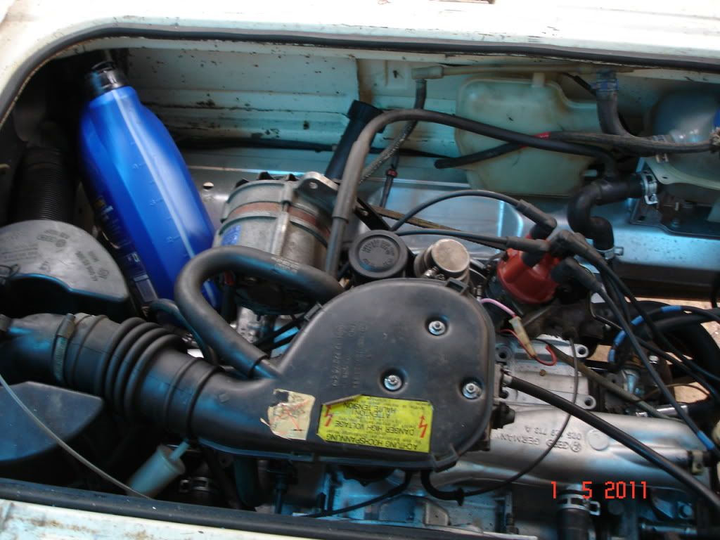

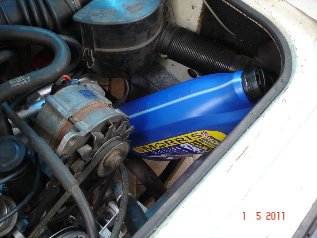

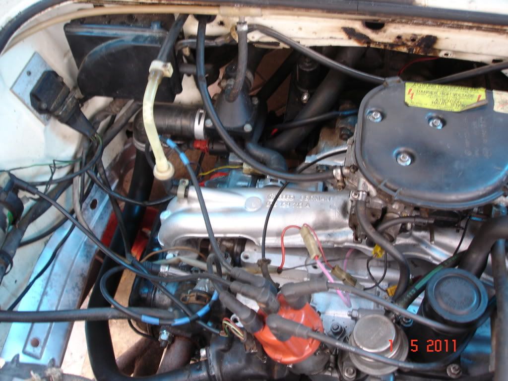

when you feel like you should have stayed in bed, and would have achieved more than i had yesterday.
i should have known when, the first job was going wrong, looking for the empty oil can, to drain the old engine oil into. could not find it anywhere so used an empty 5 litre cider container. i lifted of the engine hatch to see this Shocked
four king van - Page 6 Knackeredengine006
four king van - Page 6 Knackeredengine001
four king van - Page 6 Knackeredengine002
it must have fell in there last thursday down at burnham, the oil warning lamp came on, so i checked the oil, topped it up. i had the bed propped up and the engine hatch wedged under that it must have fell in then What a Face
