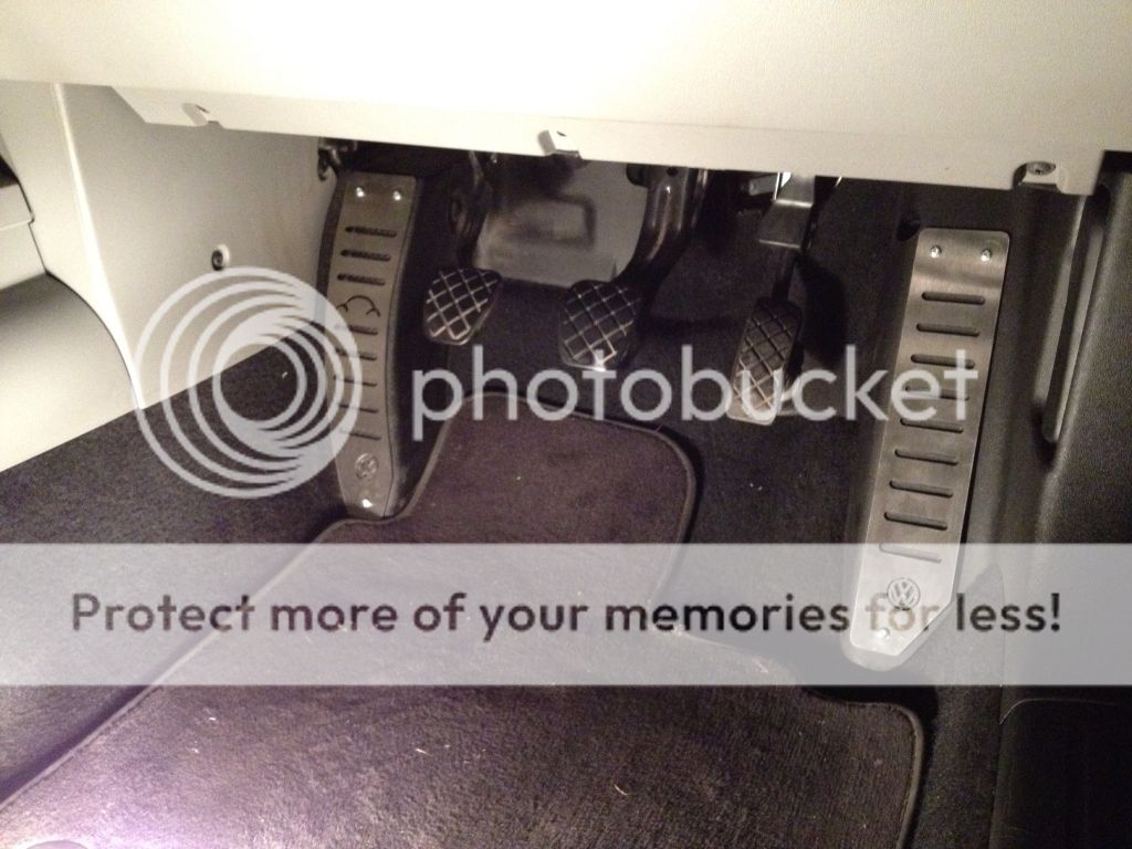

LJ - 20v 1.8T newbie De8230a9d41f91c77ae09904d609dd7b

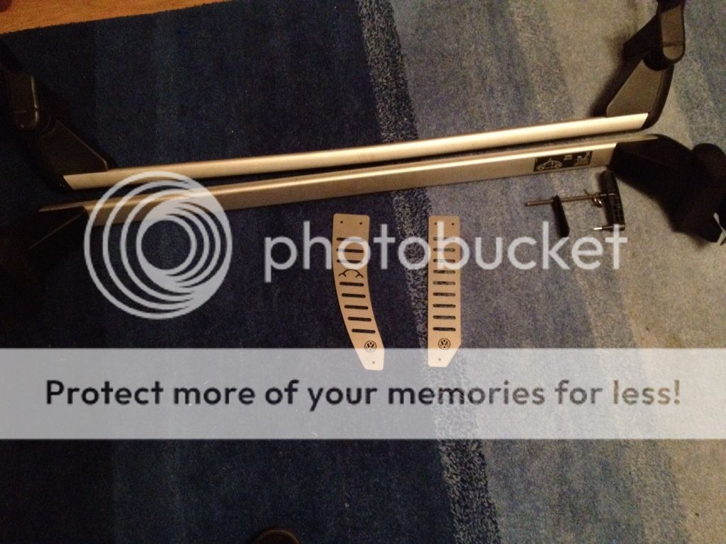

Dead pedal covers fitted (new mats now fitted from dealership)
LJ - 20v 1.8T newbie 5a952ea4a32d5ca139de46aab7481c2c
Bought locking genuine VW roof bars, for trips to Cornwall Wink

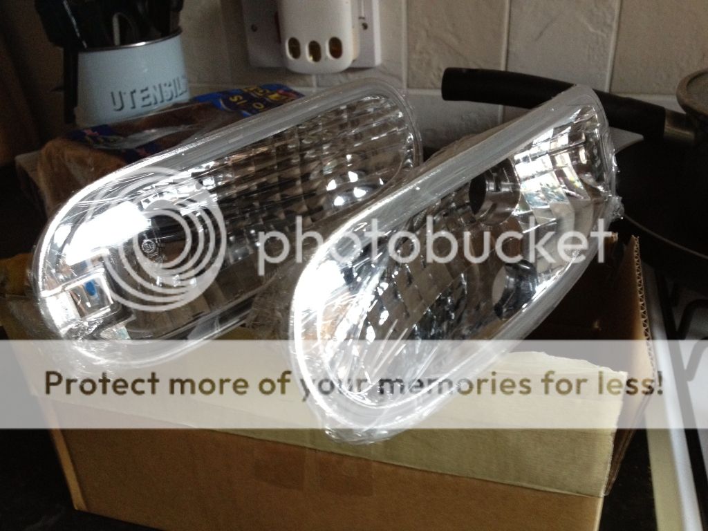

Bought some crystal indicator lenses and diadem bulbs
LJ - 20v 1.8T newbie B38b343ab1ef042e54bf5b9f330388ce
LJ - 20v 1.8T newbie 184e0f193b6d25e92a764d926bfadb68
LJ - 20v 1.8T newbie 2797b6972035ac970ce8a1520a3a423b
Looks much better now

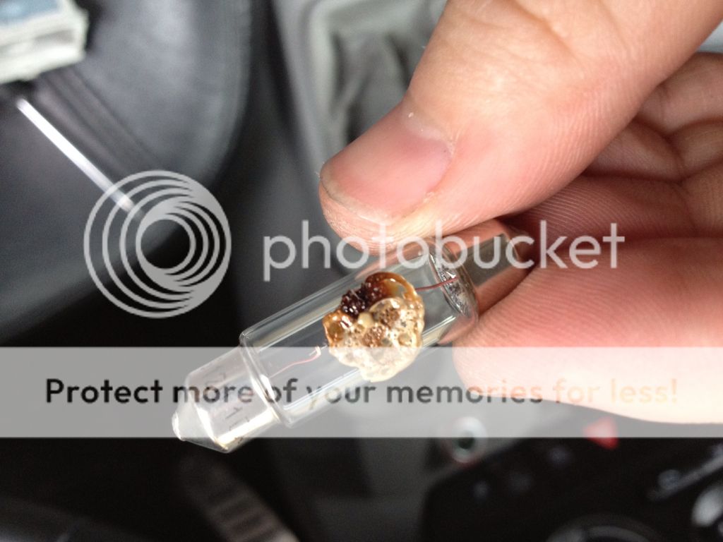

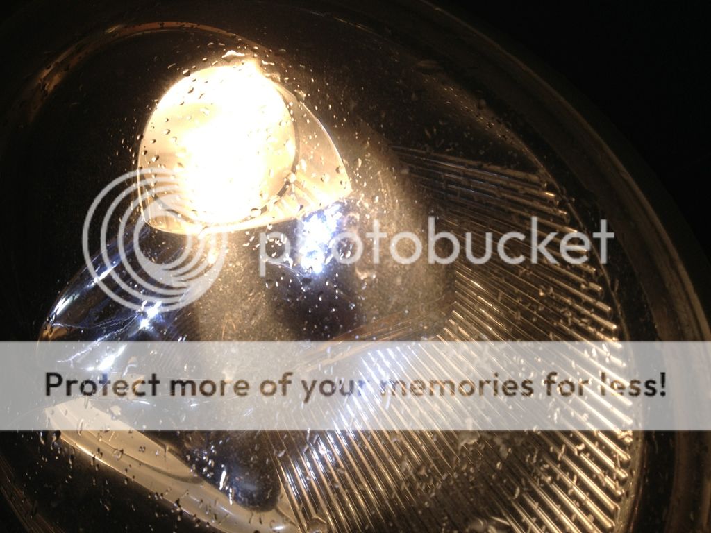

Fitted bright white LED bulb kit: interior vanity mirrors, mirror, reading lights, puddle lights...
... One of which had got a bit hot..

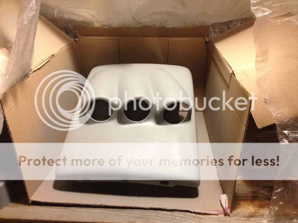

Bought this for 40notes off eBay ..
LJ - 20v 1.8T newbie 0ef3a3fc19f41b70b9edd72b193eb94a
Rhd version of Bernt pod Smile only seen these as Lhd USA version ...
Just need to order up gauges from new south performance to match the Oem gauges ..

Going to take a mould of this gauge pod before I fit it. Ordering gauges today Wink

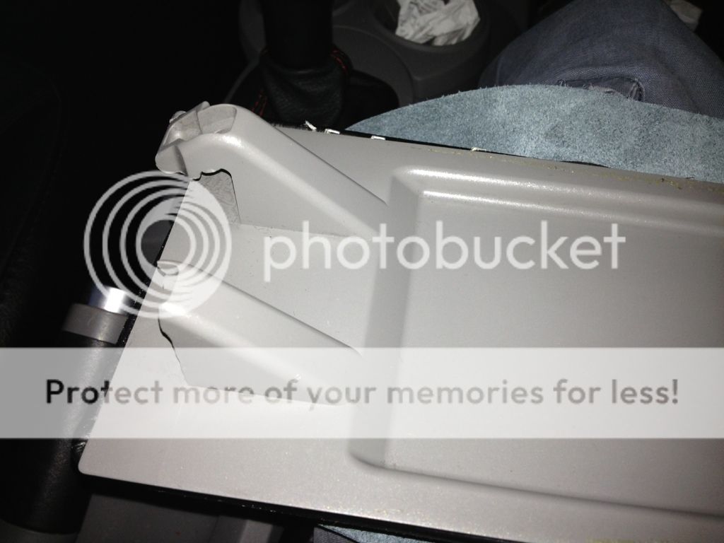

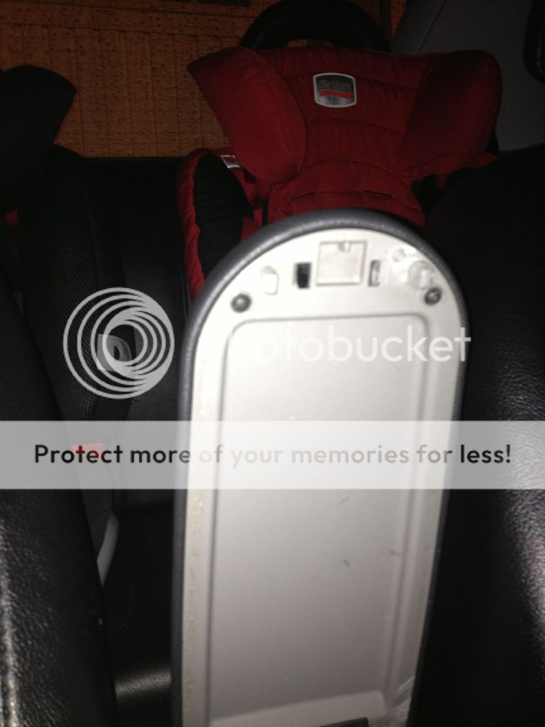

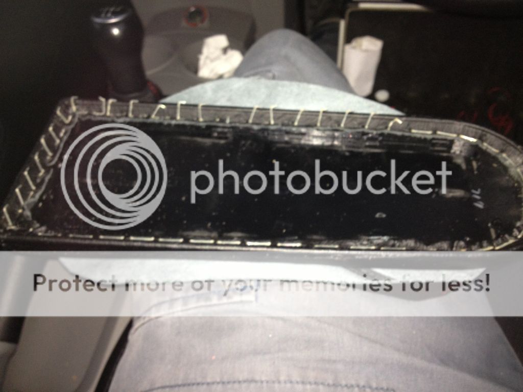

replaced the centre armrest leather to match and repaired the centre armrest hinge.
held with lots of staples..
LJ - 20v 1.8T newbie 389F31E7-8F62-46E0-BA0F-1AB21C2C39E3-483-00000029ACCF9DBB
broken hinge
LJ - 20v 1.8T newbie 3D3E68EB-E053-497E-AFF3-4AD65ACA850B-483-00000029BAD430C2
inside of armrest when top taken off

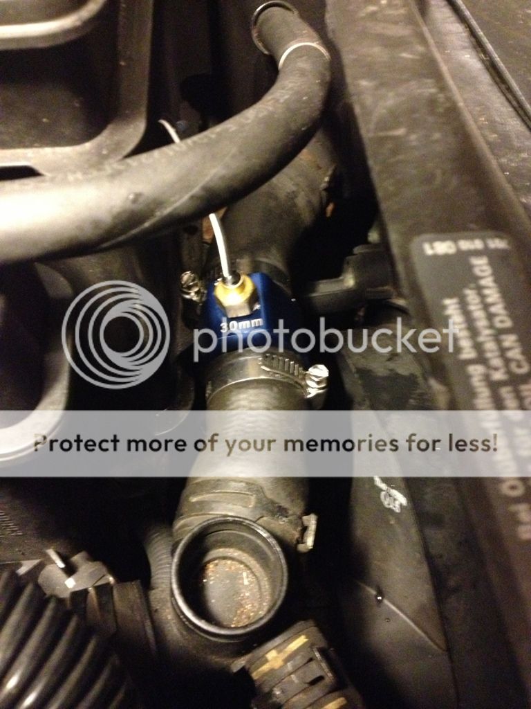

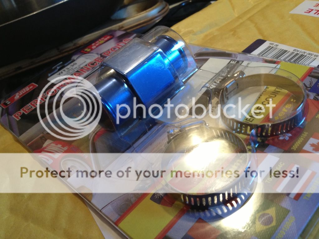

ordered up water temp sender adapter 30mm (1 3/16") for the top radiator hose.
LJ - 20v 1.8T newbie 9BAA07DB-FC3A-44C1-984F-149E39C52190-1861-0000026D95C434ED
to be installed here:
LJ - 20v 1.8T newbie D32E1692-DE16-4AC2-8328-2E86CC7F5DD4-1861-0000026D88C3AE4A
so cut hose in half, drained some coolant into suitable container below. then measured up size of adapter to insert and cut some more off the hose.
Used some teflon tape on the thread of the water temp sensor and fitted to adapter adapter, and put adapter into radiator hose. A pain to fit due to batt and power steering hose in the way, but once in secured with hose clips. refilled coolant reservoir to correct level and ran engine to temp to remove air bubbles in system. checked for leaks etc..
job done

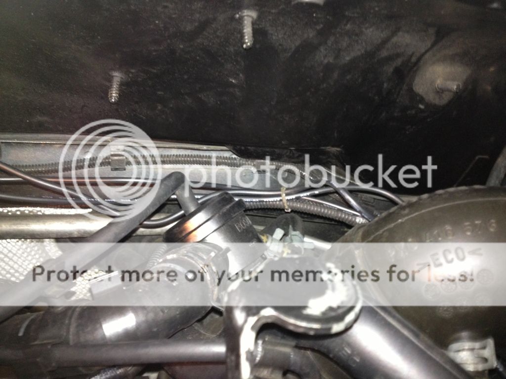

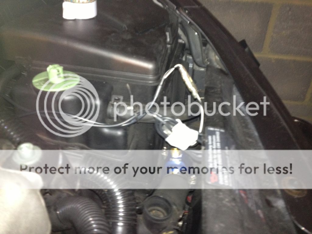

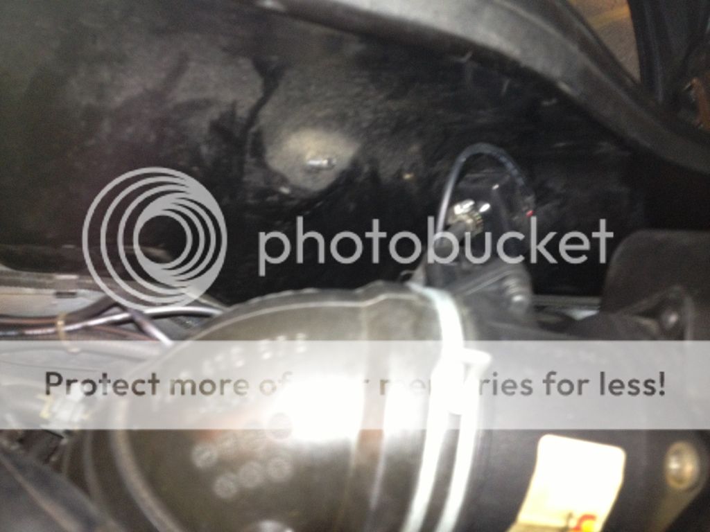

Next is the boost gauge sender:
Tapped into the boost line from the manifold with a T-piece.(looks too big, but there is 12mm in the pipe.)
LJ - 20v 1.8T newbie 79271955-1264-4238-9790-197633C722D7-1861-0000026D74DA0A70
runs up to sensor via a inline filter. Installed sensor up behind the air box/MAF sensor out of the way.
LJ - 20v 1.8T newbie AB14FD67-02D2-4CCC-BD0D-D2386C84F302-1861-0000026D6E1FFB53

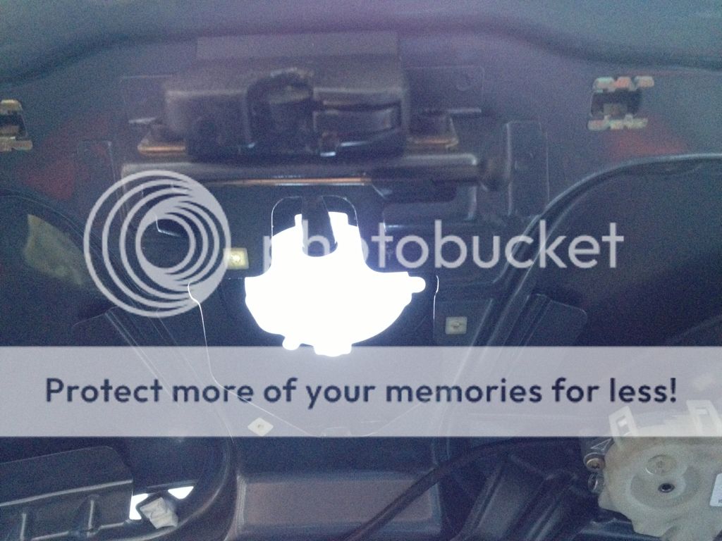

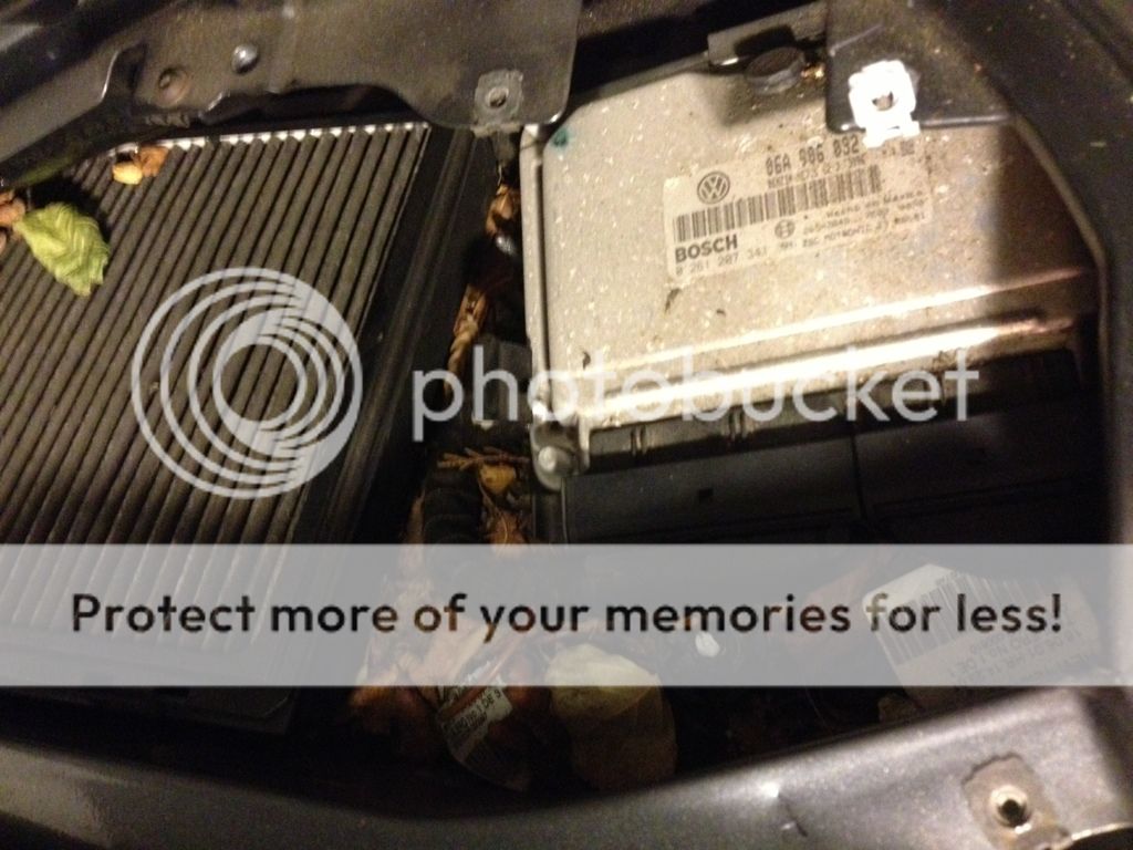

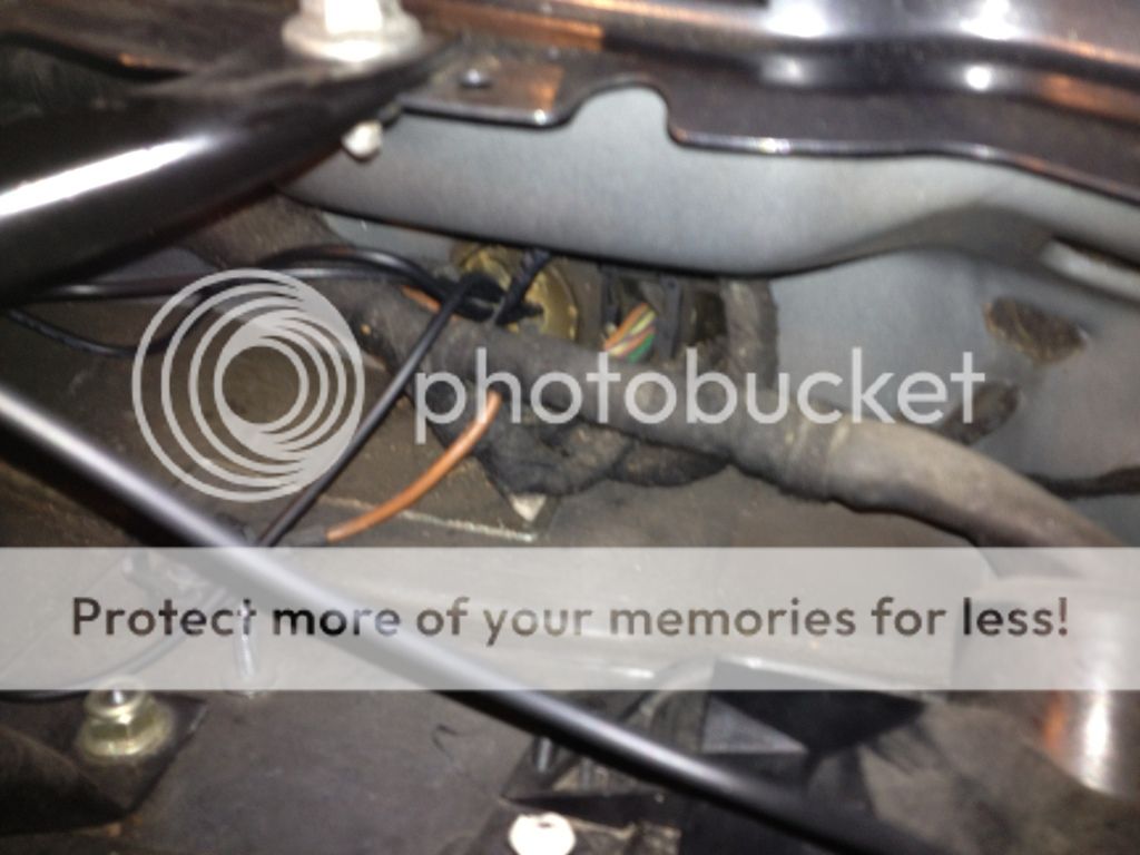

Next task was to run the cables from the sensors into the cab.
so took apart the top of the dash and removed the inner dash panels to look for a suitable location/grommet to run the cable through. I didn't want to drill anything.
left hand side: potential to run alongside the ECU loom and into the engine bay, but it was too tight a fit. It would also mean removing air box and ecu bits the engine bay. no thanks.

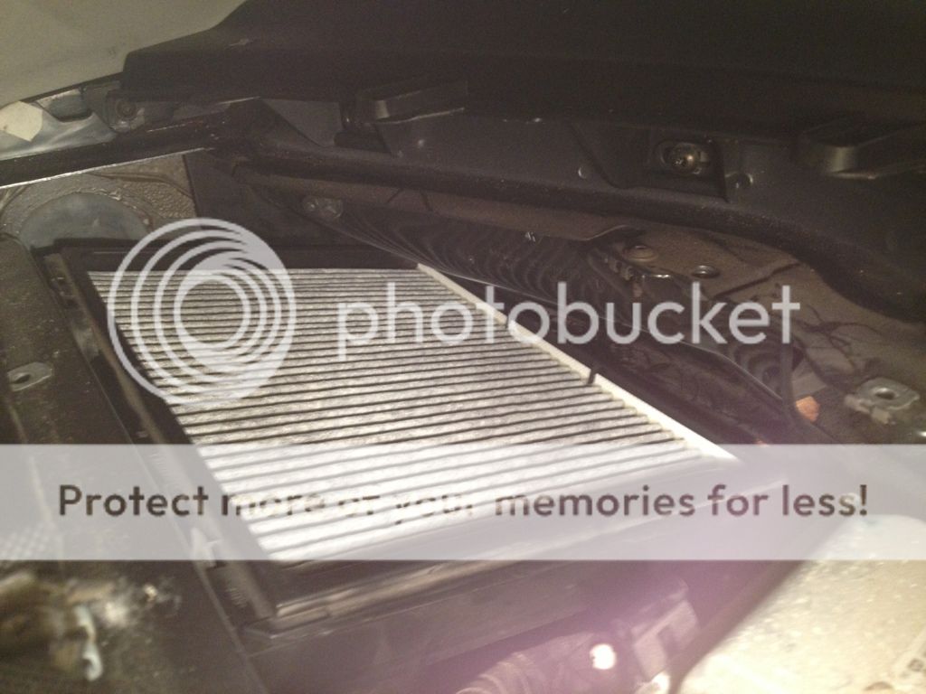

but whilst there the pollen filter needed a little clean Wink
LJ - 20v 1.8T newbie 9D127360-782A-4285-99D6-6ED84120F11D-1861-0000026D66DE166A
and around the ECU...

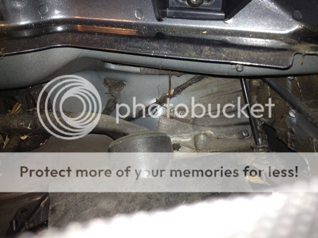

found that the rubber grommet had lots of room left, so opened up a new hole in it to feed the cables through.
LJ - 20v 1.8T newbie 0F302B7A-4615-426B-A843-FBC554177B97-1861-0000026D0CFDD5B0
this also is easy to get to in the engine bay.

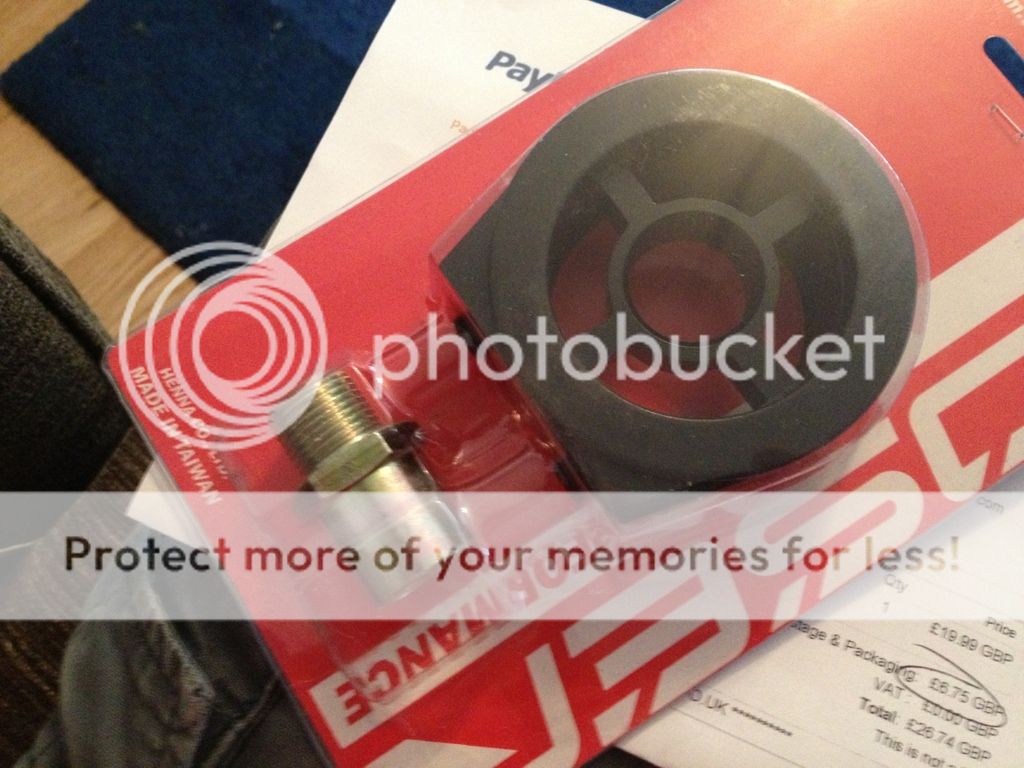

ordered up one of these today Wink
LJ - 20v 1.8T newbie 807199ec724e5fa76ab4e38acdd89186.image.300x300
Stealth-black sandwich plate adaptor 3/4 UNF 16
will arrive saturday ready to fit up the oil temp sender.

This arrived so fitted oil temp gauge sender
LJ - 20v 1.8T newbie E0AB8063-EE82-4D6A-BF7A-CE0E74C13E50-1188-000000E232AFD5B7
Also replace pollen filter as it needed doing. Prob the first time it's been done!
Nice new one in Smile

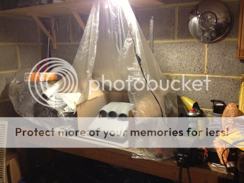

As dash was apart made a small spray booth and sanded and primed the gauge pod
LJ - 20v 1.8T newbie BCD92EBE-F0A7-4805-9FC7-1B1CEDD87E49-1188-000000E252E05AB0
About 3 coats
LJ - 20v 1.8T newbie EFFEFFA8-CE4E-4948-9DC3-DB65BD876869-1188-000000E25D01E6F5
Then applied 3 top coats

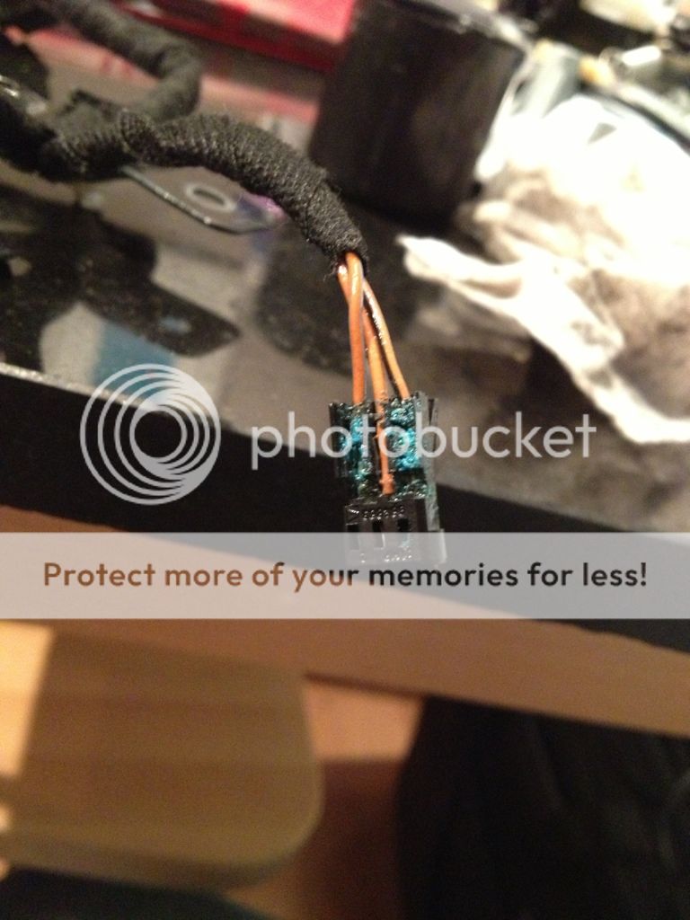

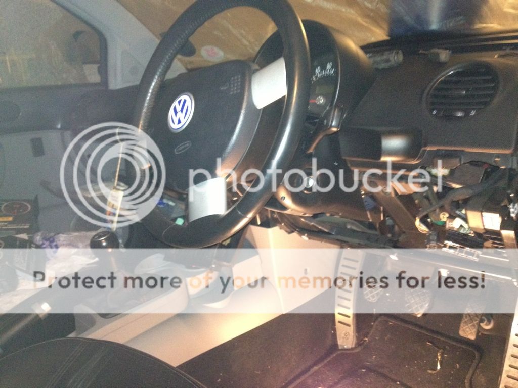

Took the rest of the drivers side dash out and made a loom for the gauges.
Took power from x75 and 30. Earthed to main earth point under steering column
LJ - 20v 1.8T newbie 19A654AE-FF51-4821-BDF0-06D286A9A939-1188-000000E27BAE14BB
LJ - 20v 1.8T newbie B34B8B39-F1EC-4119-A845-6DD1F32486FF-1188-000000E293120DD6

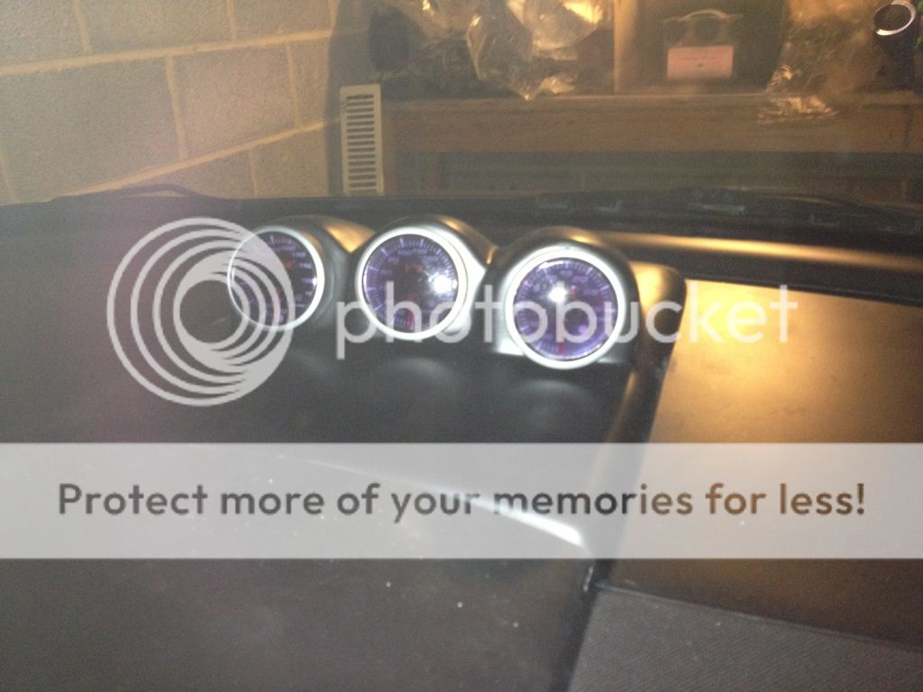

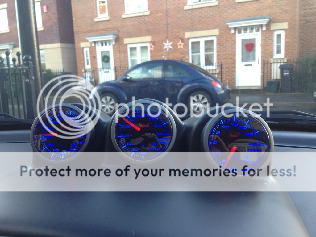

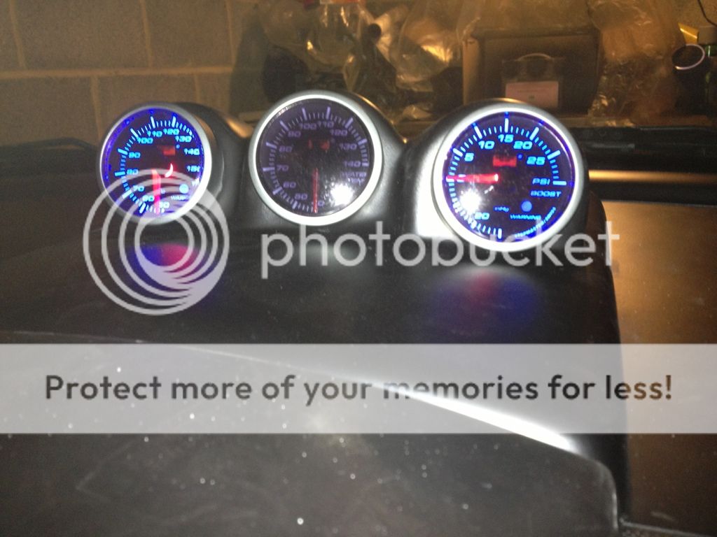

Fitted gauges and connected all wiring up. Then put whoe of dash back together
Here's the result
LJ - 20v 1.8T newbie D0D6BDD4-F21D-40BB-B046-CAB2DD4D52E1-1188-000000E29C892AB4
LJ - 20v 1.8T newbie 975834B1-92F7-431F-8791-E8E5EDDF9AFE-1188-000000E2A2D2E407

All tested today. No oil water or boost leaks. Operating temps are good.
LJ - 20v 1.8T newbie FC47B926-26BC-4203-8F7E-2A11AADCA3F9-1552-000001881FC63870
LJ - 20v 1.8T newbie Empty
PostSubject: Re: LJ - 20v 1.8T newbie   LJ - 20v 1.8T newbie EmptySun Dec 16, 2012 4:59 pm
the gauges look cool dude
PostSubject: Re: LJ - 20v 1.8T newbie   LJ - 20v 1.8T newbie EmptySun Dec 16, 2012 8:02 pm
Looking trick Dude

First on the list was to sort the random alarm going off every time it rains!
Problem located to the rear centre brake light in the boot. All lose and the seal was not doing it's job. A common fault apparently.
So removed the inside trim, centre brake light and all of the locking mechanism.
LJ - 20v 1.8T newbie 3E0EF3CB-27F1-4210-BE1B-EB610FFD454A-2558-00000205DE4284A6_zps1fcaa5ef
LJ - 20v 1.8T newbie D1BAC0FA-FF9D-44B7-9801-D33A43CC02D6-2558-00000205B0BBB301_zps8b705e08
LJ - 20v 1.8T newbie 76CAE65C-BEAE-40DD-9FA1-DCD0C1D6479C-2558-00000205C9A1C902_zps713c68bc
all of the parts removed ready to be cleaned..
LJ - 20v 1.8T newbie 71F8C409-04FB-4E7D-AF1E-857572F7870C-2558-00000205E83CFA29_zpsbb5a4cd0
Found the culprit connection/sensor wire in the rear lock.
LJ - 20v 1.8T newbie 97B8DAE6-641B-494D-AAC0-FC154BF59E8A-2558-00000205F5F9A470_zps73b985d0
All cleaned and rebuilt. rear lens re-sealed to the body. job done!
