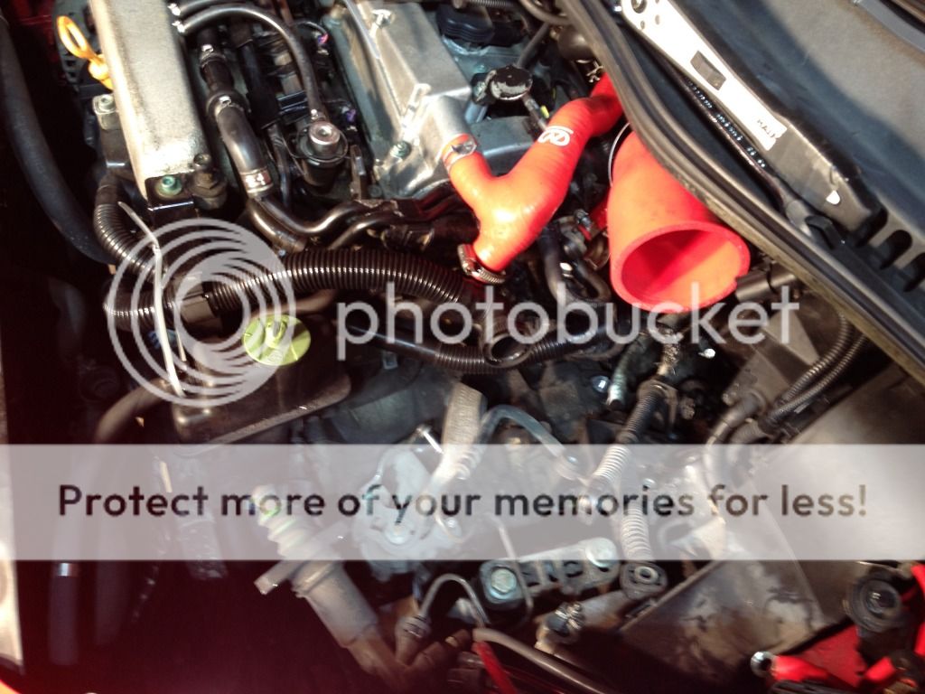

So we fitted a new Clutch kit installed last Sunday... ECS tuning VR6 lightened solid flywheel conversion stage 1 Sachs job off Awesome Gti... easy he reckoned ...
Max - 20v 1.8t Newbie  - Page 3 1A372D24-D053-4309-80D6-1DCECD5B920A-14163-000008E8BD9850A8_zps52807216
Max - 20v 1.8t Newbie  - Page 3 03EFB5A2-58C5-4497-8775-7E08E7A75A71-14163-000008E8D5AC5B9A_zps225e02cb

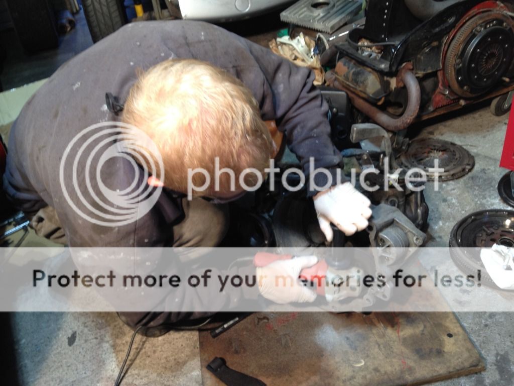

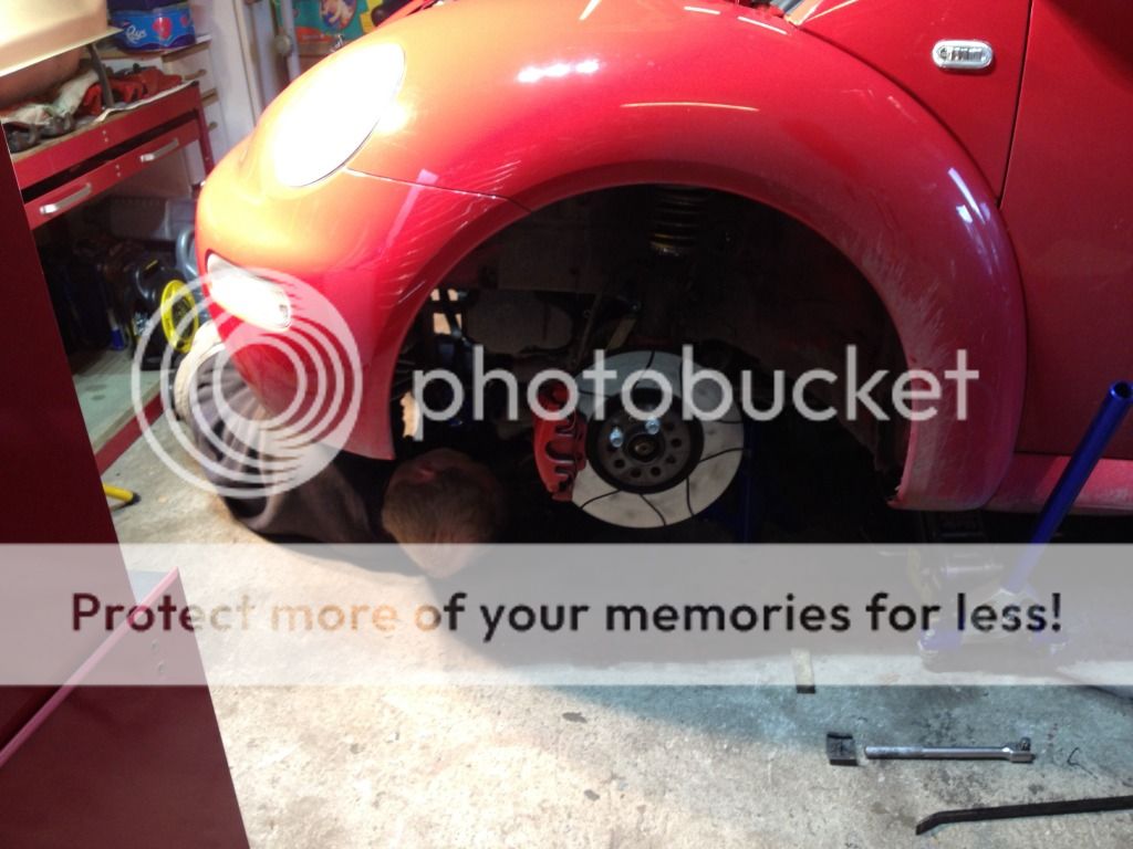

removal of Battery, tray, air filter/MAF, gear controls, clutch slave, power steering reservoir, moved A/C lines out of the way...

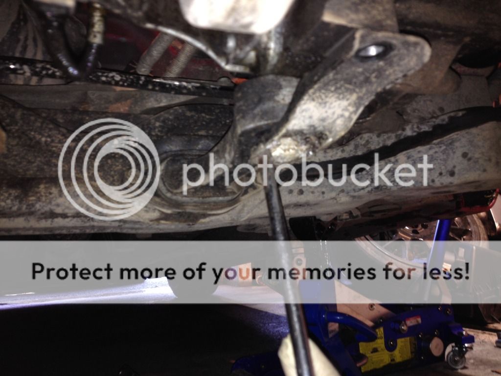

removed some road surface from his dogbone engine mount Wink

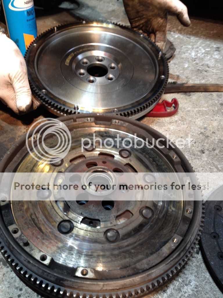

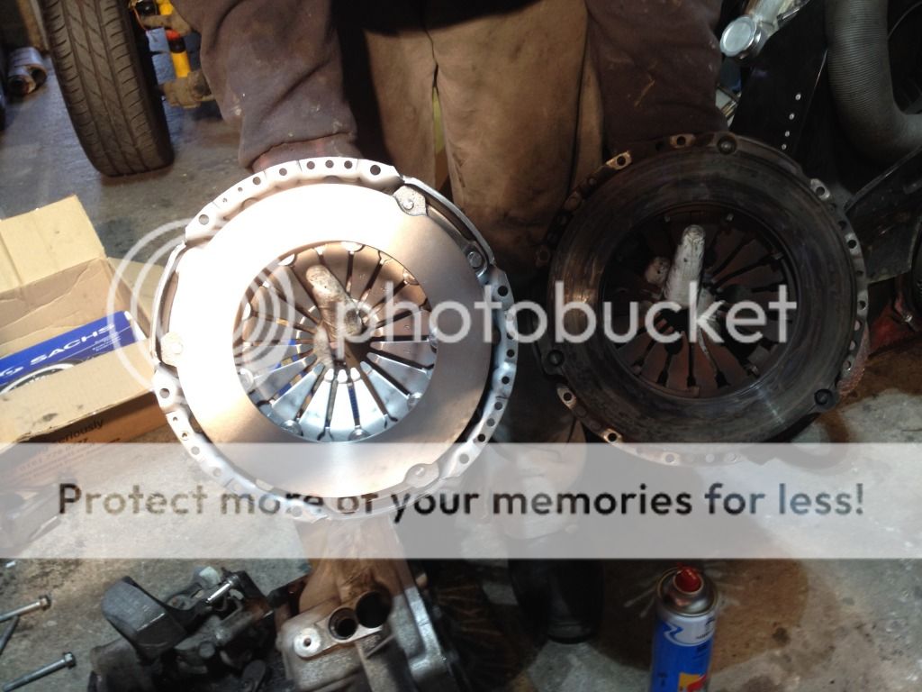

nice line up of new and old..
Max - 20v 1.8t Newbie  - Page 3 996F9C9E-E15C-4C3F-A69E-62B05B0E0C53-14163-000008E8A2CE0E6B_zps8d28953c

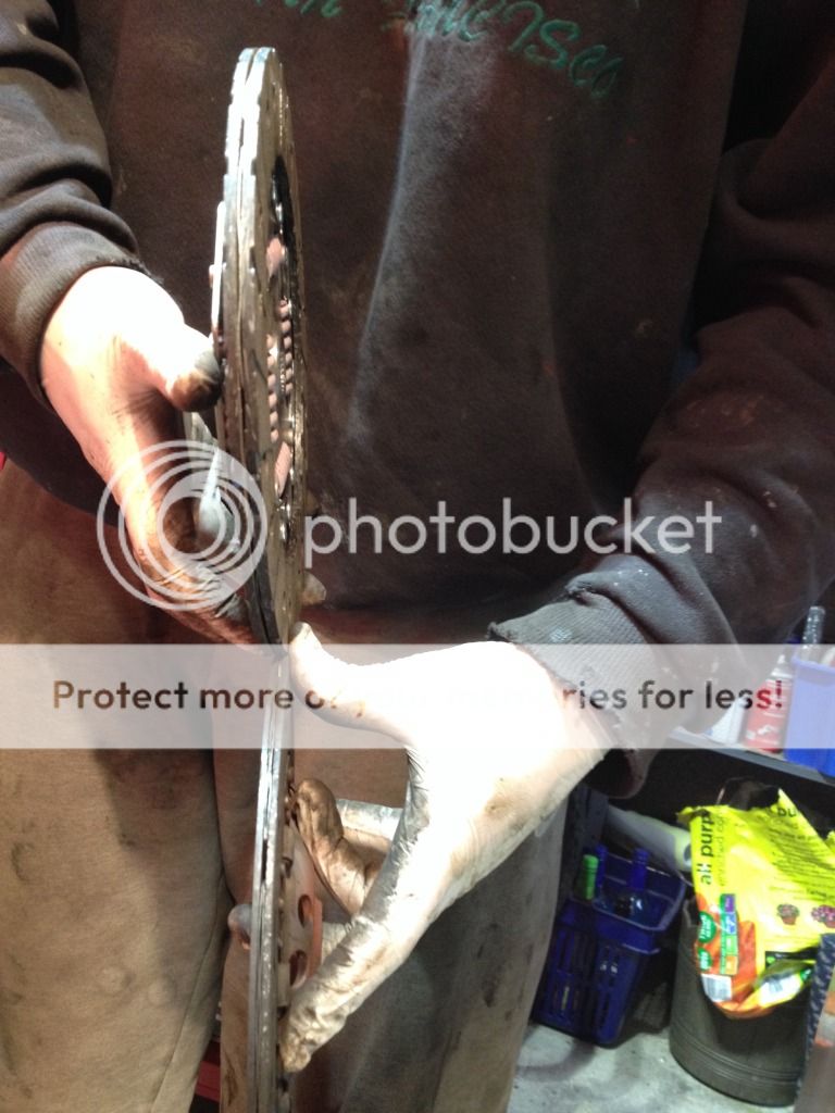

old clutch was a bit worn compared to the new one..

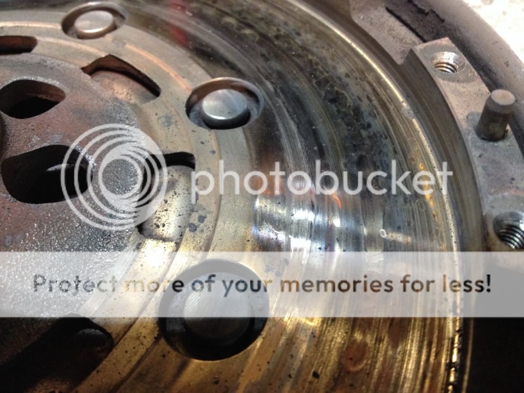

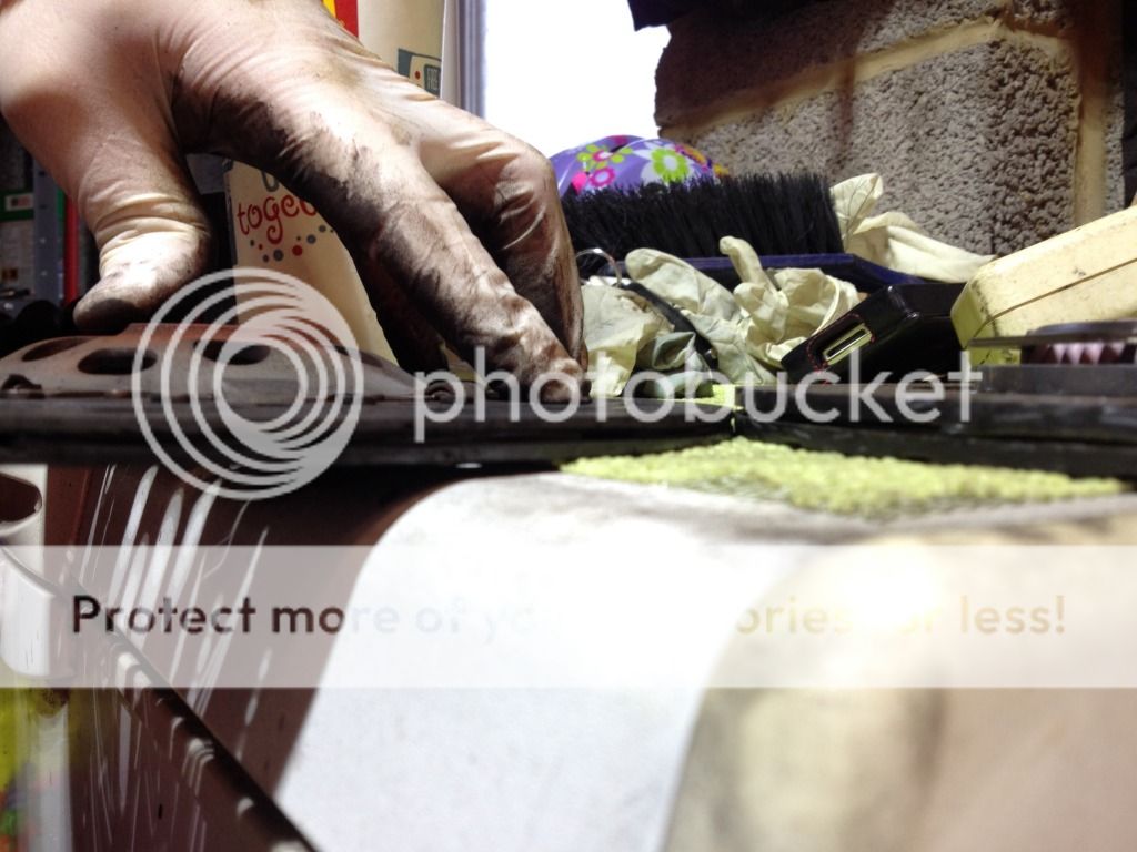

DMF had to go as damaged and worn out..
Max - 20v 1.8t Newbie  - Page 3 F657F2C8-6996-4A20-AFF5-3938512139F8-14163-000008E86BE689AA_zps68b15000

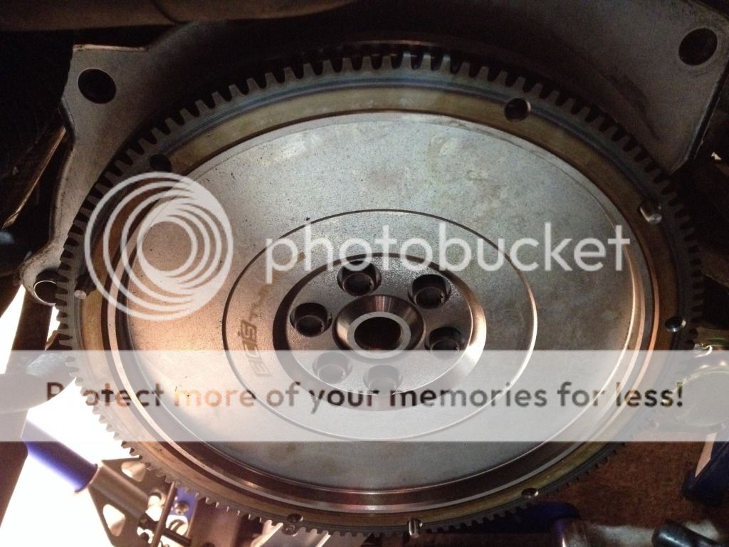

new lightened solid flywheel ready to go in.
Max - 20v 1.8t Newbie  - Page 3 032964AD-2434-45A4-89D2-08966C6EC46A-14163-000008E85BE913B7_zps470d1152
all cleaned up and ready:
Max - 20v 1.8t Newbie  - Page 3 084D2E09-4194-4749-B75D-705738EEB0A3-14163-000008E84A000C92_zpsdb975ac5
new flywheel installed..

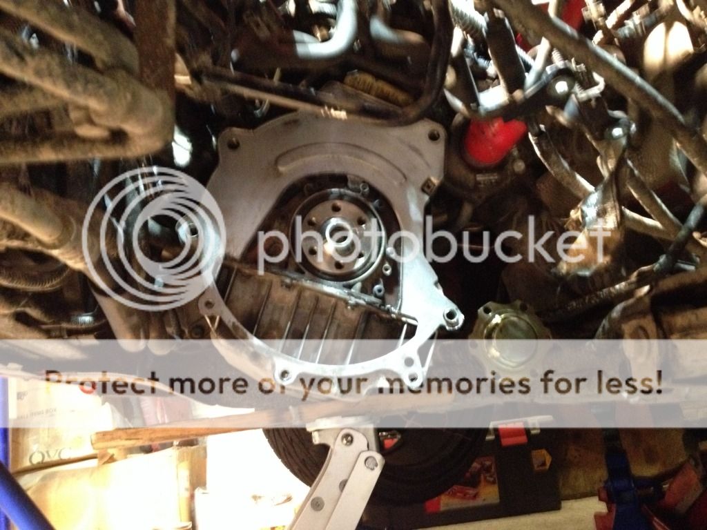

gearbox had to be checked and clearances sorted to accept new flywheel/clutch/pressure plate

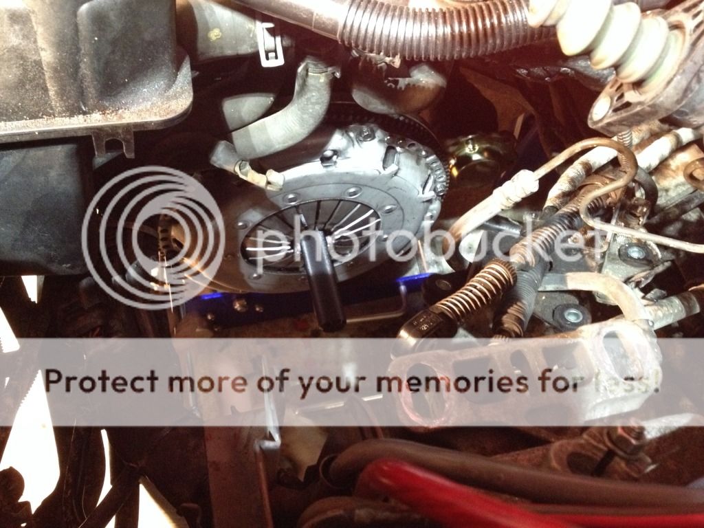

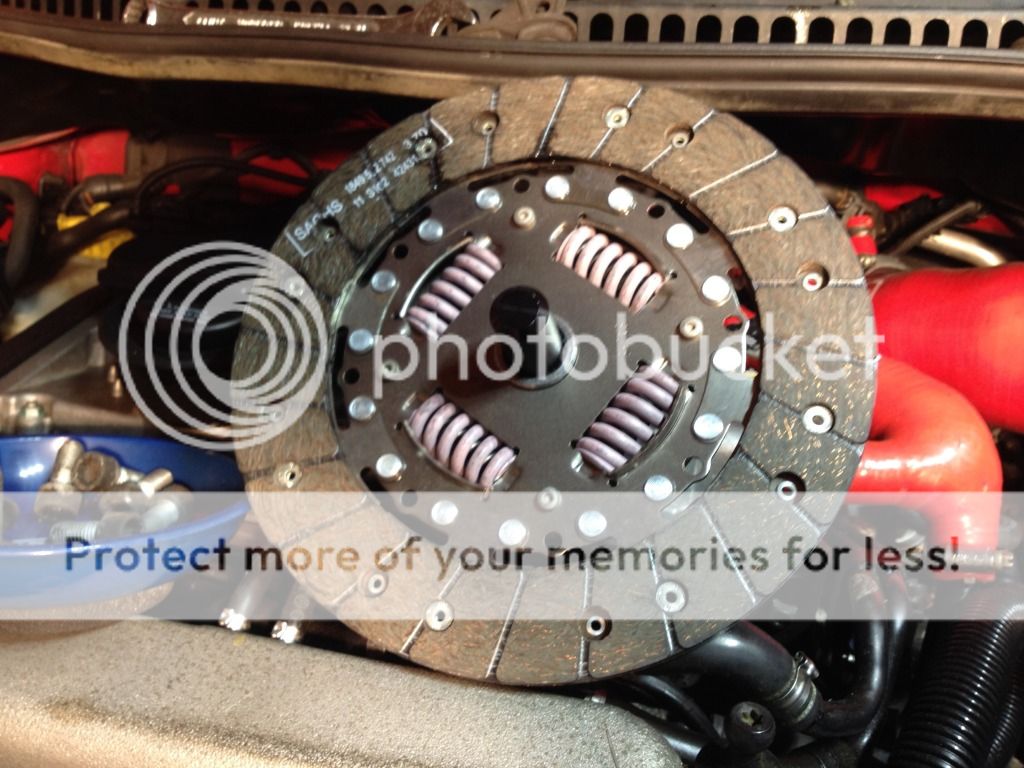

new stage 1 sachs clutch installed:

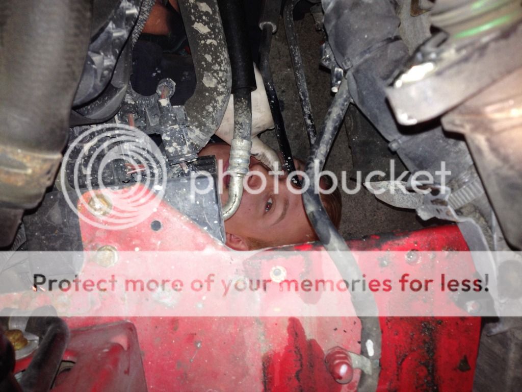

then it was a long process of getting the gearbox back in and the driveshaft flanges kept getting in the way of the subframe and trying to clear the larger flywheel...
