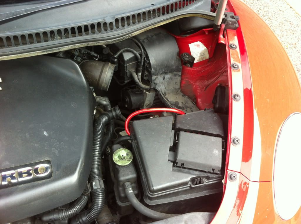

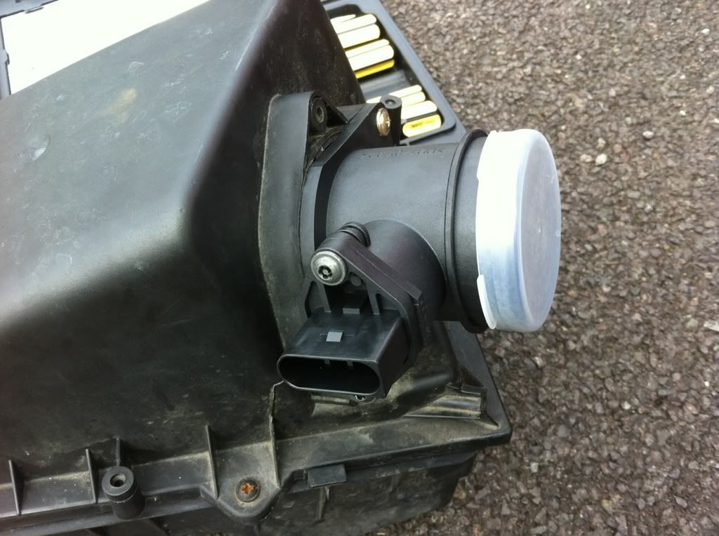

installed a new MAF as had engine check light on so check on the diagnostics and faulty MAF, i tried cleaning my old one but no joy,
so nice bosch one installed and faults cleared.

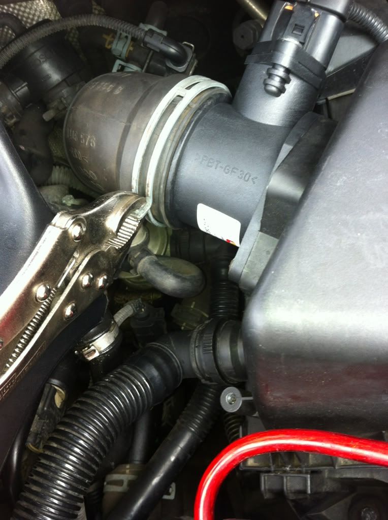

Gave the Throttle Body A clean out on the the weekend Very Happy
Max - 20v 1.8t Newbie  - Page 2 A4915397-3389-40E0-B843-41A9FB516D1D-1560-00000121B991898D
Max - 20v 1.8t Newbie  - Page 2 BC266027-A5F6-426B-8DD9-8B882E8F4E24-1560-00000121C1F82CC4
Max - 20v 1.8t Newbie  - Page 2 0E9D7FAB-9215-40D9-BBAC-55F066A7AF80-1560-00000121C9250FCF
all clean now
Max - 20v 1.8t Newbie  - Page 2 CCE11CEE-8C0F-4522-BA20-C89456F6A7B2-1560-00000121E78CB7B8
Max - 20v 1.8t Newbie  - Page 2 6A2D7165-7052-4A97-B6F7-DBFF9FB78A48-1560-000001240E691524
Max - 20v 1.8t Newbie  - Page 2 CF6E3051-C4AD-437D-834C-A3D3C8A15C7A-1560-0000012417CC1E38
Re Fitted with new gasket and then realigned/re calibrated through Vagcom

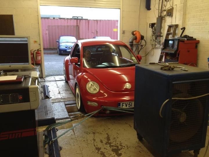

rolling road session
