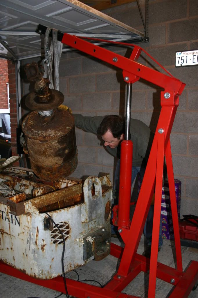

| Tomorrow is the big day in my 4WBE's resto history.
Tomorrow morning I'm removing the huge DC traction motor from the chassis. The motor is massive. Can't imagine how much it weighs. I've borrowed a hydraulic engine hoist to do the lifting. The motor will then be sent away for assessment and refurbishment. The motor will have to be 'top notch' for future passenger service....shhh - I can hear you sniggering from here.
As soon as the motor's out I can drop the wheel sets, as the chassis will weigh less without the motor. Then I can finally start on restoring the 0.5 inch thich steel plate chassis.

| The motor's finally out. For saying it's been rained on for nine years it's condition isn't too bad. I was in the garage at 615am and by 10 it was out. Bacon butties all round. Next job: dropping the wheel sets (complete with hornblocks and transmission). | |

| The motor is a sealed unit, as is the Clayton 'Camtactor' controller. I reckon they're that way for intrinsic safety down the mines. The sealing has saved my motor from the elements. However, the side effect is that condensation could not escape and that's done the damage.
A company up in Newcastle are the first to say they're interested in the refurbishment job. Sending them a load of motor pics (internal and external) for a very rough quote.
The coolest thing so far is that the Festiniog Railway and Talyllyn Railway have both submitted great quotes for re-profiling my worn wheels.
Talking of Mr Dibnah....years ago I was up in Bolton, looking at an old car, I popped around to see Fred. I looked over his garden fence and there he was riveting the foundation ring on a traction engine boiler. I shouted, "Oi, Fred!" He responded and invited me down. The next two hours were bliss. I had a tour of his fantastic workshops and various projects. We chatted at length about glorious steam and the state of our nation. The workshops were like Aladdins' Cave, in a steam way. Great man. | |
