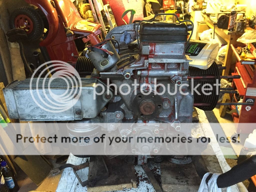

PostSubject: Re: Tango Van - 1972 westy..   Tango Van - 1972 westy.. - Page 16 EmptyMon Jun 08, 2015 8:43 pm
Found some plastic in the oil...? not sure what from or how it got there?
Tango Van - 1972 westy.. - Page 16 7B841C55-69BF-4699-80C5-ED0495CEBA99_zpsl24wcp6l
initial strip down: removal of exhaust header, fan, shroud, alt housing and front tin
Tango Van - 1972 westy.. - Page 16 05F58698-24E8-4831-ABF5-6B4B4E81B6F6_zpsavvjuuc7
Tango Van - 1972 westy.. - Page 16 D55A03F7-3569-405D-80FA-6C6E5E42AE9E_zpsdffgwqzg
Tango Van - 1972 westy.. - Page 16 B44A894D-B148-4457-8BA6-D4D3AEE0822B_zpswrv5vlyr
oil in the breather looks a bit worse for wear..
Tango Van - 1972 westy.. - Page 16 38CFE2BE-1A31-48D5-A9C7-02BA5F6D6B14_zps9n0jxlka

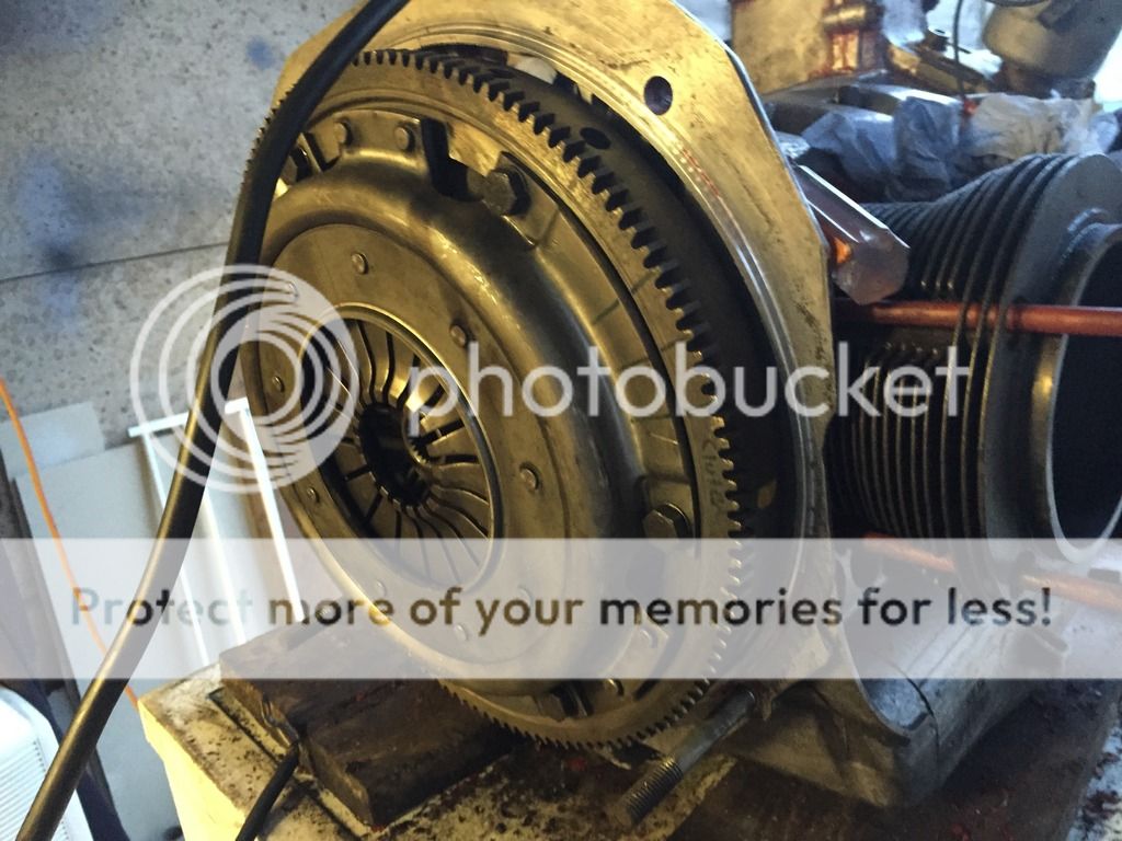

removed clutch and flywheel as the bell housing looked a bit damp..
Main oil seal had just started to go.. contaminating the clutch a bit, so will replace it and clean up the clutch as loads left on it.

Niiiice is that definitely plastic, not a seal giving up?
PostSubject: Re: Tango Van - 1972 westy..   Tango Van - 1972 westy.. - Page 16 EmptyMon Jun 08, 2015 9:07 pm
yep. black plastic ring.. snapped easily, and not magnetic..
red stuff is the gasket sealant on the rocker covers..

Progress...
Flywheel on and clutch etc..
Tango Van - 1972 westy.. - Page 16 D4827F3F-5193-4AAE-BED9-C15879AC1813_zpsil0qe7uq
Engine case degreased and most of the paint removed.. A bit more to go still...
Tango Van - 1972 westy.. - Page 16 FABE3EB4-F7B4-431C-96FC-F716213F357D_zpsiv1iwve2
