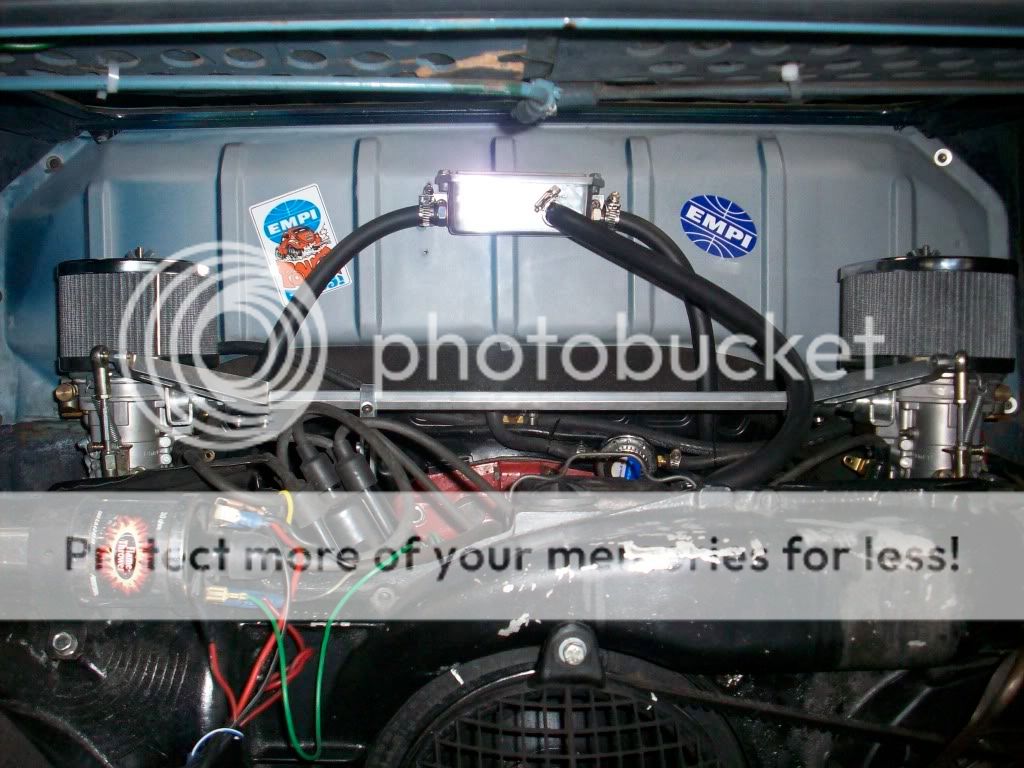

Oil Breather pics:
left rocker cover:

right rocker cover:
Tango Van - 1972 westy.. - Page 5 101_1579

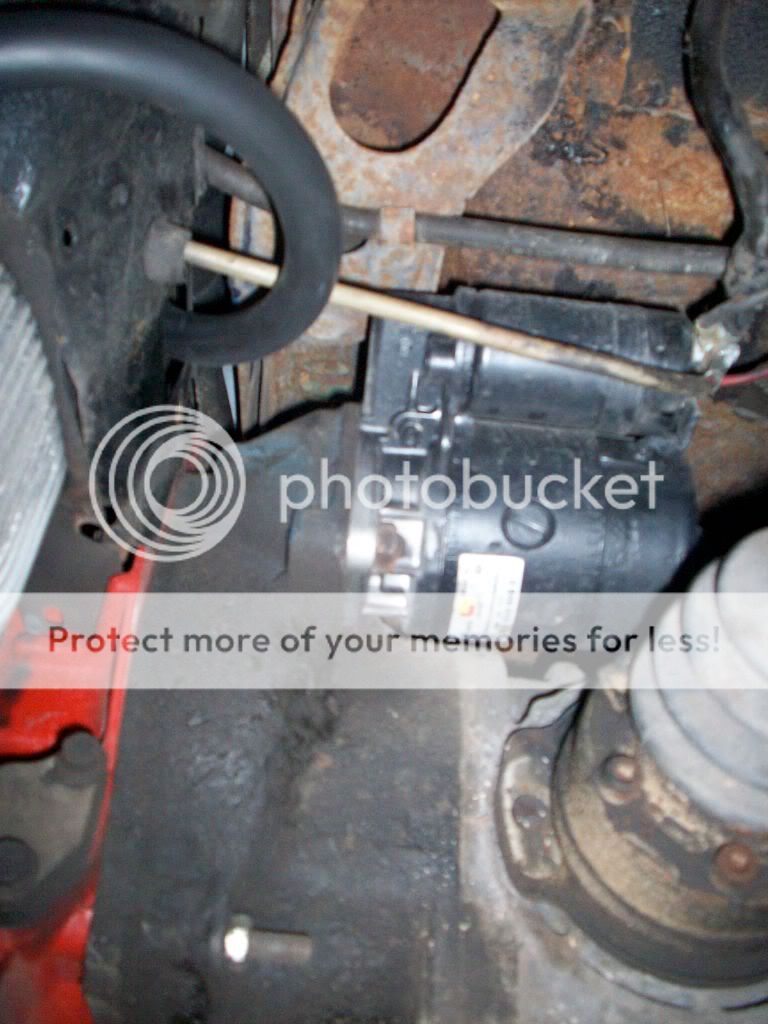

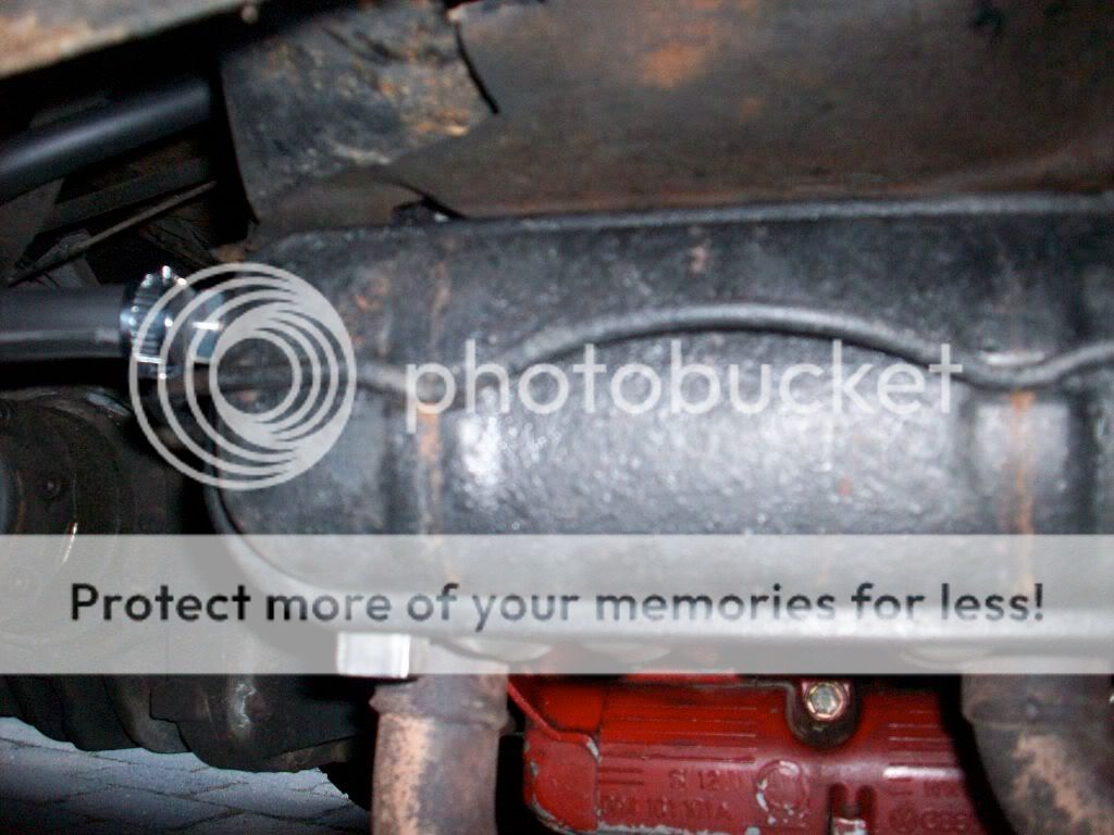

breather hose going through the tinwear right side (had to drill a hole on the left side by the brake vacuum line)
Tango Van - 1972 westy.. - Page 5 101_1582

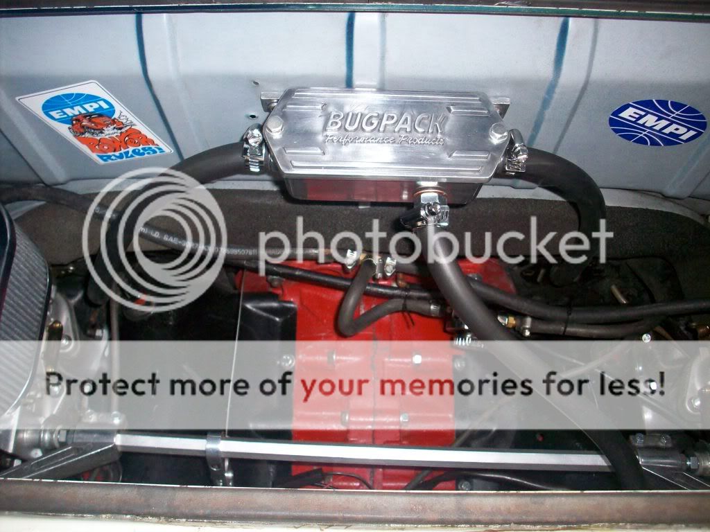

positioning of the breather box on firewall and hoses conected from rockers and crackcase breather fitted.
Tango Van - 1972 westy.. - Page 5 101_1583
pic from above through access hatch.
Tango Van - 1972 westy.. - Page 5 101_1585

PostSubject: Re: Tango Van - 1972 westy..   Tango Van - 1972 westy.. - Page 5 EmptyWed Sep 02, 2009 2:15 pm
Looking good......

PostSubject: Re: Tango Van - 1972 westy..   Tango Van - 1972 westy.. - Page 5 EmptyWed Sep 02, 2009 3:14 pm
forgot to mention ....the outlets are smooth and quite short ....where the hose goes on to the rocker covers ......if you buy two bolts with the same thread as the suppied nuts .....I can turn them down on the lathe and you can cut them to whatever length you feel if safe .
PostSubject: Re: Tango Van - 1972 westy..   Tango Van - 1972 westy.. - Page 5 EmptyWed Sep 02, 2009 3:23 pm
I pushed the hose over the thread and them did up the clamps.
will keep a close eye on it for a while.
you can take a look at them if you want. always nice to have another pair of eyes to see if I made any obvious mistakes.
PostSubject: Re: Tango Van - 1972 westy..   Tango Van - 1972 westy.. - Page 5 EmptyWed Sep 02, 2009 3:39 pm
they look fine dude ....it was an observation I had when doing the ghia 's engine .....I could pull them off ....so I made longer outlets ....it may have been cos of the angle of the hose ....you probably have more space in your engine bay
