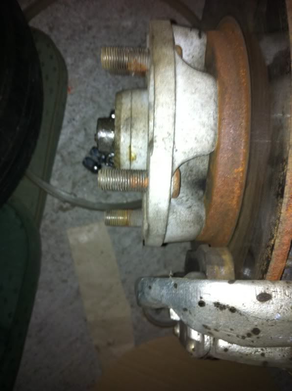

So I've spoken to T2D and what appears to be the adaptor/spacer bolted to the discs in the pics is a stock 944 hub.
They are going to be fitting these wheels to a Bay with the same brake set next week and have said they'll let me know exactly what's needed.
I may have to ship 2 x wheels back to JGE to get the centre bore opened up but I'm going to see if simply using a spacer might work.

how will a spacer make the hole in the wheel bigger? .....or are you changing the adaptors too?

CSP disk kit....
All the stopping power, non of the wheel grief ;-)
had a similer issue on my bug, so got rid of the porker kit and went csp with a 924 master cylinder

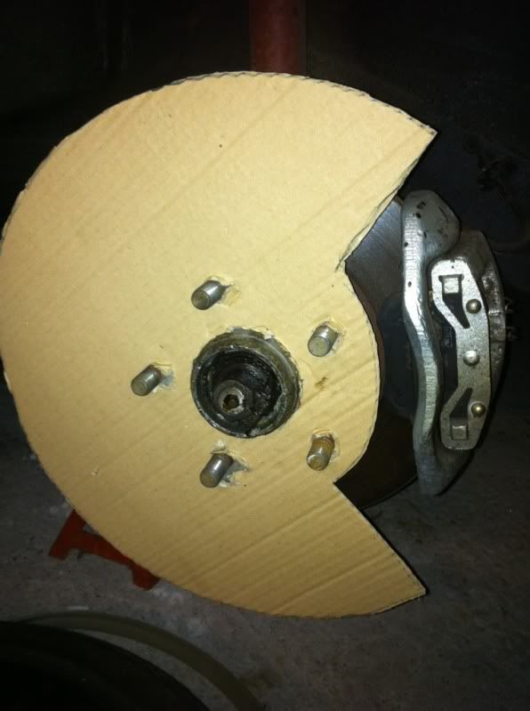

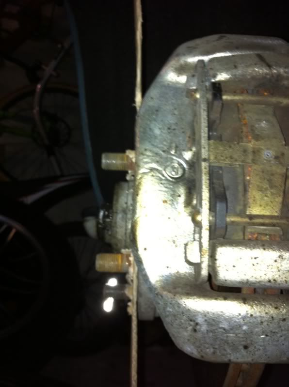

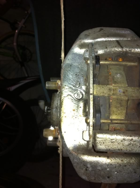

So, I got home from work tonight, and before shooting out to the mid-monther I had a little play.
I had a look to see just how much of a clash I think there's going to be.
71 Early Bay (formerly known as Superdry) - Page 5 267ed0d3
I made this up;-
71 Early Bay (formerly known as Superdry) - Page 5 441d5d3c
And then took these to see how far forward the caliper is;-
71 Early Bay (formerly known as Superdry) - Page 5 1535c894
71 Early Bay (formerly known as Superdry) - Page 5 0f356bbc
I think it's going to clear now I've looked at it like this as the back of the wheel isn't flat
71 Early Bay (formerly known as Superdry) - Page 5 B03d48b2

it needs some 15mm copper pipe over each stud, jobs a good un clown
71 Early Bay (formerly known as Superdry) - Page 5 Empty
PostSubject: Re: 71 Early Bay (formerly known as Superdry)   71 Early Bay (formerly known as Superdry) - Page 5 EmptyWed Mar 09, 2011 10:34 pm
If necessary I can't see why a little tickle with the grinder on the edge of those calipers wouldn't hurt.

I dont think it will run very well with cardboard!! lol
