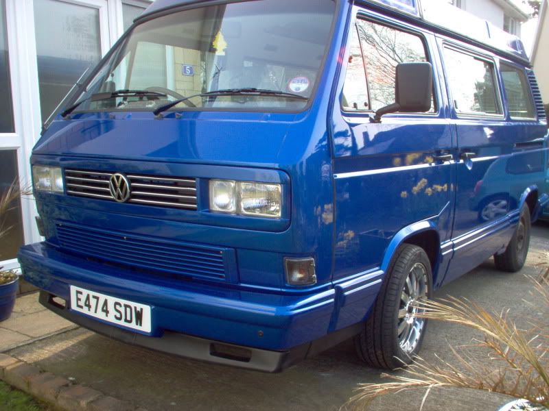

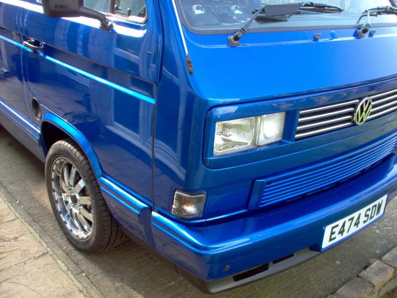

My latest project is well underway so I'll just get a load of pics up to get you up to speed........might take a while, bear with me!!!

Found a guy in Cardiff in the end for seat trimming.......Springers Upholstery. He made a nice job of the seats and trim panels, not a bad price either.
T25 Caravelle to Camper T25008
Volkswares bed;
T25 Caravelle to Camper T25010
Hoping to get an MOT on it next week and sort the engine out.
