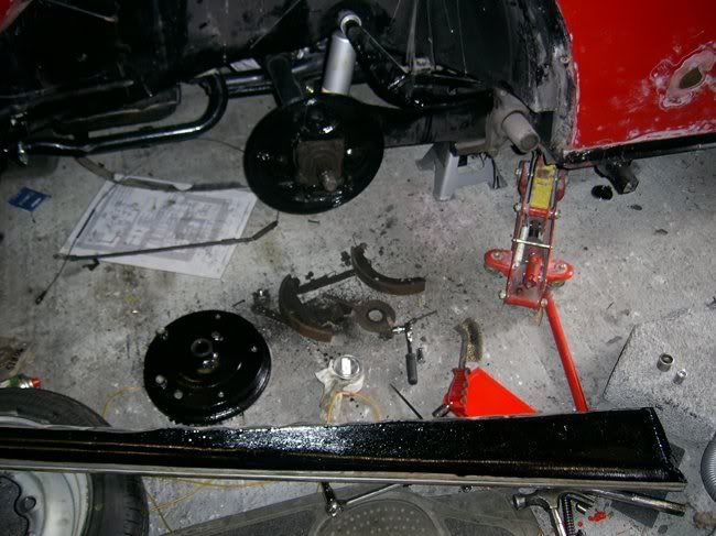

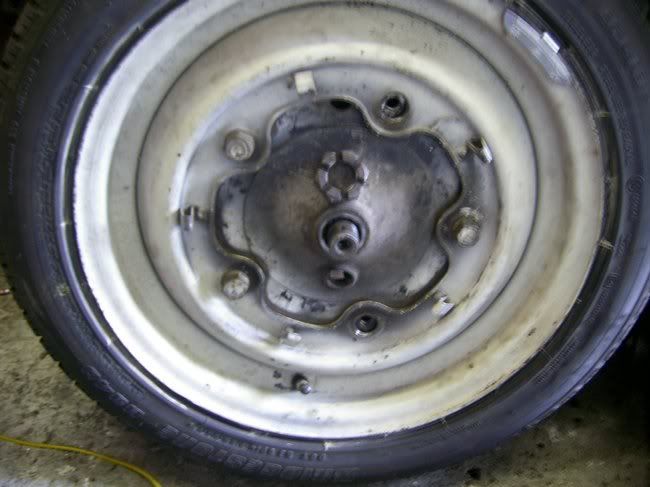

Okies, back from a weekend away with Evvo in Germany. Went to Bad Camberg and Wolfsburg - highly reccomended!
Anyway - back to reality with a bump - and onto the rear brakes. Finally managed to get one of the hub nuts off! Woo hoo!
Bella - 1958 Australian Beetle - Page 5 PIC_0258we
Bella - 1958 Australian Beetle - Page 5 PIC_0259we
All pulled apart, wire brushed and given a coat of POR-15.

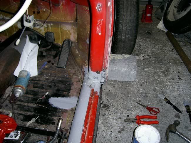

Oh and here's the welded in other a pillar repair pic:
Bella - 1958 Australian Beetle - Page 5 PIC_0078we

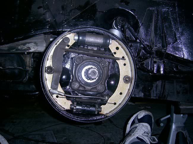

Shiny new brakes are in:
Bella - 1958 Australian Beetle - Page 5 PIC_0264we
If anyone sees anything wrong -please say! Smile
Bella - 1958 Australian Beetle - Page 5 Empty
PostSubject: Re: Bella - 1958 Australian Beetle   Bella - 1958 Australian Beetle - Page 5 EmptyWed Jun 27, 2007 4:00 pm
Looks good same as the pic when you took of but newer lol!

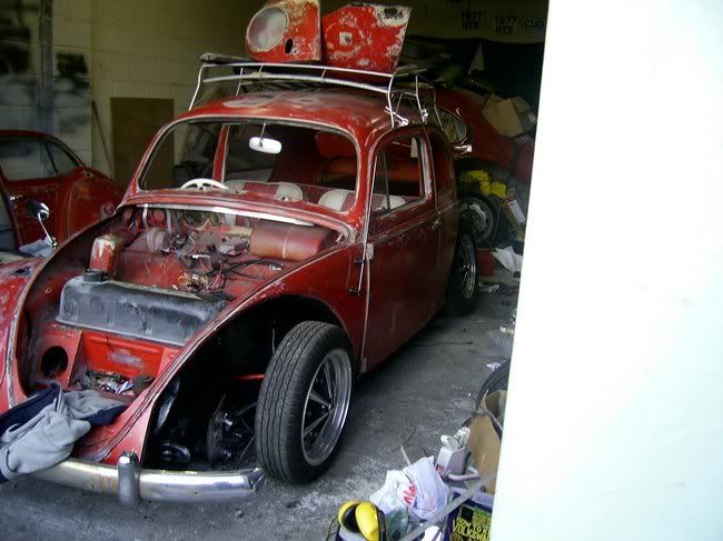

i put her alloy back on, refitted the rear wing and the running board and pushed her out for some more piccys:
Bella - 1958 Australian Beetle - Page 5 PIC_0266we
Bella - 1958 Australian Beetle - Page 5 PIC_0267we
Bella - 1958 Australian Beetle - Page 5 PIC_0268we

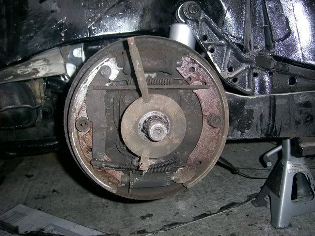

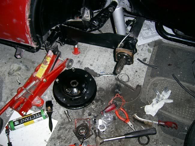

Been out playing with her again today. Got the other hub nut off:
Bella - 1958 Australian Beetle - Page 5 PIC_0269we
Pulled all the brakes apart and painted up the face of the drums and the backing plate. This time the bolts for the backing plate to come off came off, so I'm replacing all the seals etc.

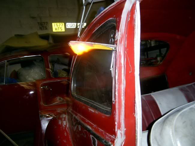

And I managed to get a semaphore working Very Happy
Bella - 1958 Australian Beetle - Page 5 PIC_0271we

Just gotta work out how to get the wiring for the other semaphore back up through..... it doesn't seem to want to go back pale
PostSubject: Re: Bella - 1958 Australian Beetle   Bella - 1958 Australian Beetle - Page 5 EmptyFri Jun 29, 2007 6:38 am
Are you able to push some stiff thin wire down and solder the end to your wire and then pull it back up through??
Bella - 1958 Australian Beetle - Page 5 Pbucket
PostSubject: Re: Bella - 1958 Australian Beetle   Bella - 1958 Australian Beetle - Page 5 EmptyFri Jun 29, 2007 6:47 am
Yeah that's what i thought would work - but I don't appear to have any wire which is flexible enough to go down the pillar, but strong enough not to just bend and not go anywhere.... Rolling Eyes
I've found an old bit of window chrome works really well - it's just not long enough Sad
PostSubject: Re: Bella - 1958 Australian Beetle   Bella - 1958 Australian Beetle - Page 5 EmptyFri Jun 29, 2007 11:55 am
welding wire, metal coat hanger something like that normally does the job then tape the wire to it..
PostSubject: Re: Bella - 1958 Australian Beetle   Bella - 1958 Australian Beetle - Page 5 EmptyFri Jun 29, 2007 11:57 am
Tried welding wire - it just bent Sad
I'll try a coat hanger tho, that might work Very Happy
Ta!

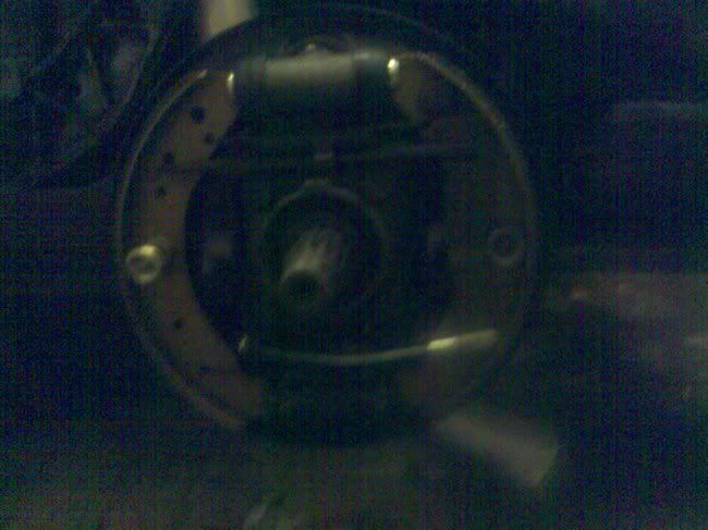

Got the rear brakes all together too. Sorry about the pic - couldn't find my camera at the time (yet again!) so had to use phone:
Bella - 1958 Australian Beetle - Page 5 Image085we
