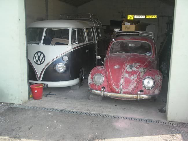

We went and collected the busses, stripped them down for shipping and drew out a container sized space in our friend's field. The reason we stripped them down was because there was (I think) only going to be 4cm spare in the container once they were all loaded. So we put the Split first so her front end could be nudged into the engine bay, then Bella, then the Bay who would hopefully be high enough to go over her engine slightly. Since Bella was being taken directly to the shipping yard, we had to measure the gap where she'd go:
What seemed like forever afterwards, my Dad recieved a call telling him our container had arrived. I picked up Dad at Gatwick Airport and met Mum with the Landrover and trailer at Tillbury docks. This is what greated us:
3 unharmed Volkswagens. We'd been advised on Volkszone that we must get 3 cars into the container. The reason for this, is that if one car breaks free, it will have a 'run up' to keep hitting the other vehicle. If you have 3 cars and only a 4cm 'run up' then they can't do much damaged if they escape the ropes. We'd paid Geoff's handy man to properly secure them into the container (as they were packed after we'd left for home) and he'd done a brillaint job Very Happy
This was the first time we'd been able to see Bella in proper light, so we had a good look round, nervous that the dark shed she was in may have hidden some nasties. Luckily (yep, again!) there was no rot

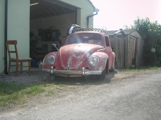

I replaced all the fuel pipes to be on the safe side and bolted her panels back on and took some pics:

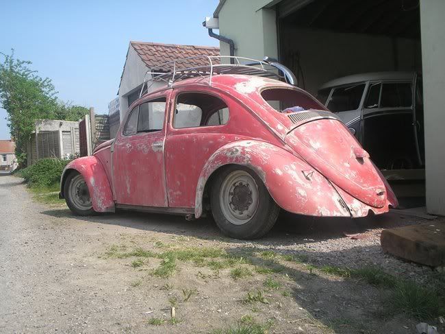

The only real problem (other than the running) was a bit of accident damaged where she'd been reversed into something:
Not the end of the world by any means.

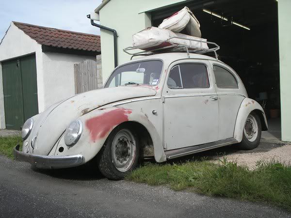

She was a little on the high side tho...
Put it this way - both at standard height - look at the height of the roofs!

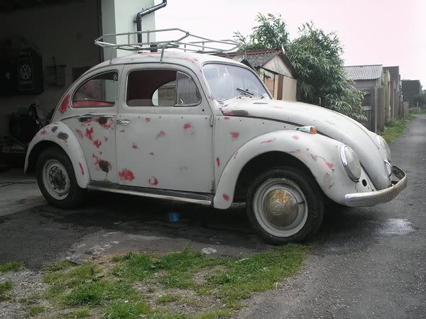

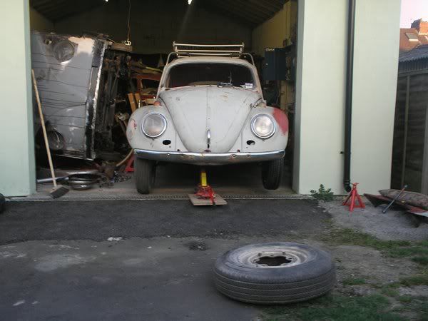

Right, now where was I? Oh yes, we'd got her running, pumped the tyres up and accessed the accident damage. It was around this time that Luke decided he wanted an old Bug, so I suggested that he should have a go in Bella to see how he got on. If he managed Bella he could cope with a 'better' Bug really well.... she was spluttery, untuned, kangaroo'd everywhere and had a habit of opening the passenger door when you put her into 2nd Surprised
Then Tom was introduced to Bella and he and Jim told me off by saying she was the easiest project in the world and should be roadworthy in about 6 weekends worth of work..... a year on she still has no MOT ;D
Anyway, after rather a lot of faffing round doing bits here and there, thing started to progress. The tyres she came with were really wide and had no tread - so along came some shiny new ones in different izes ready for lowering...
New and old:
Seriously need to do something about the ride height tho!

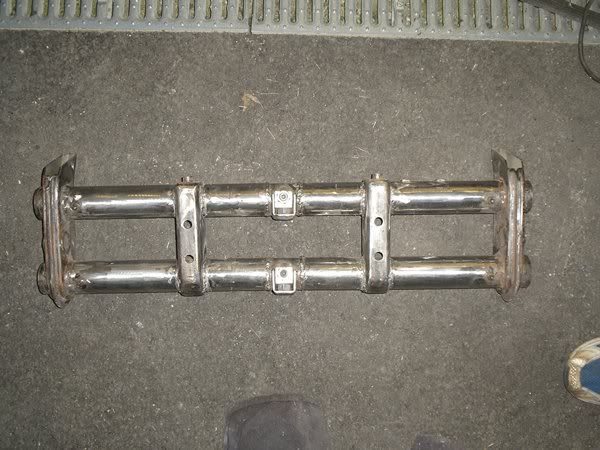

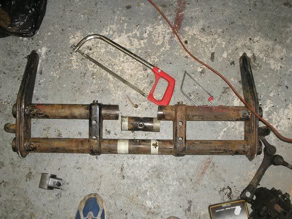

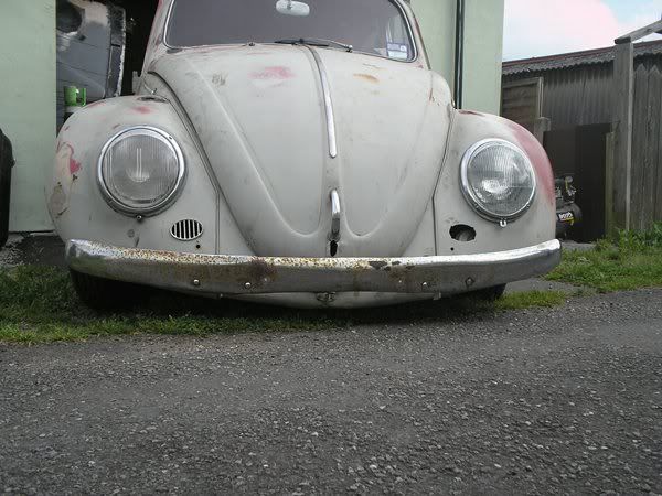

So that was next. Tom narrowed the beam by 3.5 inches for me:
and welded in some adjusters and cut of the shock towers because she’ll need custom ones due to the amount she’s been narrowed:
We lowered her off the jack and this is what we got:
I don’t like the nose down stance so the next thing to do was lower the back end. Currently down 3 splines with no interior or engine, so we’ll probably have to raise her one spline to just get her to move!

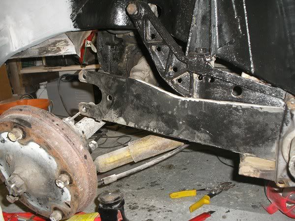

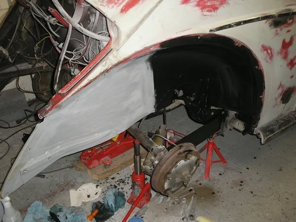

We then put her on the roller to paint her pans and channels with POR15:
All painted up and shiny:

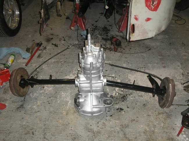

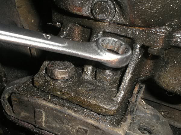

We found the problem to the kangarooing – if you look on the right of this pic there is a round hole. In that hole (and the one on the other side) there should be a thread and bolt there. Instead they’d welded the mount to the chassis – so the gearbox was just moving about as the rubber stretched – hence the bizarre driving!
So the gearbox was removed, oil drained, cleaned up and painted:
So the mount was taken off and Tom welded on some studs for me, the gearbox went back in and she was put on her wheels again – check out the camber!

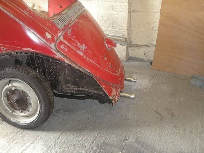

In the meantime I’d welded in the 2 rear bumper hangers to get rid of the accident damage:

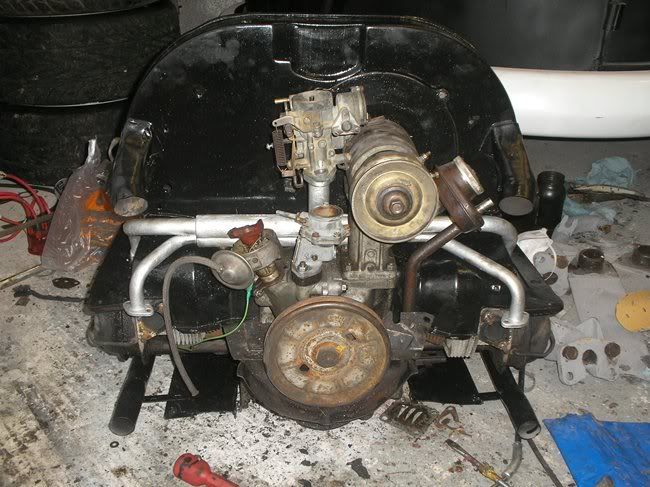

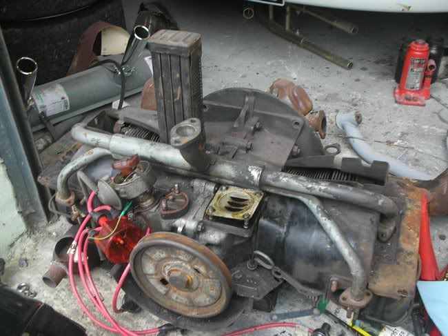

I also did a 12v conversion on the 1200 engine I’d picked up for £50 as her original one was eating oil a bit.
I cleaned the carb up and painted all the tinwear with POR15:

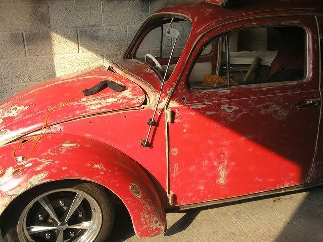

After that I decided to see what she looked like underneath the primer – I sanded her down and this is what I was left with:
So she’ll look like this soon:

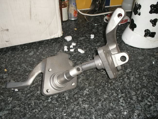

After we’ve lowered her a bit more using dropped spindles:

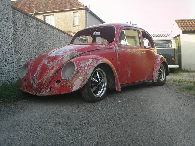

Almost finished all the sanding - just got a few bits to do by hand - under the handles etc.
Seems weird to see her with a decklid on again!

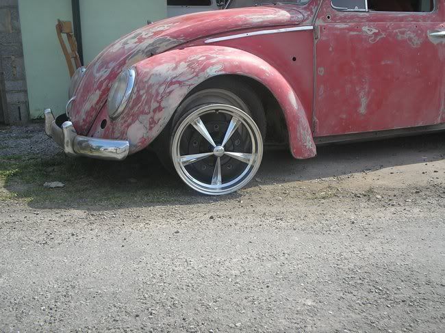

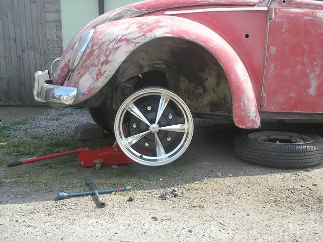

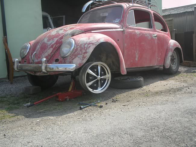

I wanted to see what her new wheels would look like:
Only problem with having no shocks is that you have to jack her up sooooo high to get the wheels off the floor!

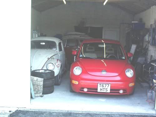

Strange seeing 2 'whole' looking cars in the garage too!

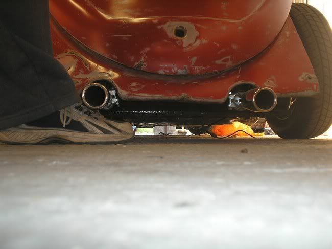

Fitted rear bumper and rear lights:
She looks like a 'real Beetle now!

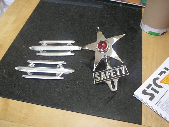

Then I fitted something I never thought I'd buy! I've never really been a fan of eyelids and I've always thought they were quite girly... but then again all the cars I've had before have been boys - Bella is the only girl. I've recently seen a few nice Bugs with them on which seem to have really suited them. So I got a set of Flat4 ones and trial fitted them when i did the wheels.
At the moment, I quite like them, so they shall stay on her for a bit methinks. Only take a minute to remove if I decide I don't like them anyways Smile
