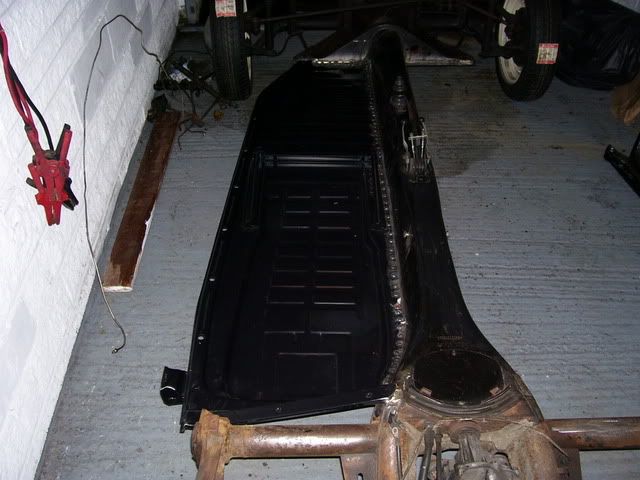

PostSubject: Re: Introducing....THE STIG   Introducing....THE STIG - Page 3 EmptySat Dec 01, 2007 6:25 pm
One pan half in! Very Happy

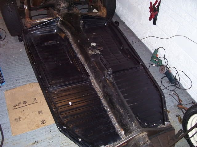

PostSubject: Re: Introducing....THE STIG   Introducing....THE STIG - Page 3 EmptySat Dec 01, 2007 10:10 pm
Got to tidy it up a bit and seal it tomorrow, but quite pleased.
Once the other side is done gonna drop the engine and flip it all upside down and seal and paint the underside, but for now...

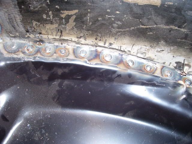

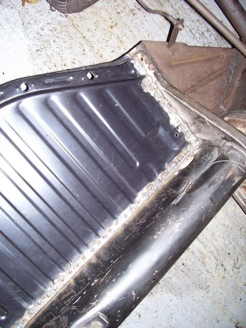

PostSubject: Re: Introducing....THE STIG   Introducing....THE STIG - Page 3 EmptySun Dec 02, 2007 3:05 pm
I'd like to meet the bloke from VW brasil who made my driverside floorpan and give him a dam good thrashing.
Anyways, after a bit of a tickle with the persuader...
Introducing....THE STIG - Page 3 Stig02-12-07003
Introducing....THE STIG - Page 3 Stig02-12-07004
Introducing....THE STIG - Page 3 Stig02-12-07002
Just hope it all lines up right when it goes back together, but at my workrate i wont have to worry about that for a while!!!
