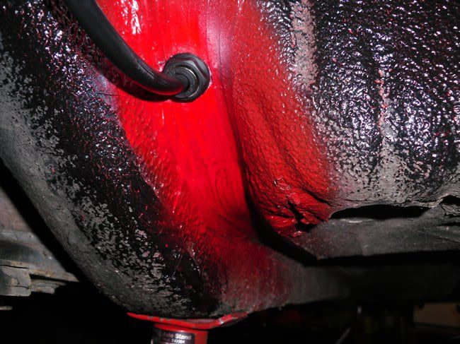

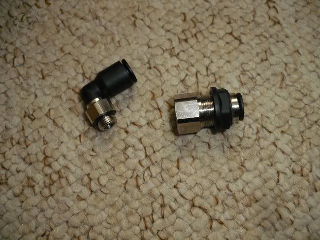

Right, now where was I? I've been getting Robbie ready for his MOT (
Wednesday!) and sorting out a few bits that I wasn't happy about. One of these were were the air lines exited through the body - I tried putting in rubber grommits but the metal was too thick, so I tried putting fuel line around the pipe - which although seemed to work, I didn't like the angle that it was going it at the back of the car and still seemed a little vulnerable to being damaged at the front.
So, I bought some of these:
Robbie Rocket - New Beetle Cup Car Replica - Page 8 650DSCI0450zx
Here they are at the front:
Robbie Rocket - New Beetle Cup Car Replica - Page 8 650DSCI0451zx
The elbow peice is inside the car at the front as once it gets inside it goes round towards the centre of the car.

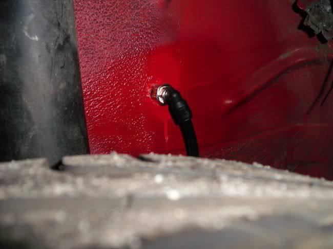

At the back, the elbow is on the outside:
Robbie Rocket - New Beetle Cup Car Replica - Page 8 650DSCI0459zx

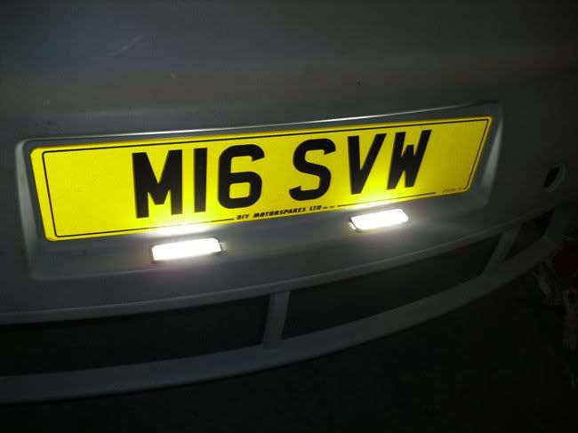

I've also fitted, what are quite possibily, the world's brightest number plate lights - and the number plate:

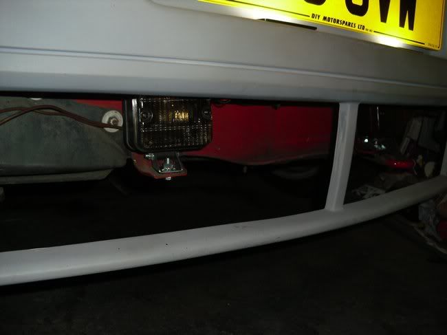

And the reverse and fog lights are wired up and fitted - they've been given a bit of a tint to make them less obvious. Once I've got the grill in, you should hardly be able to see them. Just need to tidy up the wiring:

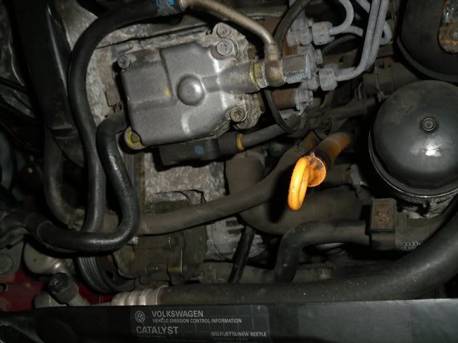

Over the last week or so I've been sorting some technical issues. The alternator wasn't working and hence wasn't charging the battery. I needed to get this fixed before I could take him out (once taxed, obviously!). Alternator removal isn't what I'd describe as a fun job on Robbie. We ended up having to remove the auxillary belt, tensioner, front bumper, wings, crash bar, radiator, fuel filter, air conditioning compressor and bits of various piping to get to it. Once I could get to it, it was a nightmare to remove once the bolts were out. They're shoved into the smallest gap in the world and one move the wrong way and it gets stuck!
Anyway - I eventually managed to wrestle it out and took it to Bridgwater Battery Centre where it was reconditioned for the bargainous sum of £35! Very Happy Eventually after 4 trips to VW I got the correct new auxillary belt to put on and volia - problem solved!
This morning I've been removing the starter motor to take down to the battery centre to check over. The starter has never failed, but it often makes the common 'VW squeal' (which I belive is due to clutch dust build up making it stick) and as he's done over 100k and has never been the quickest to start, I thought it wouldn't hurt to get it looked at whilst it was off.
In true New Beetle style, removal involved taking off a few other bits (the radiator again - as the battery tray didn't want to budge.... but I could have done it with all those in situ, but as the front end was off from the alternator, it made sense to have a bit more room to work in) and a lot of wiggling about.
I was suprised at how diddy the starter motor was. It's much smaller (and lighter) than a classic Beetle starter and soooooooooo much lighter than the starter off Steve's Series 1 Landy which I struggled to pick up, let alone carry! This one I can carry comfortably in 1 hand!
Soo.... pictures.... here's where the alternator lives (it's the silvery thing at the bottom, below and to the left of the dipstick):

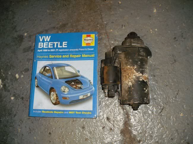

And here's the starter - pic of Haynes manual for size (btw, the Haynes is useless on describing this... it just says 'remove wires and bolts and take starter out'..... then again, it also describes the alternator as a '2 spanner' job.... pfft! Altho not technically difficult, alternator removal requires a lot of taking apart of other stuff.
Robbie Rocket - New Beetle Cup Car Replica - Page 8 650DSCI0517zx-1

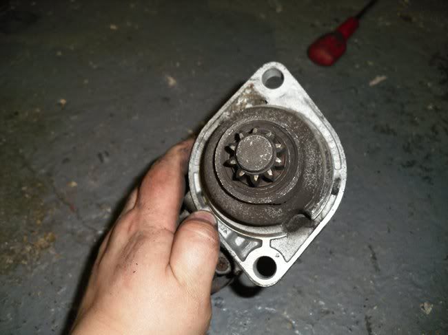

Here's the clutch dust which apparently causes them to stick. I wouldn't have thought what was on here was excessive though?
Robbie Rocket - New Beetle Cup Car Replica - Page 8 650DSCI0518zx-1

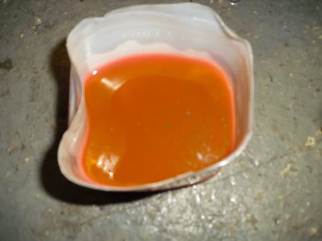

Oh, and I'm also changing the coolant temp sensor and doing a coolant flush whilst I'm at it.... I last did a coolant flush on him in 2005 or 2006... the stuff that went in was pink.... it's now orange... yuck!
Robbie Rocket - New Beetle Cup Car Replica - Page 8 650DSCI0510zx-1
