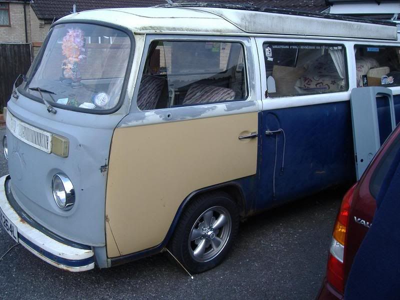

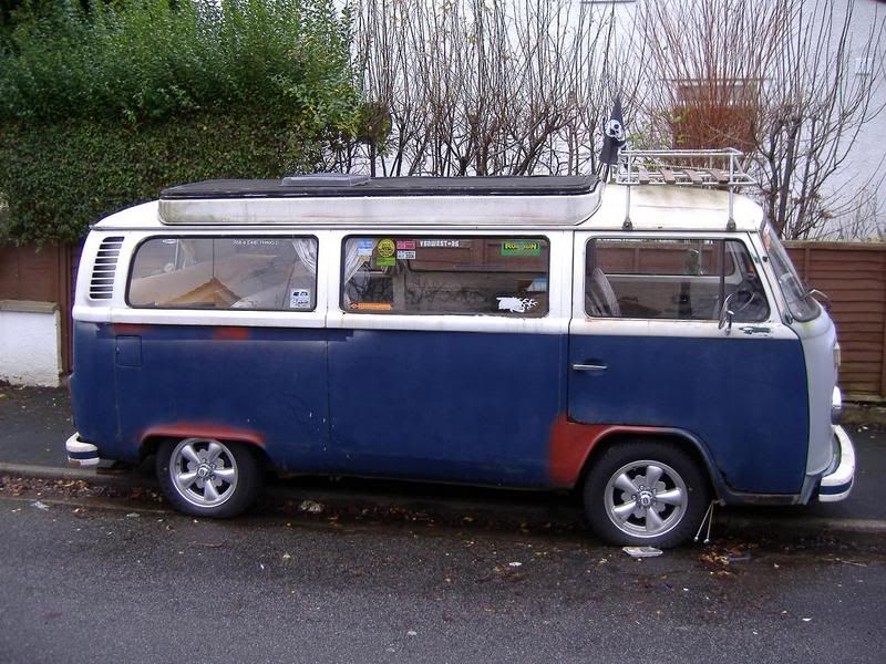

starting point
my 72 bay 'JAX' Camper003a

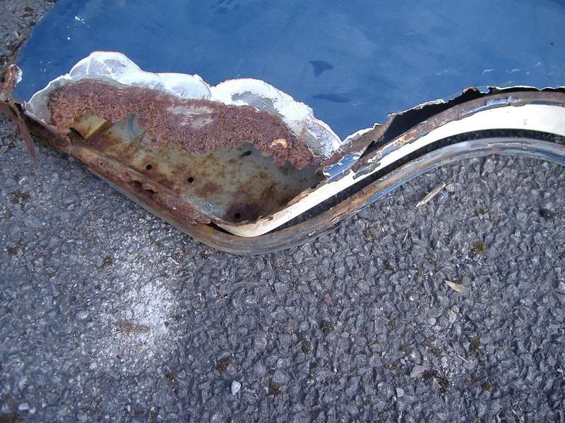

more rust than was expected time to get ordering even more bits
my 72 bay 'JAX' Van003-1

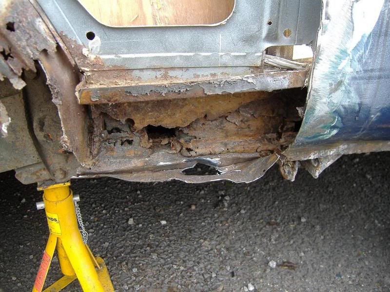

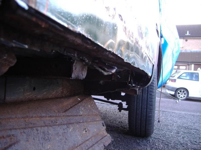

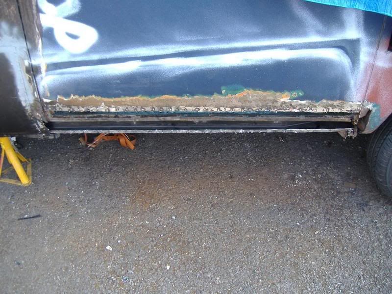

all the rusty old sill removed
my 72 bay 'JAX' Van010
well nearly !!!

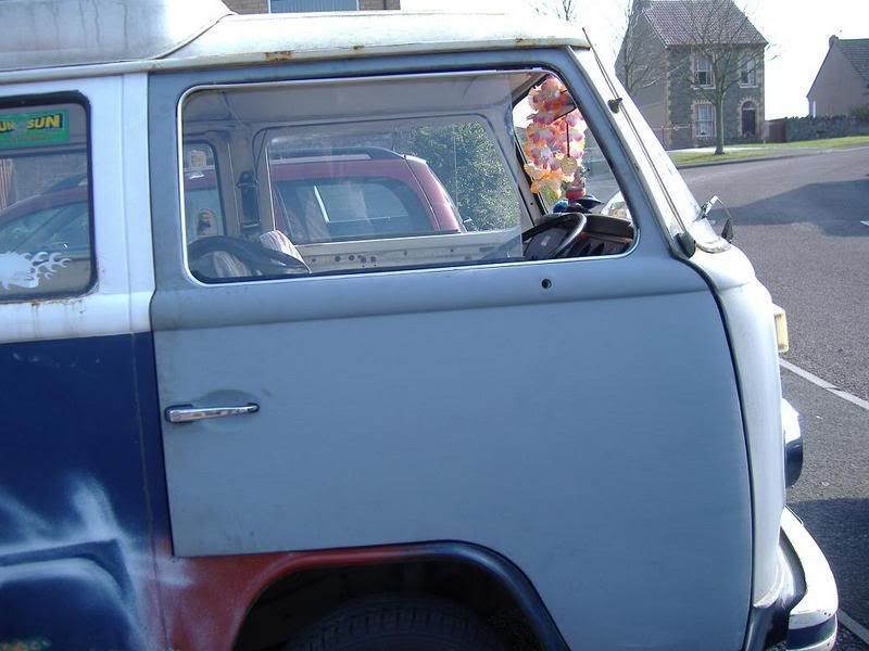

and the new second hand one in place needs quaterlight frame
my 72 bay 'JAX' Camper005-1

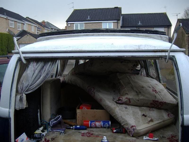

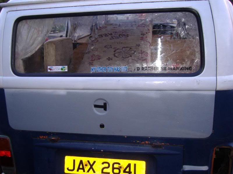

then on to the rear tailgate
old one off
my 72 bay 'JAX' Camper008
new one in place just needs the lock fitting
my 72 bay 'JAX' Camper010

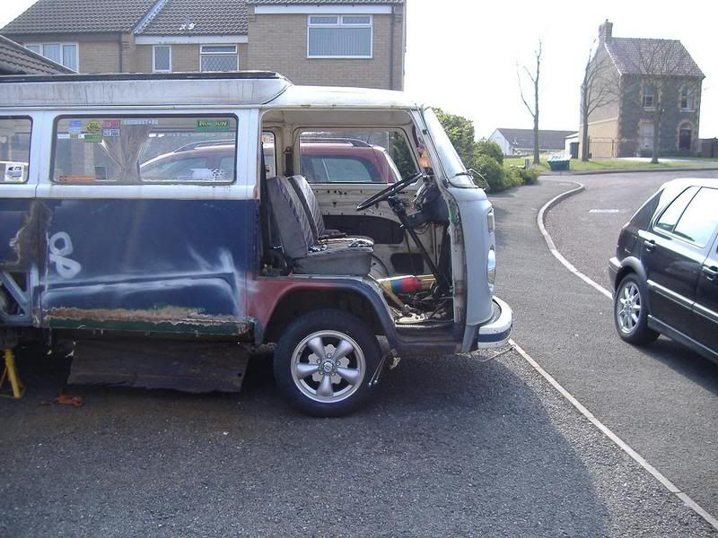

next the drivers door old one off
my 72 bay 'JAX' Camper014
new one in place needs lots of adjusting yet tho
my 72 bay 'JAX' Camper015

PostSubject: Re: my 72 bay 'JAX'   my 72 bay 'JAX' EmptySun Apr 01, 2007 8:35 pm
I like the stickers in the back window Shocked
PostSubject: Re: my 72 bay 'JAX'   my 72 bay 'JAX' EmptySun Apr 01, 2007 8:54 pm
LMAO lol! Thanks for pointing them out Steve! I love stickers that are as tasteful as that! Wink
Keep up the good work dude (and keep the pics coming Wink )!
PostSubject: Re: my 72 bay 'JAX'   my 72 bay 'JAX' EmptySun Apr 01, 2007 9:17 pm
Rolling Eyes what it says i'd rather be 'working' honest

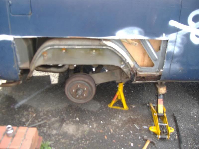

Very Happy beenbusy so far this weekend got quite a bit done
some rust repair on the front out rigger and on the back of the rear tub
my 72 bay 'JAX' Camper020
my 72 bay 'JAX' Camper022
then i fitted the new inner sill
my 72 bay 'JAX' Camper016
test fitting the rear arch and outer sill
my 72 bay 'JAX' Camper017

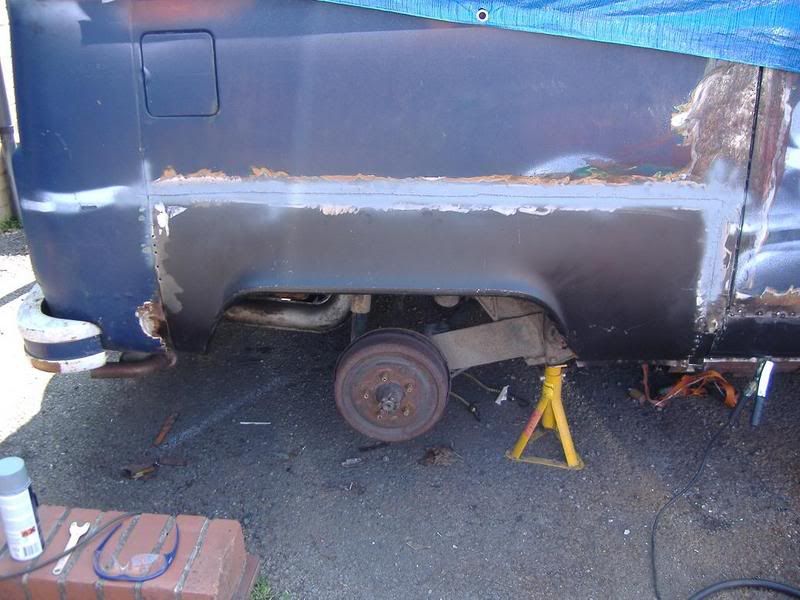

No not a good day to dayone step foward two back
started ok got the rear arch on nt quite as flush a fit as i would have liked never mind just a bit of extra filler
my 72 bay 'JAX' Camper023
a bit off zinc primer
my 72 bay 'JAX' Camper024

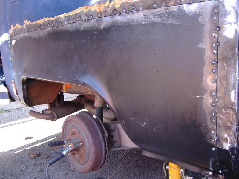

but then disaster in my haste and excitement cos it was all going back together i welded the new outersill on but i had not cleaned the back of either panel so rubbish welds and i had to pull it back out No so i am left with this and i may have to spend even more money on panels ihave bought once Crying or Very sad but lesson learned the hard way won't jump in like an idiot next time
my 72 bay 'JAX' Camper025
